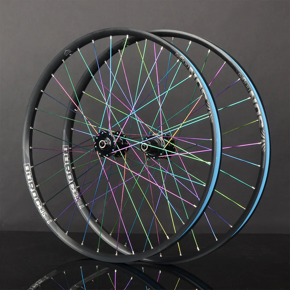

Found this listing for the same wheelset but little cheaper and cheaper postage but only few sells and new store. Shipped from same place apparently.
Never used aliexpress before so I think I will use the more popular one to be safe.
€77.99 8%OFF | Custom Built Mountain bike wheelset 27.5/29 inchs Duroc 30/35 Tubeless Ready rim XM490pro Hub 8-11S Microspline 12S MTB wheel
sandnap
Dec 23, 2023
130
128
Herriman, UT USA
Oh that's interesting quite a big difference to me. Seen in the photos. However if I go to the same shops listing about the same wheel but boosted option and there you can choose black hub with black spokes for the same price 😅
That is interesting. All hub color and spoke options are the same price in the US.
I just recently started buying from aliexpress too and so far I have had good luck. It is probably wise to do business with reputable shops. I have seen some pricing from new shops that is very hard to believe.

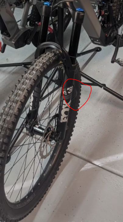

It's not safe to run the external brake hose through the fork slider, but the bike is nice anyway.
Thanks! Yeah I am not fond of the internal head tube cable routing but I'll deal with it because so far I love everything else. I will be disassembling it and checking for wear more often that I might if it was traditional frame routing, at least until I am confident that it isn't wearing down the cables.

Thanks! Yeah I am not fond of the internal head tube cable routing but I'll deal with it because so far I love everything else. I will be disassembling it and checking for wear more often that I might if it was traditional frame routing, at least until I am confident that it isn't wearing down the cables. Luckily if the rear brake fails there is always the front brake to make a terrifying situation slightly less terrifying.
I didn't explain myself, I apologize for my English but I meant the passage of the front brake hose to the caliper

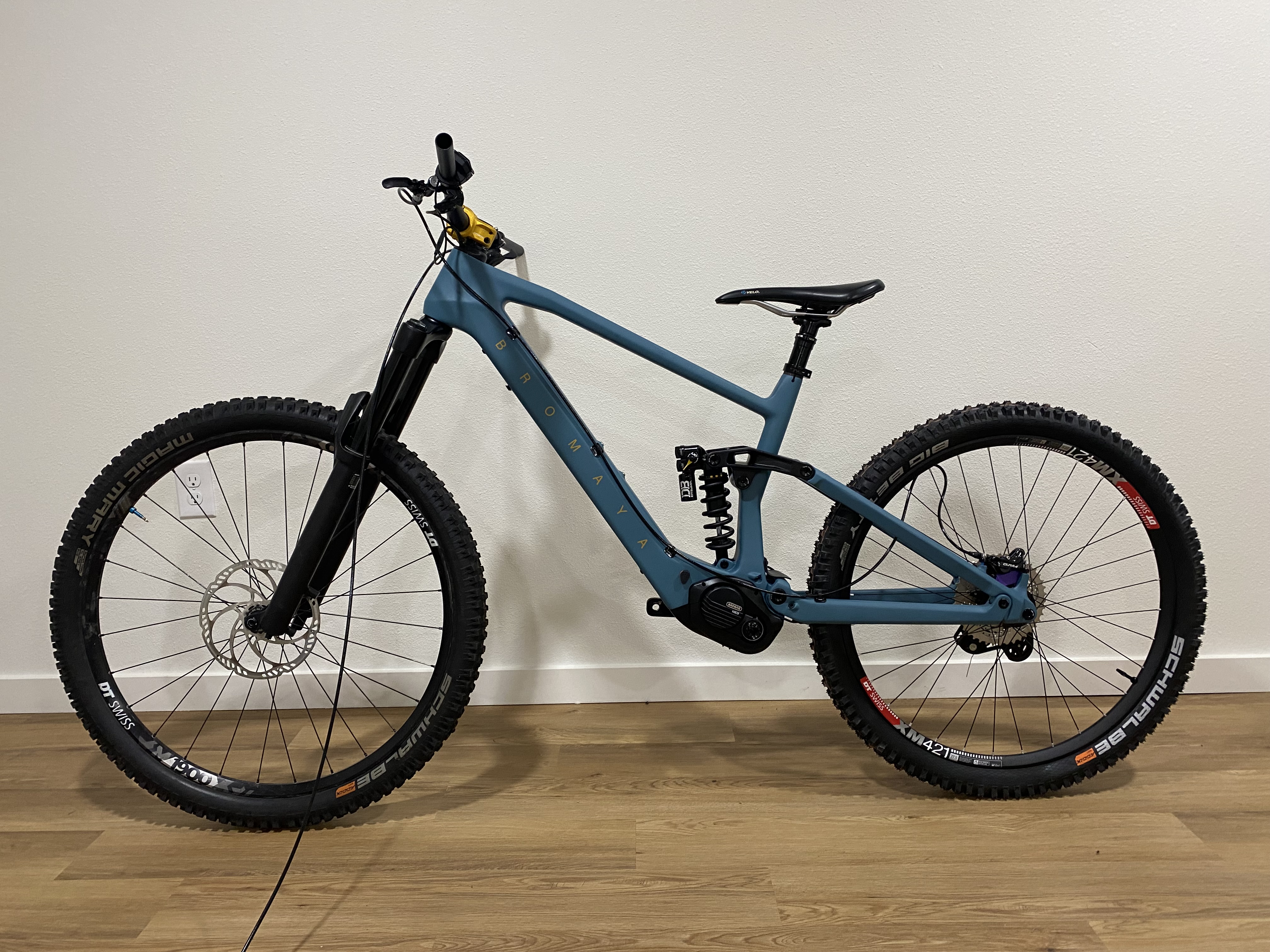

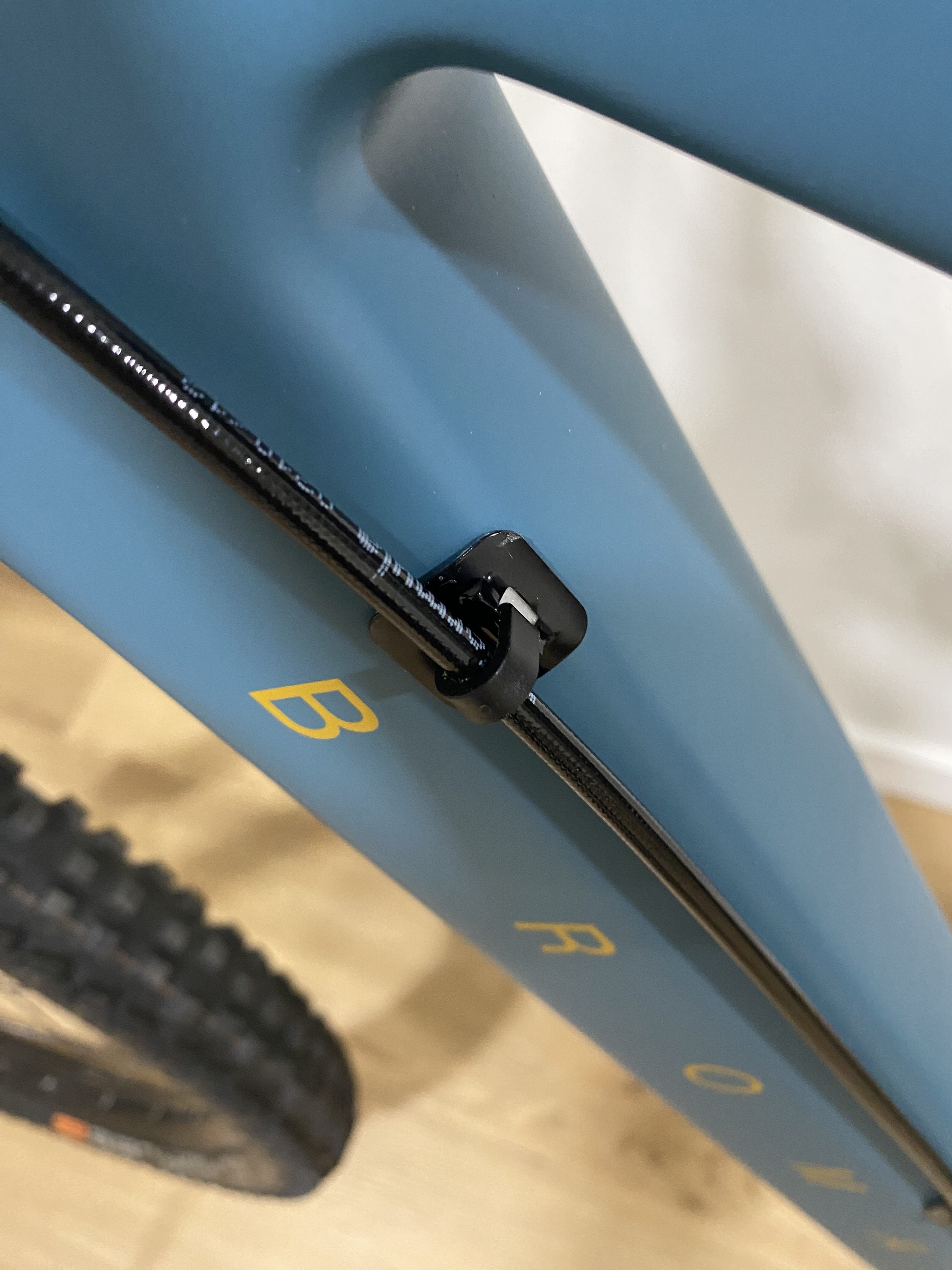

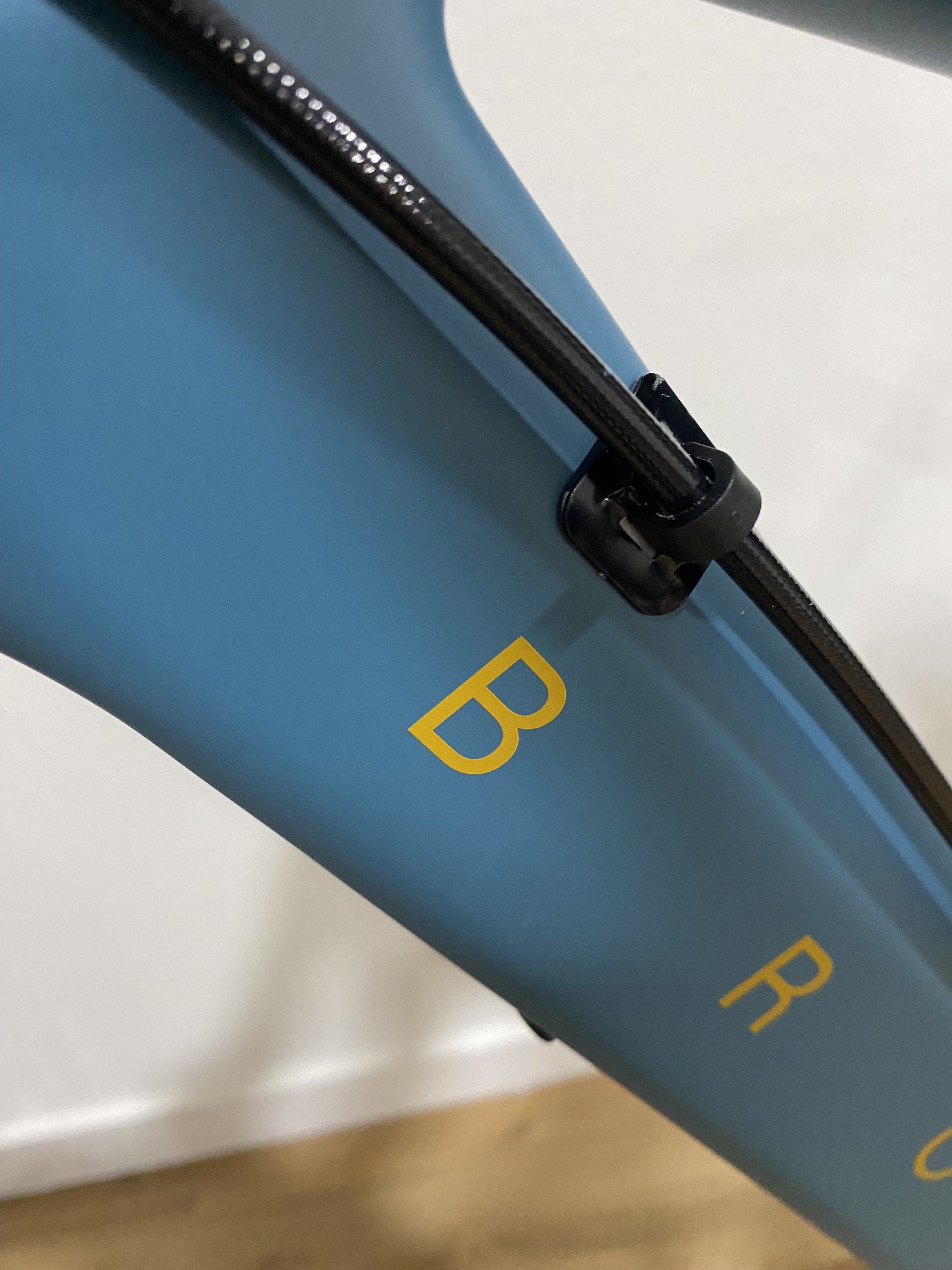

Good to know about the run, I think I’ll insulate my cables that run inside. For the rear brake I’m going to try to run the rear brake on the outside, I bought some adhesive cable guides from Amazon. I’m not sure how it will perform but I’ll give them a try.

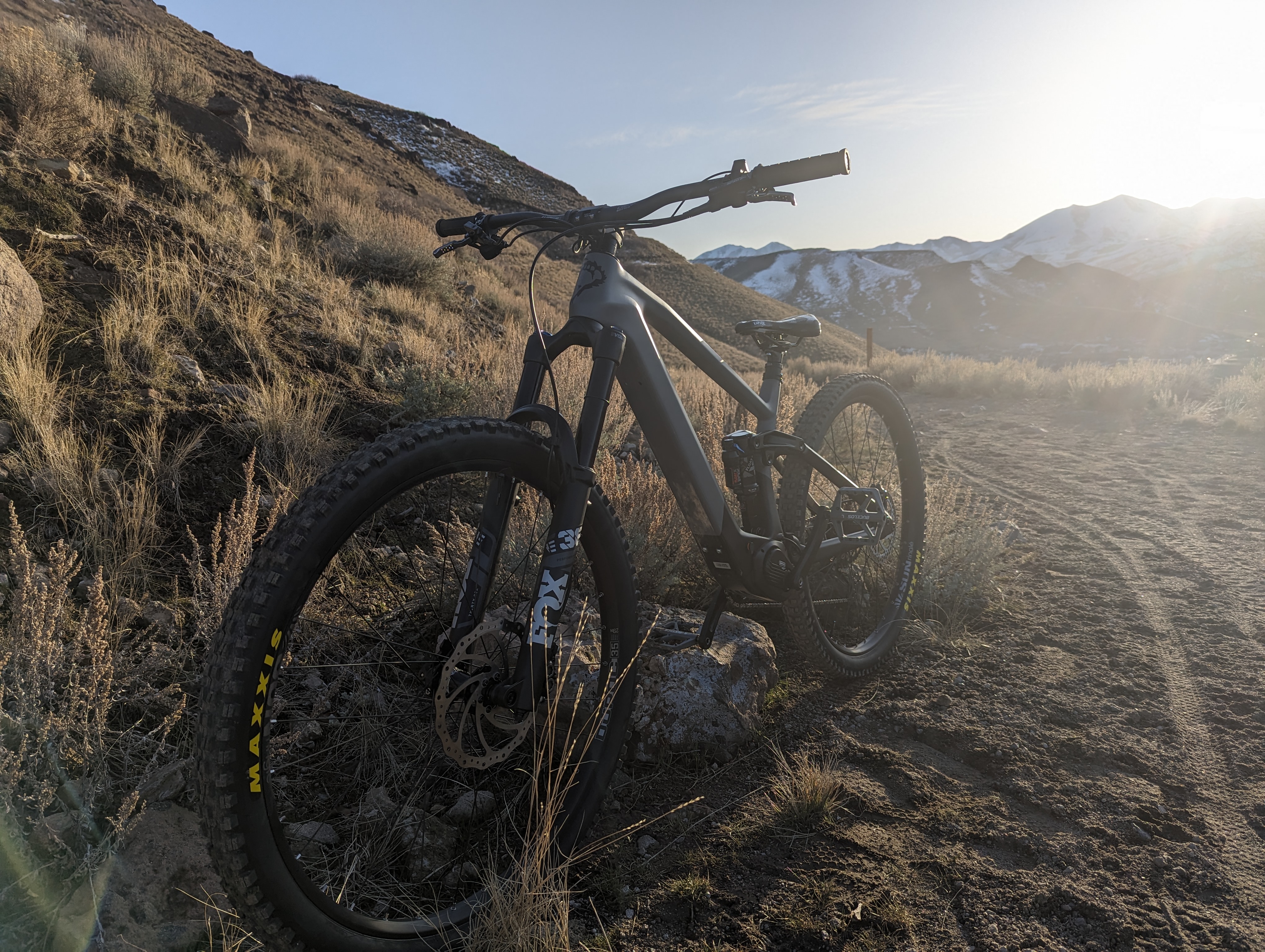

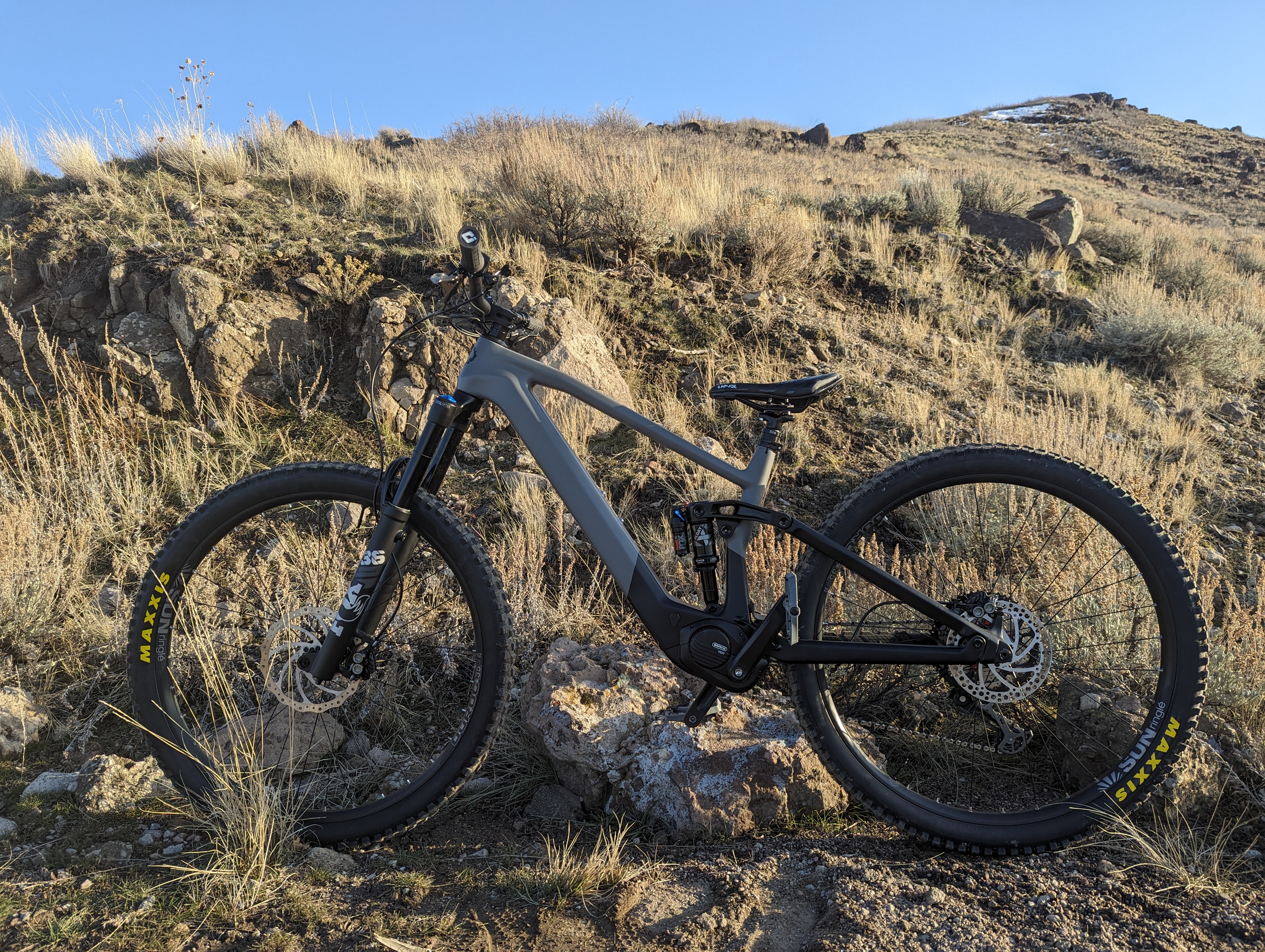

I finally had an opportunity for a short trail ride. Unfortunately the ground was soft so I had to take it easy. The trail I took is a steady, rocky climb with switchbacks.
Powerwise it's about what I expected. It helped me out a lot but I was winded at the top of the climb. It likes a higher cadence than I am used to. My full power emtb has a lot more power overall but especially at a lower cadence.
It feels very very similar but noticeably slacker than my Specialized enduro carbon.
I am looking forward to drier trails so that I can wring it out a bit more.

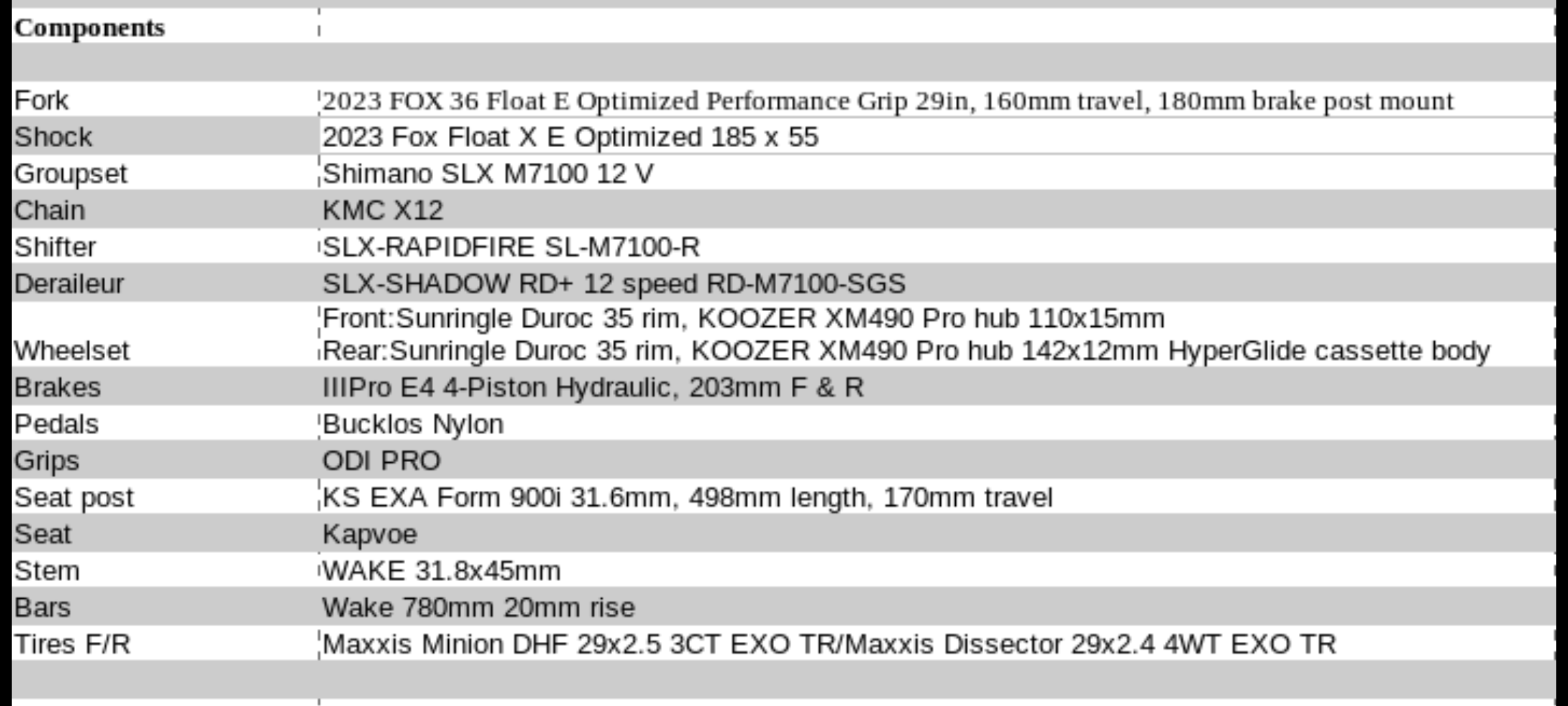

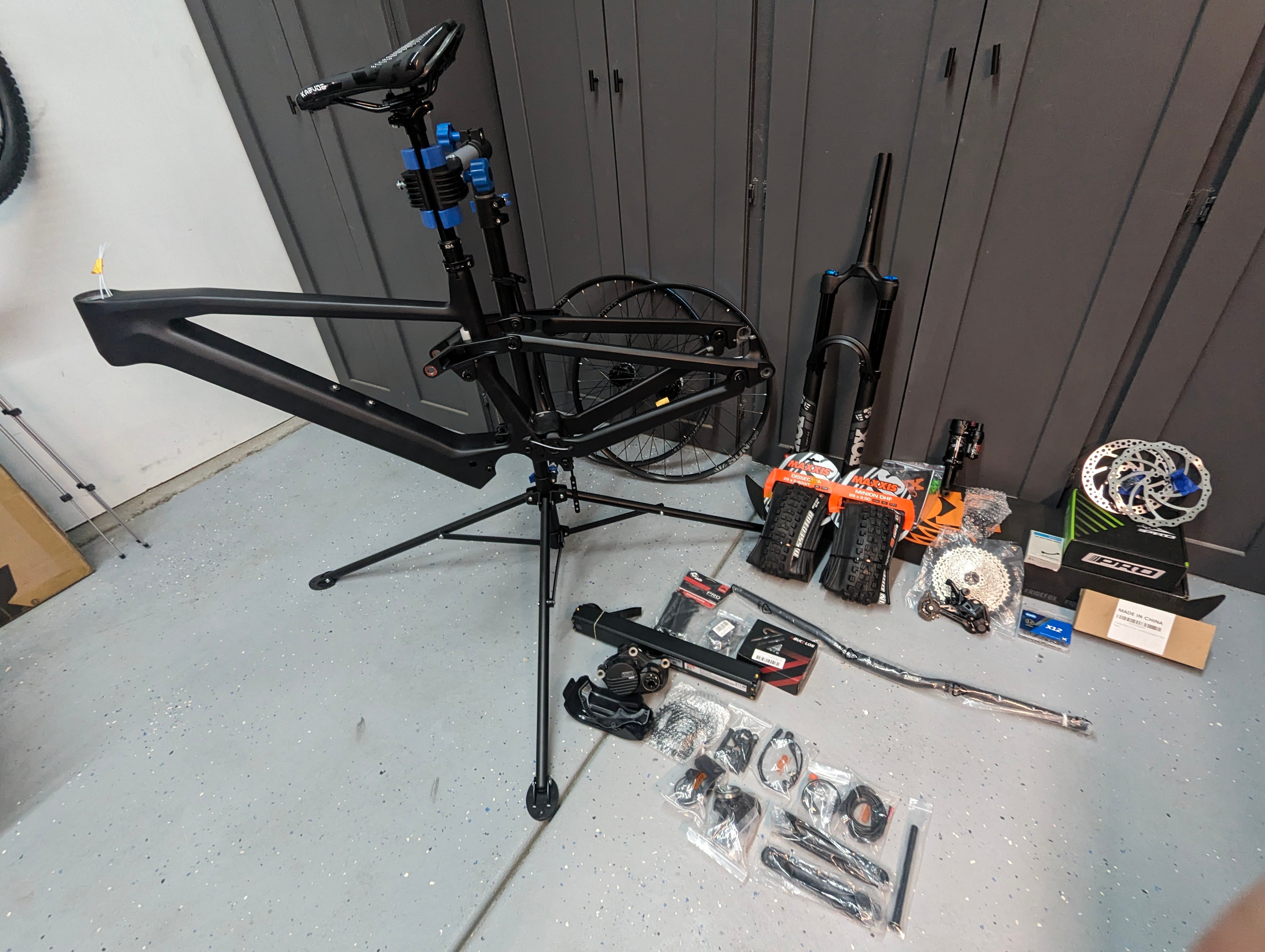

My LCE930 Build is underway!
Thanks to Lightcarbon for providing such a well built frame! It looked flawless on the inside and outside.
The Components:
The total build cost is 3117.89 USD including shipping, taxes, etc.. The anticipated weight is 19.47kg -> Actual weight is 19.77kg.
Part I, Paint is complete:
Watch me paint!
Part II, Assembly is complete:
Part III, Build review:

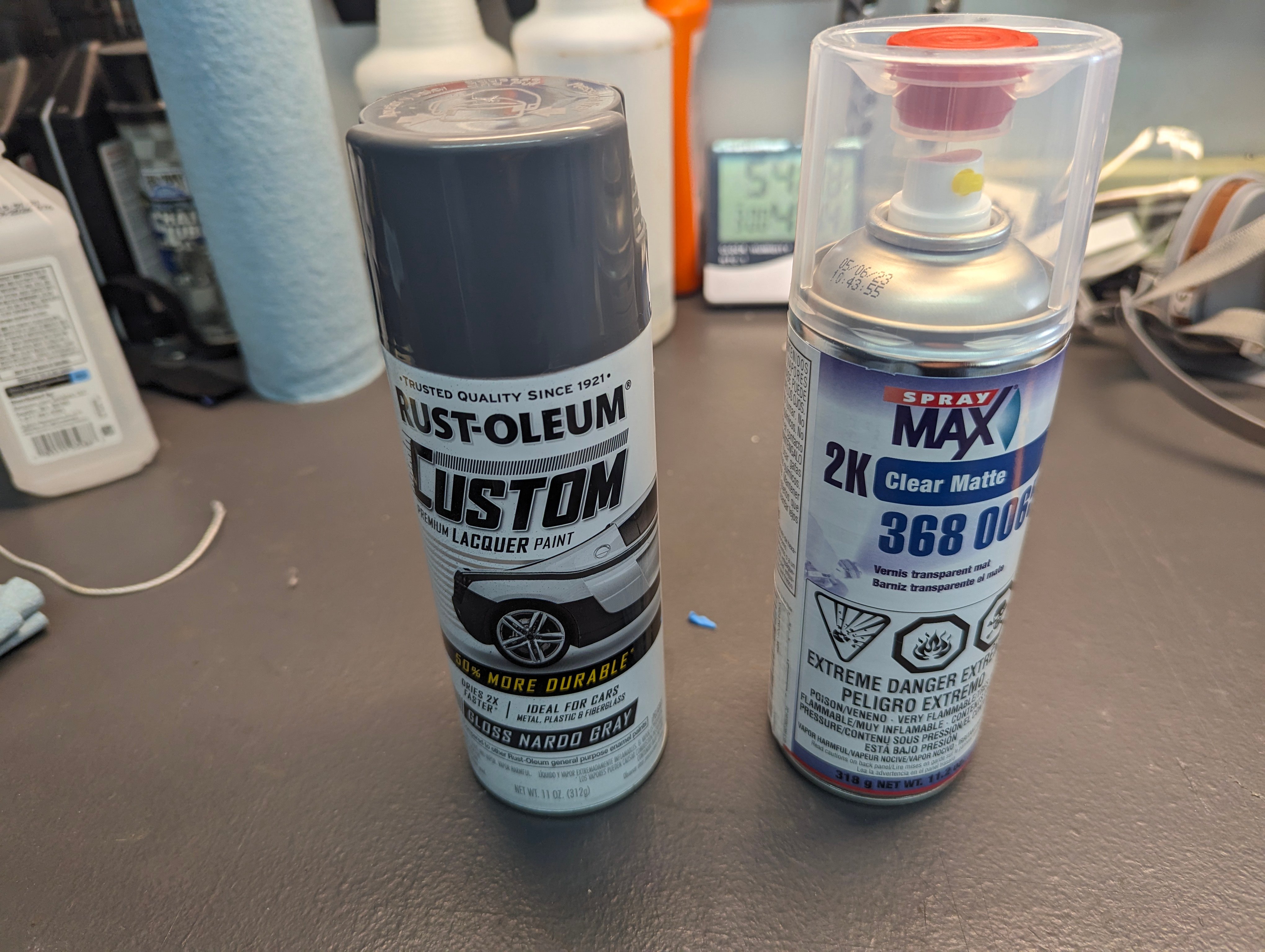

Do you recommend some specific painting brand? And do you have to apply something before painting and after that?
sandnap
Dec 23, 2023
130
128
Herriman, UT USA
The frame came painted in matte black. I roughed up the paint with some 800 grit sandpaper and wiped it down with alcohol before applying the paint.
The paint and clearcoat I used:
sandnap
Dec 23, 2023
130
128
Herriman, UT USA
It certainly looks good, i’ll give you that! 😄
I just hope it will last. In most cases, paint won’t adhere well without primer, so more likely to chip or peel off. Good thing you sanded for a smooth surface though.
Thanks! Yeah I have been painting vehicles for quite a while. I took my chances in order to avoid painting the black and gray areas. If it doesn't stick I'll be redoing it which won't be a big deal.
