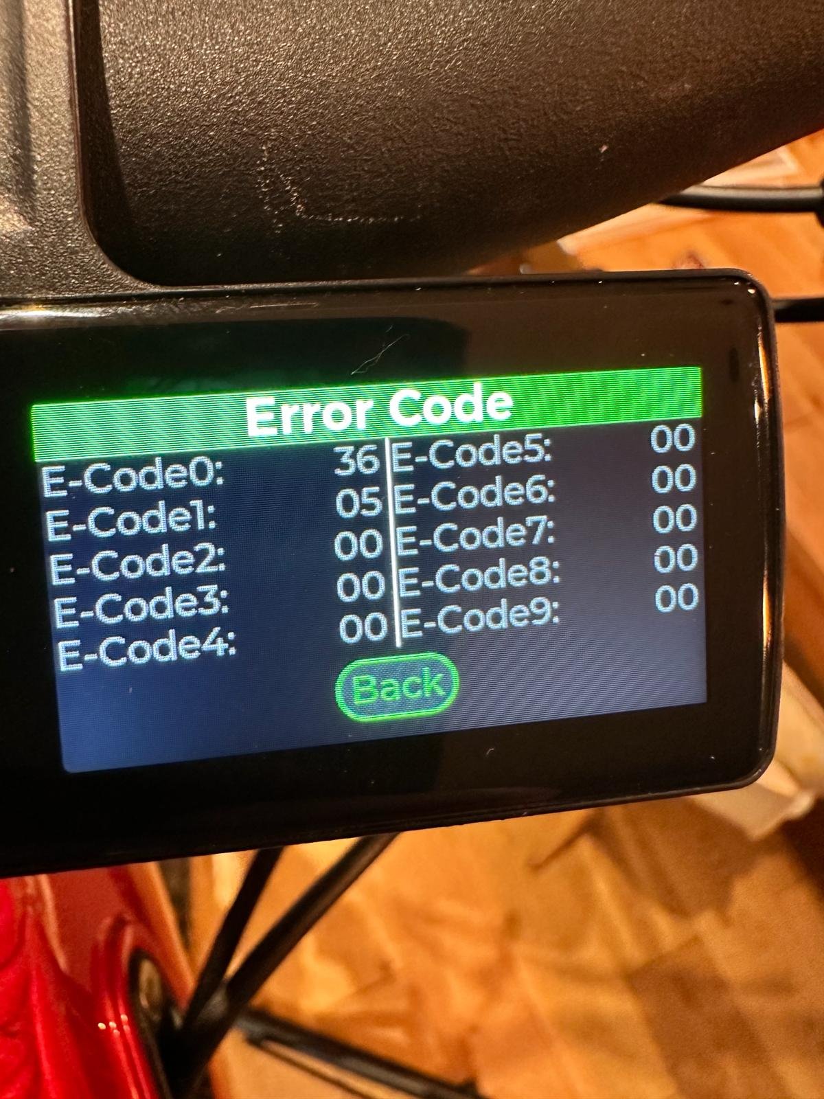

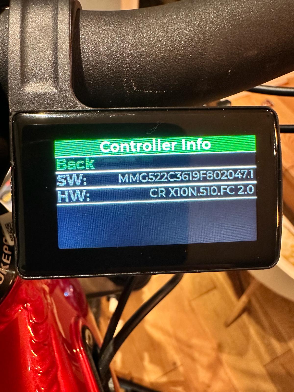

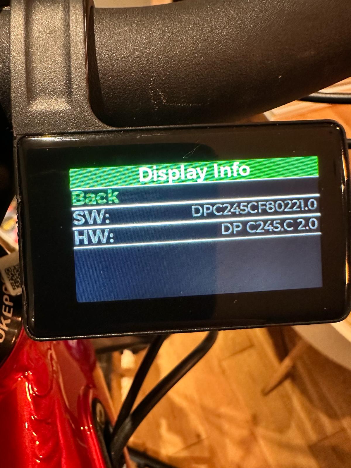

Thanks for all the replies. Tonight I wanted to drop the motor and check the cabling above the motor but the chainring tool which works on my bosch motor is too shallow for the longer spindle and I had to buy the Park tool on amazon, coming tomorrow.
However, I keep coming back to the intermittent nature of the fault which feels like an electronic issue. So, fiddling around with random key press+hold combinations the bike sprung into life. I was able to prove all the buttons worked and navigate the settings. I learned the following before I put a crank arm back on and put load on the motor for a min at most and then it powered off, never to reboot. So, again, feels like a motor board issue? I learned the following:
  1. I have an FC2.0 Motor Controller
  2. DPC 245 v2.0
  3. Error Codes 36 & 5
Any ideas if this helps narrow things down?
Does the FC2.0 work okay with a DPC245 v2.0 or should it be a v3.0?
What about those error codes?

36 is error on the keypad
5 is throttle not in correct position
I have both of those before i changed my display
Interesting - when you swapped out the display did this resolve it? Could this be the issue, controller or keypad shorting?
No Vitus ones available now but I'm assuming a DPC245v2.0 should be plug and play?

Yes it fixed those two errors but didnt fix random on and off thing, i also have error 21 which is no speed signal tried three different speed sensors.........still there
I have display ver 3 but dont think it makes any difference except bafang go works only with ver 2 and bafang go+ only works with ver 3
Thanks, I'll take the plunge on the display and see. I'll perhaps go V3.0 if it plug and play.
