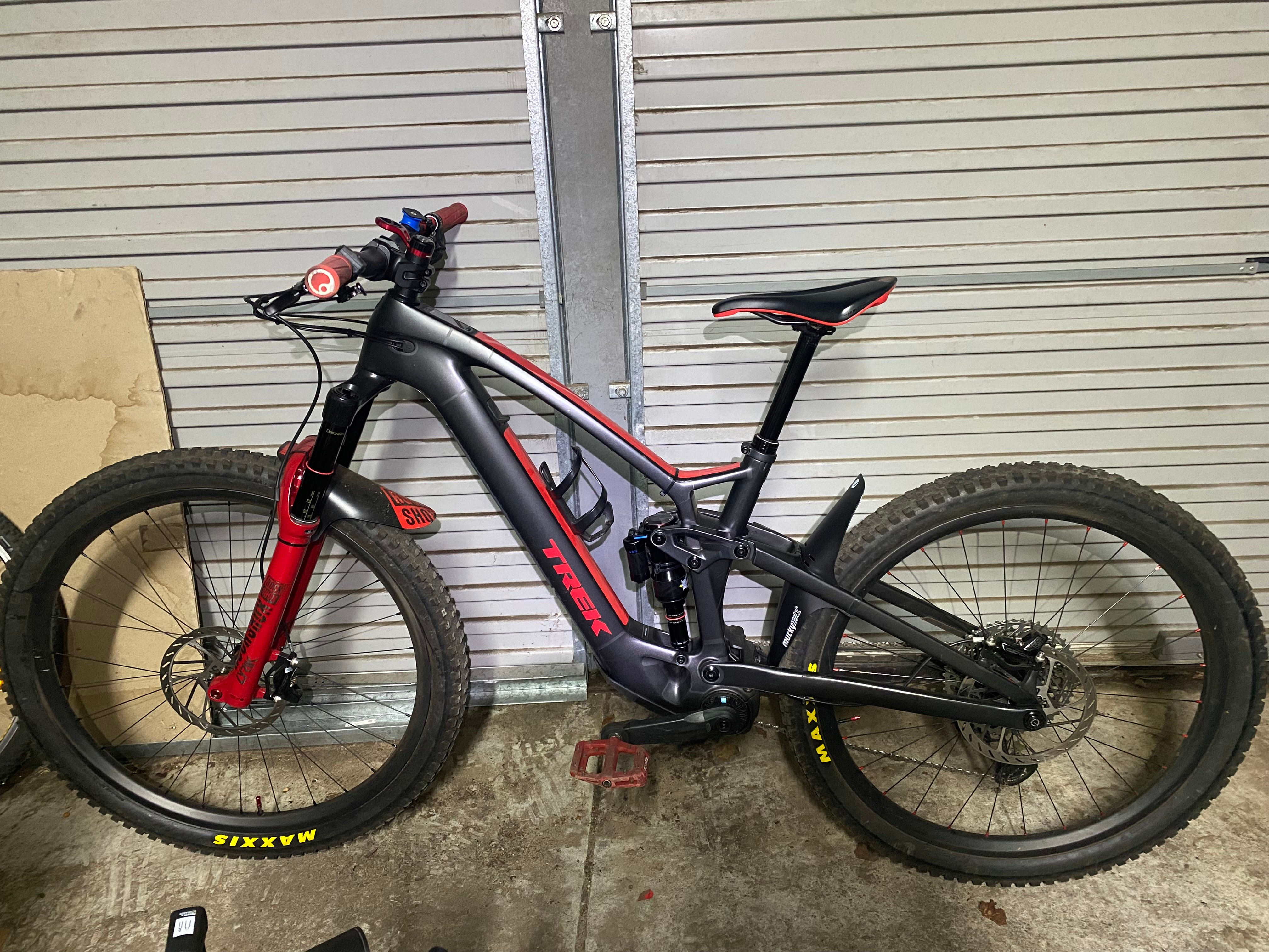

Hey folks
I went down the path of buying the 9.5 because the Matt Black looks soo awesome.
Working through a few upgrades from stock:
Completed:
Stans Flow rims w/ DHRII/Assegai tyres w/ HOPE Pro 4 hubs
Fox 38 Factory fork -160mm travel
SRAM XG-1299 and XX1 chain, w/ 30T chainring
SRAM GX Eagle AXS
DYEDBRO protector
To do in next few months:
Hope Tech 4 V4 brakes, braided, and rotors
Rear shock either Fox or Rockshox
TQ Control box and AXS hardwire cable
Bike is amazing, even for me @ 100kg. I have had the TQ LCD screen replaced twice under warranty! First at 1 month, then at 6 months with the V02 LCD.

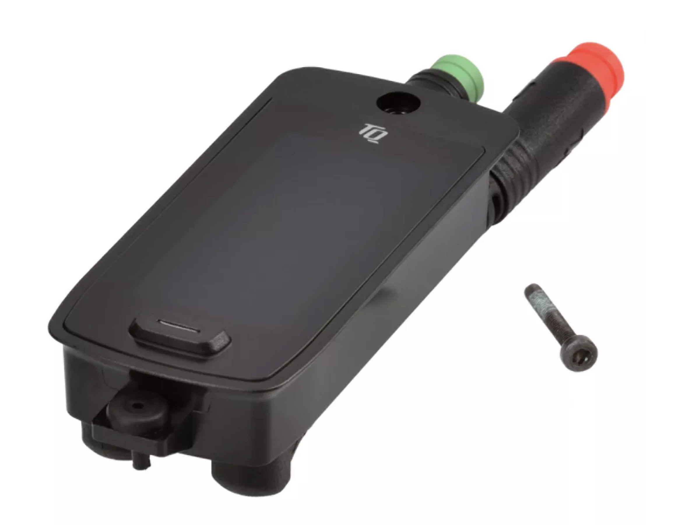

what went wrong with the LCD?
How would one identify v1 vs v2?

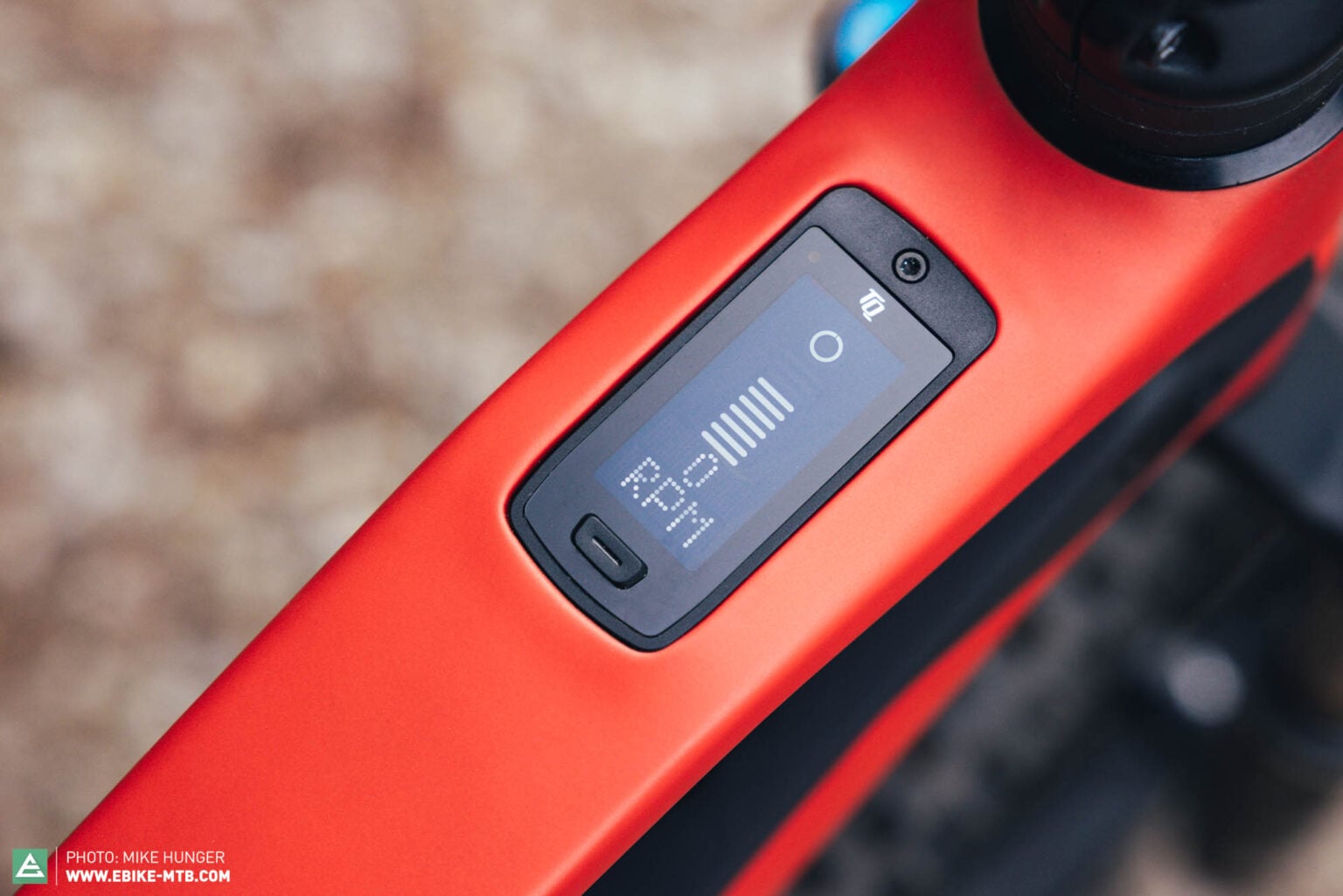

whats the different with the V1 lcd and V2 lcd? Can you post some pics of the v2 lcd?
joel.nz
Apr 15, 2023
Wellington NZ
That's a great question - the bike shop said they replaced it with version 2 - and that they have had no issues with the latest version but have had several with the first.
I assumed the code 'V02' on the back was version two but I cant find any information on the internet. I will check the back of my new display and let you know.
The first fault I had was the display wouldn't turn on, even when plugged in. The LEDs on the battery showed as 100% full. It did have a few comms errors when on the diag machine, so they replaced the LCD under warranty. (from another shop floor bike)
The second fault 5 months later caused the bike to turn off and display fault code 0416 on the display. Turning off then on would reset fault for 10 or so minutes then the bike would power off again. When I got it back home and charged it, it seemed to be fine, except the display wouldn't turn off (it would turn off then turn on straight away by itself).
The diagnostic machine showed the fault code, so they replaced the LCD with a version 2 (which I am now going to check and somewhat doubting based on my quick internet search).
Hope this helps.

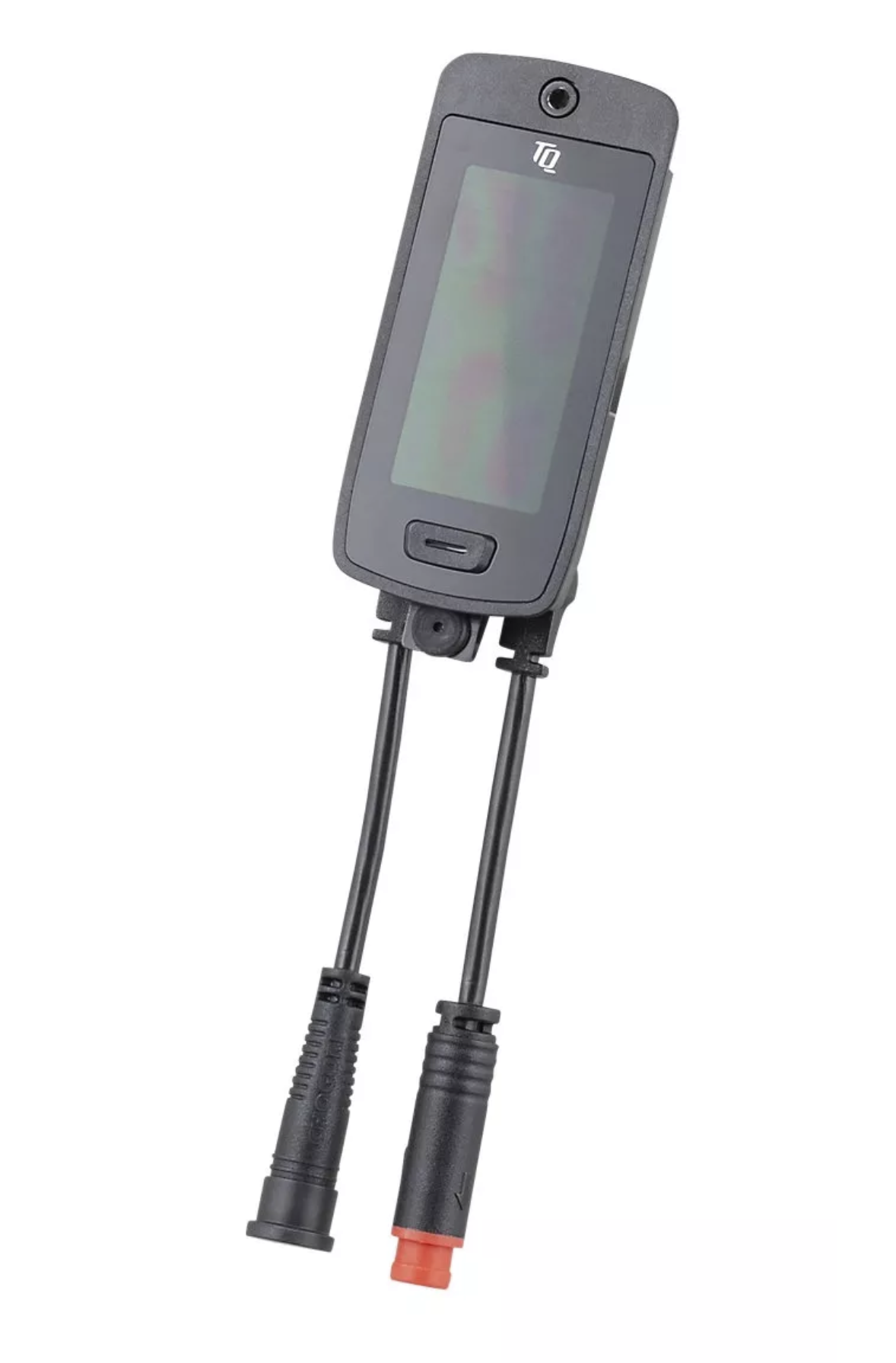

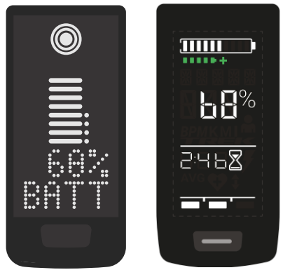

I'm pretty sure only the Trek Fuel EXe and the Trek Domane+ have the V02 display. The other brands such as BMC, Scott, etc with the TQ motor has the V01 display.
LEFT V01 vs V02 on RIGHT.

Hi.
No, the left screen does not exist on the Fuel Exe.
To recognize a V01 from a V02, you just have to look at the cable outlet.
V01:
V02 :
Minerve
Apr 25, 2023
Switzerland
Humm... Ok, I see better, sorry... then you may be right because your left version above is used by the new Rotwild.
But the V01 doesn't exist for the Fuel EXE, so when the guys say they put together a V02... it's not a new, more reliable or stronger version, it's just the screen version that matches the Fuel EXE.

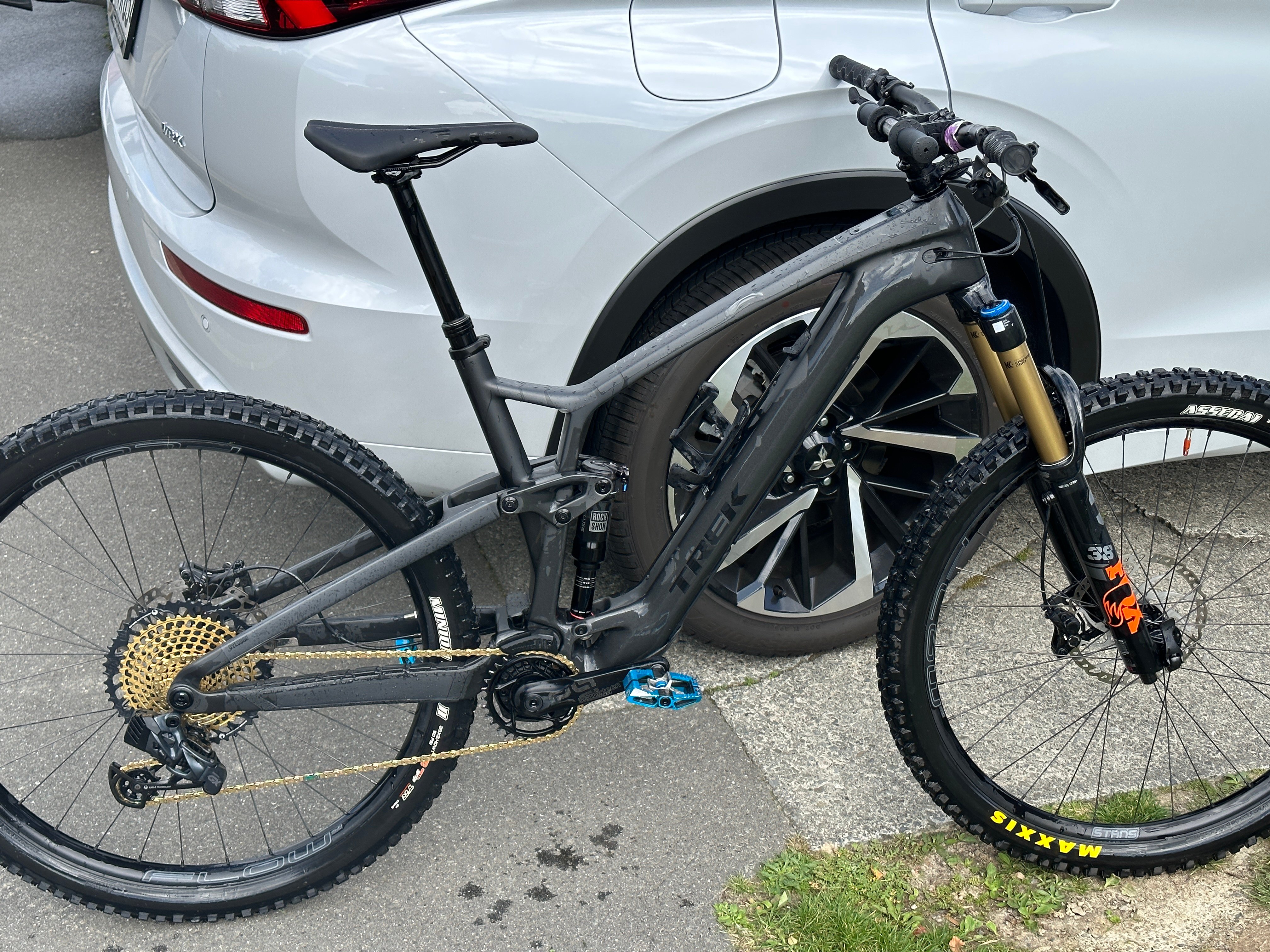

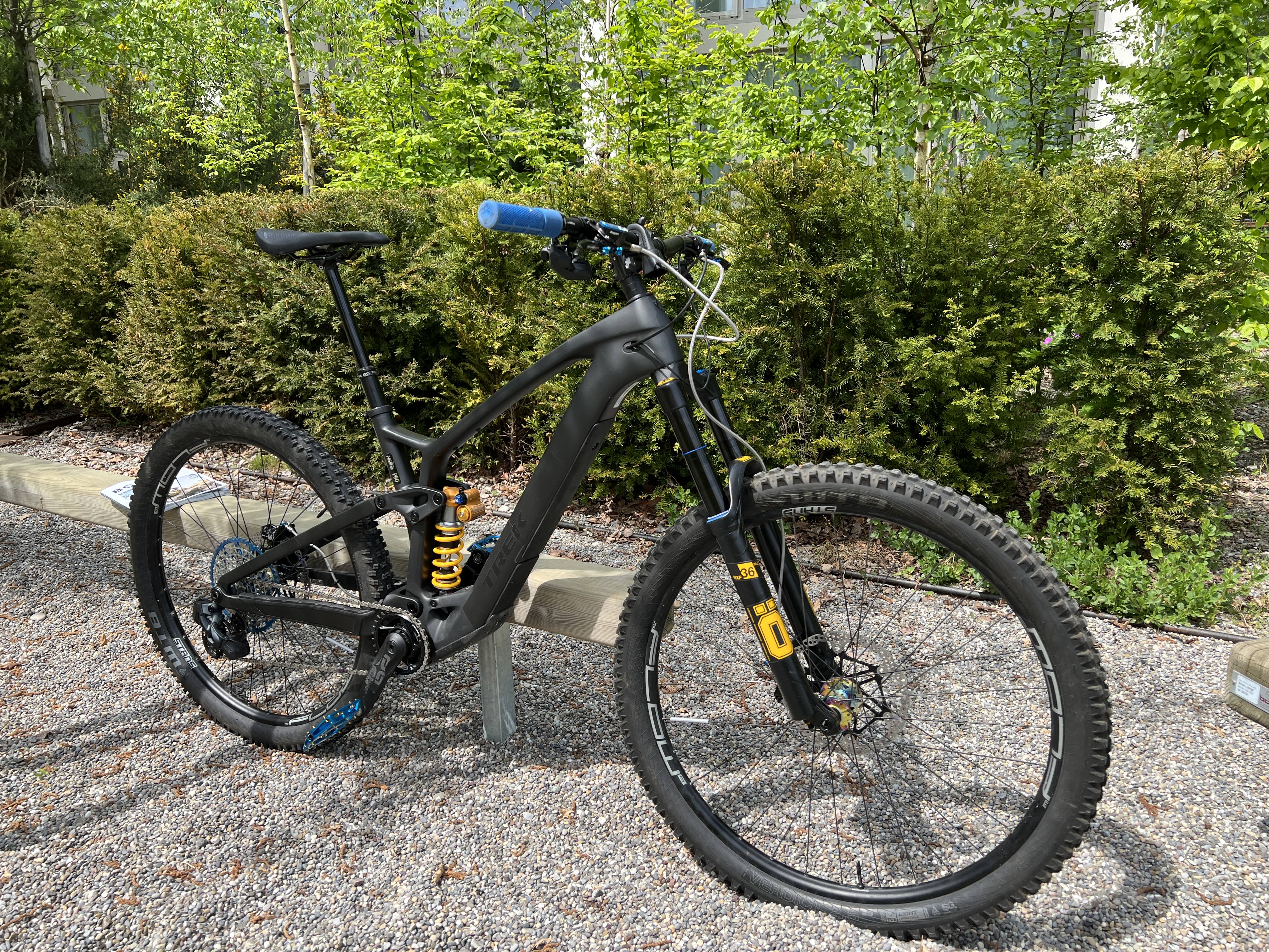

Almost finished mine:
L-size ex- e 9.5
Ohlins rxf 36m2 on front
Ohlins ttx22m2
Sram GX AXS
Bikeyoke dropper post 185mm
Deathgrip grips
DMR Vault pedals
Garbaruk casette
Dt swiss 240 + Stans ztr flow ex3
WTB tires Vigiliante 2.3 rear and Verdict 2.5 on front + Pepi’s inserts
Hope Tech4 V4 brakes with Hope brake discs
Protection film from Highfivestyling (Polish brand)
Just waiting for handlebar and sattle to have my dream bike, and need to test suspension to figure out what coil will work best

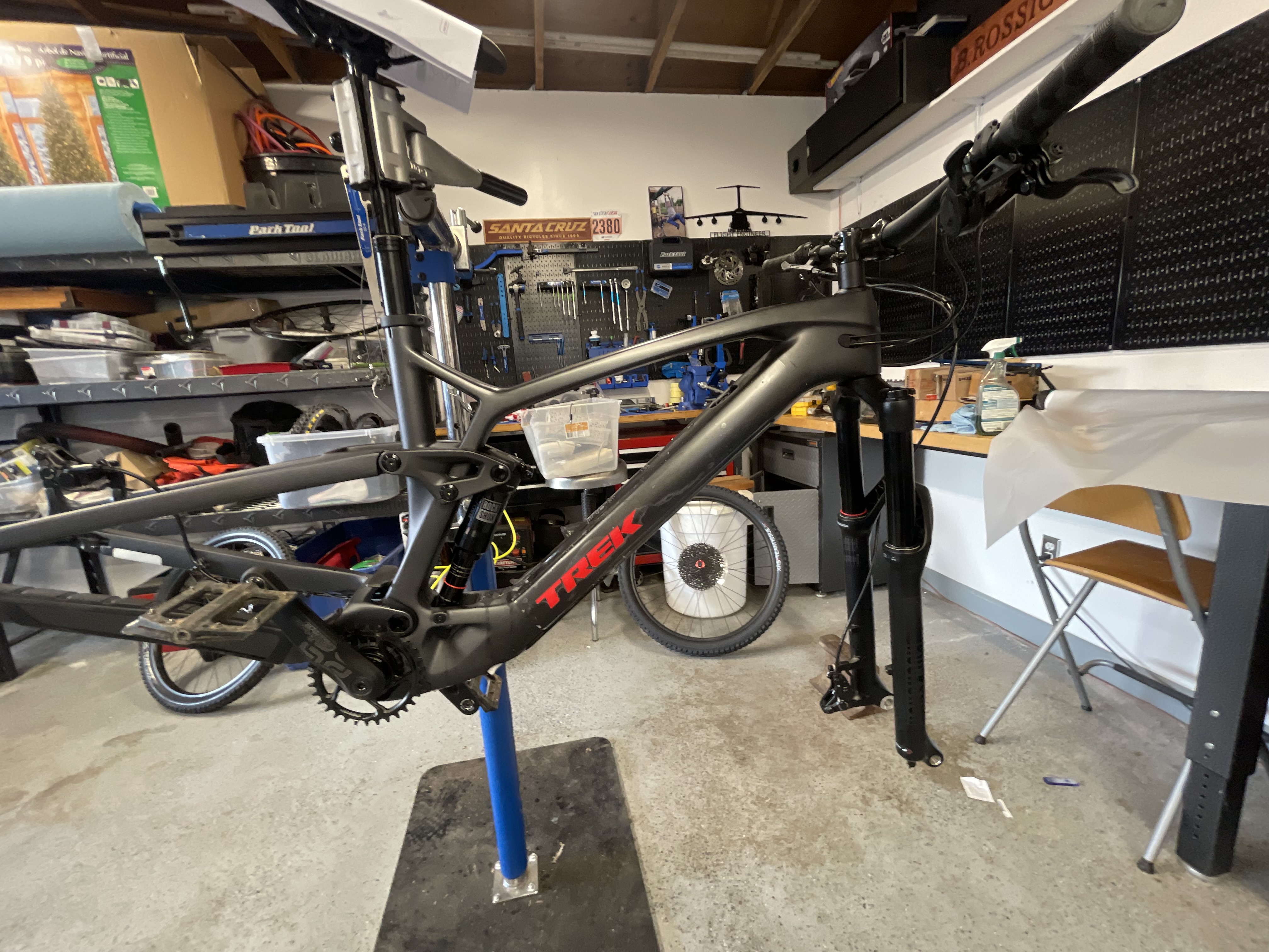

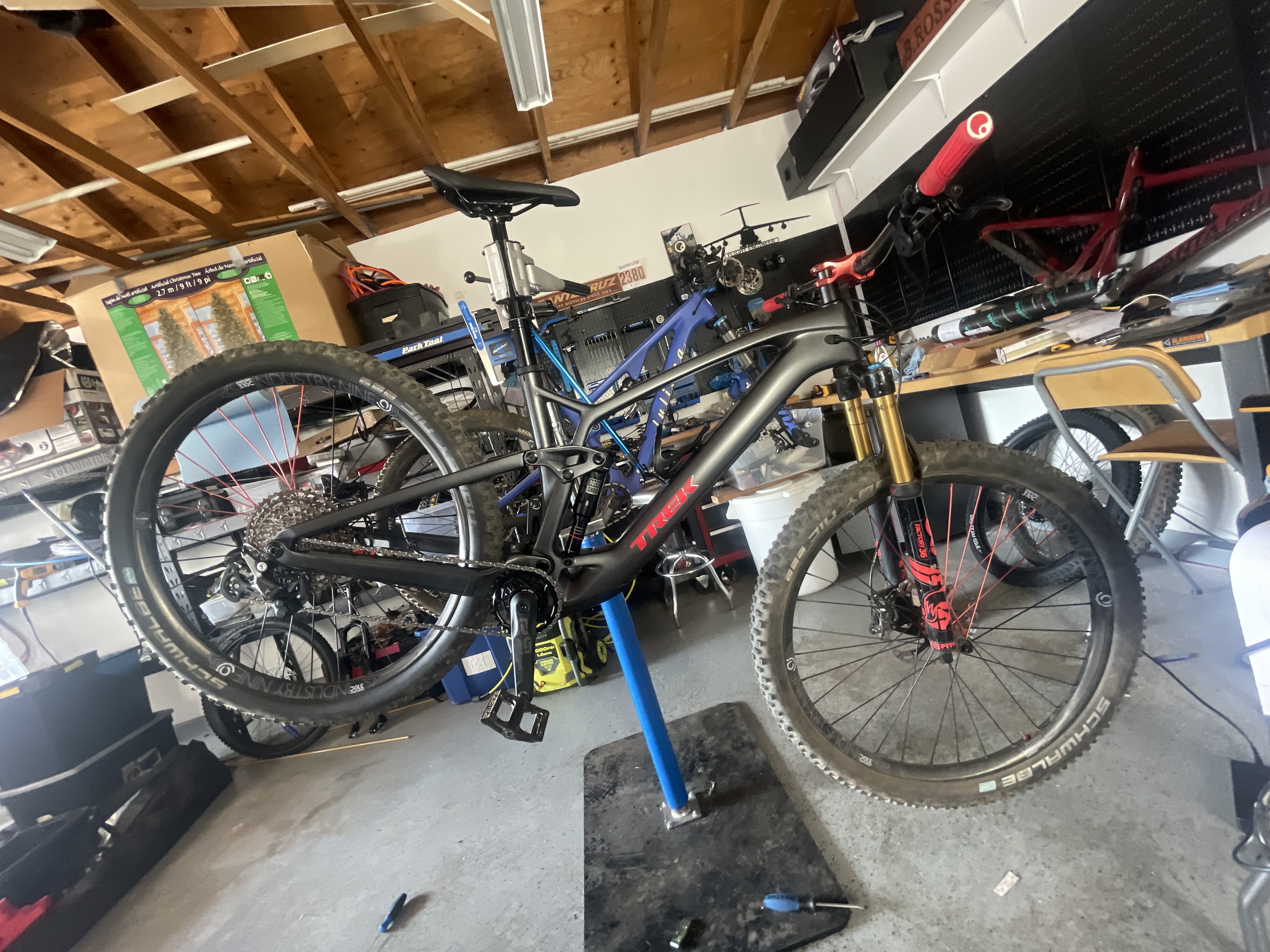

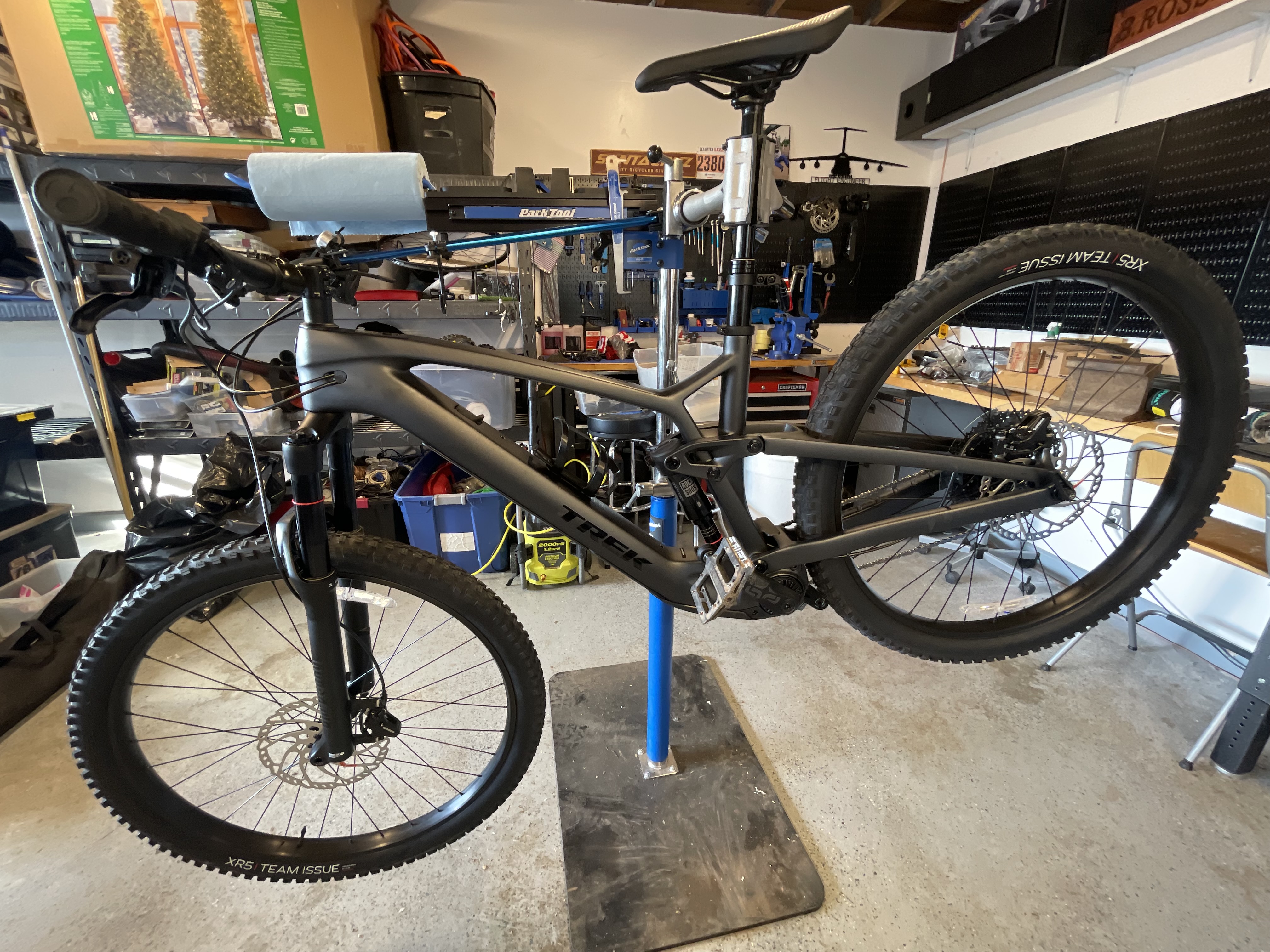

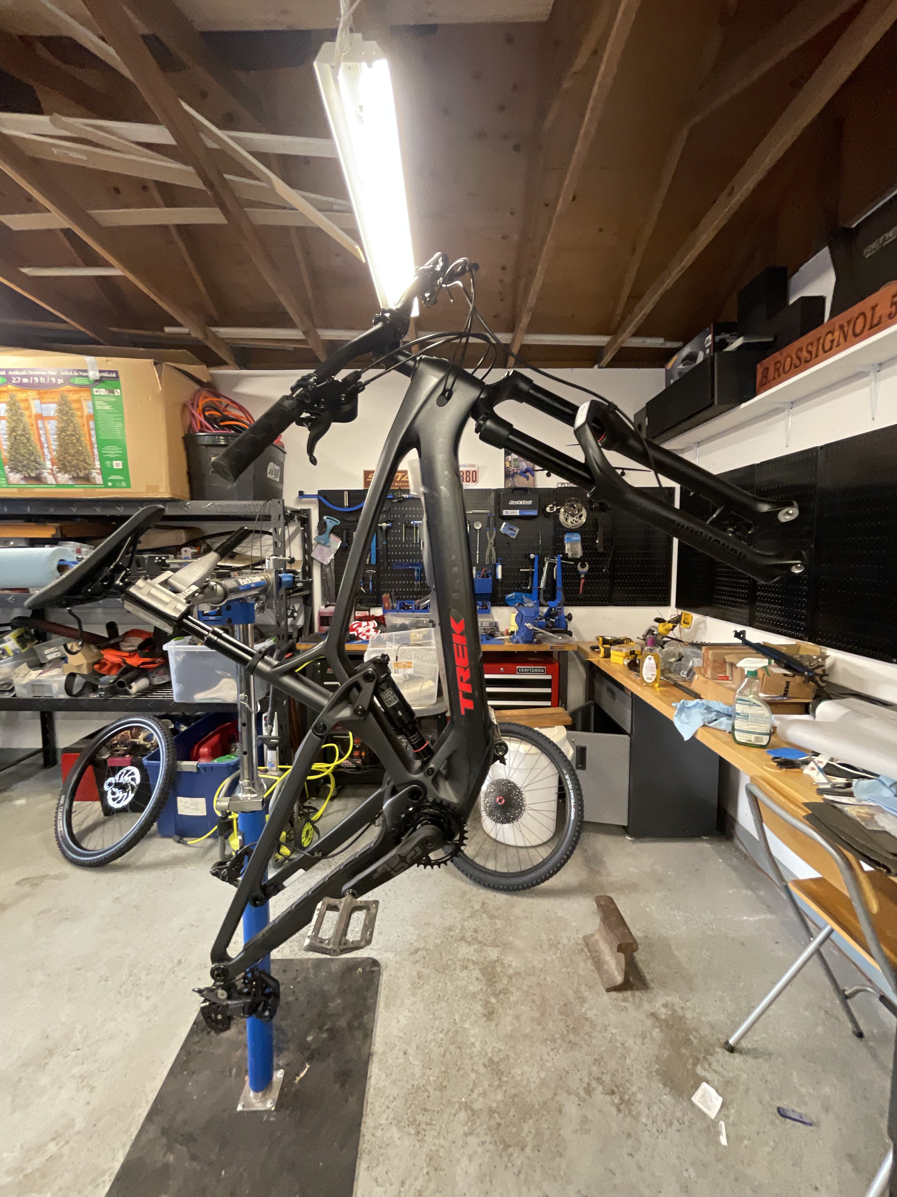

Started my 9.5 build last week. Stealing parts from my Santa Cruz Megatower and Hightower before I sell them.
Upgrades so far:
Invisaframe with color decals
Industry Nine Enduro 310C with Hydra Hubs
Schwalbe Eddy Current Front Super Trail 29 X 2.6 Tire
Schwalbe Eddy Current Rear Super Gravity 29 X 2.6 Tire
SRAM GX AXS (will be changed later)
SRAM Reverb AXS Dropper (Cane creek 31.6 to 34.9 seatpost shim)
Fox 36 with Push ACS3 150mm (will be changed later)
Raceface SixC Carbon Handlebar (will be changed later)
Industry Nine A35 Stem
Ergon GE1 Grips
Shimano XT-8120 4 Piston Front and Rear Brakes
Shimano XT Ice Tech Rotors (203 Front and Rear)
XTR SPD Pedals
ENVE Carbon Bottle Cage
Industry Nine Matchstix thru-axle
Currently installing the TQ Smart Box and AXS Adapter Cable. I need to talk to someone at a Trek to figure out what part I need to connect to the derailleur. Plus I need a firmware update once I plug in the the Smart Box so just a heads up for anyone wanting to do this.
Ergon E-Mountain Core Prime Saddle (delivering this week)
Future Upgrades:
Range Extender (I need to back order it but I already purchased the cable and mount)
Push 11-6 (should release in the next few weeks according to Darren)
Push Fork (product name unknown)
SRAM Transmission (waiting on Wolftooth to make a 34 tooth direct mount chainring or able to purchase the spider)
TyreWiz
Cushcore E-BIKE Inserts (August)
Crank Arms and handlebar (undecided)
I only have have one ride in so far but I was impressed and excited making the transition from analog to digital.

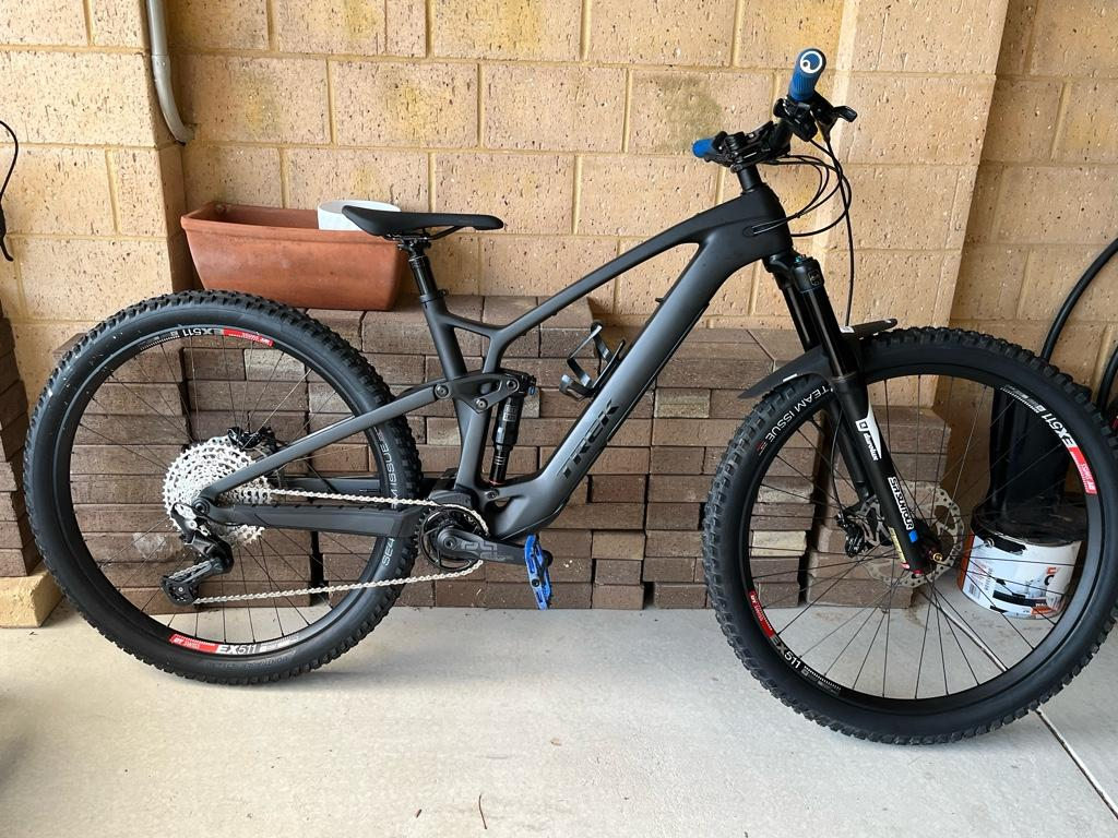

Realised I never posted my build in the 9.5 thread!
I picked mine up as they were heavily discounted here in Australia in June and the dealer near work had a Large in matte black - the best colour IMO.
I moved over the wheels, saddle, forks and cockpit from my Banshee Prime and installed a set of TRP G-Spec DHR brakes I got for a bargain and a Yep Joystick lever.
It rides really well, but I need to work on my cadence to get the most out of it!
Future upgrades are maybe a new saddle and rear shock at some point. Other than that, I'm really happy with it!
