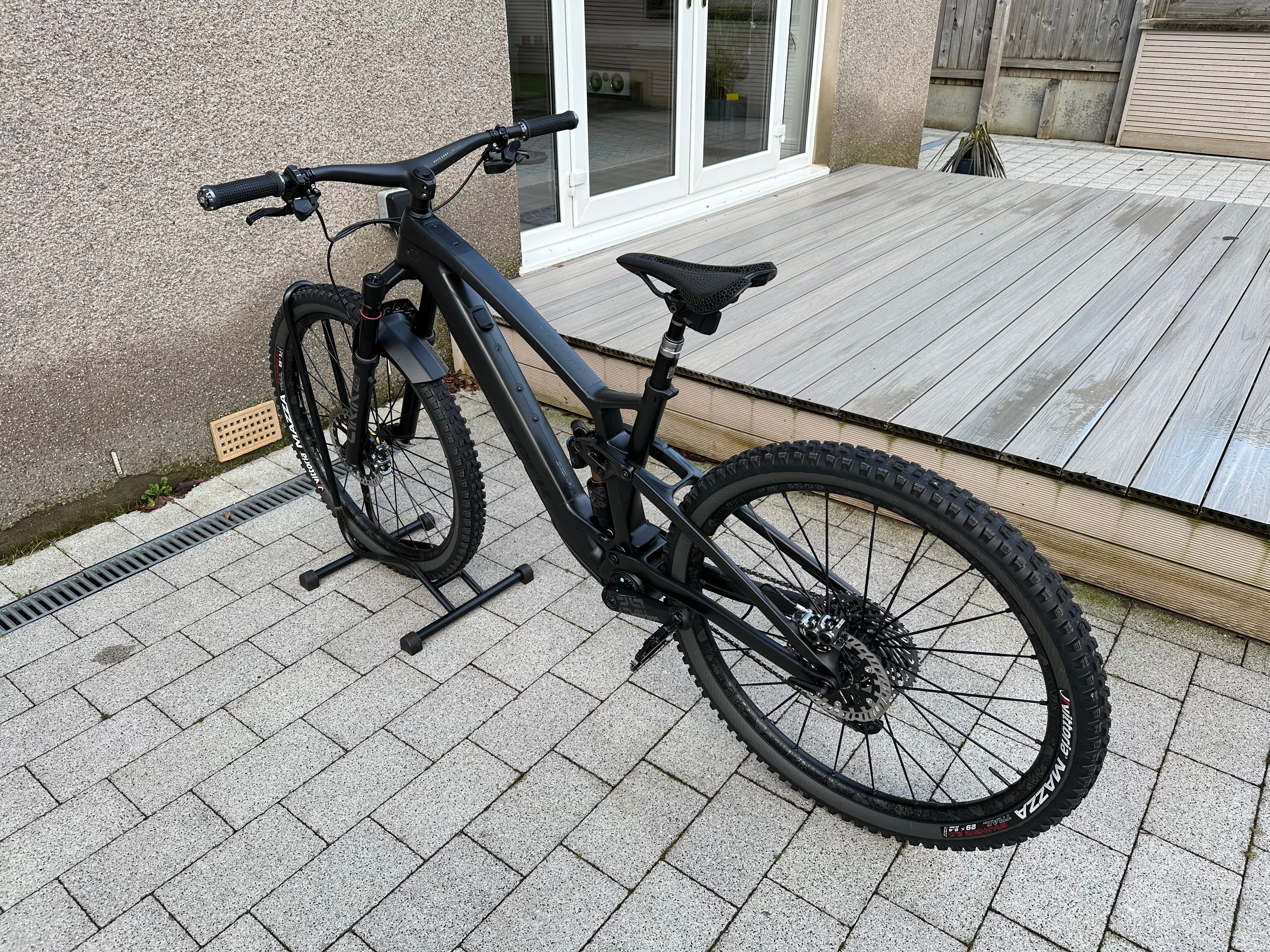

Hello
Purchased 9.5 in October for frame, battery and motor. Had all custom parts ready so converted bike straight away and been using since. Two small changes to do this week in Title seat-post clamp and Intend headset.
Thoughts on bike - Great handling and fun, can't fault once all bolts tightened properly.
TQ motor - Enough power but would like a bit more 10% of the time, you deff need to work harder, knew this would be the case when buying but willing to trade for the silence. Previous bikes had Shimano EP8/EP8 RS and Bosch Gen 4 but would not go back, motor whine not end of world but going downhill...
Range - Could be better will probably get extender for big days out in Alps etc...summertime.
Cheers

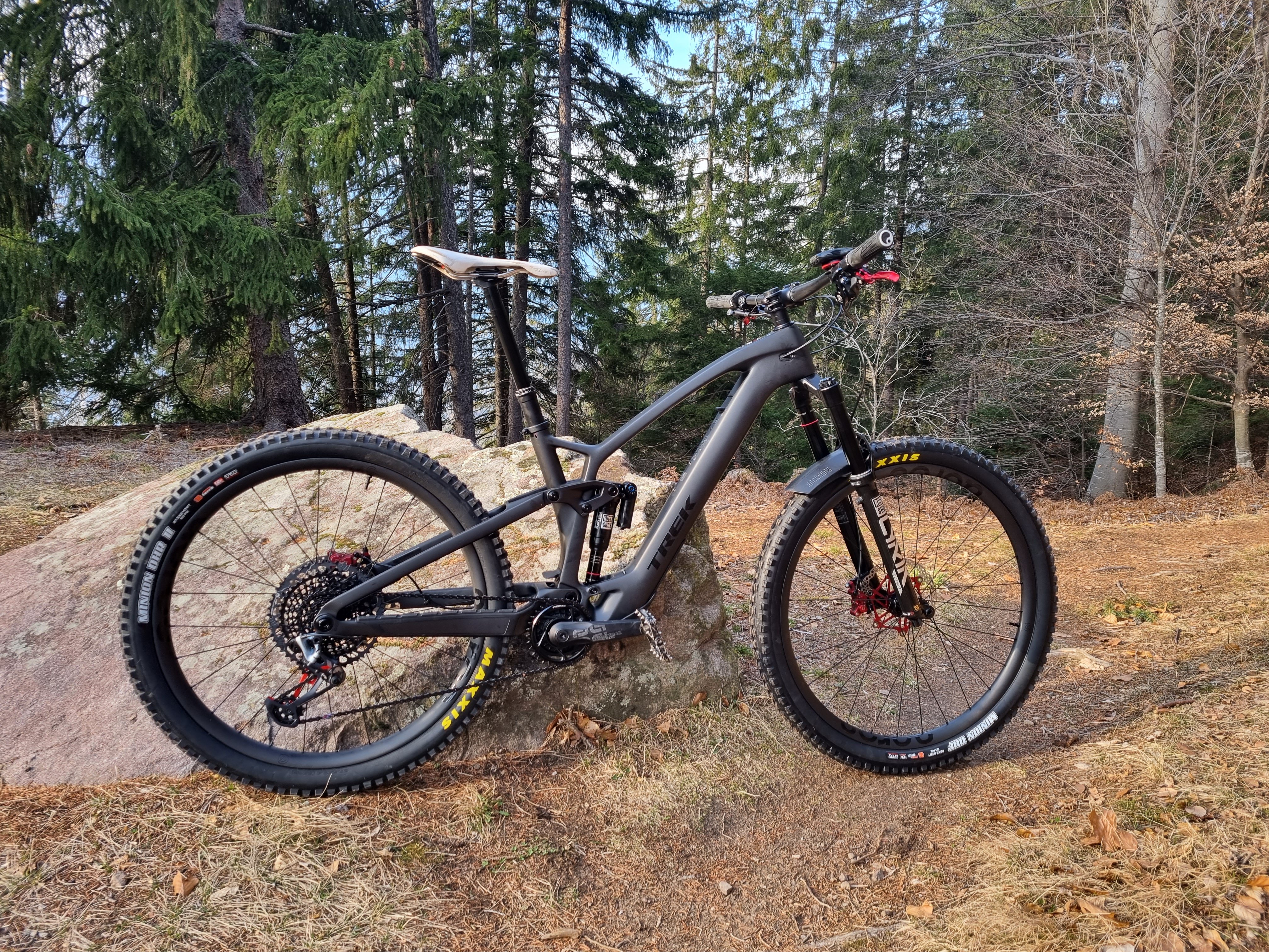

I did more less the same: I ordered a 9.5 because I was just interested in the frame and my updates are as follows:
- Rock Shox Lyrik Ultimate Charger 3 RC2 in 150 mm
- Rock Shox super deluxe Ultimate RC2
- Syntace Vector Carbon Bar and headset
- Full Sram X01 Eagle drivetrain with maybe a small 30T chainring from Raceface or Garbaruk (this will be decided after the first rides if 30T really needed or if I stay with 32T)
- Acros Enduro Carbon rims mullet with Maxxis DHR 2.4 and DHF 2.5
- Kind Shock Lev Integra 200mm dropper post with Selle Italia Flite saddle
- Trickstuff direttissima brakes (I will move them from my actual Liteville 301 MK12)
- Syntace pedals number 9 Titan (also from my existing bike)
So I end up with the same price as a 9.8XT but with the components as I want them and an expected weight of below 18 kg.
Bike is expected to come in the next 2 weeks so by end of march I will show you the final result and givve you my feedback on the riding impressions.

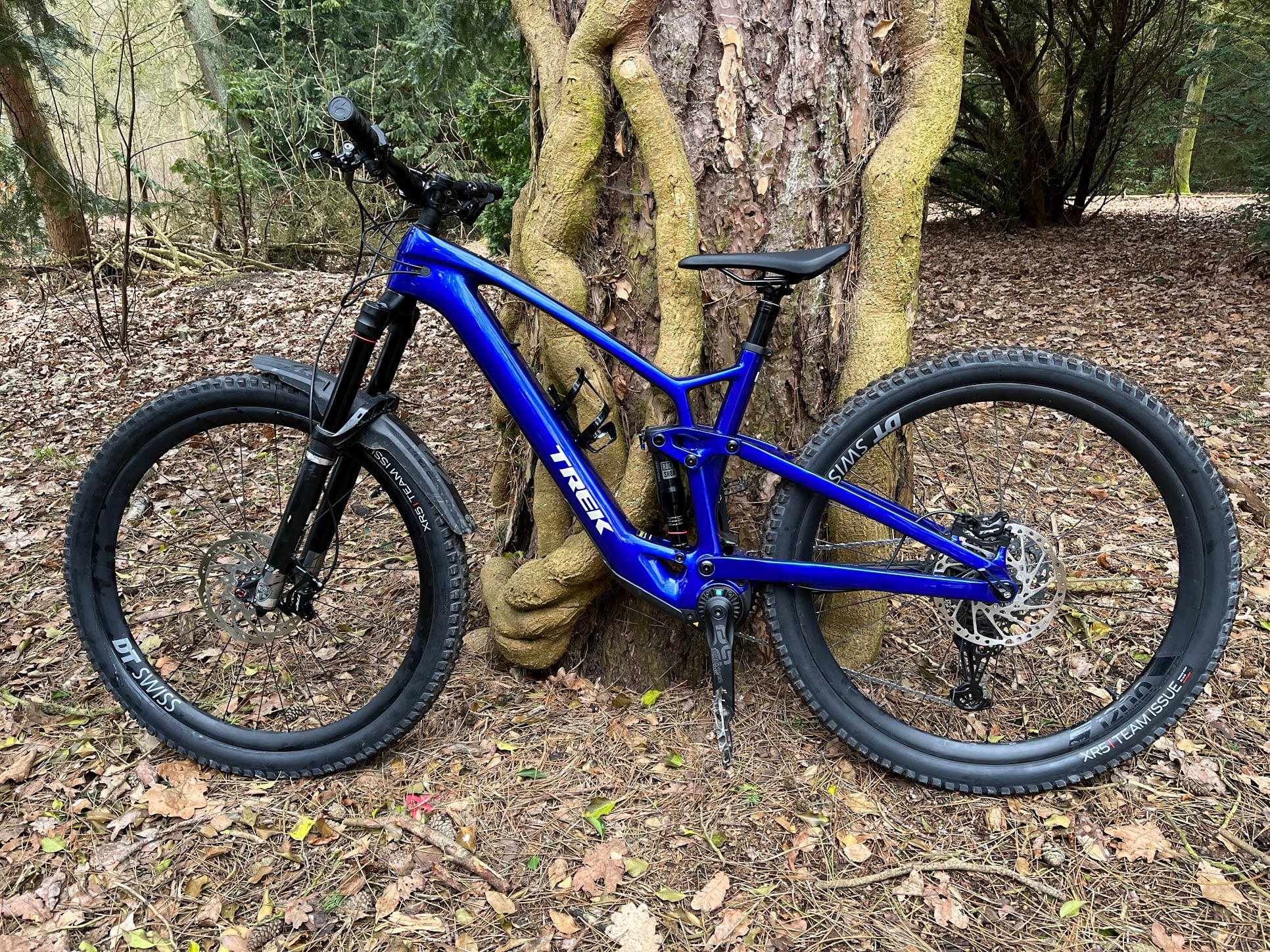

I ordered a 9.5 in the blue. I hope it looks good.
I'll be putting on a Mezzer Pro set to 160mm and a 65mm stroke float X performance I got for almost free and will make the hack to turn it into a float x performance elite.
203mm rotors, xt cassette, xt derailleur, slx shifter, 35mm stem with oneup bar, SLX brakes and a 210mm oneup dropper, DT Swiss XMC 1200 carbon mullet wheels and flip the chip to high and I should be set.
Can't wait for the bike to arrive, parts are ready. Most of the parts I already have, so all in all not an expensive build.

My husband recently got the blue 9.5. It looks great in person and the folks at our LBS thought the color was beautiful too.
The 9.5 model has 2 nice colors. :)
Love this 9.5 thread by the way… giving me many ideas. Maybe too many, lol.

View attachment 104234 View attachment 104326
Hi there, just seen you are glasgow like myself, is that photo from the Braes?
Thanks

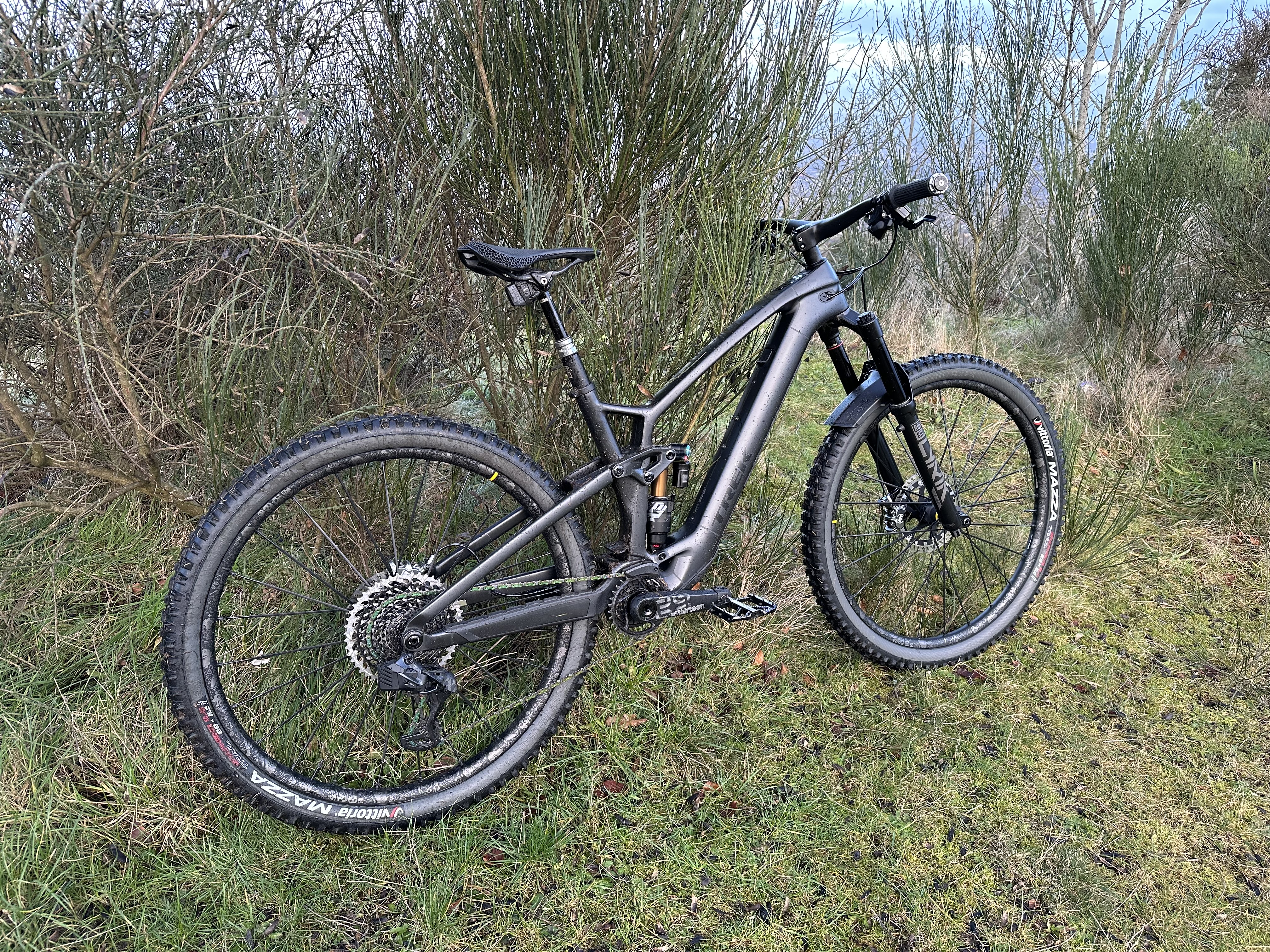

I'm far from done but I have a broken thumb so working on the bike is hard. Took the bike for a short ride today though.
The cables are a birds nest, the dropper is very short, the brake handles will be swapped to shimano, the shock will be swapped, new saddle, new grips, new shifter and different bottle cage coming up.
But so far so good.
