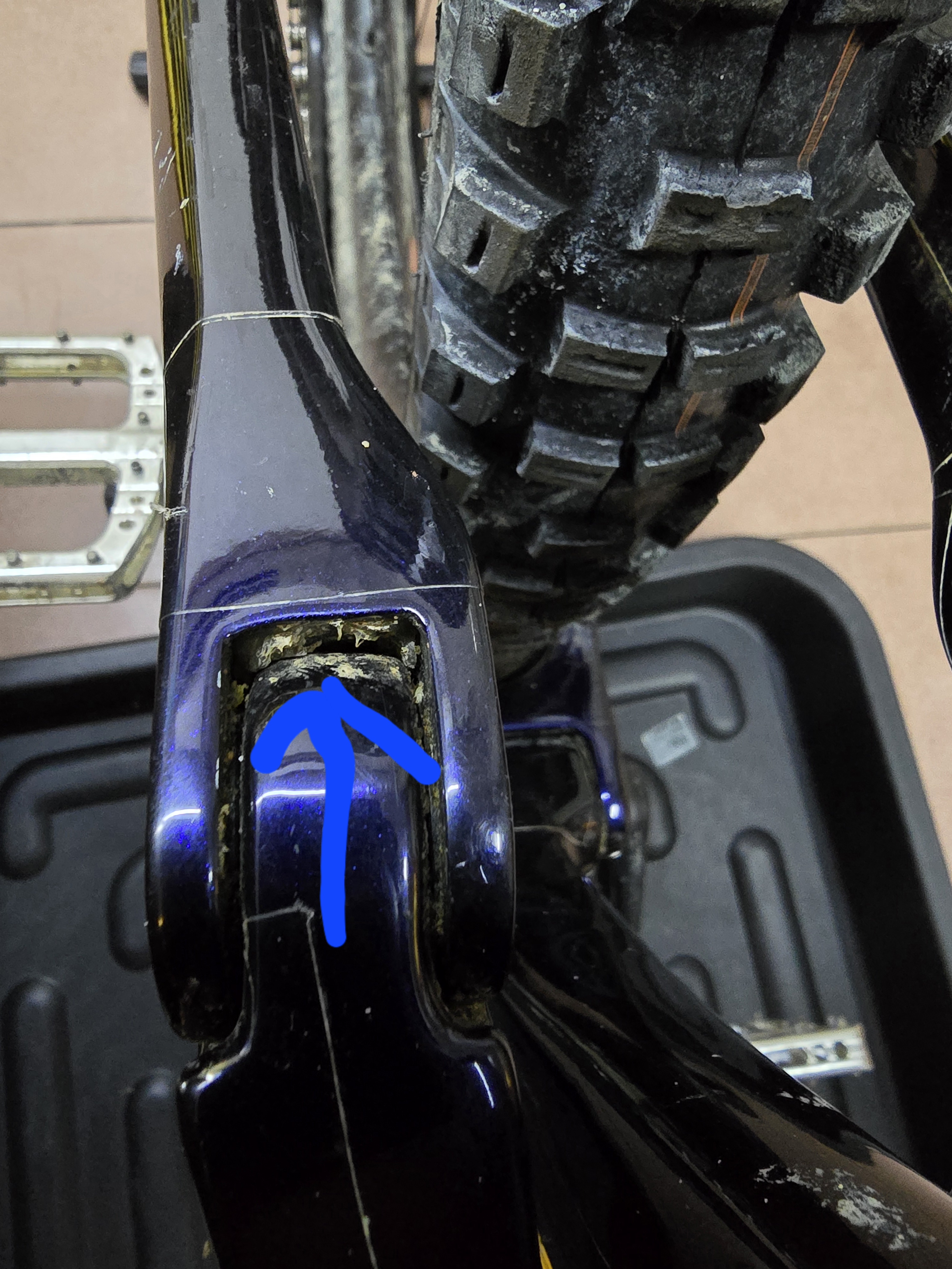

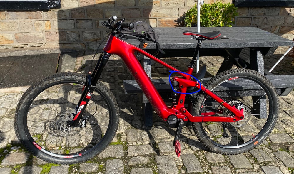

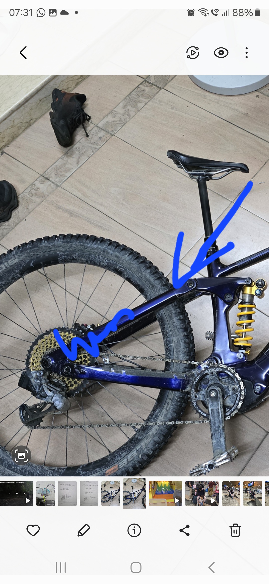

Thanks TCFlowClyde for starting this thread. I built my CEF50 last year as I wanted something lighter than my E10. I just want to share with those who ride in wet weather (or who uses a hose pipe to wash their bike) something I recently discovered, water builds up inside the rear top yoke (as marked in the photo). I discovered it recently when I tipped the frame forward about 45deg when doing some maintenance work on a stand. View attachment 138452
Water enter from here , there is a hole between the linkage , I close it with foam + silicone glue.

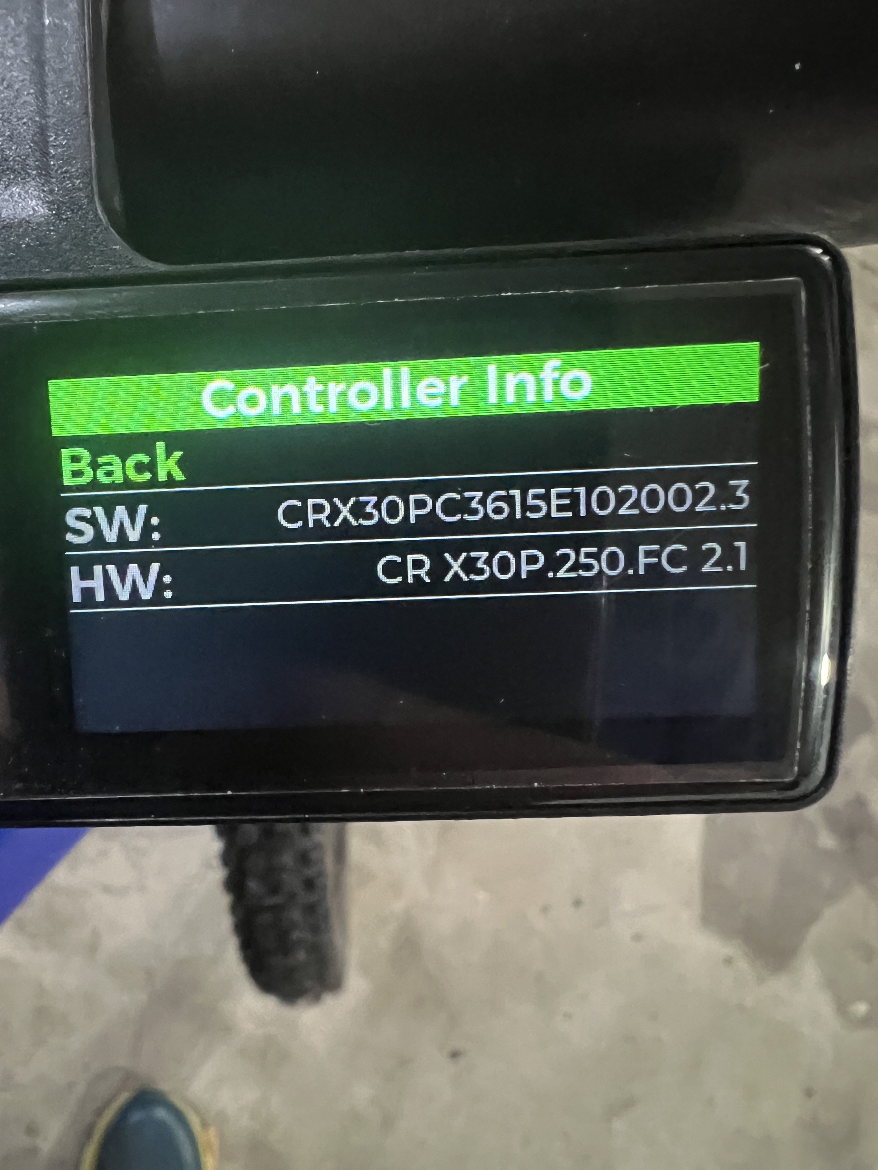

Can anyone tell me whether it is worth buying the Besst tool to tune and update the firmware on the m820? I currently have version CRX30PC3615E102002.3 installed and am trying to figure out if there is much of a performance gain.
You may want it for other reasons like flashing a replacement controller. AliExpress for $100 +/- to have when/if needed. Nice to have on hand. 👍
Herculesridesebikes
Jun 19, 2023
41
23
as far as I could read on the forum, they have some problems only with the 36v system. maybe I will make a 48v battery.
I don't have any major problems with my firmware or battery, I do notice the battery drains quite quickly during rides though I burned through about 70% riding roughly 30km and 2500ft on boost . I have read the 2003.2 FW worked well for a few people that had the 36v system with more power and consumption and thought of trying it. Is there a way to backup your old software when you change it?
i tried that fw. does not recognize the battery. backup cannot be made.

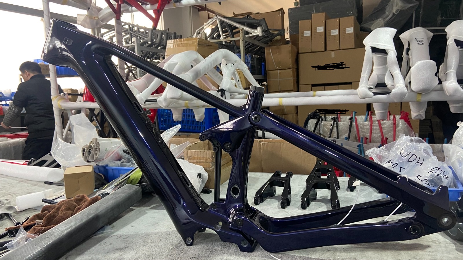

MY frame finally done, New Update CEF50 -V2 with Update Coil shock mount position and Chameleon color

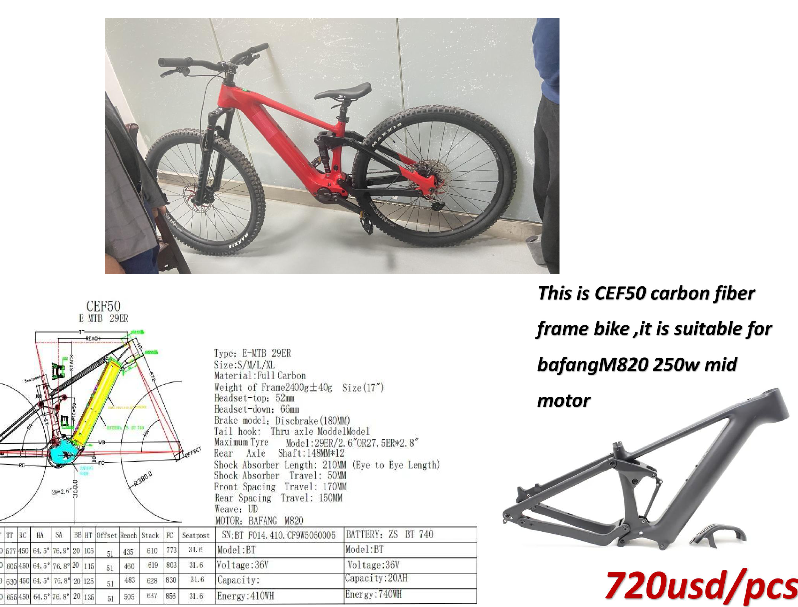

I'm trying to price up a build.
Is there any way of knowing whether the frame from a supplier has clearance for a coil (V2 frame)?
Has anyone figured out whether a 216mm eye-to-eye will fit?
Attached is the picture from the spec sheet I received from the supplier. Company is Changzhou Fieldebikes Co., Ltd.
Many thanks.

Do you know for a fact that the manufacturer is now only supplying a coil compatible frame?
Still would like to know whether a longer length shock would fit. Not concerned about warranty for extra 6mm on a 216mm. Just want to know whether it would physically fit so I can work out an overall budget.
I think 216 will be too long. I put 210 with offset bushing on both sides, about the length of 213 and there is still 2mm space.
everything else you have to try yourself!
Thanks! Why did you need an offset bushing if the frame is built around a 210mm shock?
When you talk about 2mm clearance, do you mean for the rear wheel (as it looks like there is heaps for the shock based on the linkage movement).
Was it a coil by any chance?
I use air shock. 2mm in the length of the shock installation.
offset bushing for the reason that the bike is a mullet and then the bb is too low and the fork angle is 63°. with offset bushing, I got a height of bb approx. 350mm and HA 64-64.5°.
if you need a longer shock and longer stroke, then buy an e82 frame!
Thanks for the info.
While I would prefer a frame designed around a 230mm shock (I have one spare), I am specifically pricing a build under 19kg with the M820 motor and ~500wh to replace my enduro.

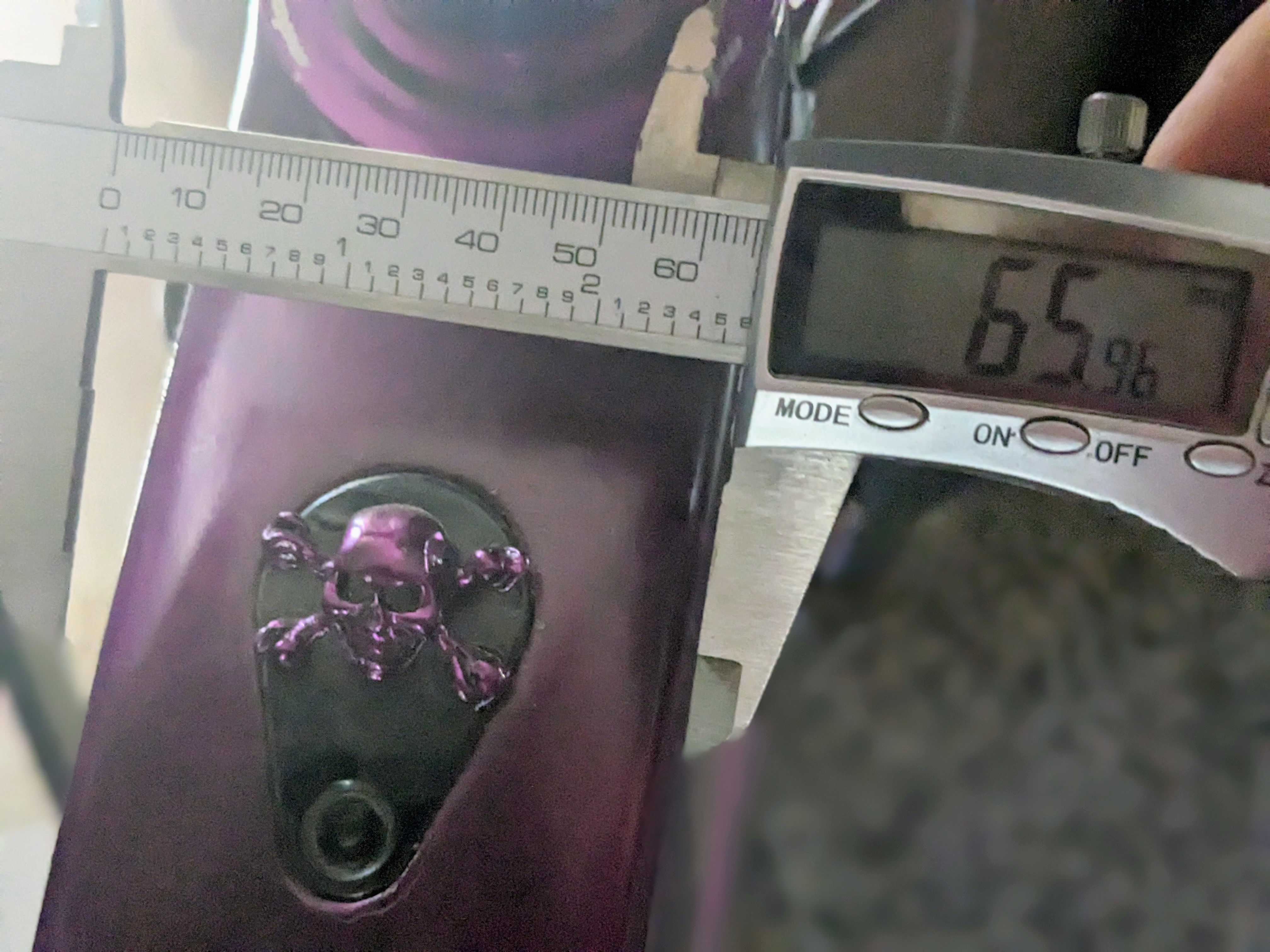

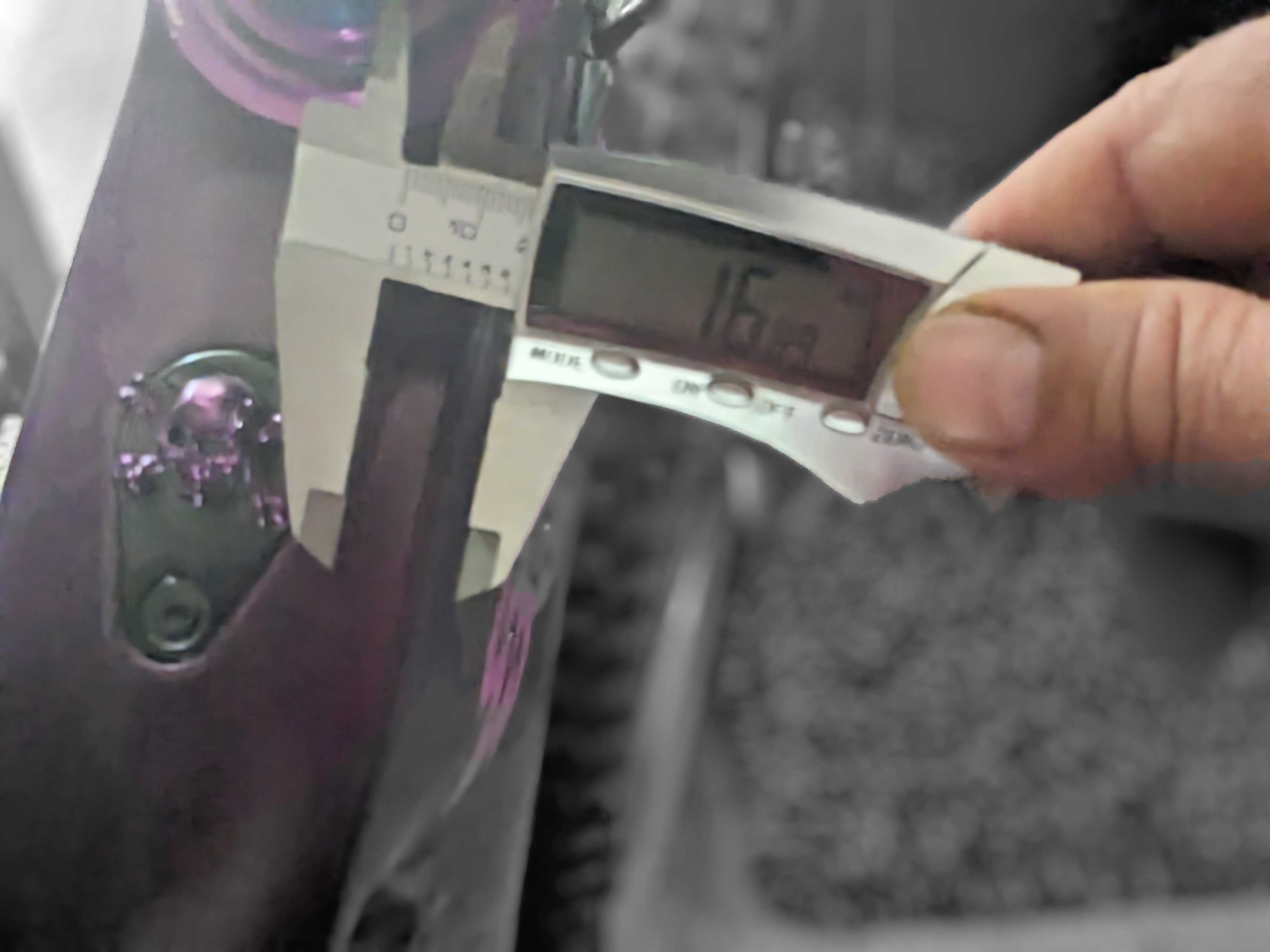

Please, how wide is the top tube between the head tube and power switch opening?
I'm ordering a custom stencil for motivational purposes and will be needing it as large as possible :)
Calipers were touching frame when measured. Just couldn't hold it long enough without jiggling and potentially stratching my paint job for the snapshot...damn auto focus takes forever!🤯😁

Thx bro, I'm gonna call it 65 mil. Enough for a few words of wisdom and what an awesome bike.
