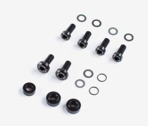

Because I'm that kind of guy, I 've saved the best method for last. This method works every single time and doesn't require you to spend a tedious hour burning your fingertips, losing your mind due to the tediousness of removing the thread locker, prevent you from riding your bike with your mates, or developing an addiction from breathing the chemical fumes......Buy a new set of bolt hardware from Orbea's spare parts catalog. It works like a champ every time.
Linkage Hardware Kit
Motor Mounting Hardware Kit

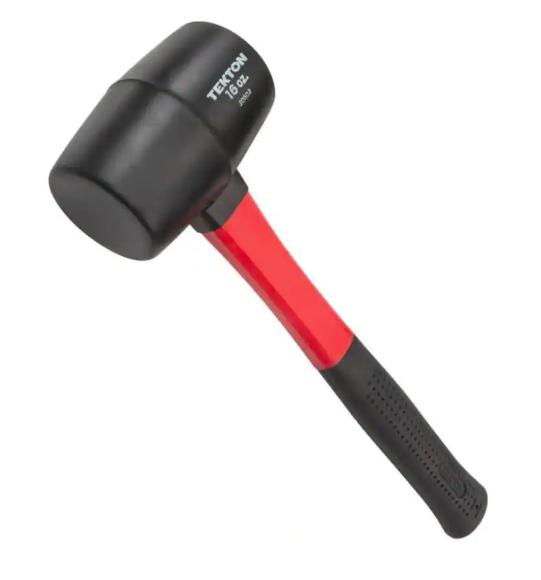

any reason you would not knock them out with a brass drift then tap new ones back in on the carbon model? Pretty sure the local dealer said that is how they would do them...
Tried that, but I just don't trust myself enough taking a hammer to the bike, leading to a limit to how hard I was prepared to tap :). But that was the method used by the mechanic when I asked. He did say he used an actual hammer on the drift, rather than a rubber mallet which was my chosen tool. Perhaps the mallet doesn't generate the necessary shock to dislodge them?

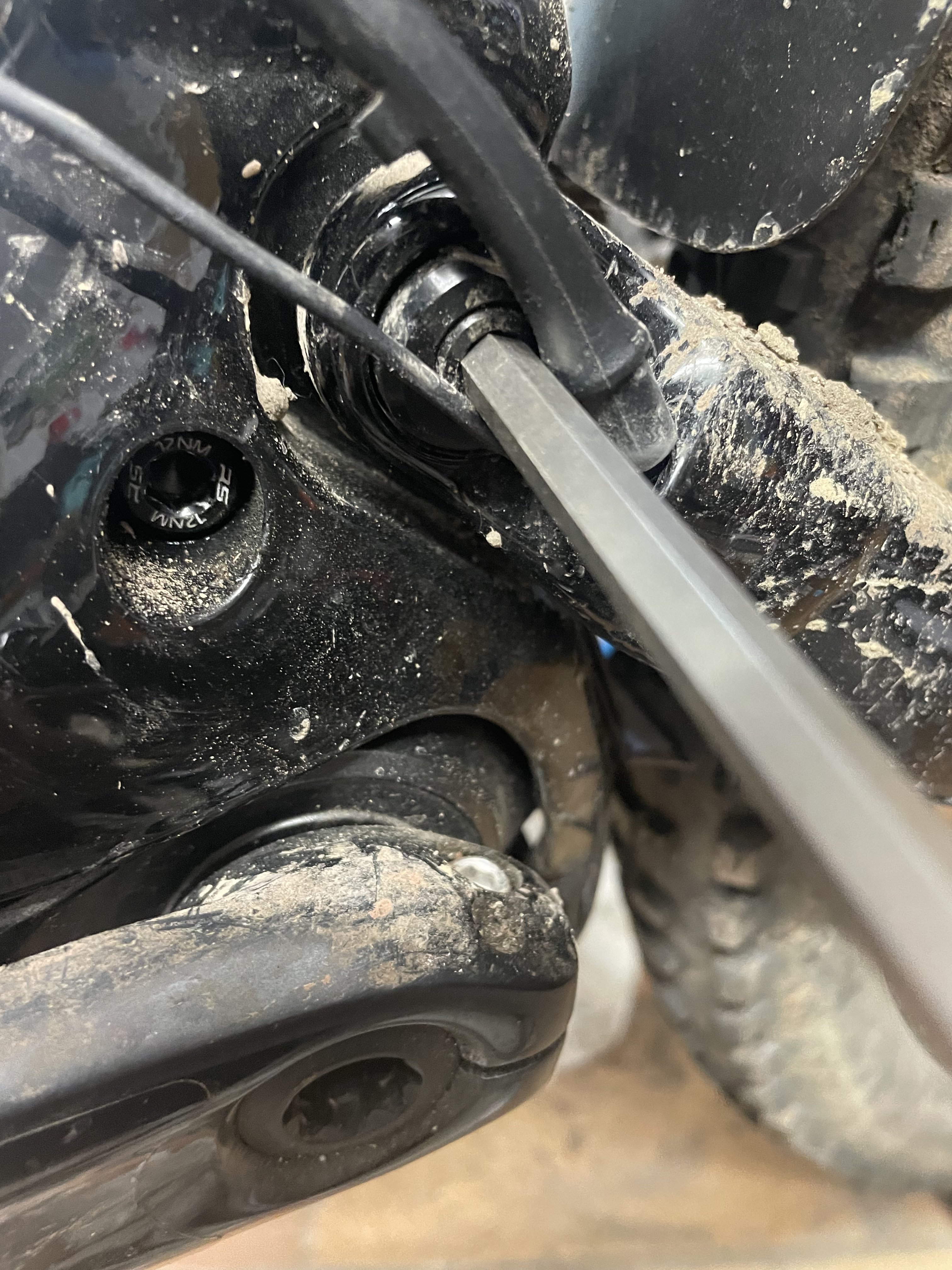

Replaced the bearing that had gone on my linkage pivot yesterday. Was surprisingly hard to remove - the button popped off my power button in the process so I'm guessing there must have been a hell of a twist on the frame when I was hammering at it...
I did work out a good way of removing the levers from the splined axle as if it doesn't come off by hand there's not really anything to tap on. However, a 15mm piece of wooden dowel lets you tap it out from the centre of the lever on the other side. Then a 19mm dowel to removed the axle through the other bearing and the the 15mm dowel again to remove the axle from the second lever once it's off the bike.

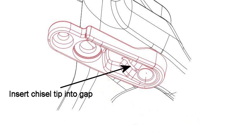

The upper linkage arm attachment is a weak spot on an otherwise fantastic bike. As I've noted in several technical articles, it requires frequent maintenance in order to prevent play developing in the rear triangle and or noise issues developing.
Hopefully the new pivot linkage arm and axle design will prove itself to be a solid design.
Note that the drive side linkage arm does not appear to feature a pinch bolt. The addition of an axle seal is a very welcome improvement.
The non-drive, left side linkage arm does feature a pinch bolt for clamping the arm to the axle. It'll be interesting to view the 2023 Rise Blue Paper, to see how the new design works. More importantly, can it be retrofitted onto the older "M" series Orbea Rise?

With the linkage arm warmed up, I take my soft rubber mallet and strike the end of the linkage arm in a back and forth manner to loosen the bond between the axle and linkage arm. As I tap the arm, my goal is to walk the linkage arm off of the axle splines.
If heating and tapping the linkage arm doesn't work, I take a thin tapered chisel and insert the tip into the gap where the pinch bolt threads into the linkage arm.
I tap the chisel into the gap. My goal is to slowly insert the chisel into the gap and release clamping pressure on the axle. Do not drive the chisel deeply into the gap, you'll ruin the linkage arm. You just want to wedge it firm enough into the gap to slightly spread and release clamping pressure on the axle.
I prefer to use a thin tapered chisel so that I do not mar or mushroom the edges of the gap in the linkage arm. I can be more precise with a thin tapered chisel. If you use a thickly tapered chisel, you will have to really drive it hard into the gap and this will mushroom the edges of the linkage arm. The objective here is to release clamping pressure and avoid marring and rounding over/mushrooming the edges of the linkage arm gap. A flat tipped screwdriver will cause marring due to the small width of the screwdriver blade. Use a thin tapered chisel, it's wide surface area is less likely to cause marring or damage.
Example of a thin tapered mechanics chisel
With the chisel inserted into the gap on the linkage arm and applying pressure to the gap, I once again apply heat and use my soft rubber mallet to tap and release the linkage arm from the axle. This method works.
As a side note, I've not had to use the chisel method once I began channeling my inner Bob Ross and I began to sparingly apply the 638. You live and you learn.....
