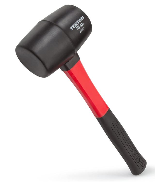

4. Use the soft rubber mallet to tap the axle completely out of the frame mounted pivot bearings. I like to use a combination of taping the axle and tapping the linkage arm. Do not use anything hard, i.e. metal to drive the axle out of the pivot bearings. The aluminum pivot axle is soft and will warp if struck with something hard.

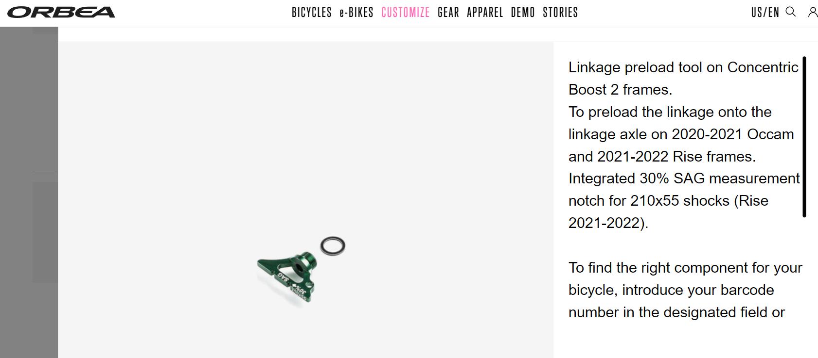

Dan or anybody else interested,
You can purchase a pre-load tool on Orbea's website. Shipping is slightly more due to the parts being shipped from Spain on DHL. It's been my experience that it usually takes two to three weeks to receive parts from Orbea, this includes usually about a week to just process the order.
I would encourage you to purchase Rise wear items along with the tool. I will list below several items which I've found to wear fairly quickly, especially if you ride your Rise three to four times a week. Buying everything all at once will save on additional future shipping costs or possibly having to wait for additional parts when you need them right now.

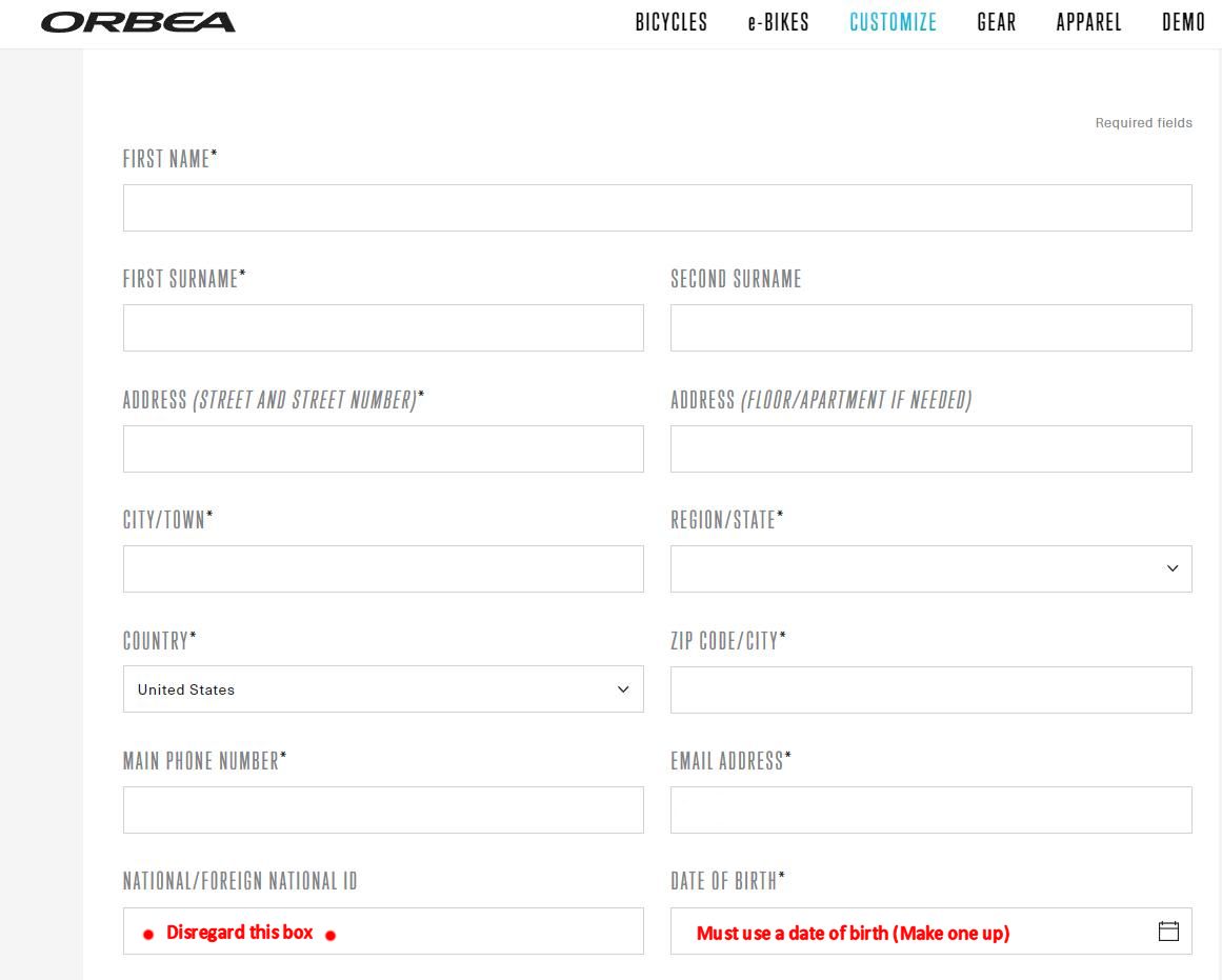

1) Once on Orbea's "USA" website, you will need to open an account/Register in order to purchase parts. Orbea's web format is not user friendly. With a little patience it's eventually easy to figure out. Note that Orbea has multiple websites for various continents/countries. Make sure you are on the Orbea USA website and not another country's website. If you are on an incorrect website, you will not be able to order parts.
To confirm you are on the correct website, check to see if US/EN is listed in the upper far right corner. If you don't see US/EN, click on US/EN and it will take you to a drop down menu which will allow you to select America as the continent and United States the country.
Orbea USA web page picture
Orbea Great Britain web page picture
2) In you have not registered your Rise or opened an account, you can do so by clicking on the person icon located on the right side of the upper header bar.
When you register/open an account, you will be asked for your national ID and Date of Birth. I think this might be a Euro thing. I leave the National ID blank and list a fictitious date of birth. Note that when you do purchase parts, you will also encounter a similar box titled "National/Foreign ID." You can leave this box blank and the order will still process. The order will not process without a date of birth listed.

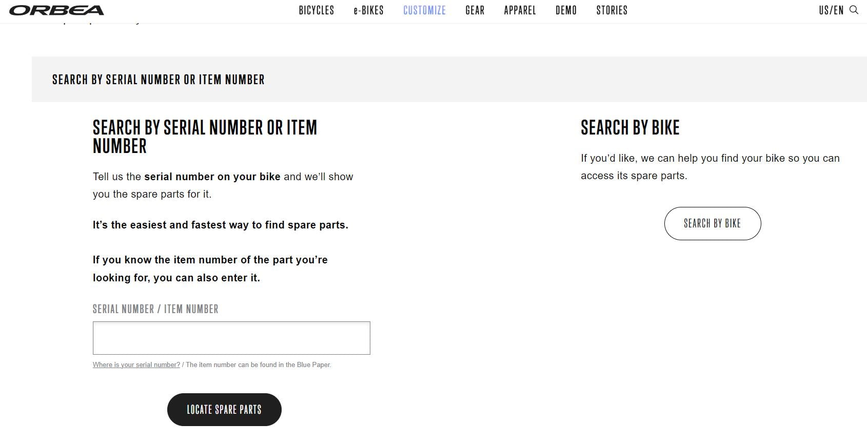

3) To purchase parts, click on the opening webpage, upper header bar word "Gear." When Gear opens up, click on "Spare Parts." When "Spare Parts" page opens up, you have two ways of searching for Rise parts. On the left side of the webpage you can search for parts specific to the Rise by inputting your Rise's frame serial number. On the right side of the page your can search by bicycle model, i.e. Rise, Rallon, etc.

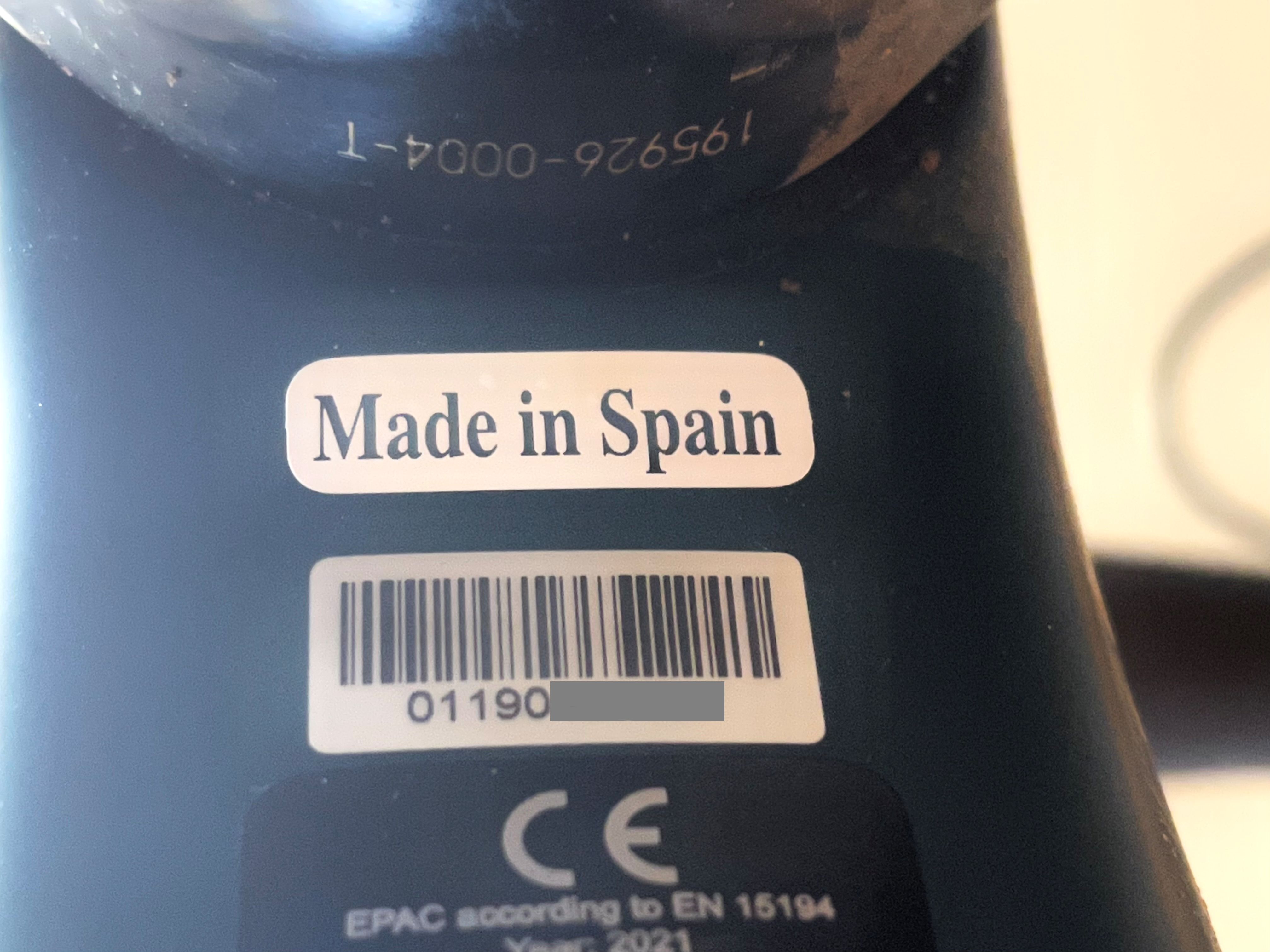

I recommend searching for parts by serial number. This avoids purchasing parts for the wrong model, i.e. Hydro, Carbon, Rallon, Occam, etc.
You can find your Rise's 11 digit serial number located on the bottom side of the down tube near where the head tube and down tube meet.
4) There are two Rise "Pre-load" tools offered in the Spare Parts inventory. There is a "Green" colored pre-load tool and a "Purple" pre-load tool.
The green pre-load tool is used on Rises which came with a 210mm x 55mm rear shock.
The purple pre-load tool is used on Rises which came with a 210mm x 50mm rear shock.
My Rise came from the factory with a 210mm x 55mm shock, yet I also received a "Purple" colored pre-load tool. I believe you can use either pre-load tool to set the pre-load adjustment. The fiber washer itself sets the pre-load tolerance and I believe it's the same for either color.
The pre-load tool is also used as a rear shock, sag gauge. If you plan to use the pre-load tool to set sag on your rear shock, you will need the correct colored tool.

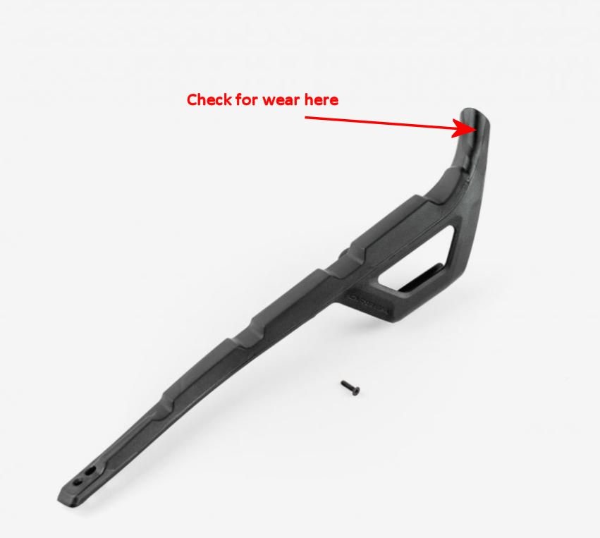

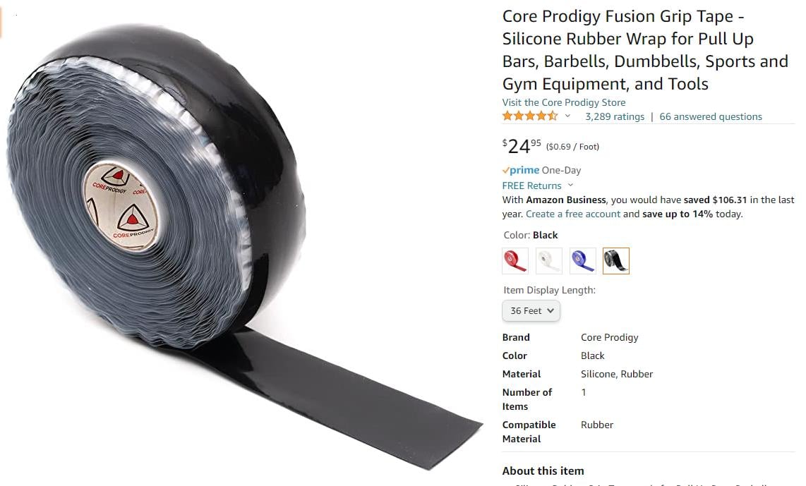

The black rubber chain stay guard on the Rise tends to wear out rapidly. If you are running the standard 32T chain ring that comes with your Rise, the chain tends to rub on the chain stay guard, near the upper end of the chain stay by the chain ring. If the wear is allowed to continue, the chain will eventually eat into the actual chain stay itself. Keep a close eye on the rubber guard.
Note: I've used silicon tape to wrap several turns of the tape around the chain stay and guard at the rub site. The tape doesn't look pretty, but it's very effective against preventing further rub through.

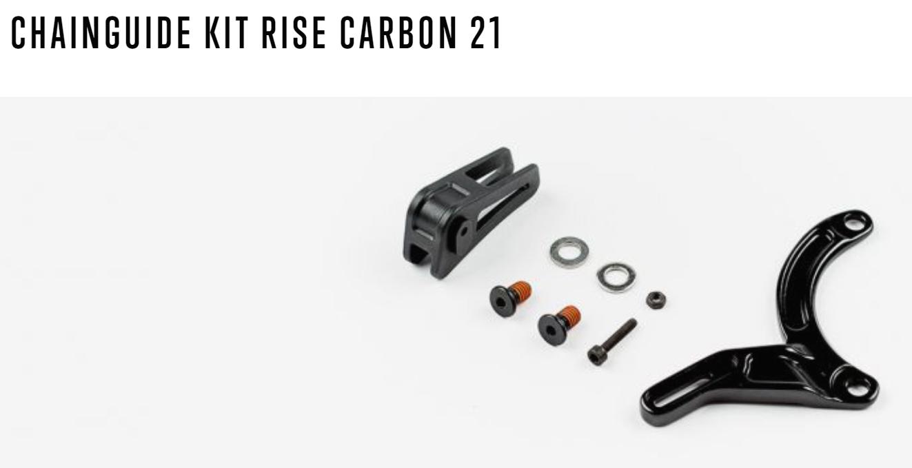

b) Another high wear item is the black rubber head on the chain guide. After about a thousand miles or so, the arms on the black rubber head will become paper thin and no longer offer enough guide protection. Keep in mind, an eBike motor is powerful and if for whatever reason you do happen to drop a chain, especially while hammering it in boost mode, that chain is going to act like a chain saw and cause a lot of damage to the frame. Make sure the chain guide height is adjusted correctly and have a spare on hand for when it does begin to wear out.

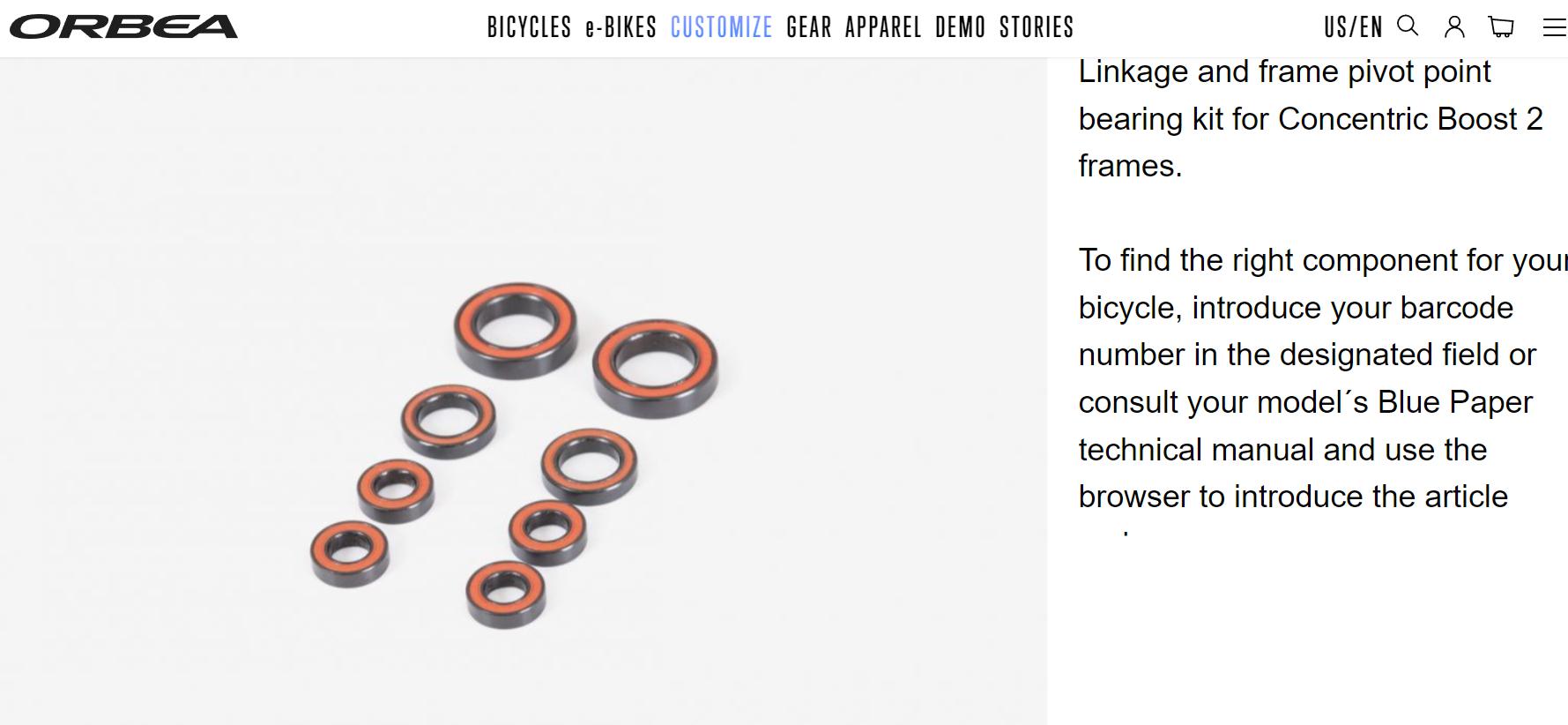

c) Lastly, let's talk pivot bearings. How long the bearings will last on your Rise is dependent upon many things, such as rider weight, terrain the bike is ridden upon, how often the bike is ridden and weather conditions. Orange County California, which is where I'm from, is dryer than a popcorn fart in the summer time. The trails feature soil the consistency of concrete, which has been sprinkled over with about an inch of fine talcum power dirt. My linkage arm bearings lasted 2,800 miles, whereas my upper and lower pivot axle bearings which are unprotected on the Rise, lasted 1,500 miles. I gave up replacing the rear axle chain stay bearings. Orbea's milling for the bearing bores is so poor, the bearings themselves never worked correctly even when the bike was new.
The Rise Blue Paper lists the bearing sizes needed for the upper and lower pivot axles, linkage arms and rear axle. You can source these individually on the internet or you can buy a complete set from Orbea for $42.
I would not make a single purchase of bearings from Orbea. The cost of shipping does not make it practical. It's cheaper to source bearings individually on Amazon, eBay, or Jenson USA, etc. However, as a whole group parts purchase, the cost of $42 for an entire set of suspension bearings makes it a good deal.

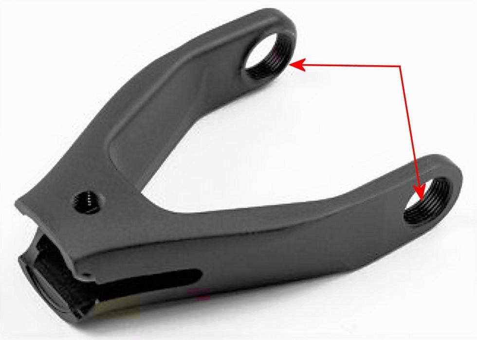

The Rise Blue Paper for both models (Years 21/2022 & 2023) show that the upper axle pivot bearings have stayed the same (Enduro 6804). Therefore it may be possible to do the conversion. To have a better idea, we need to know if the design of the chain stay arm where it mounts to the linkage assembly has been changed. Lastly we need to know if the 2023 Rise frame width at the upper axle bearing mount is the same or has it been widened or narrowed?

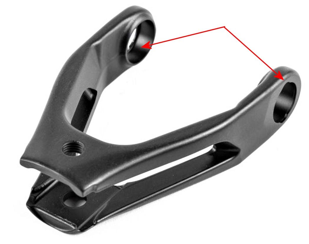

The one glaring difference between the old and new Rise is the shock yoke, it has been changed quite a bit in design. I have not seen a 2023 Rise Carbon in person so the following is an absolute guess, If the 2023 Rise Carbon chain stays have not been changed and the frame have not been narrowed or widened at the upper axle mount, then a conversion is possible.
Note, to affect a conversion of the older model Rise carbon, you would need to purchase a shock yoke, linkage arm/axle assembly, left linkage arm, linkage hardware kit, upper axle seal kit, shock mount bolt kit and the axle trail tool.
Lastly, Orbea is not currently offering the 2023 linkage arm/axle assembly. It is listed as "Unavailable" on Orbea's website. One wonders if the unavailability is done on purpose. If the assembly was to be made available and the conversion possible, then many people would likely do it and not feel the need to purchase a new Rise.
2021-2022 Rise Carbon Shock Yoke Assembly
2023 Rise Carbon Shock Yoke Assembly

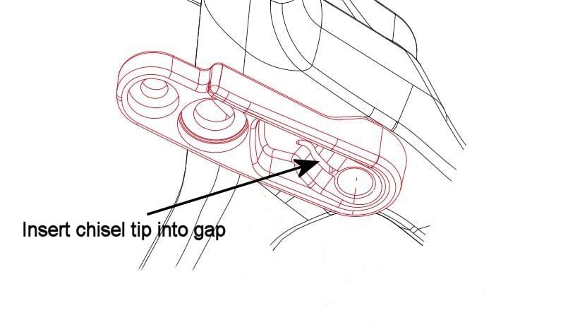

It depends on how much 638 was used. If the 638 was applied sparingly, you can usually take a soft rubber mallet and tap the outer end of the drive side linkage arm back and forth. This should be sufficient to break the bond of the 638 and walk the linkage arm off of the axle.
I never separate the non drive (Left) linkage arm from the axle. I instead remove the axle and left linkage arm as a one piece unit. Unless you plan to replace the upper axle and or, the left linkage arm, then leave the two pieces attached permanently.
However.............que the theme song from Jaws..... if the 638 has been heavily applied, you will need to do a few additional steps to break the bond.
Application Definition
Light Application:
You think of yourself as a self made Bob Ross. With a few small drops applied to the axle splines, you spread the 638 around with your fingertips to form a very light coating on the splined interface of the axle and linkage arm. While doing the finger painting, you think of pretty trails and trees.
Heavy Application: You drenched the axle and linkage arm splines thinking to yourself, 'A few drops is for pussies, I say go big. Let's really drench it, I don't want this sucker to ever come off.' Note: I've used the heavy application method and it works....
Okay, so you went big........and really applied the 638.
Remove all the hardware from the right and left linkage arms. Remove the pinch bolt from the drive side (Right) linkage arm. Take a blow dryer and really heat up the linkage arm in the area of the axle. I do this to soften the 638 and make it more pliable. I prefer to use a blow dryer because it won't develop enough heat to damage the frame, paint, bearing etc.
With the linkage arm warmed up, I take my soft rubber mallet and strike the end of the linkage arm in a back and forth manner to loosen the bond between the axle and linkage arm. As I tap the arm, my goal is to walk the linkage arm off of the axle splines.
If heating and tapping the linkage arm doesn't work, I take a thin tapered chisel and insert the tip into the gap where the pinch bolt threads into the linkage arm. I tap the chisel into the gap. My goal is to slowly insert the chisel into the gap and release clamping pressure on the axle. Do not drive the chisel deeply into the gap, you'll ruin the linkage arm. You just want to wedge it firm enough into the gap to slightly spread and release clamping pressure on the axle.
I prefer to use a then tapered chisel so that I do not mar or mushroom the edges of the gap in the linkage arm. I can be more precise with a thin tapered chisel. If you use a thick, wide tapered chisel, you will have to really drive it hard into the gap. This in turn will mar and round over/mushroom the edges of the linkage arm gap. A flat tipped screwdriver will also cause marring. The width/surface area of the screwdriver is too small. Use a thin tapered chisel, it's wide surface area is less likely to cause marring or damage.
With the chisel inserted into the gap on the linkage arm, I once again apply head and use my soft rubber mallet to release the linkage arm from the axle. This method works.
As a side note, I've not had to use the chisel method once I began channeling my inner Bob Ross and sparingly applied the 638. You live and you learn.....
