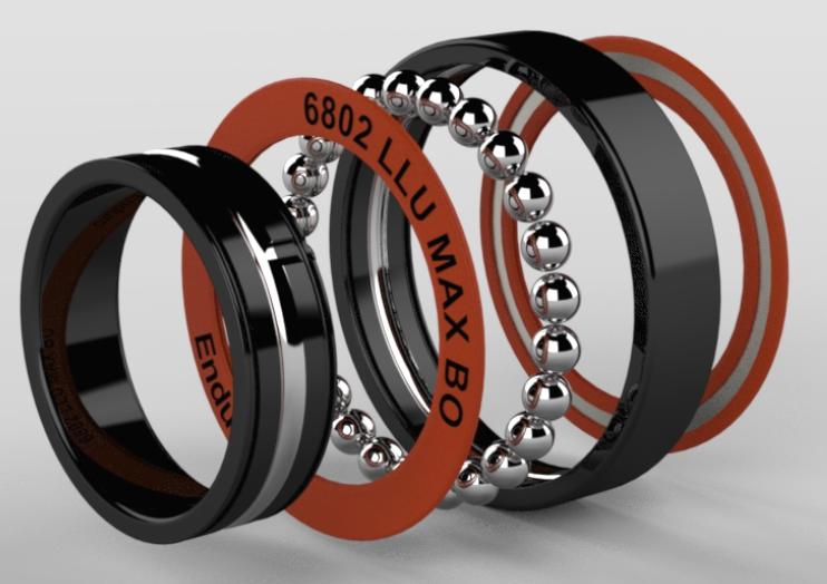

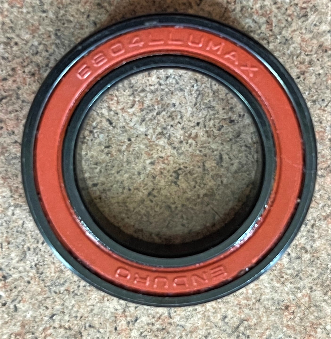

Bearings used on the Rise are manufactured by Enduro. They have a black oxide finish which inhibits corrosion. The Enduro bearings on the Rise are a "LLU" and "Max" design.

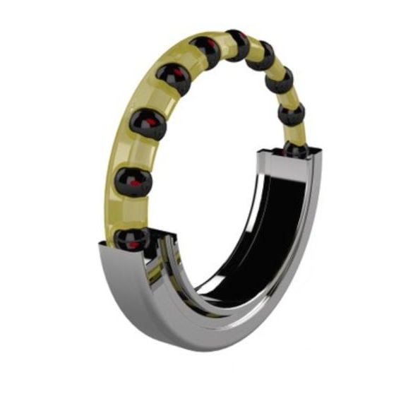

"LLU" indicates a bearing that has a full contact, dual lip seal, which rides in a groove on the inner race. This type of seal is good at keeping contaminants out of the bearing.
"Max" is a term used by Enduro. It refers to the absence of an inner bearing retainer. By removing the bearing retainer, Enduro is able to pack the Maximum amount of ball bearings into the bearing.
Cross section of a typical bearing with inner nylon bearing retainer
Cross section of Enduro LLU Max bearing. Note the absence of the nylon retainer

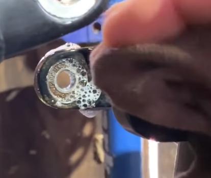

Because the pivot bearings are mounted in the frame and linkage arm, you will only have access to one side of the bearing. I like to use a spray cleaner to forcibly clean and dissolve the old grease from the bearing. I've found Maxima chain cleaner works well to dissolve old bearing grease. It's safe to use on rubber, metal and carbon fiber components. If you don't have access to a spray detergent cleaner, WD40 also works well at dissolving grease.

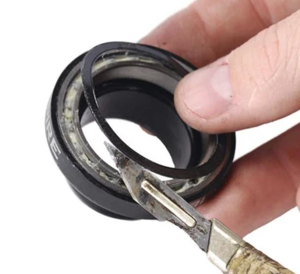

Seal Removal:
After you have cleaned the exterior of the bearing, linkage arm and frame. You will need to remove the bearing's outer rubber seal. I use a hobby knife like what's pictured below. Any razor or thin blade will work. You want to be careful and not cut or bend the seal during the removal process. To remove the seal, insert the tip of the razor slightly between the outer bearing race and the edge of the seal. Gently pry up. You may have to free up the seal in several places to get it to pop up.
The rubber seal on cartridge bearings has an inner and outer side. The inner side of the seal which faces the ball bearings, will have an exposed metal grove to accommodate the bearings. The picture below depicts the inner side of a bearing seal with the groove.

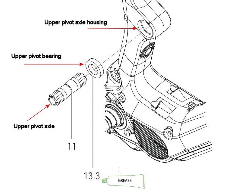

Orbea Rise diagram showing the upper axle pivot linkage, areas requiring grease, and hardware torque settings

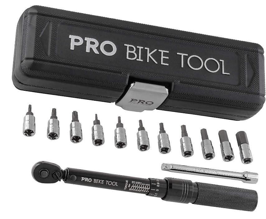

The Rise linkage screws can easily be deformed or scratched. Because of this, I like to use hex sockets to remove and install the linkage. I find they tend to cause less damage than a "T" handle hex wrench.
If you don't own a torque wrench, consider buying one. Without a torque wrench, it's very easy to over or under tighten a bolt, or possibly damage a carbon fiber frame by over tightening a bolt.
When shopping for a torque wrench, buy a torque wrench which reads in Newton Meters. Bike specs are typically listed in Newton Meters. Lastly, buy a torque wrench that has a low torque range i.e. 1 to 20 N.m. A torque wrench which reads 1 to 200 N.m. won't be as accurate at the lower torque settings used on bicycles, i.e. 4 or 6 N.m.
Pro Bike Tool on Amazon has a nice 1-20 Nm, 1/4" drive torque wrench that comes with hex and Torx sockets for $75.

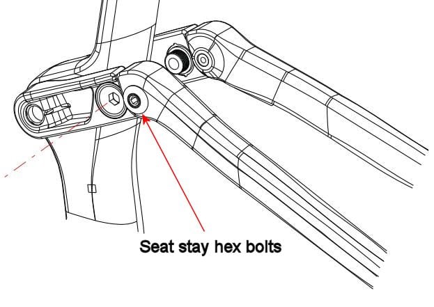

3) Remove the right/left seat stay hex bolts where they attach to the linkage arms.

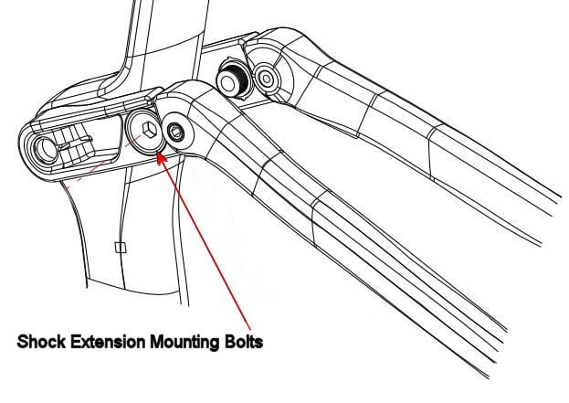

4) Remove the right/left rear shock extender hex bolts where they attach to the linkage arms.

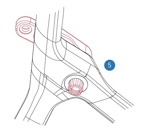

5) Remove the right and left pinch (Clench) bolts located on the bottom side of the linkage arms.
6) Six spacer washers are used in the upper suspension linkage. Two large spacer washers are used for the shock extender. They mount on the inner side of the linkage arm. Four smaller spacer washers are used for the seat stay. They mount on the inner and outer sides of the linkage arms. They may fall out, don't lose them.

1) With the upper linkage hardware and bearings cleaned and lubricated, you can begin the upper re-assembly.
2) Apply a liberal amount of grease around the inside race of the two axle bearings mounted in the frame. Apply Loctite 638 or similar to the splines on the left non-threaded side of the axle and also inside the splined interface on the left linkage arm. I use my finger to spread the retaining compound around to insure full coverage.

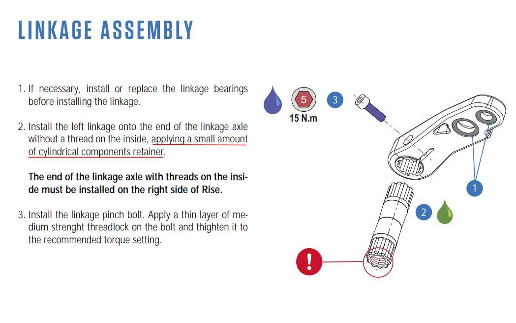

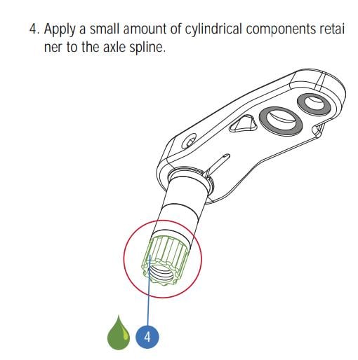

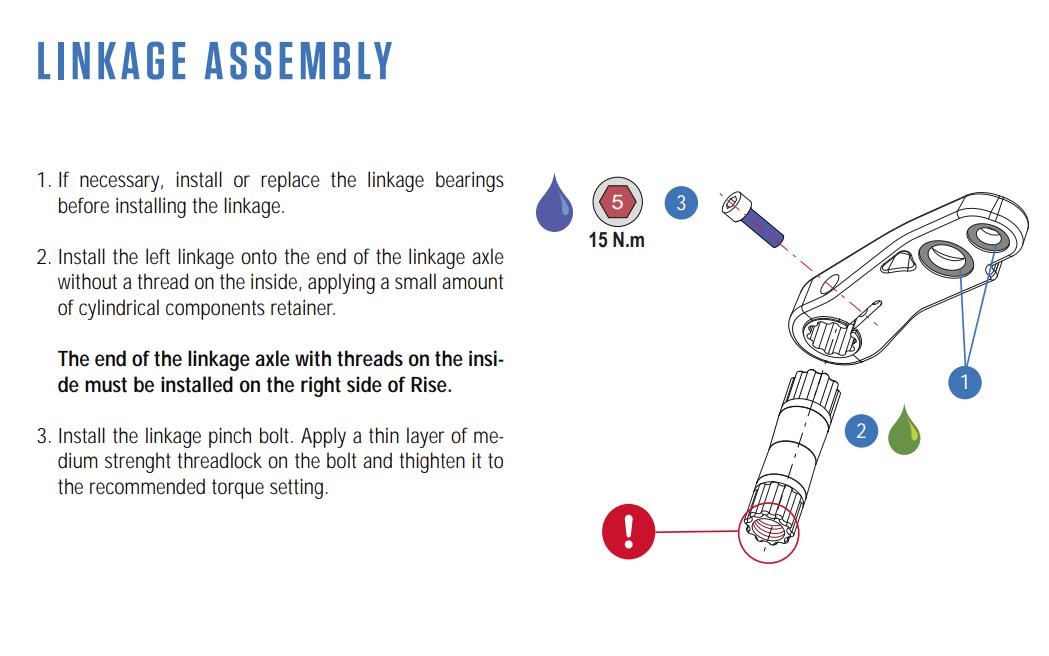

NOTE: The Orbea Rise Blue Paper requests that a cylindrical retaining compound be used on the axle splines. The blue paper does not specify which retainer compound to use. The Orbea Rallon shares a similar linkage design. The Orbea Rallon Blue Paper recommends Loctite 638 as the "cylindrical retaining compound" to be placed upon the upper pivot axle splines.

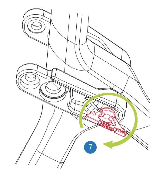

5) Your Rise should have come with a purple colored Orbea pre-load tool. The tool is used to set upper linkage arm pre-load and also to measure rear shock sag. Insure that the rubber pre-load spacer is threaded onto the pre-load tool.
7) Apply Loctite 638 to the axle splines on the right side of the axle. Do not apply any thread locker or retaining compound to the axle threads. Insure the threads are clean. Install the right side linkage arm onto the axel. Insure that the linkage arm is fully seated on the splined axle.
8) Thread the purple pre-load tool into the axle. As you thread, insure the rubber spacer is seated correctly and not cocked to where it can become pinched. If it is not centered correctly, it will become damaged during the tightening of the pre-load tool and a false pre-load will occur. Turn the pre-load tool until it stops. Do not overly tighten the purple pre-load tool as it will damage the rubber preload spacer. Check that no axle is visible between the inside of the linkage arm and the frame. Insure that the axle assembly rotates freely. If everything checks okay, apply a small dab of blue thread lock to a linkage arm pinch bolt. Insert it into the arm and torque the pinch bolt to 10 N.m. Remove the purple pre-load tool.

10) Apply a film of grease to the shock extender mounting bolt shoulders. Avoid getting grease on the threaded portion of the bolt. Apply a small dab of blue thread locker to the threaded portion of each bolt. Take the two large shock extension washers and apply a small dab of grease to each one. This will hold them in place as you work. Position the washers on the inner side of each linkage arm and centered over the shock extender bearings.
Take the shock and slide the extension fork into position between the two linkage arms. Make sure the shock extension washers are sandwiched between the extension fork and the linkage arms. Maneuver the shock extension, washers and linkage arm into alignment so that the mounting bolts can be inserted and threaded into place. Torque both bolts to 15 N.m.

Great tutorial Rod. One thing to point out is that the bluepaper recommends a retaining compound on the axle splines. The Occam bluepaper recommended 638, but there was no suggestion for which one on the Rise. I used grease on the last reassemble, my LBS guy said he has used grease successfully. I have got 641 to try next time, it is mid strength so should make it a bit easier to remove at service time.
I'd be interested to hear your thoughts on using the compound.

You make a good point and great suggestion. For others reading this post, I've attached the Rise Blue Paper segment which Rich is referencing in regards to cylindrical bearing retainer.
I see absolutely no harm in using a retention compound such as Loctite 641, especially if play has started to develop in the axel spline and linkage arm interface. I've used Loctite 641 compound in the past when a bike has been brought to me with a creaking press fit BB92 bottom bracket bearing cup. The compound fills gaps nicely and works.
My thought is Orbea specifies the "Cylindrical Retainer Compound" on the upper axle splines as a secondary retention measure. The only thing holding the linkage arm onto the axle splines is friction caused by the pinch bolt clamping the linkage arm onto the axle. It's a very secure fit. However, tolerances between the axle spline and linkage arm will increase with wear. It's possible the arm could loosen up and slack develop in the linkage.
I live in Southern California where the trails are extremely dry and like talcum powder. The powdery grit dries out the axle grease i'm using quickly. I've resorted to removing my linkage arm and greasing the axle about every two months, otherwise the suspension gets too stiff and the creaking develops. Orbea really messed up when they didn't seal the axle/bearing interface. Because I frequently take the linkage arms off, I chose to use grease on the splines to prevent axle spline/linkage arm wear. I have yet to have a linkage arm loosen on me. .
Thanks,
Rich
Rich, I edited the article to show the use of a retaining compound on the splines. Thank you for pointing this out to me.

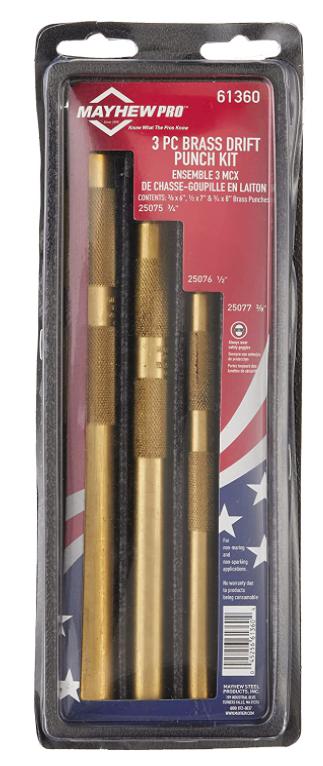

I also like to use brass drift punches to remove bearings. I use brass because it tends to grip the bearing better and won't shatter the hardened steel race on the bearing.

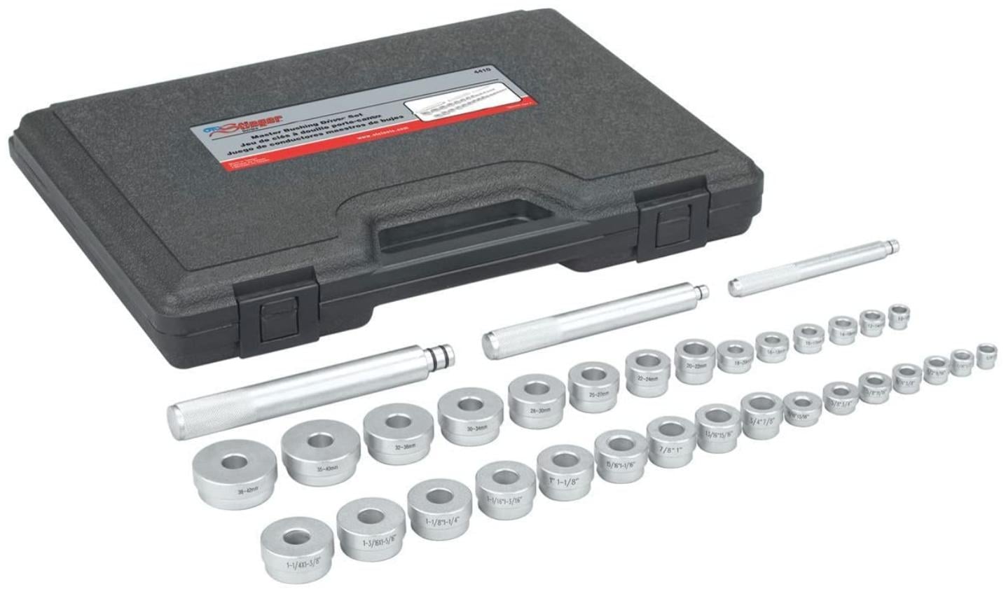

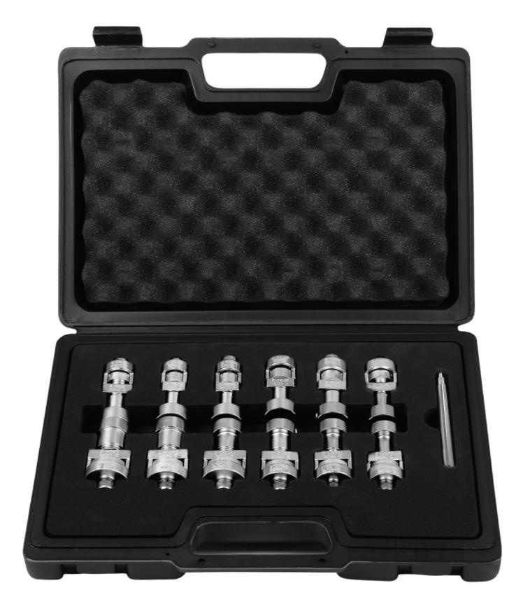

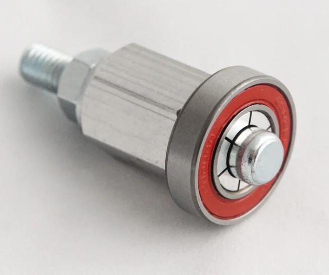

I really hate to hammer on my frame. I try to avoid it whenever I can. There are several companies which make "Non-Hammering" pivot bearing removal and installation tool kits. They are pricey but work well. You will usually find that a bike manufacturer will sell specialized pivot bearing tools for their bikes. Orbea doesn't offer any.
Here is an example of a "Non-Hammering" pivot bearing removal and installation kit made by Session USA and sells for $250.00. I have not used this kit, so I cannot recommend it and only offer it as an example. There are other types sold on the market.
PIVOT AND LINKAGE BEARING EXTRACTION/INSTALLATION TOOL KIT

DanMcDan
Mar 18, 2021
158
111
Torquay
Thanks Rod, I left it in penetrating oil for an hour and they then came out quite easily. I do have a bearing puller kit, but they don’t grab very well on the smaller bearings (sub 20mm (13/16th)) I may have to invest in something better.

GTBusso
Dec 26, 2021
41
19
Hitchin
I always like to tear a new bike down and check everything is greased, loctited and torqued as per spec. I didn’t get chance on my Rise, had too many rides booked. I got chance to do it all today.
I’ll start off by saying I’m not a jet wash user, just a hosepipe and soft brush.
I’m about 8 rides in, UK winter rides, Sandy bike parks and then 3 days in Wales riding Mount Snowdon, Penmanchno, Coed Y Brenin and part of Dyfi Forrest. Anyone that’s ridden Penmanchno will know what a soak fest it is, practically riding along rivers have the trail.
Anyway, my 2 main pivot bearings were seized and the other bearings weren’t great. Took all the seals off and gave a good clean and Mobil XP222 grease, but the main 2 are going to need replacement pretty soon- grating quite a bit.
So, if you’re a Uk rider, best learn how to do this service otherwise it’s going to be a costly ownership😂.
I’m just off to buy an Orange single pivot😂

I'm on the opposite end of the spectrum. Where I ride, it's dry as hell and the dirt is like fine talcum powder. It works it's way into the linkage and dries the grease out fast. I also wash my bike frequently, so there's that too. I know somebody is going to say they wash their bike once a year whether it needs it or not. That's awesome. Paul McCartney saw my bike on Penny Lane and said it was a clean machine.........They wrote a song about it.
I'm discovering that the type of grease you use on the Rise's linkage is critical. This is especially so in a wet environment, i.e. bogs, mud pits, sheets of rain, fog, and other Type A stuff you Brits call fun.
I'm presently trying a grease produced by Schaeffers, called 219 SynForce Green, Waterproof Grease. The grease is especially formulated to withstand high shock loads, extreme pressure, sheer stability and is water resistant. It's been a month and so far it seems to be working good. I'm not giving it a thumbs up yet, it's only been a month. I'll keep you posted on the long term results.
I found this YouTube video where a guy places various samples of grease between two metal pads which are slammed together. It's amazing the results that occur. Some greases can handle the high shock load and pressure, while others splatter. The guy also does a comparison on water resistance. It's an interesting video and the main takeaway is that greases are not all the same. The video should give you an idea of what is occurring with the grease in your pivot bearings and axles as you go pounding down the trail in the wet.
GTBusso
Dec 26, 2021
41
19
Hitchin
Hi Rod,
Am I right in thinking it’s the Chemsearch lube that they reckon is the best stuff in the YouTube link?
It doesn’t seem readily available in the US never mind the UK, so I reckon I’ll give the Synforce a go. I’ll have to get this delivered to a hotel when I come to the States in a couple of weeks, any particular reatailer you’d recommend?
Any reason that being aluminium based it could cause any issues? Might be good in bottom brackets for our winters too.
Rod B.
Aug 18, 2021
493
839
USA, Orange County Ca.
Hi Rod,
Rod B.
Aug 18, 2021
493
839
I looked into buying several different brands of grease including Chemsearch and Almagard. Trying to buy the product was difficult as you had to buy directly from the company by submitting a purchase order.
Schaeffers grease was more easily obtained and can be bought via Amazon or eBay. In both instances you can buy a single tube and not be forced to buy a whole case.
While looking for a grease to use that actually works, I learned that the term “Complex” refers to the thickeners used by the manufacturer to make the grease thick or sticky, and allow it to perform within an application such as food processing machinery, wet environment, cold weather, high speed racing, high impact, etc.
There are many grease complex thickeners, such as Lithium, Aluminum, Sodium, Polyurea. Additives are also added by the manufacturer to give the grease further specific properties.
Aluminum complex grease gives the grease a better ability to stick to an object and withstand water washout than Lithium complex based grease. Both are equally good greases, Aluminum has the edge in water resistance.
In regards to grease compatibility, the charts almost all agree that Aluminum and Lithium are compatible. Some charts indicate mixing complex greases can cause a grease to lose some of it’s properties, i.e. water resistance. If you are in doubt, clean out the bearings and axle contact points. Load them up with the same grease.
I chose the Schaeffers Green 219 because of it’s ability to withstand water washout. I also like that as a green synthetic, it’s more environmentally friendly than Lithium complex grease, which can leach into a stream during a water crossing and deposit heavy
metals.
Here’s the technical data sheet on the Schaeffers Green 219. It explains the grease’s properties better than I can.
Note: I’m still evaluating the grease. So far it’s working well but who knows, it may end up not working. It’s still too soon. I’m not comfortable with saying you should buy it. I need a few more trail miles.
GTBusso
Dec 26, 2021
41
19
Hitchin
Thanks for that insight Rod. What amazed me in the YouTube link, was how he could dilute the lithium grease so easily in his palm.
I haven’t tried that with the Mobil XP222 I use, but will this week.
It’s a real shame that Orbea didn’t employ bearing shields a la Santa Cruz. They’re certainly not impenetrable, but do help as you can smear a little grease between the back of the shield and the bearing.
Very regular cleaning and greasing of the bearings will be the order for me in winter.
Rod B.
Aug 18, 2021
493
839
I was also surprised by how easy the grease diluted. You would think all greases would be waterproof. I also found it interesting that some greases remained intact when hit and other greases were destroyed by the blow. The take away is that greases are not all the same.
At your suggestion, I tested the Mobil XHP222 for water dilution in the same manner as the guy did in the video. The Mobil XHP222 partially held up to the water, but it seemed to thin out and become partially diluted when I worked the grease under a stream of faucet water. I also tested the Scheaffers, Green 219. The water had absolutely not effect on the grease. The stuff was like superglue on my palm when I hit it with water. No thinning out or dilution.
It's interesting you mention the Santa Cruz seals. I thought the same. The Rise is such a good bike, however, I do wonder why no effort was made to seal the pivot axles.
Murphius
Jun 19, 2020
100
101
Washington
Anyone find it very difficult to get the seat stay hex bolts to align and begin threading when reinstalling? Really hoping someone has some tips to make this easier. I think I may have damaged the start of the threads enough from spinning the bolt up while misaligned enough that it won’t catch now.
Murphius
Jun 19, 2020
100
101
Washington
My solution: loosened up the rear axle, shock extender bolts on both sides, and front shock bolt. This gave me enough play in the rear triangle and linkages that applying significant force on the seat stay hex while rotating caused it to align the bolt threads with the threads in the end of the seatstay. What a PITA.
Richridesmtb
Jan 23, 2022
207
96
I also had that issue on one side. Can't remember, but I'm pretty sure I had the wheel out. But you're not on your own and it makes me question the tolerances a bit.
Murphius
Jun 19, 2020
100
101
Washington
Glad to hear I’m not the only one. I was in and out of a stand but may try in a stand without a wheel next time. Would definitely make certain aspects easier. I’m just used to my Transition where I can work through one side of the bike at a time without all the rear triangle flex/alignment issues as well as their better approach to hardware.
Rod B.
Aug 18, 2021
493
839
In my two tech articles for the upper and lower linkage, I provided a full blown, take everything apart and and do a methodical inspection version. However, you can also do an abbreviated "Down & Dirty" quick upper linkage clean and lube version. To do this method, you do not remove the shock and you only take off one upper linkage arm off at a time to inspect, clean and lube the pivot linkage. This leaves the other linkage side fully attached and in alignment. Everything threads back together fairly easily doing this method. Keep in mind you still have to remove the upper pivot axle and lube it which requires removing one linkage arm and and loosing the pinch bolt on the other linkage arm in order to slide the pivot axle out of the two bearings and lube it. I hope this helps.
Murphius
Jun 19, 2020
100
101
Washington
The approach you described is what I initially employed and struggled with. I could physically get the bolt through the washers but it wouldn’t catch threads until I loosened up many of the other bolts.
Rod B.
Aug 18, 2021
493
839
It's definitely a little bit fiddly between holding the chain stay up, aligning the seat stay, keeping the spacers aligned and threading the bolt in. I've considered taking up juggling as a result. You'll be happy to hear it gets easier and quicker the more you do it. Curious, did you notice a difference in your suspension after the cleaning and lubrication?
Murphius
Jun 19, 2020
100
101
Washington
I didn’t notice a difference, it had felt good but I was hearing a creak that I thought was coming from one of the pivots. After greasing everything but the main pivot, I think the noise is actually coming from the derailleur cable housing (between the front and rear triangle) rubbing on the frame.
