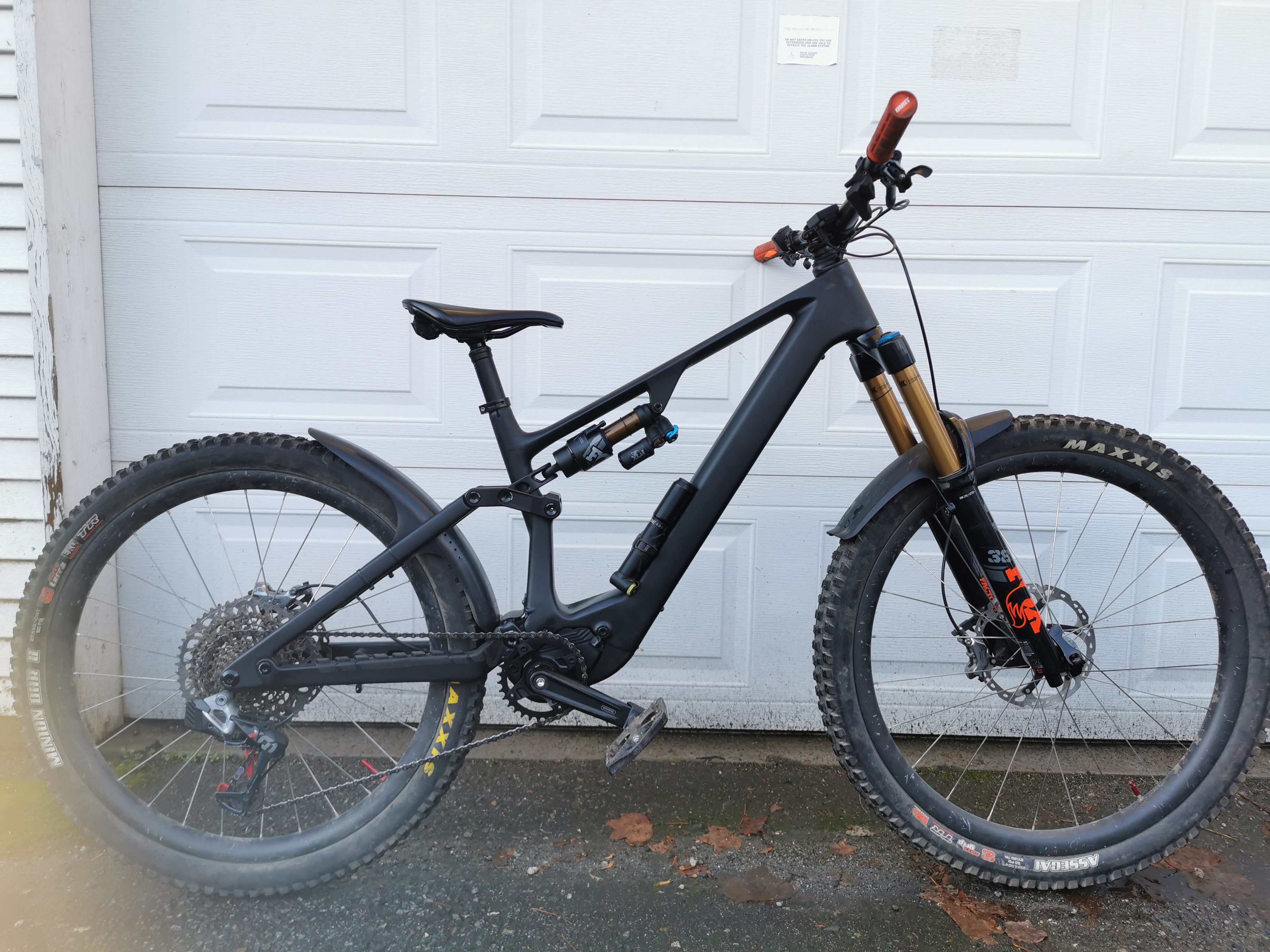

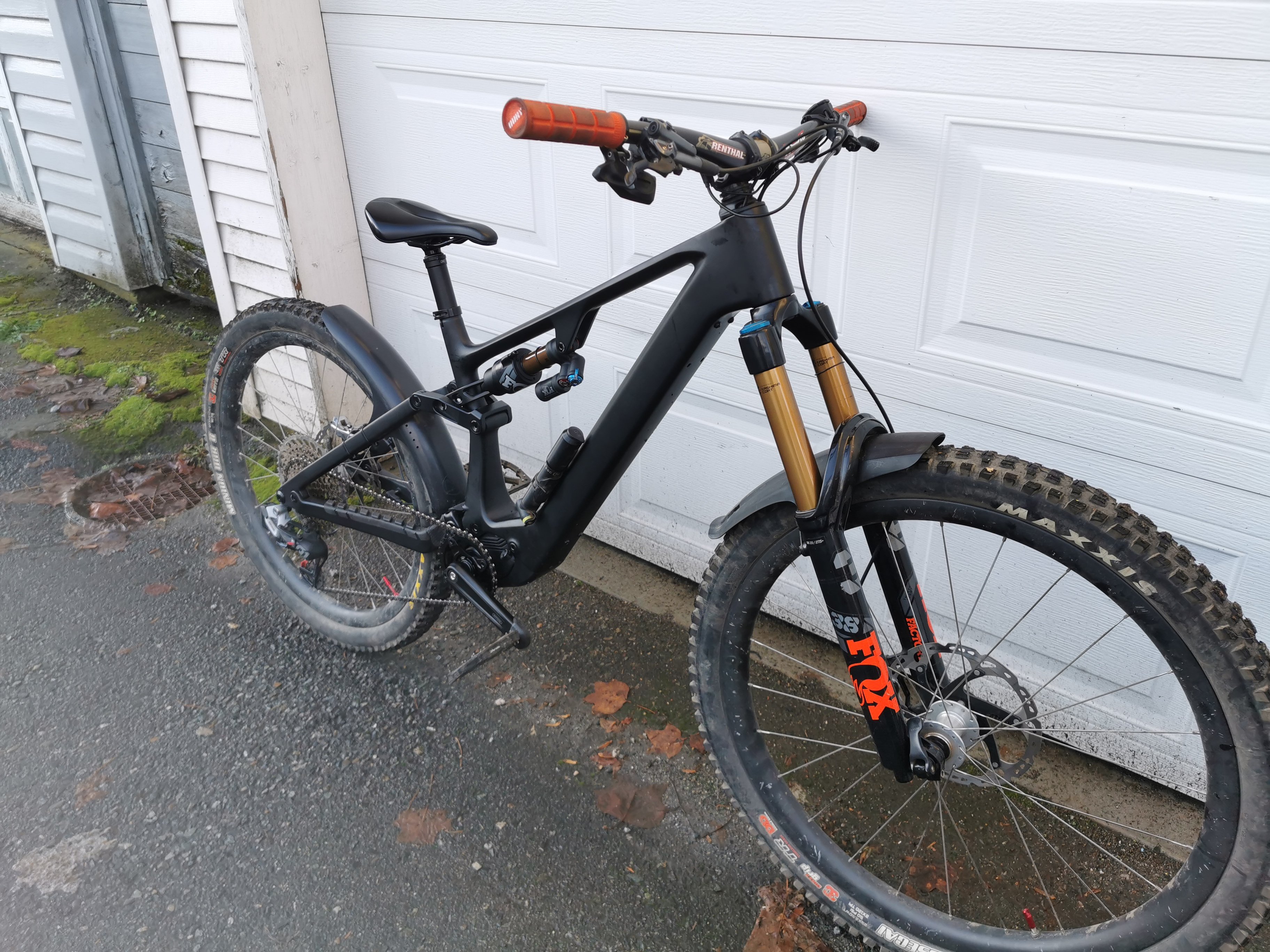

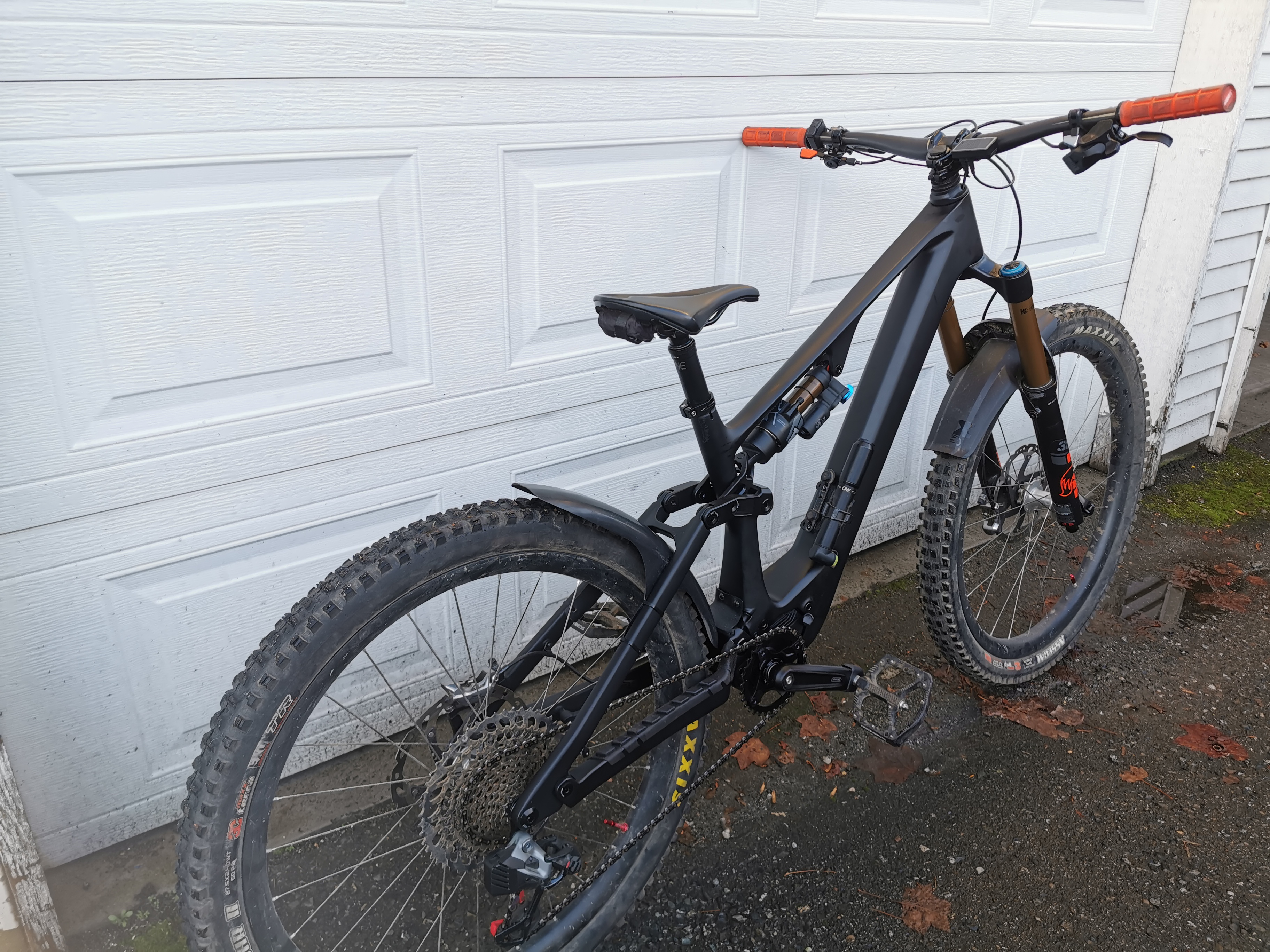

Hi, I built up a bike with this frame but there is a serious issue with the frame design. As mentioned by other, the shock specs an outdated size but the real issue is the clearance. A shock with a larger air can or a coil shock will interfere with the top tube of the frame half way into its stroke. I learned this the hard way!
Verdo07
Oct 22, 2023
26
9
Italia
nice bike!!! with that type of kinematics I expected some interference problems with spring shock absorbers... but if the X2 fits, I think 90% of the air ones fit... I think it's one of the largest with air. .. apart from that, tell a little more about your bike if you feel like it!!! I see a 27.5 wheel on the rear... would a 29 fit?
How much travel does the 38 have? bafang battery or do it yourself?
weight?
How are you feeling with the suspension?
in short...you've built a beautiful enduro bike!!!!how do you feel about it?
Lvtride
Dec 17, 2023
7
8
Vancouver
weight?
Thanks for your reply! Unfortunately this bike has been disassembled because the x2 does not fit this frame nor does any coil shocks. Only shocks such as older Fox DPS and Monarchs with slim air cans. I was so excited about trying the bike that I didn't check everything over before hitting the trails. Needless to say, the frame took some damage and so did the X2 air can. I checked to confirm what shocks would interfere and I have a bunch of shocks on hand luckily. I decided I didn't want to ride it with a low end shock so I am planning to do some carbon modifications to the frame to allow for a large air can and coil shocks. I'll probably give it a paint job as well while I'm at it.
Regarding the battery - it uses the Bafang battery but there is another issue here, LOL!! The battery goes into a "deep sleep" mode after 45min of inactivity. This means there's no way of turning it back on unless you wake it up by plugging the charger in. You could imagine what this would mean if you drive out to the mountains and it takes you over an hr, then you go to turn the bike on and nothing happens. I don't think most people will carry their charger with them and have a power source to plug into to wake the battery up.
Anyways, I suspect the battery management system has a design problem or maybe I just got a lemon. Bafang says their trying to figure it out, whatever that means. I hope others can comment about their experience with the stock Bafang 410whr battery (BT F014.410.C)
I am currently waiting for a warranty replacement but who know when I'll see it. Until then I'll build my own battery and get this bike going again.
If you're considering this bike, I'd say check out the alternative options like the LCE930 or the CEF50 - way less hassle and seems to be proven platforms with so many great build by people on these forums.
