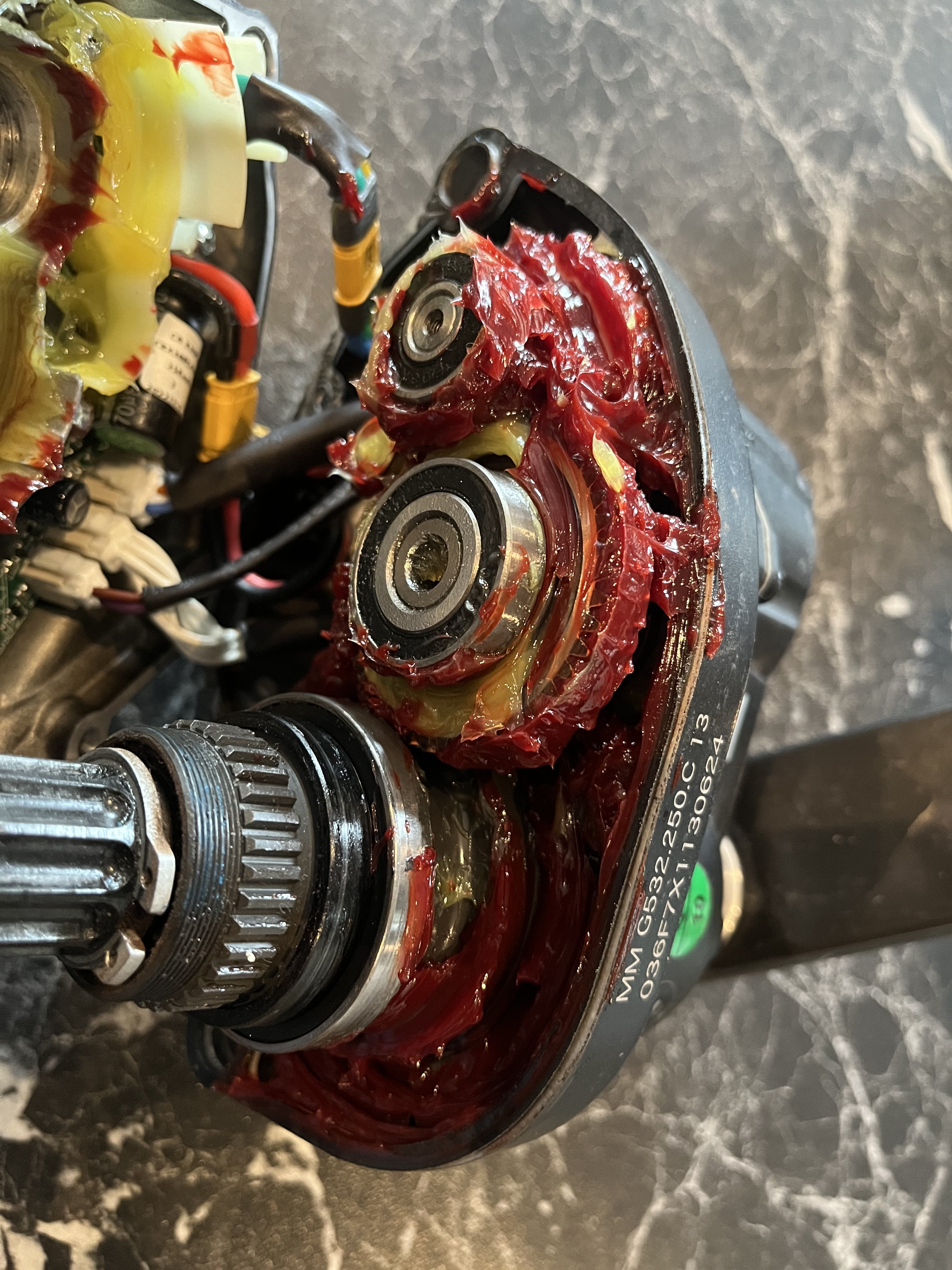

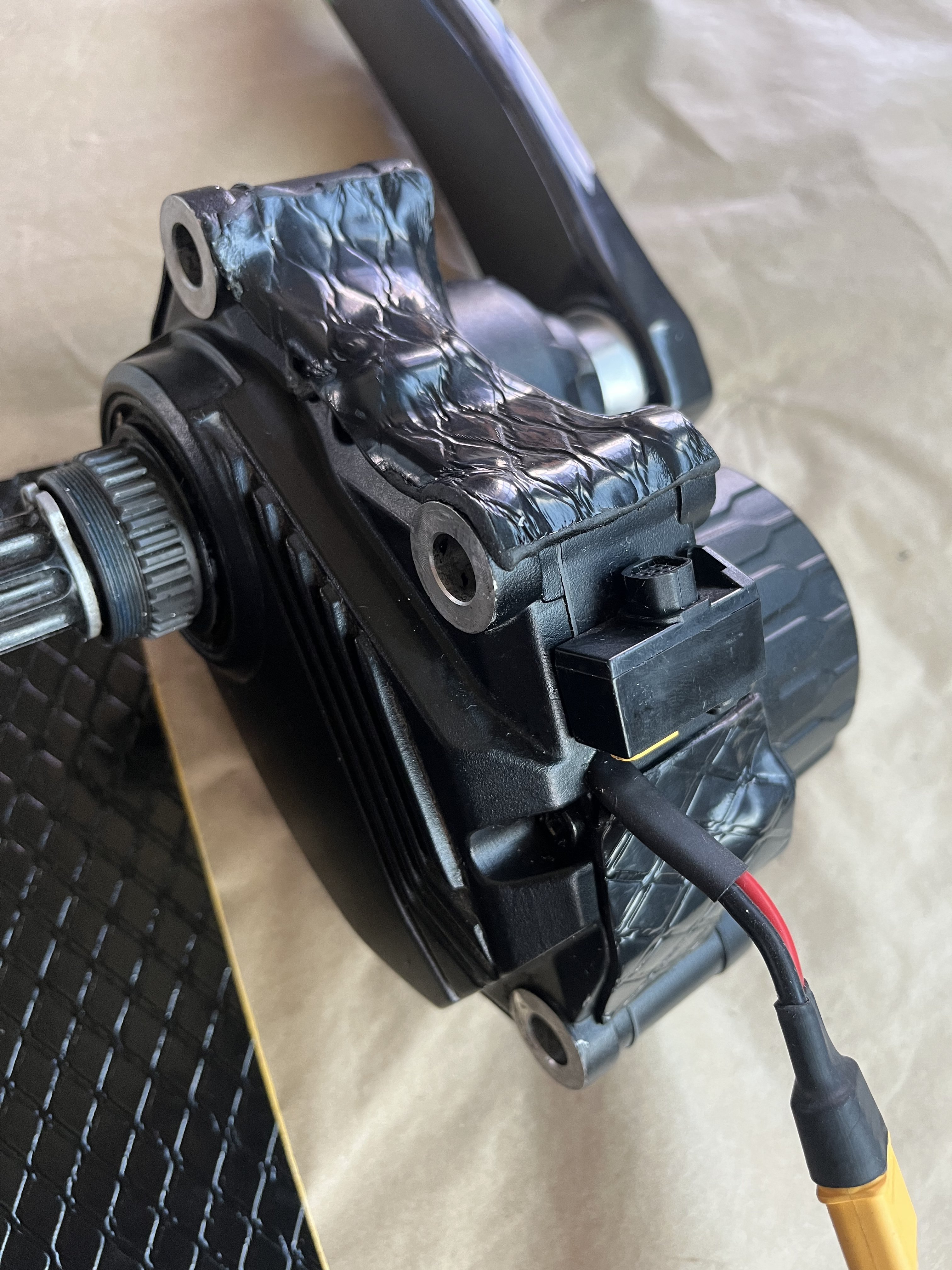

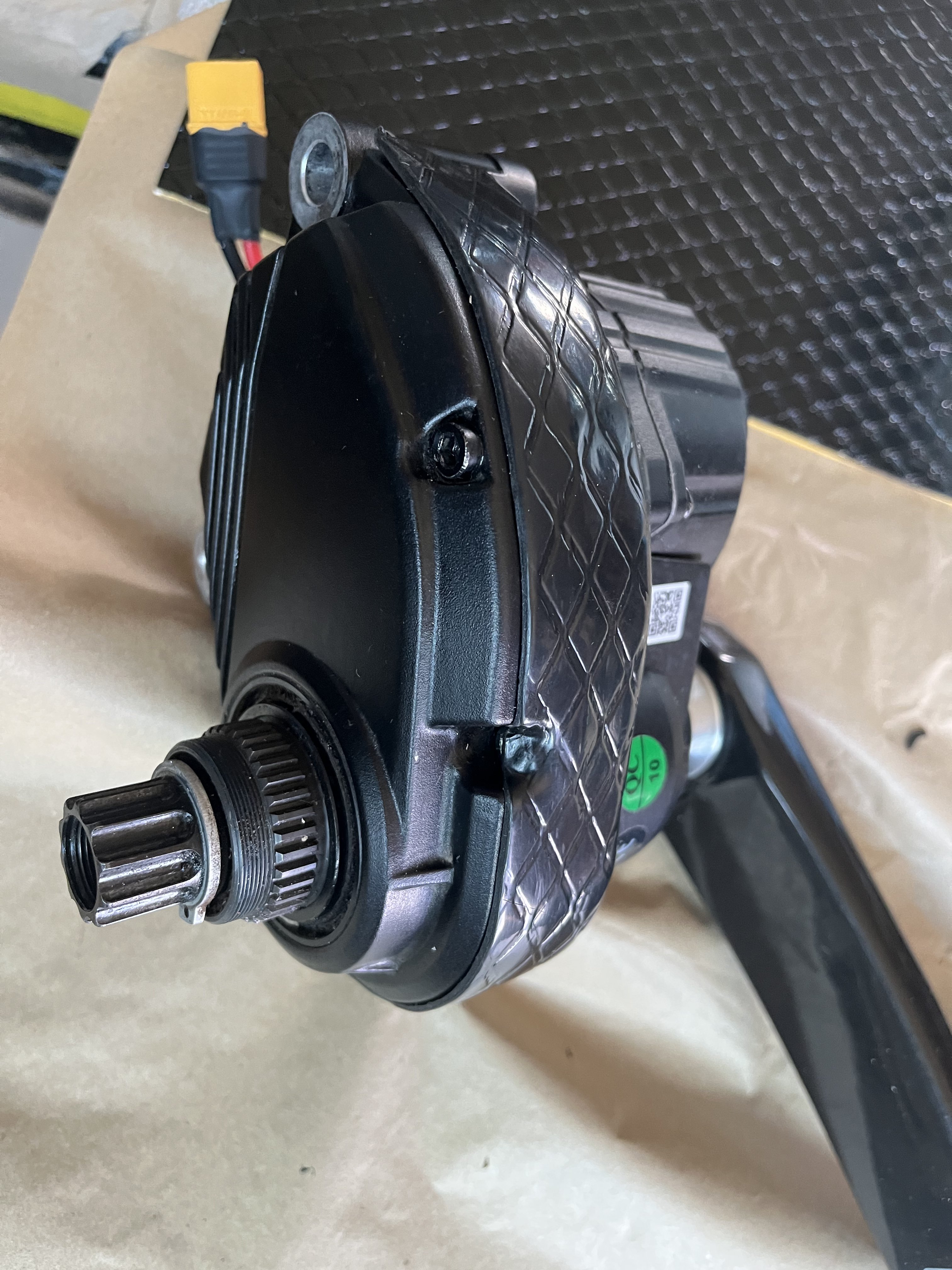

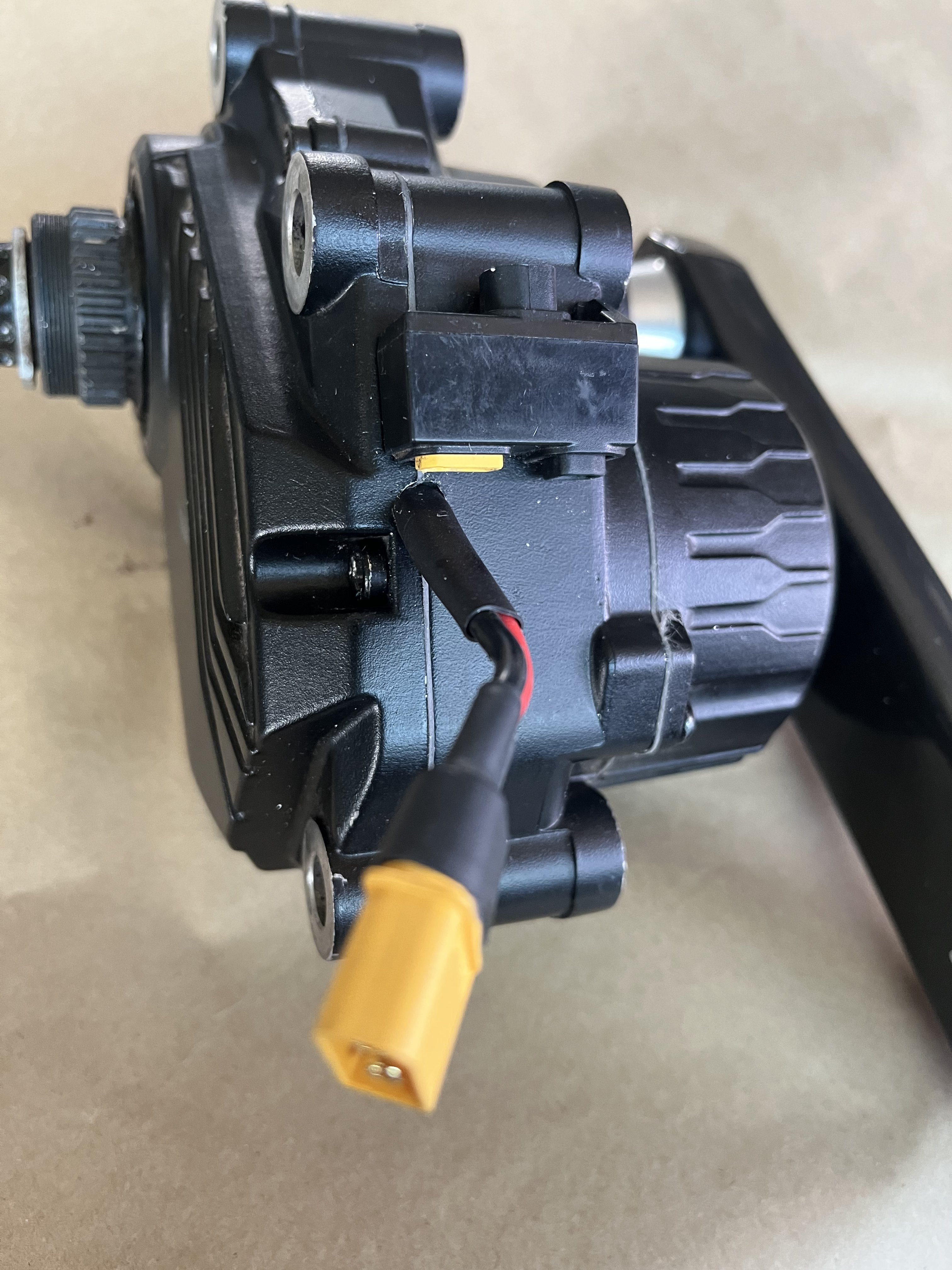

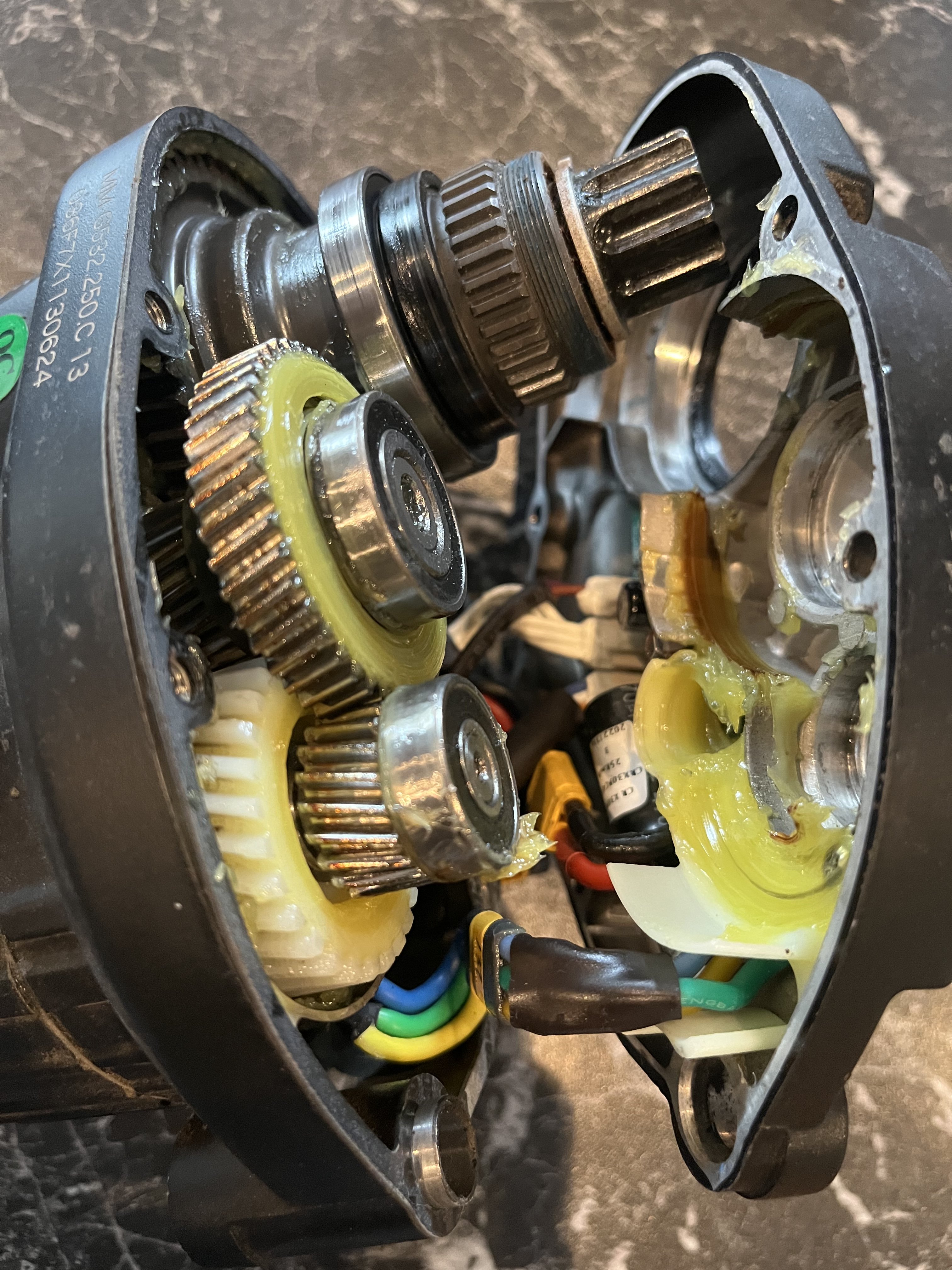

After the first 100 km I decided to make a few improvements.
Since the noise of the motor bothers me a bit, I greased it with Mobilgrease 28 and covered the housing with insulation mats to reduce the high frequencies. On this occasion I replaced the puny XT 30 connection with a flexible XT 60.

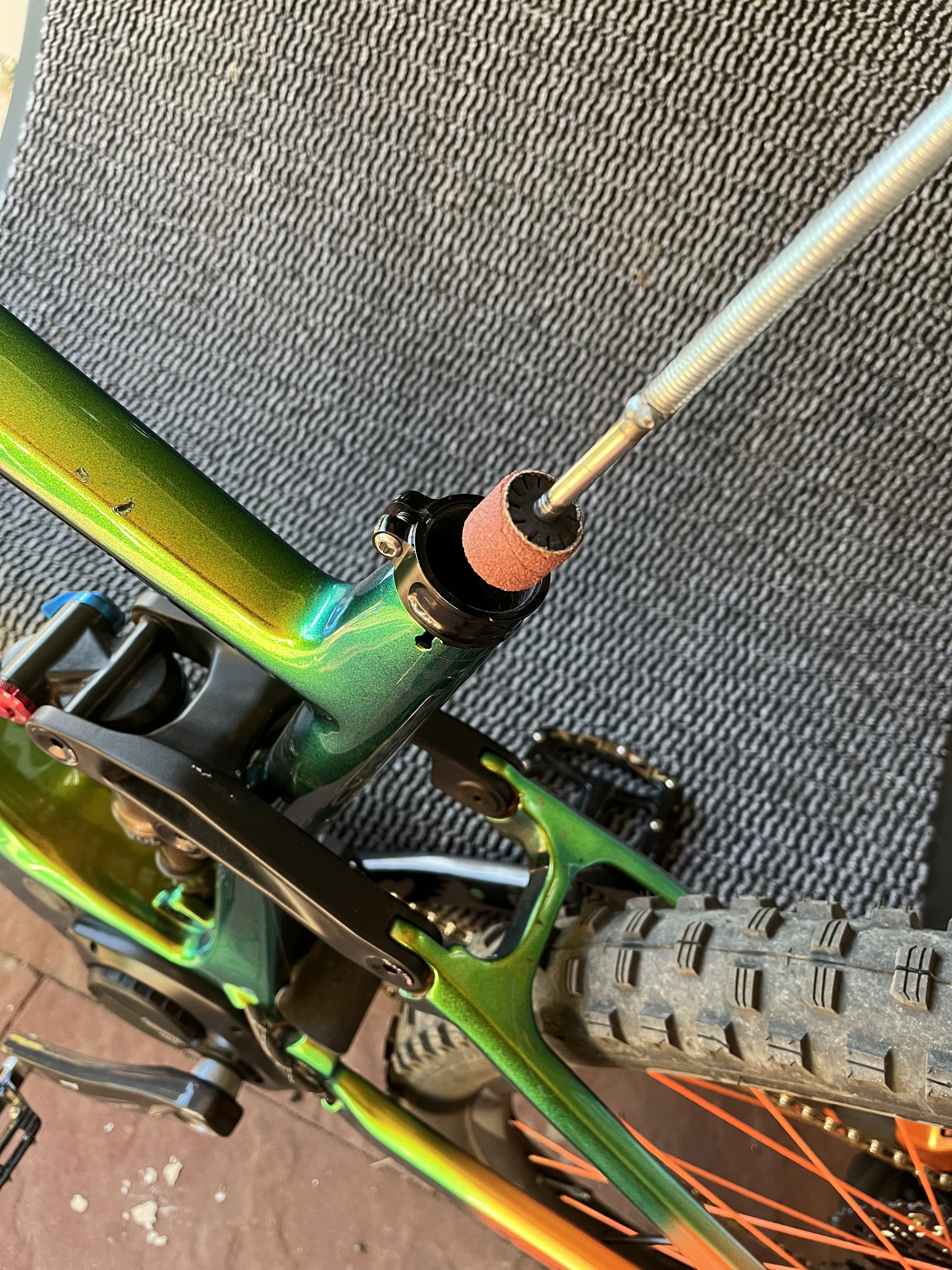

I also processed the seat tube with an extended sanding roller in order to use a 170mm seat post.

Wow! Nice to see inside!
On my side the 170mm dropper fits without an issue

So U mix factory lube with your mobilgrease? Isn't that too much?

Yesterday the first ride after the "improvements" and what can I say ? The work can be saved, only minimal improvements in noise reduction. I had hoped for more. 🤷‍♂️ Still, one of the best bikes I've ever ridden.(y)
