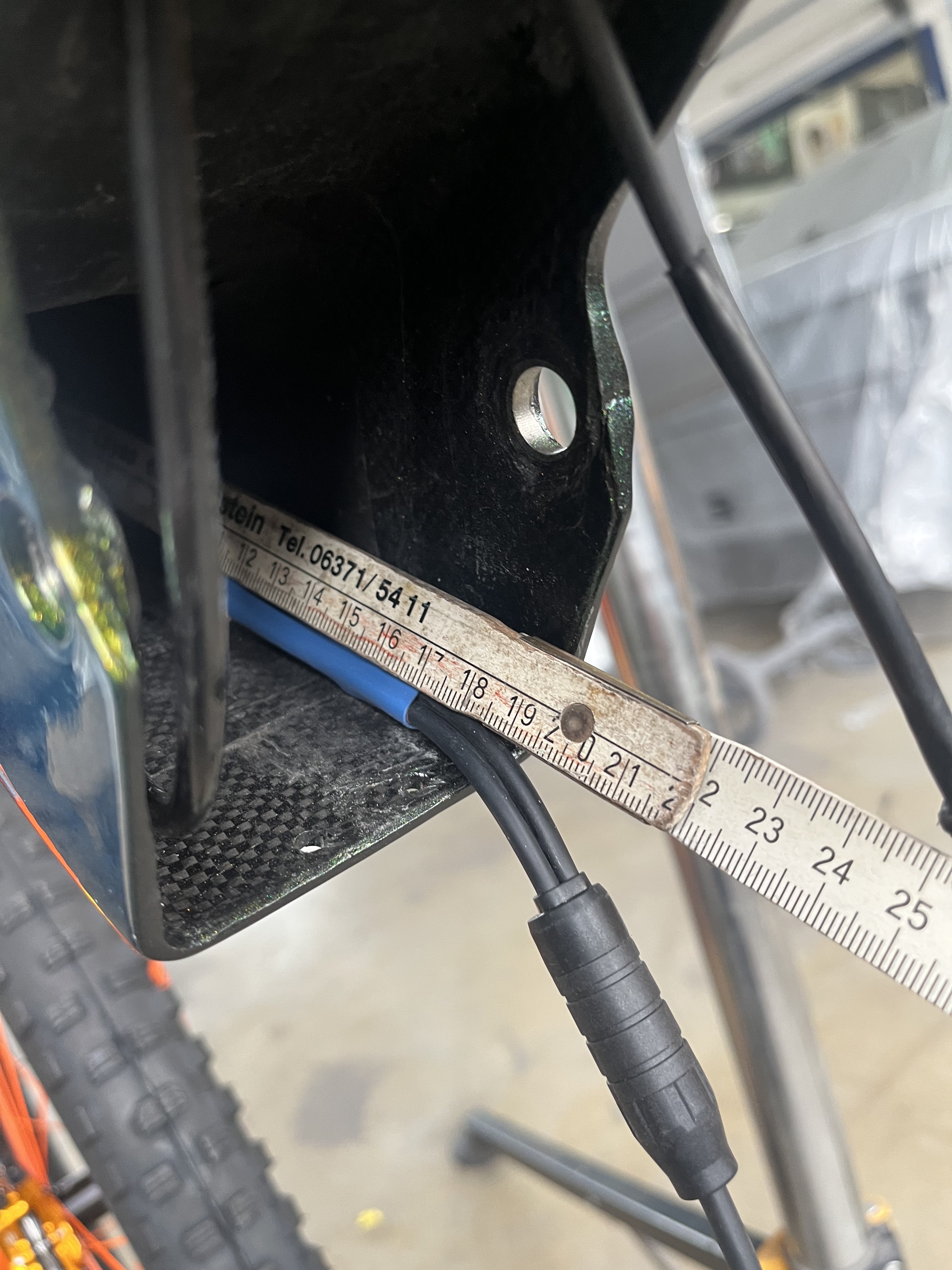

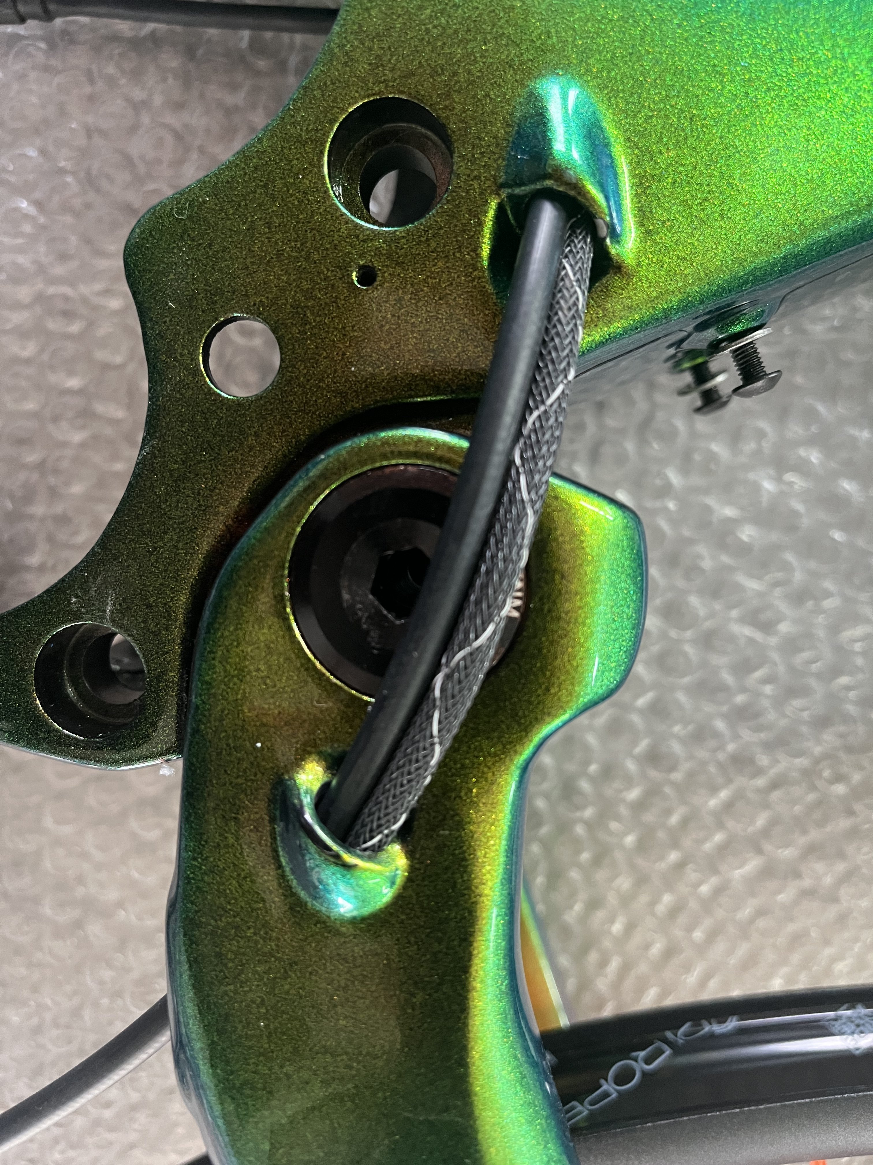

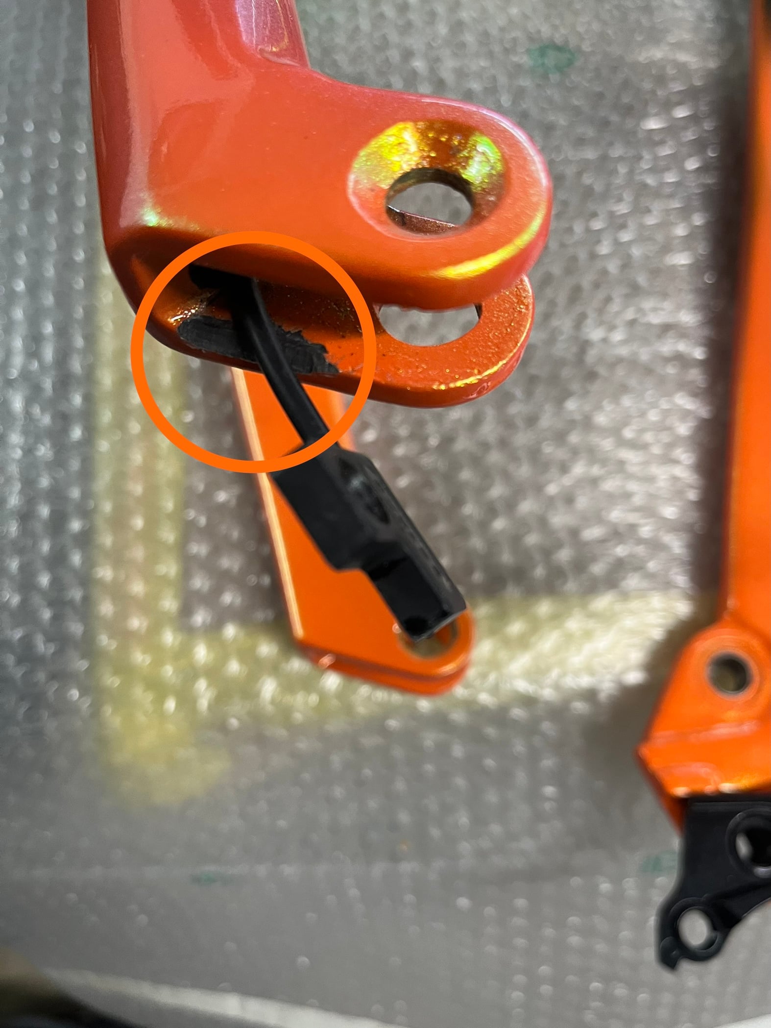

@KaroKönig , considering that this hole is meant for the brake, where are you planning to route the rear brake than?
Also, did you check, if at full compression, hole at the end of the chainstay stays big enough, so the cable doesn't get pinched between the chainstay and seatstay?
Other than that, looks neat.
KaroKönig
Feb 10, 2021
234
502
Of course, the brake line also fits through and for the clearance at the dropout I had to make a 3mm edge break and reinforced the cable with shrink tubing

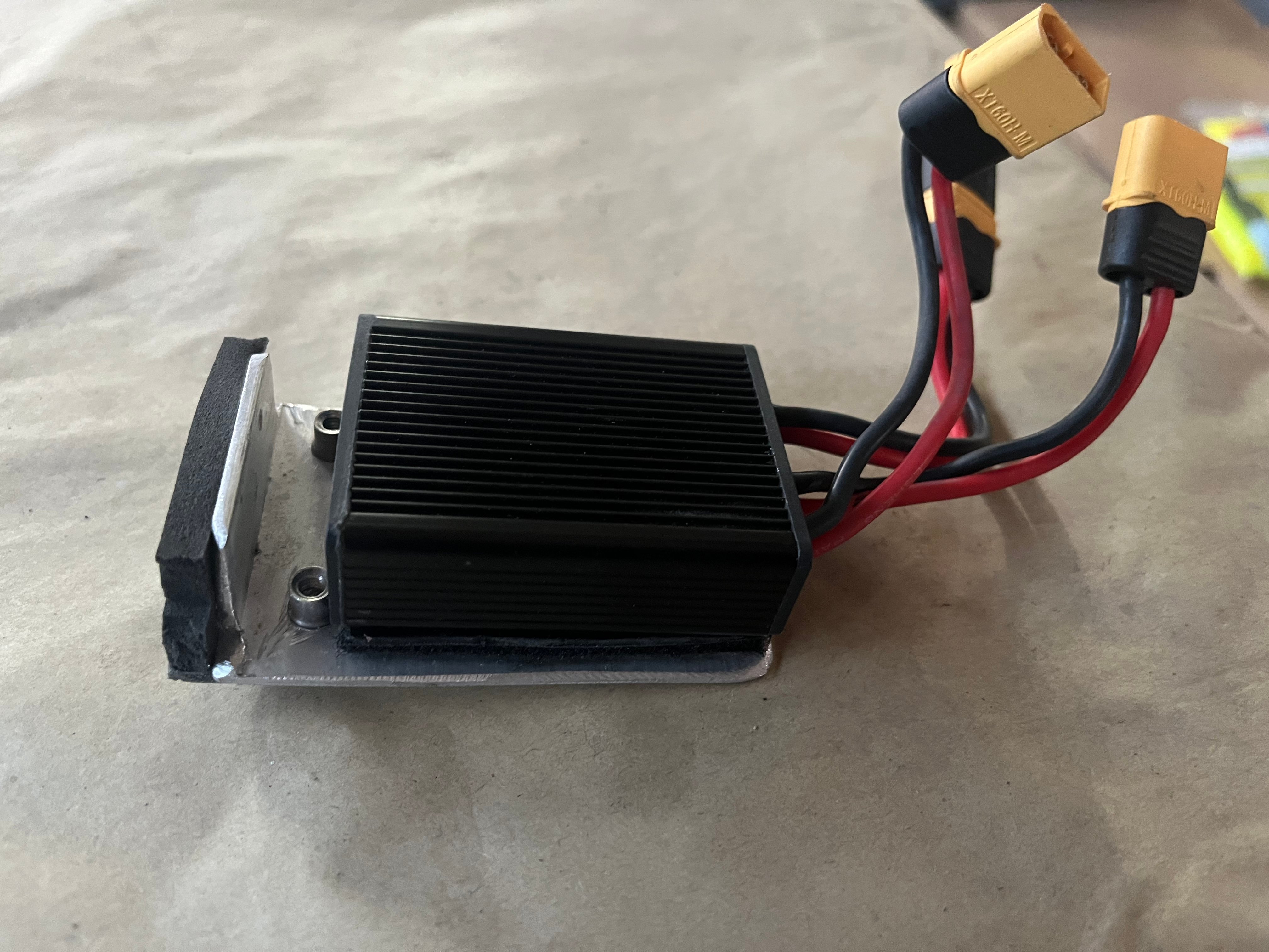

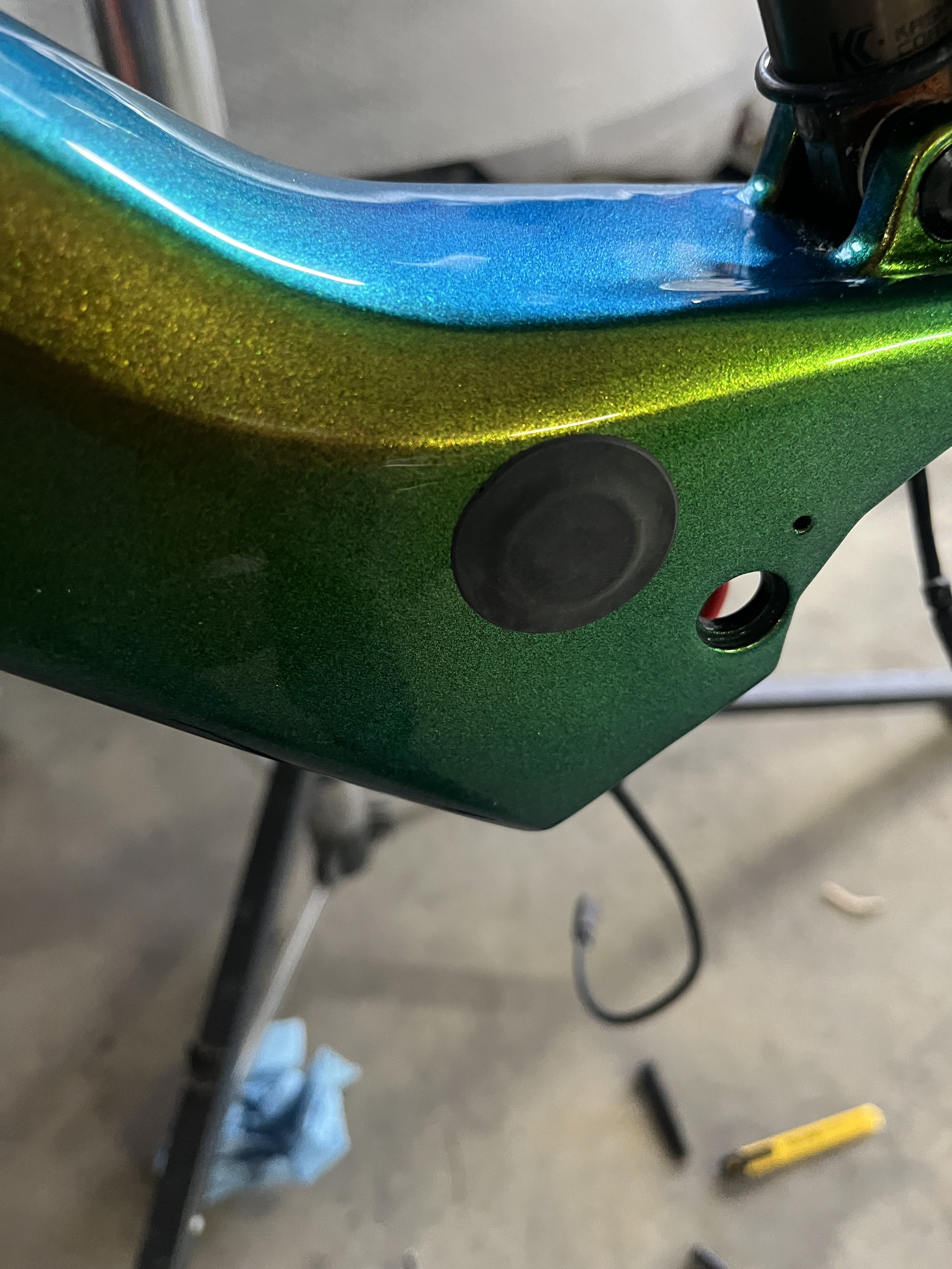

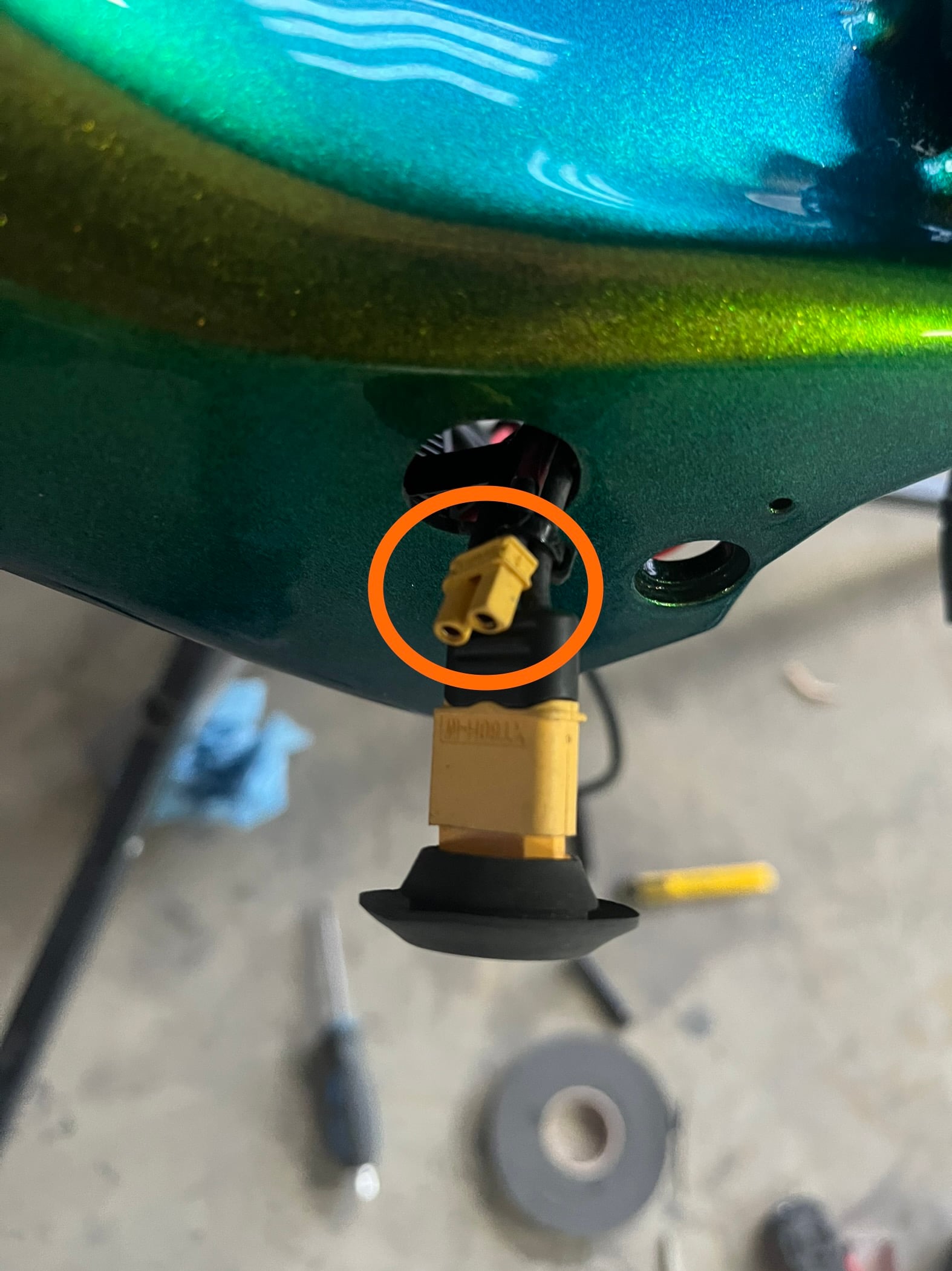

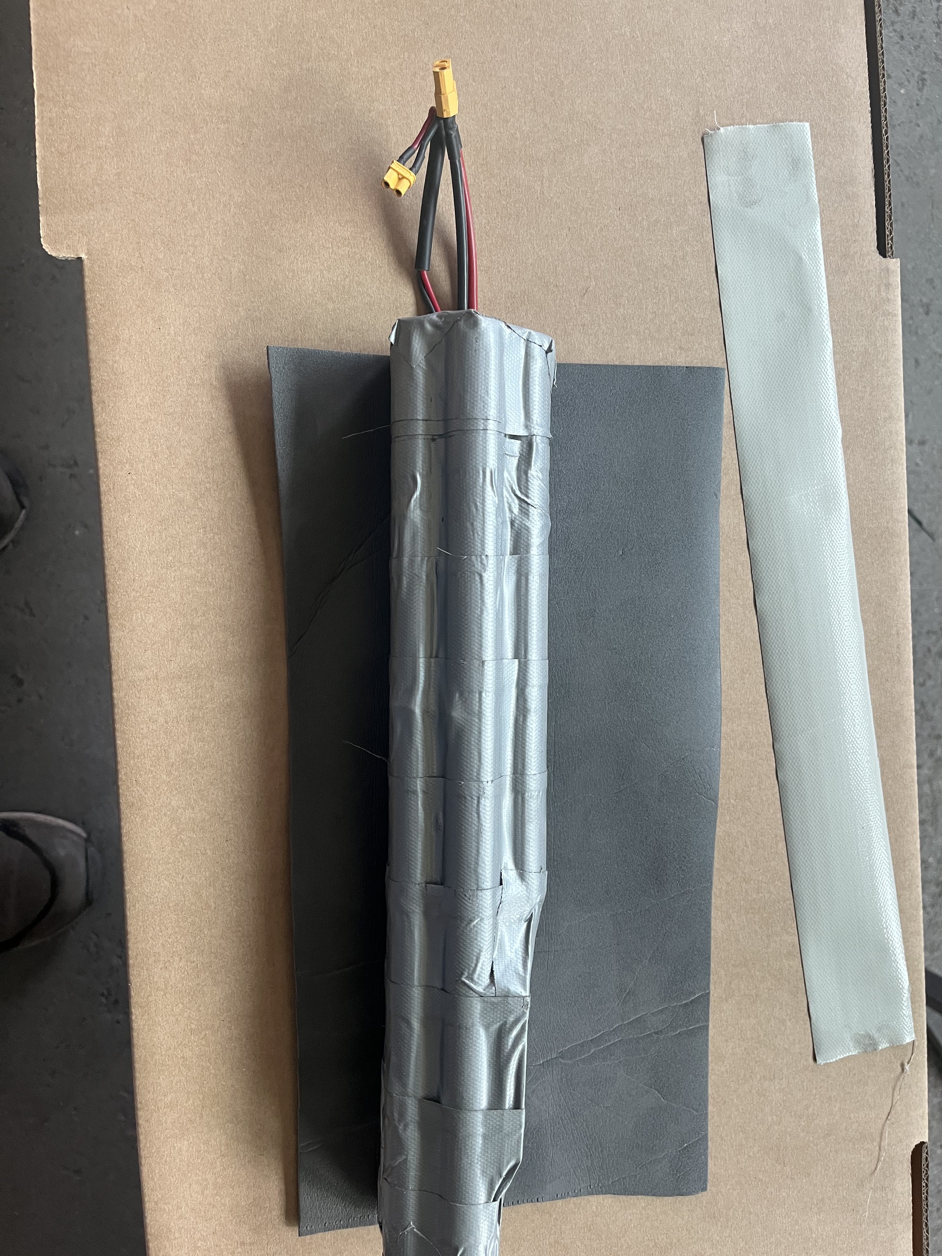

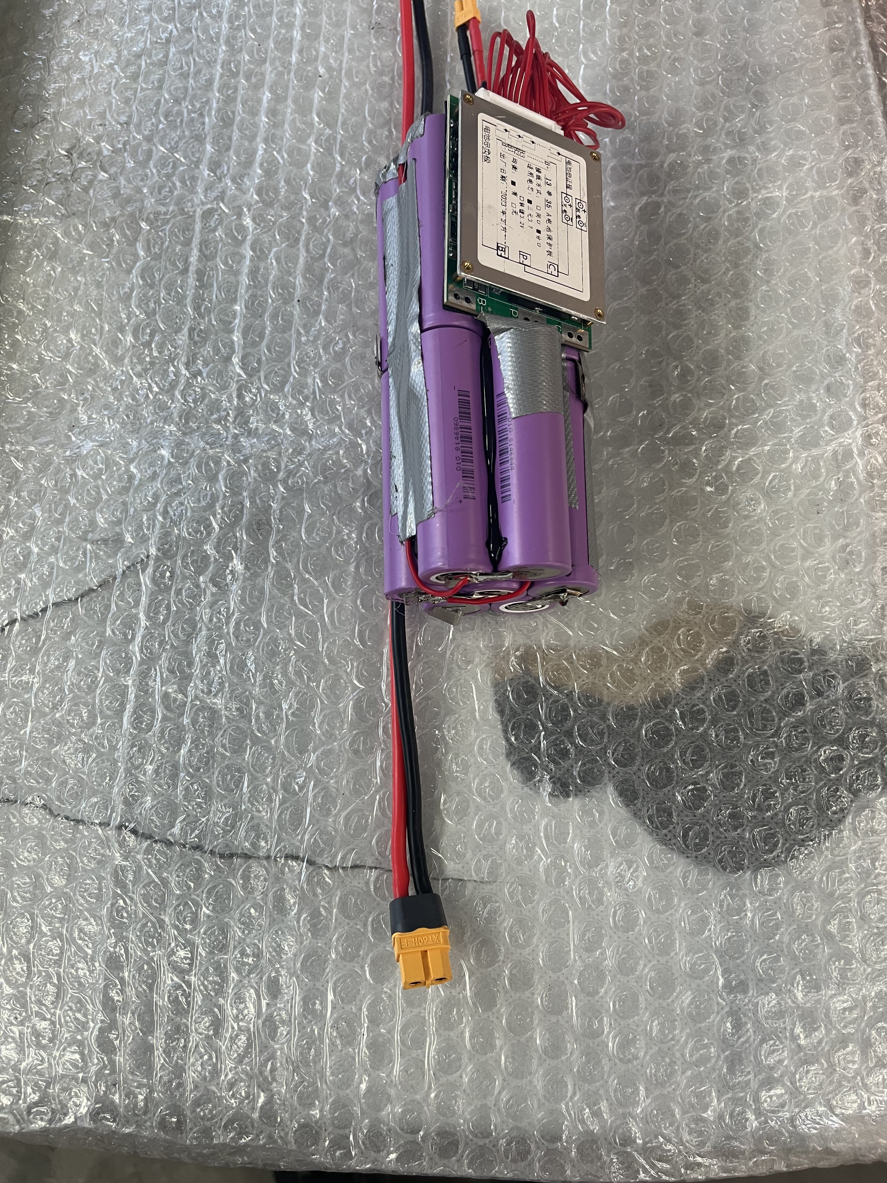

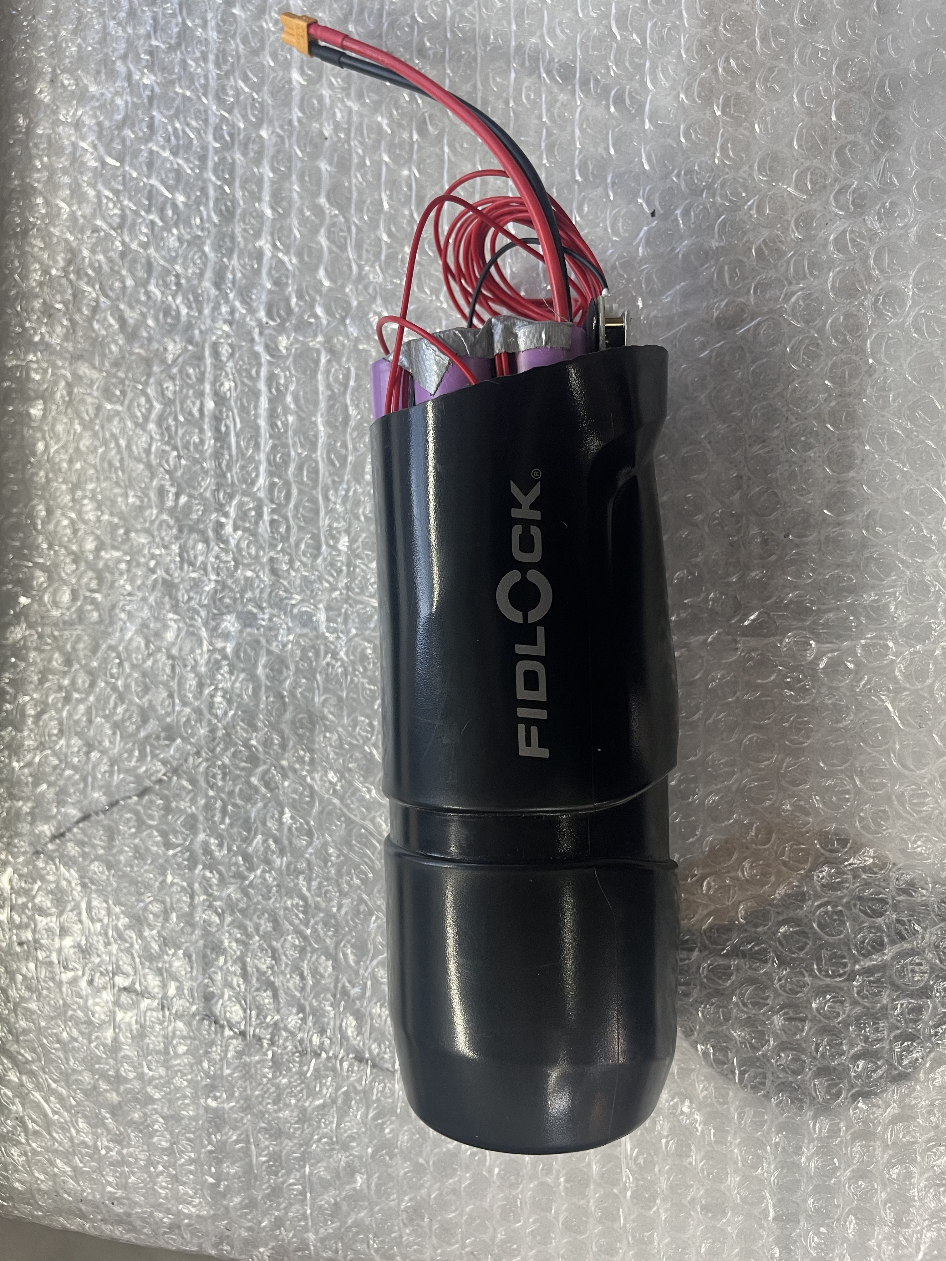

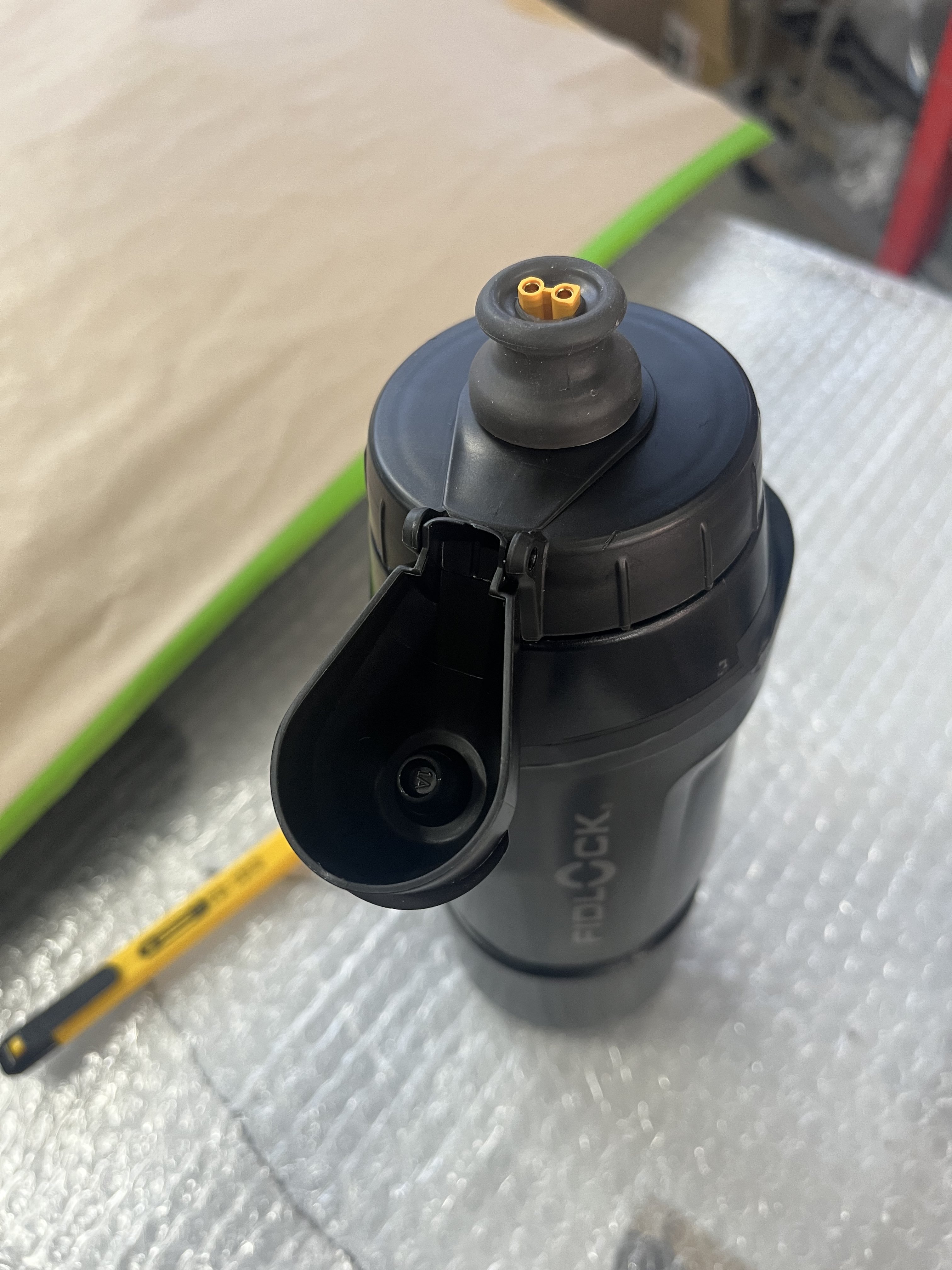

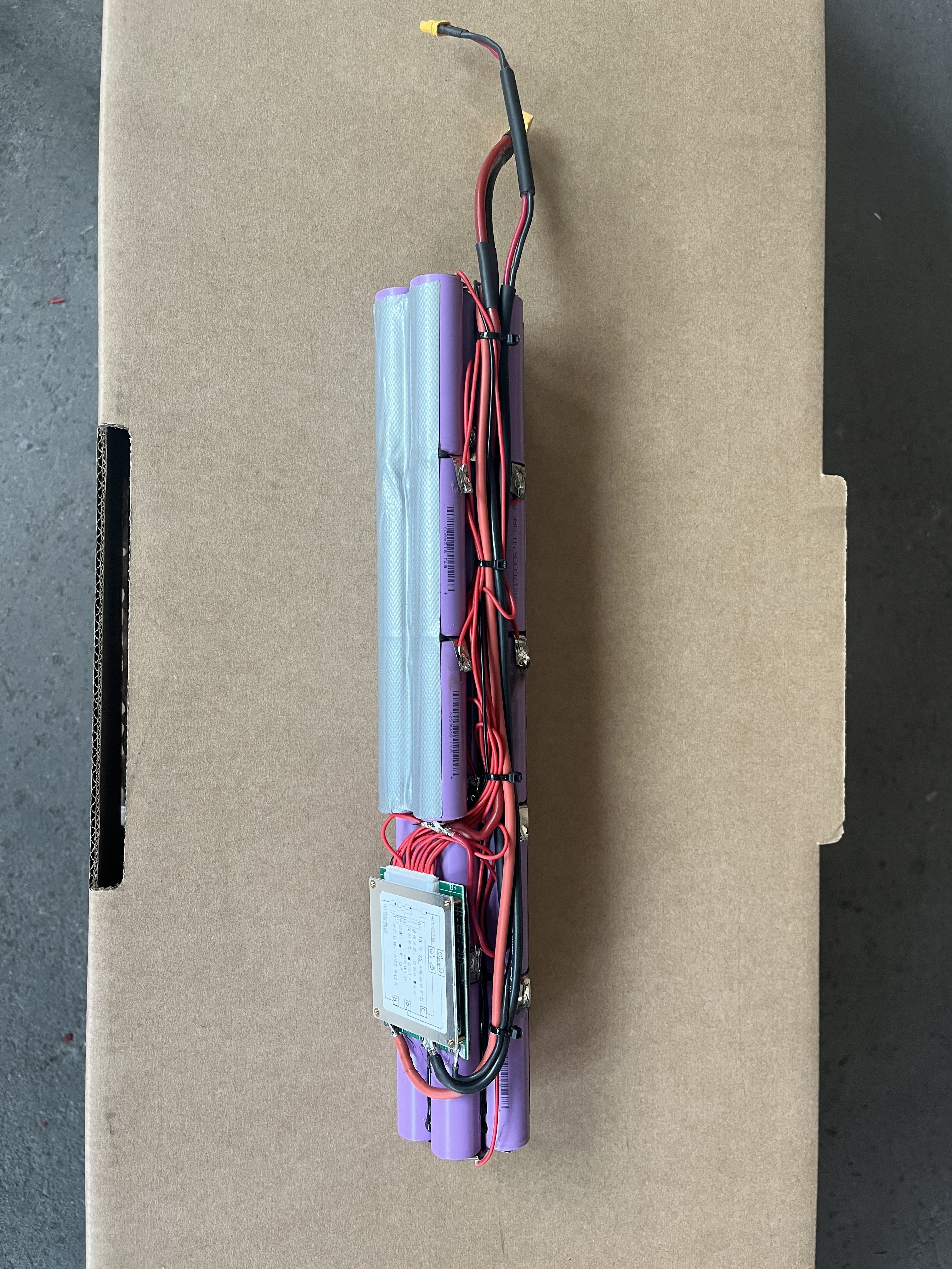

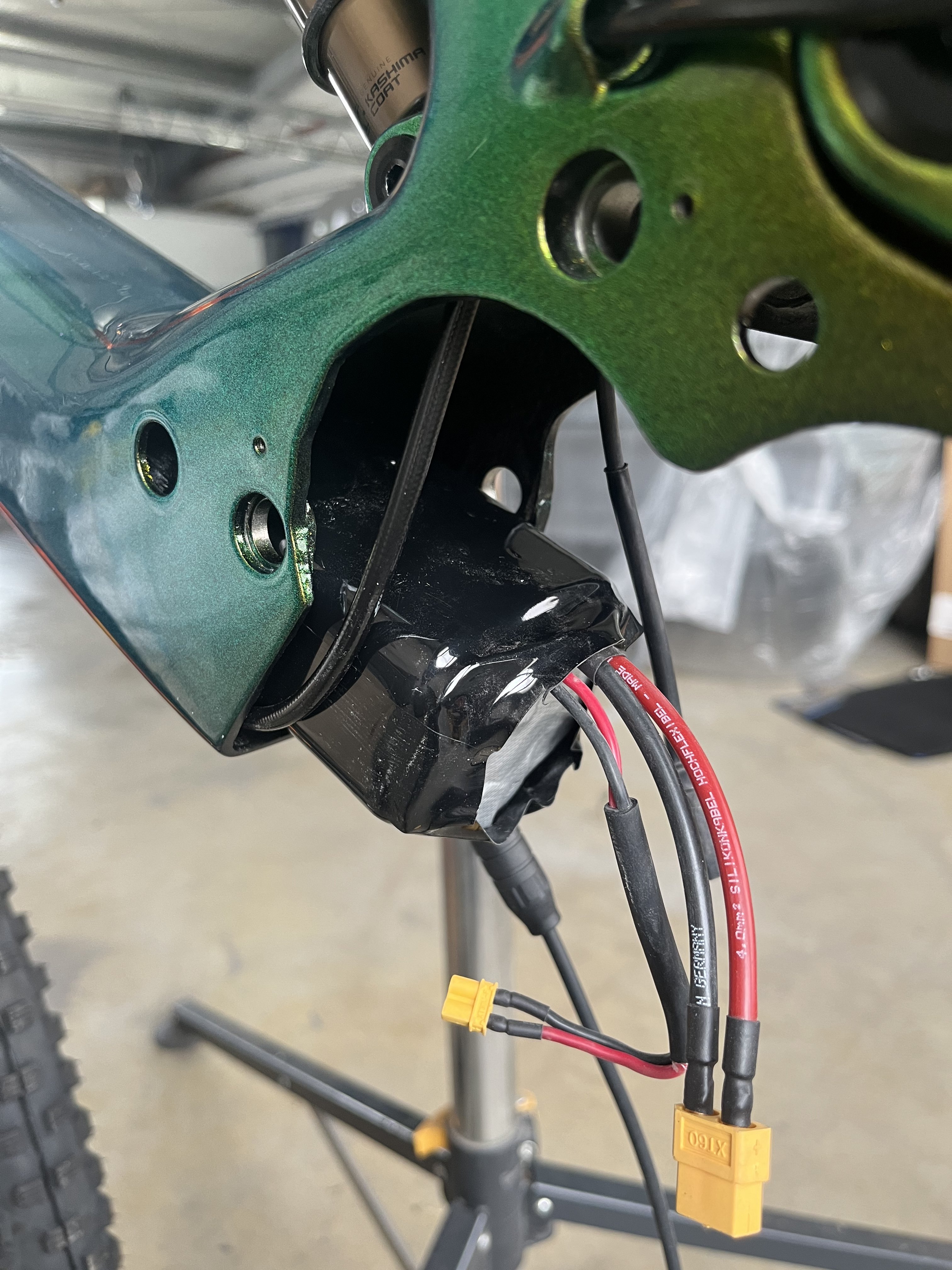

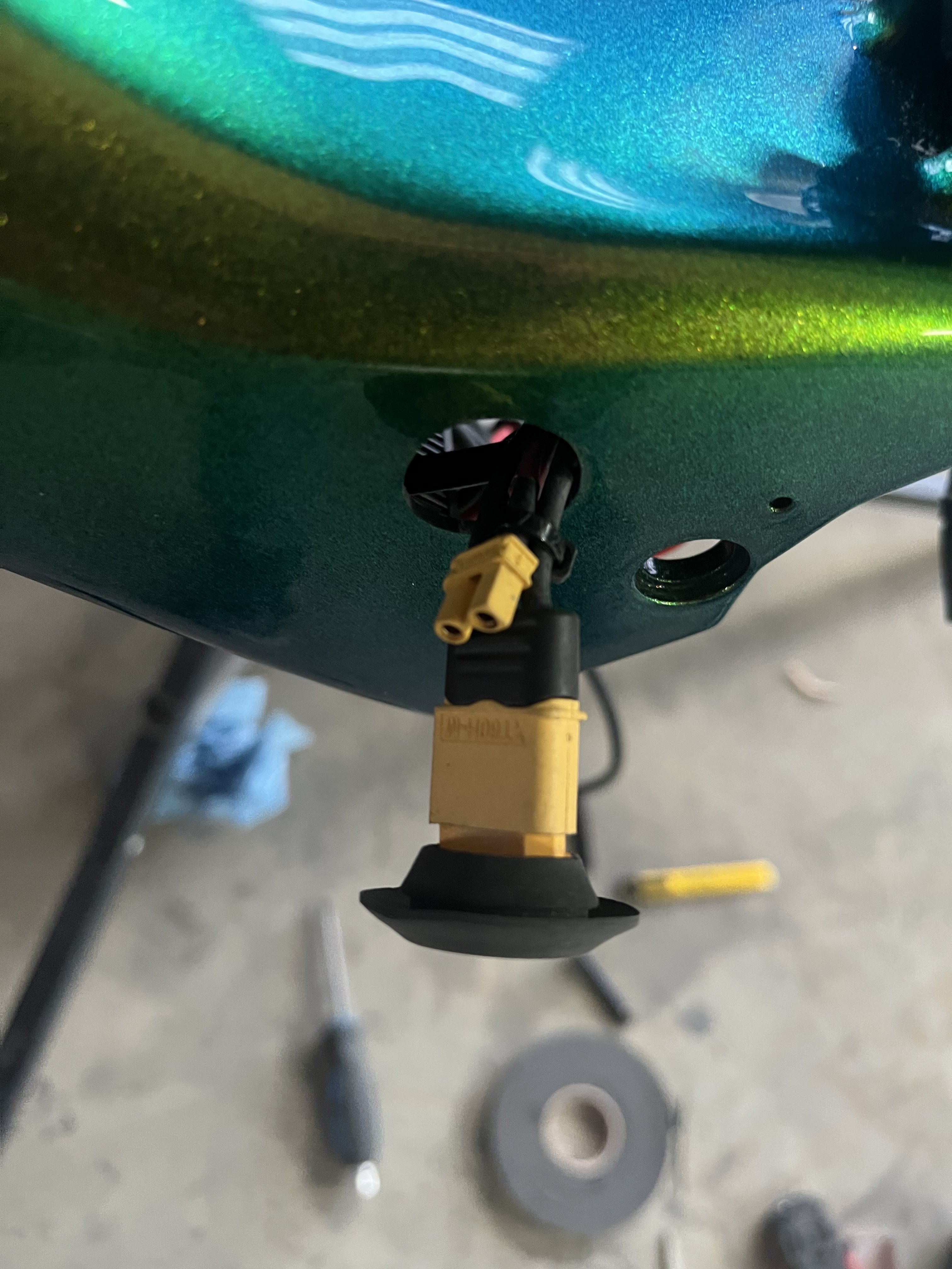

In order to fix the battery and attach the dual battery discharger, I made an aluminum bracket…
I attached the connections for the range extender and the charger with a rubber stopper and pull them out of the frame when necessary, I couldn't think of anything better 🤷‍♂️
View attachment 124280 View attachment 124281
If you’re using axs, you can use the exit hole of the derailleur line for the range extender but it’s a bit far
