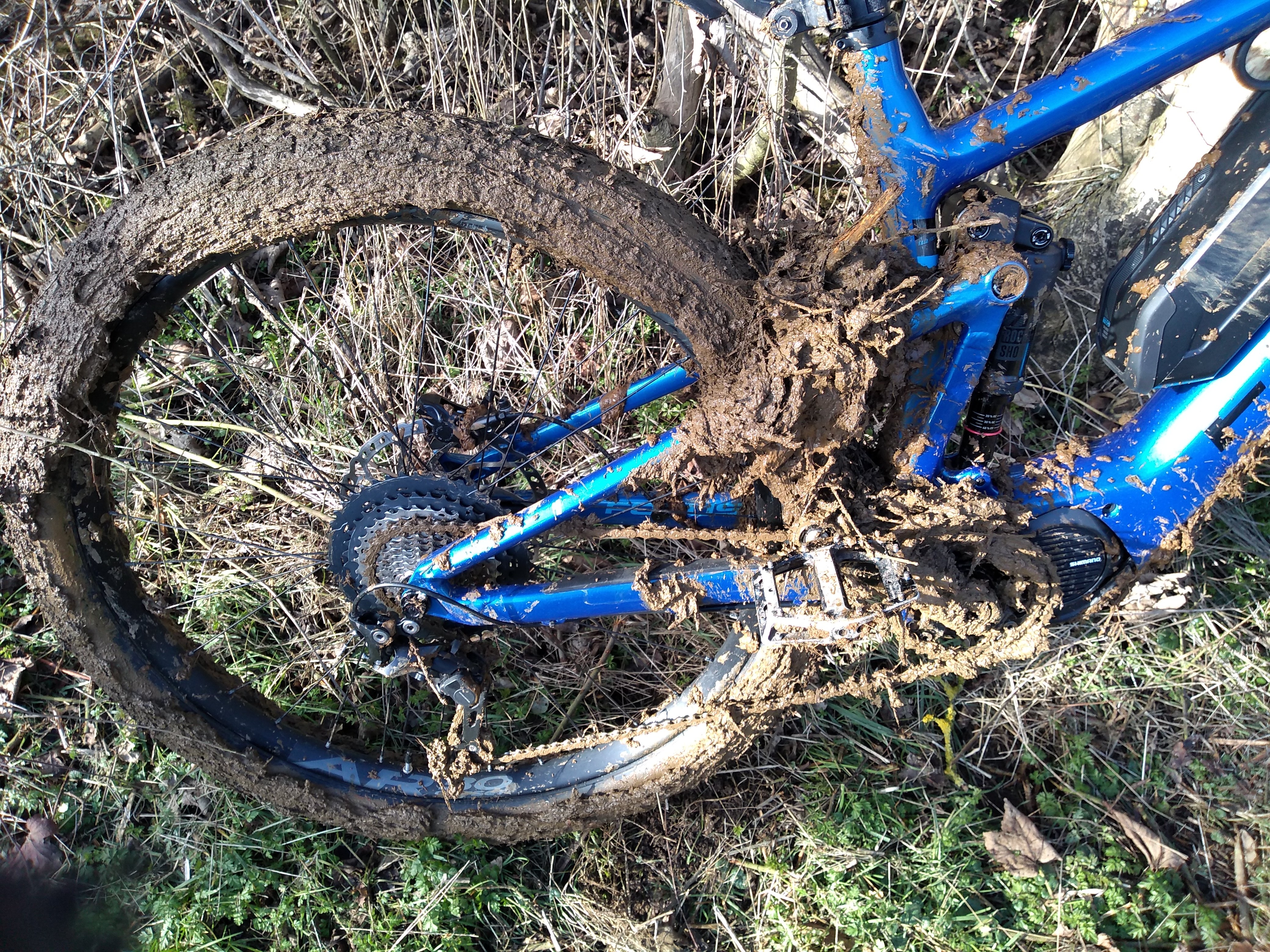

@steve_sordy's a funny boy, he is.
What is this "mud" of which you speak?
