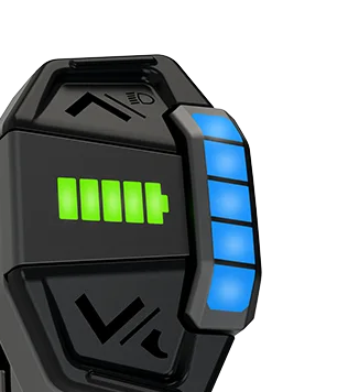

My motor kit arrived today. Battery coming separately. Question, I did not get a display with the controls....just the level switch and cables etc...no readout. I assume that should be standard?

That is just the assist switch, I am talking about the computer. Now there is a computer that has the switch built in, a big unit like the 181?

The lights act as assist level indicators. You should be able to use the motor now.

Turns out the new provided display is just
Yes confirmed this is what I have. Its so basic looking that I thought it was just the controller. It shows battery level and power level which is actually cleaner than two different units on the bars. Simpler for my intended rider as well!

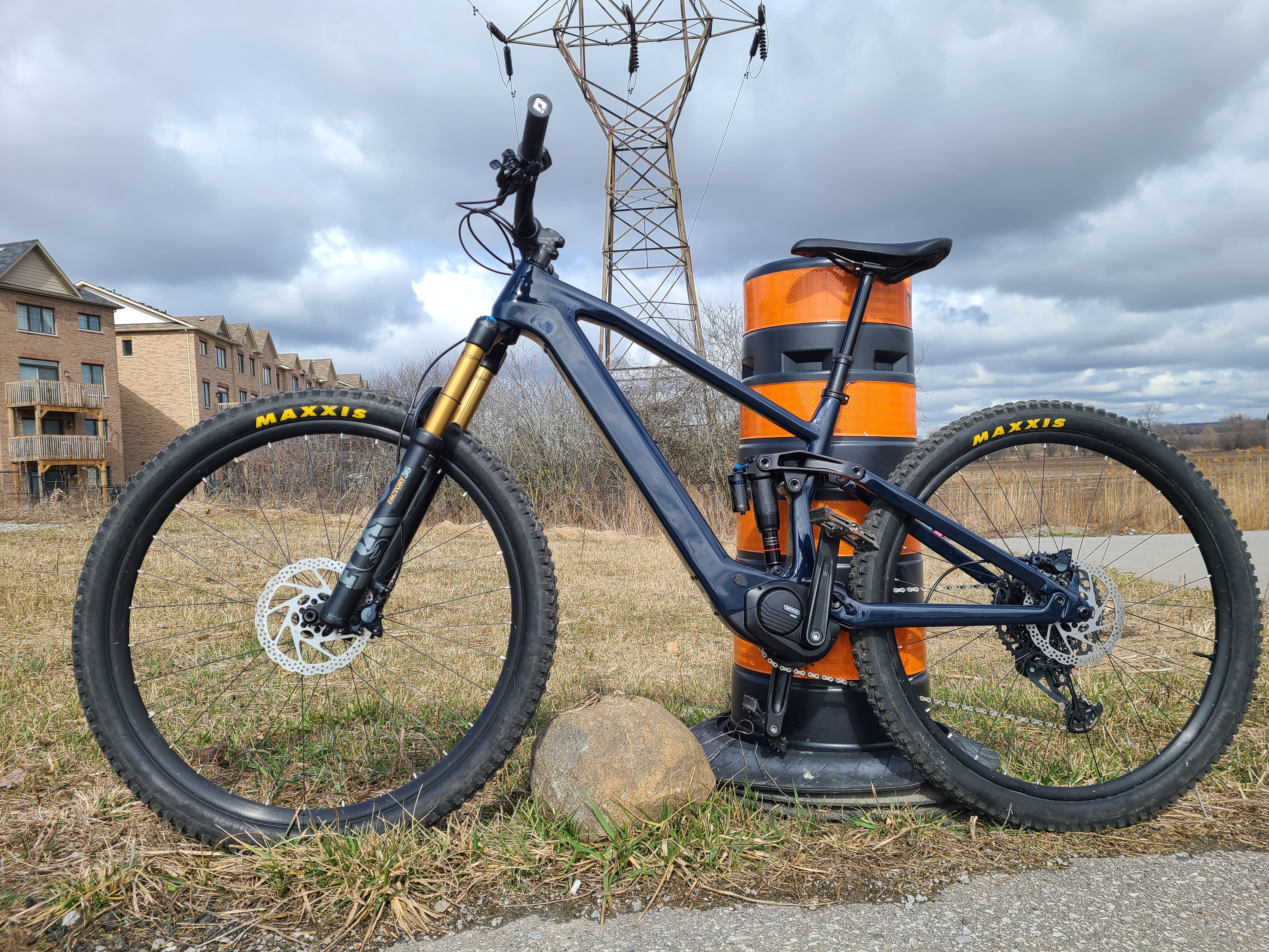

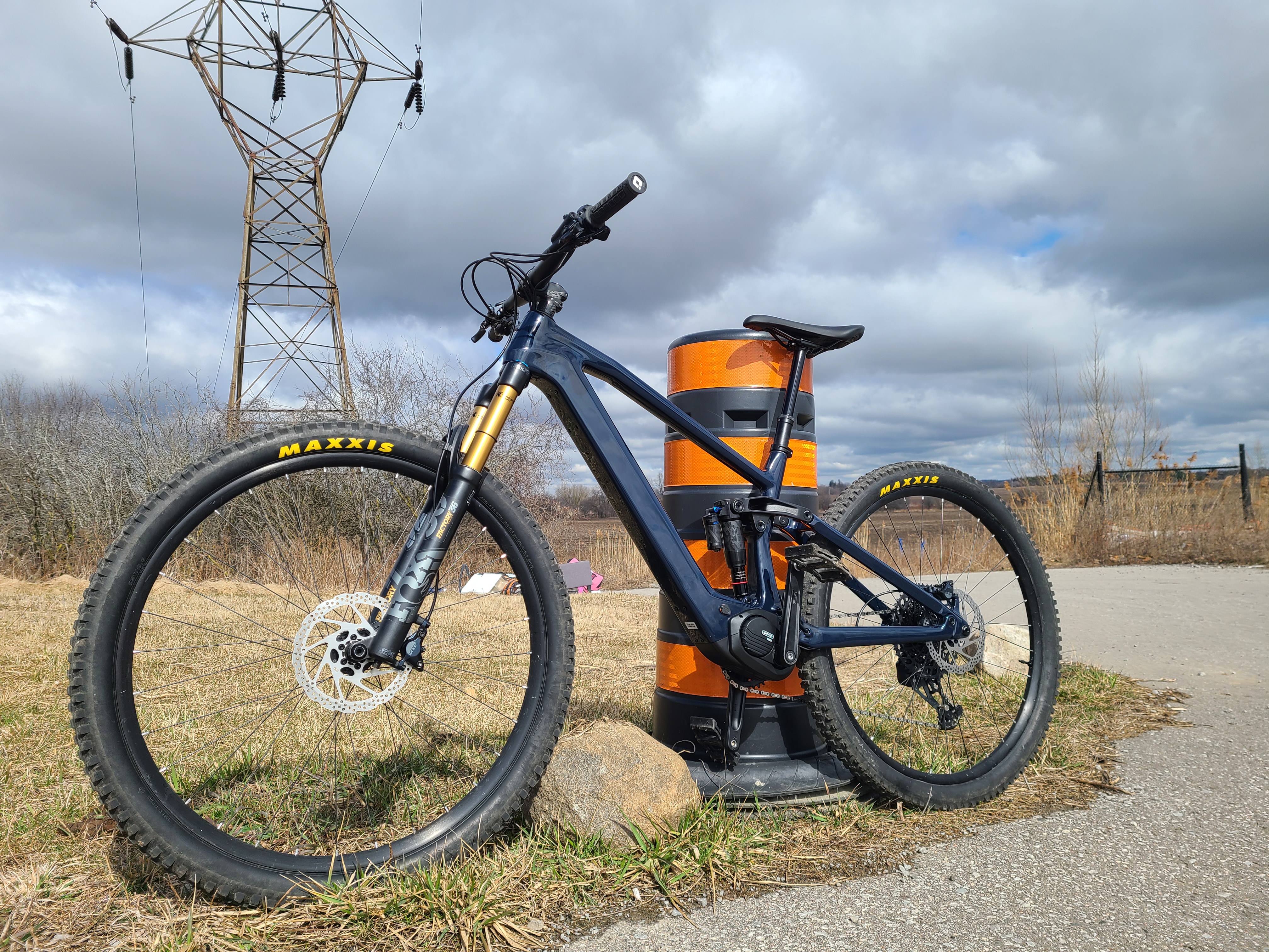

Quick first ride around the hood. Never been on any ebike of any type but ride a TON of full sus cross country and trail. I built this for my wife so she can stay with me and push me a bit vs getting killed on hills etc. This thing is amazing!! Feels like my Rocky Mountain Instinct carbon with power off. The power on is so incredibly seamless and quiet!! Just blown away with it. Kudos to Light Carbon and Bafang. I have two small gripes.....1. the control readout is not very bright so its a bit hard to see in bright light (even cloudy) and the headset routing is a curse. The little rubber plug that comes with it is a joke and impossible to even put on and getting the fork in and battling that thing is really frustrating vs just plain ports. The rest of the fit and finish is top end!

Quick first ride around the hood. Never been on any ebike of any type but ride a TON of full sus cross country and trail. I built this for my wife so she can stay with me and push me a bit vs getting killed on hills etc. This thing is amazing!! Feels like my Rocky Mountain Instinct carbon with power off. The power on is so incredibly seamless and quiet!! Just blown away with it. Kudos to Light Carbon and Bafang. I have two small gripes.....1. the control readout is not very bright so its a bit hard to see in bright light (even cloudy) and the headset routing is a curse. The little rubber plug that comes with it is a joke and impossible to even put on and getting the fork in and battling that thing is really frustrating vs just plain ports. The rest of the fit and finish is top end! View attachment 136369
Nice build!!
There is a day/night mode for the backlight (really the headlight on mode, but it also dims the display). Press and hold the up arrow for 2 seconds and it should get brighter. You can also adjust the brightness in the settings menu. Even riding in bright direct sunlight you shouldn't have an issue seeing it.

Nice build!!
it was on the bright mode unfortunately.
That's one great looking build you have, unfortunate your wife will never get the chance to ride it with you on it all the time :LOL:. Sounds like another build might come soon. Fortunately the display issue can be fixed with a different one, the headset routing though I agree not a fan.

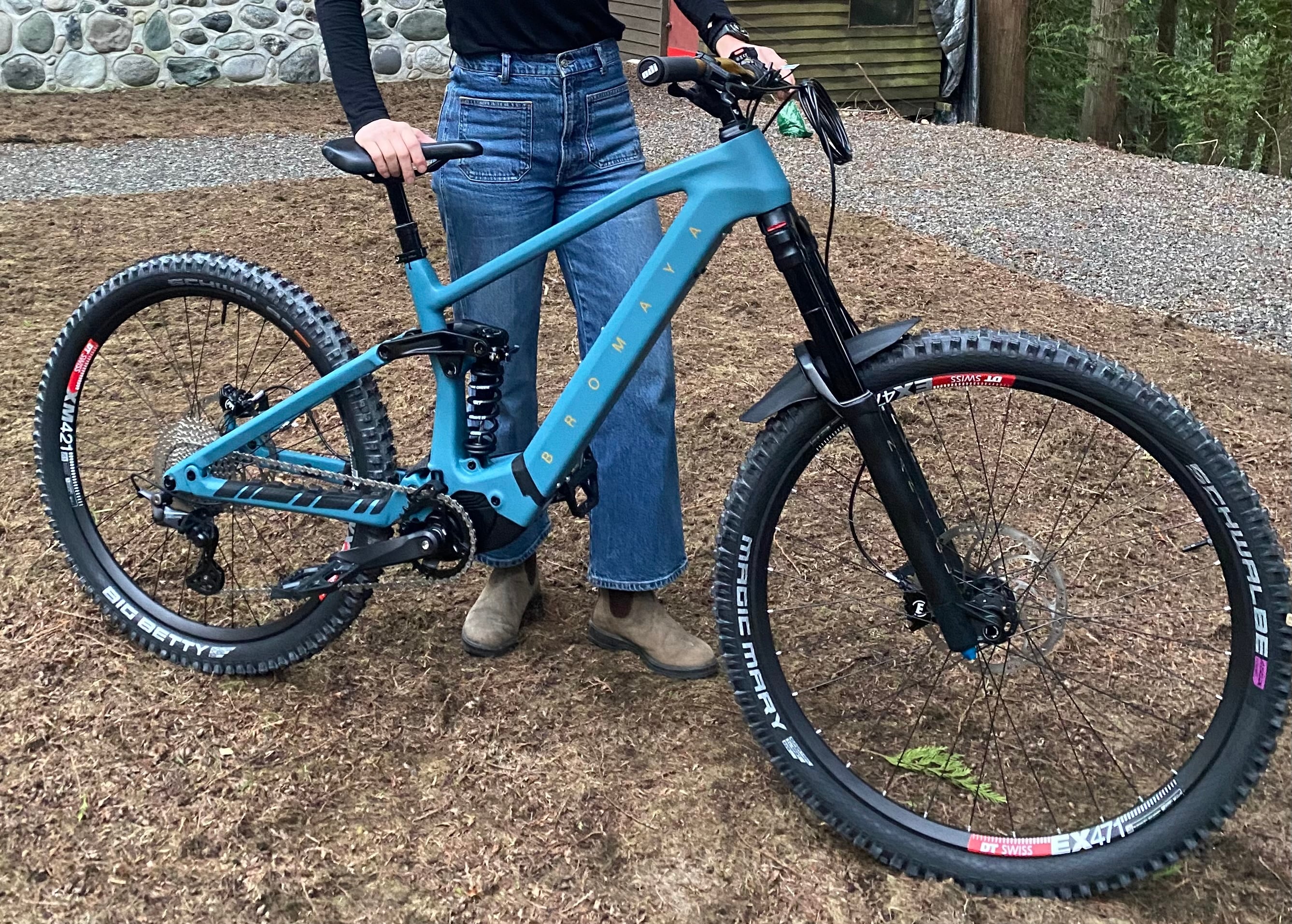

I thought i'd post an update. I'm about 15 rides into my bike and I recently built up my wife's, Same build with the fork and shock being different. Her medium is coming in at 44.5lb and my large is 46.5 (I have marazochi z1 coils that are heavy!! 2.7kg almost! I also have the Kitsuma coil shock and she has the cane creek inline which if I was buying again I would probably go the same components as her.) so far everything has been running great and we've really been enjoying the bikes.
