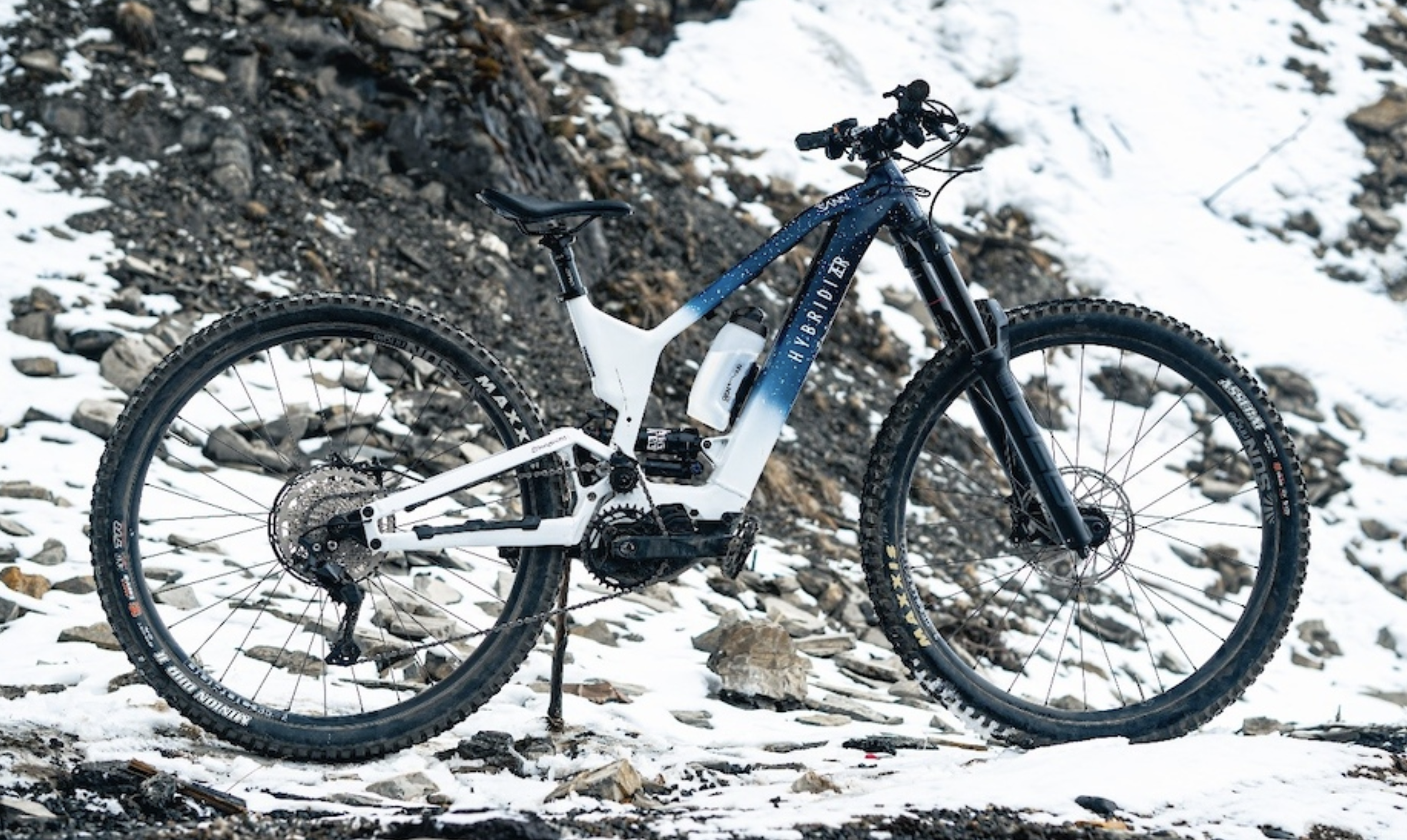

This bike was posted in the Frey Dopamine thread by @Cit and is a similar design but with some substantial differences? Link to the Pinkbike article about it that has more info than their website: Hybridizer Announces Its First Bike eMTB Frame, SANN - Pinkbike
It is an idler design which is the same but if you compare the two frames they are different. Most notably the battery (720wh) is a bottom loader and that filled in area at the seattube junction is a SWAG box. Not sure if the rear dropouts are UHD but as they are modular certainly wouldn't be hard to do so.
The SANN company seems to consist of a couple of young engineers and they are bringing this forth as their first effort. Gives me a bit of hope that they will be a little more willing to work with customers that already have their own bits? The frame/electronics market such as DengFu caters to is popular and as time goes on I see it getting more so perhaps? There are so many component options these days, including the ones in your shed, that it just makes sense for someone to add to that market.

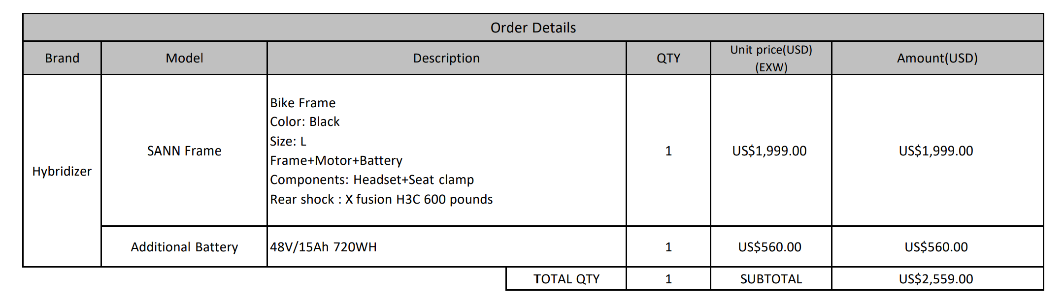

A month ago I ordered the frameset with M510 and 720Wh battery. I made the 300$ deposit and it will be shipped by end of November. Today I received the info, that all orders of Hybridizer frameset or full-bike will receive a free "X fusion H3C" (FREEH3C) rear shock.
For DDP shipping to Europe, you can contact Chili Shen.
To make an order either contact [email protected] or place a 300$ deposit on their website. Use the keyword FREEH3C, to get the additional shock (paste it in "additional comments" or tell Ezio): https://hybridizer.com/product_details?lang=en

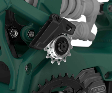

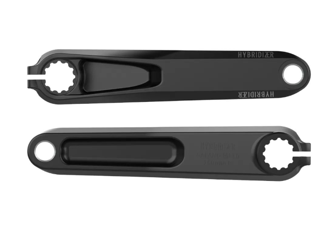

I wanted shipping as DDP (tax paid in advance) and Chili Shen from Fieldebikes agreed to forward it. Hybridizer and Fieldebikes are both located in Guangzhou, so Hybridizer did not charge extra 30$ for shipping locally. I await my to be shipped soon. Since Ezio left them, his colleague Zhiwei contacted me and asked if I want some of the newly arrived parts: Enhanced Chainglider and 160mm Hybridizer cranks (BFG-splint). He did not say if they would cost extra. I told him, that I'd take them, if they are free, because I don't want to wait any longer! 🙄
View attachment 131898 View attachment 131900
Oh, interesting. I've been talking to Zhiwei as well, but I didn't hear anything about the new Chainglider. Ezio did mention that the cranks to me though.

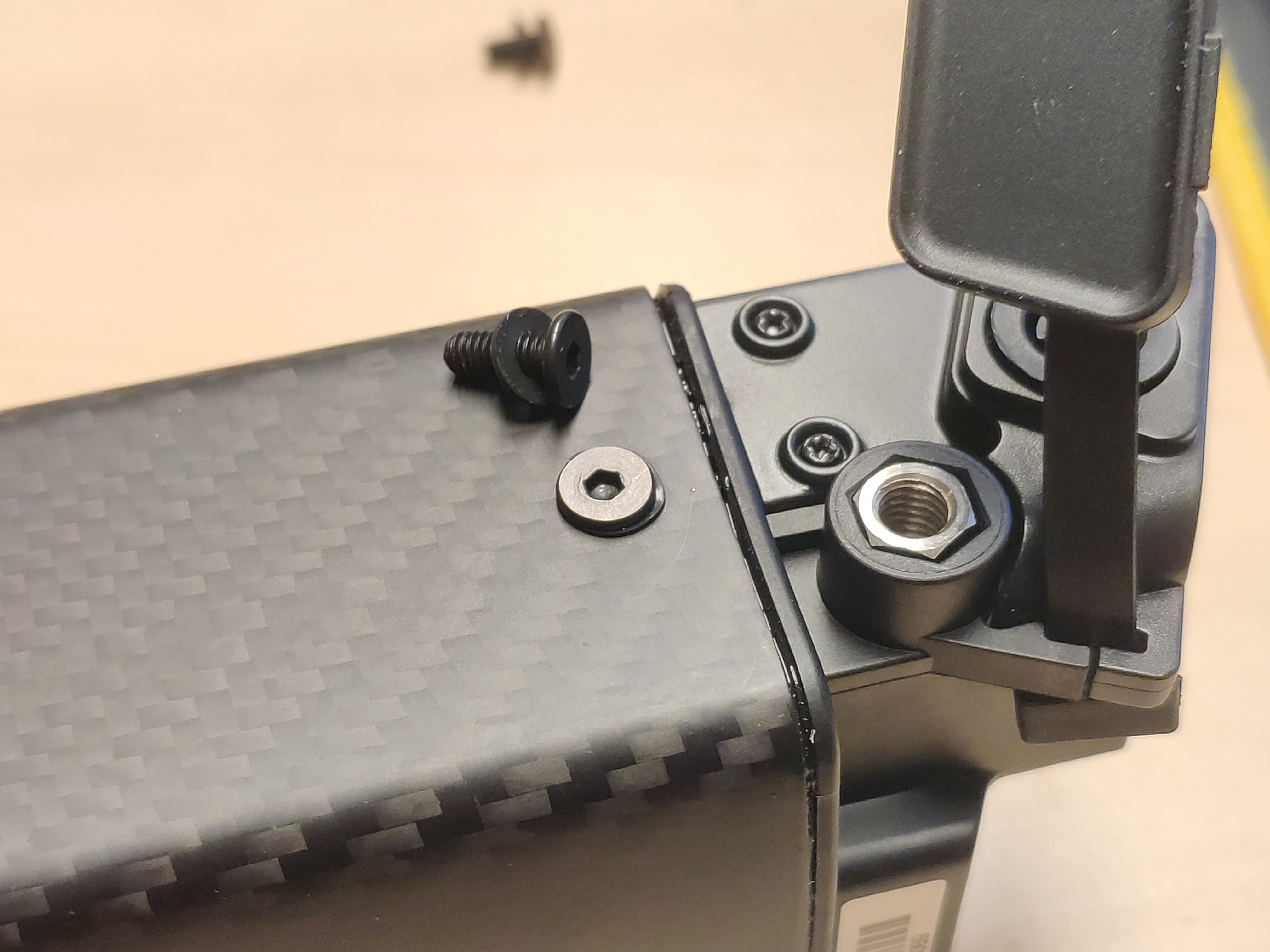

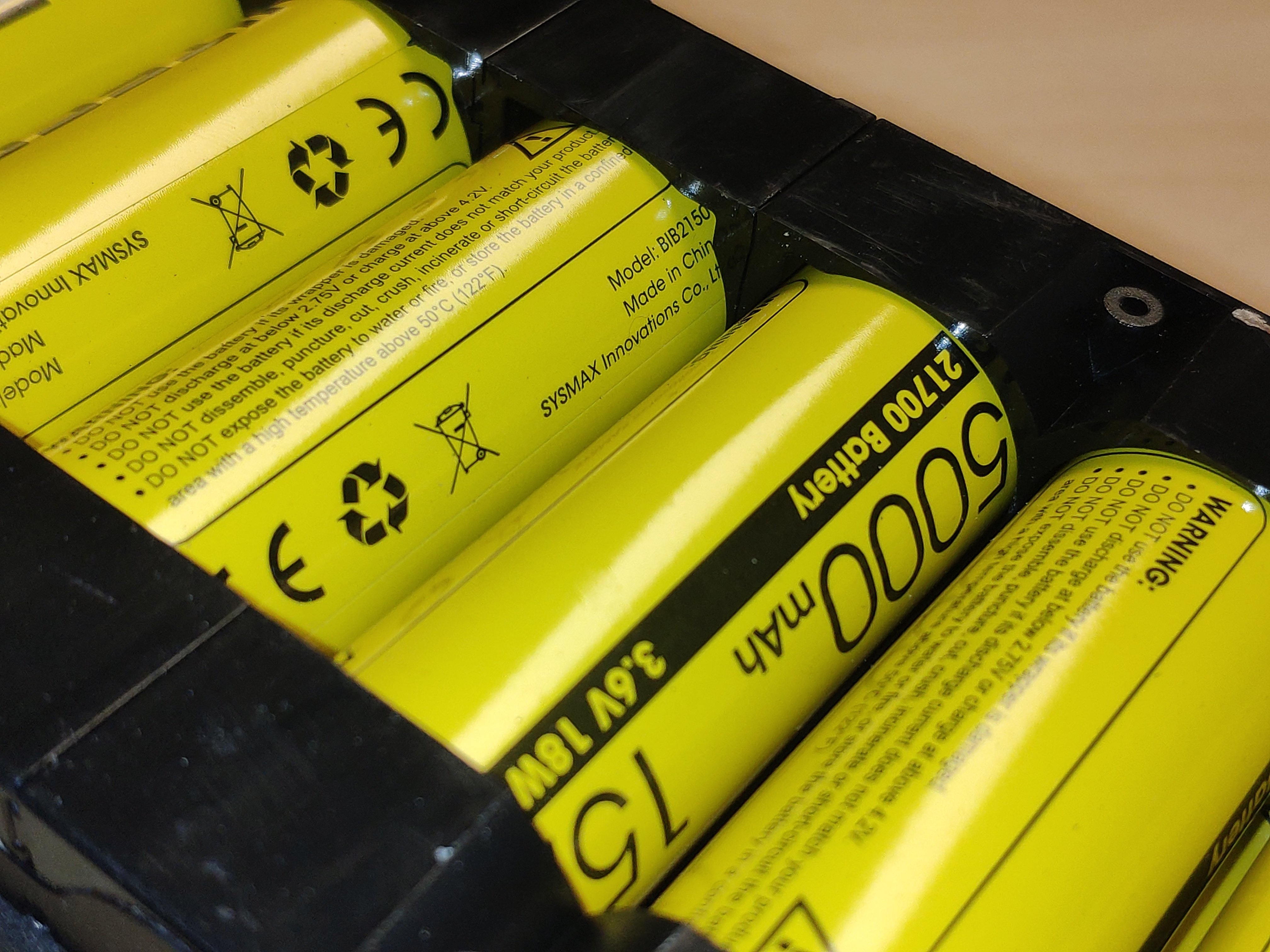

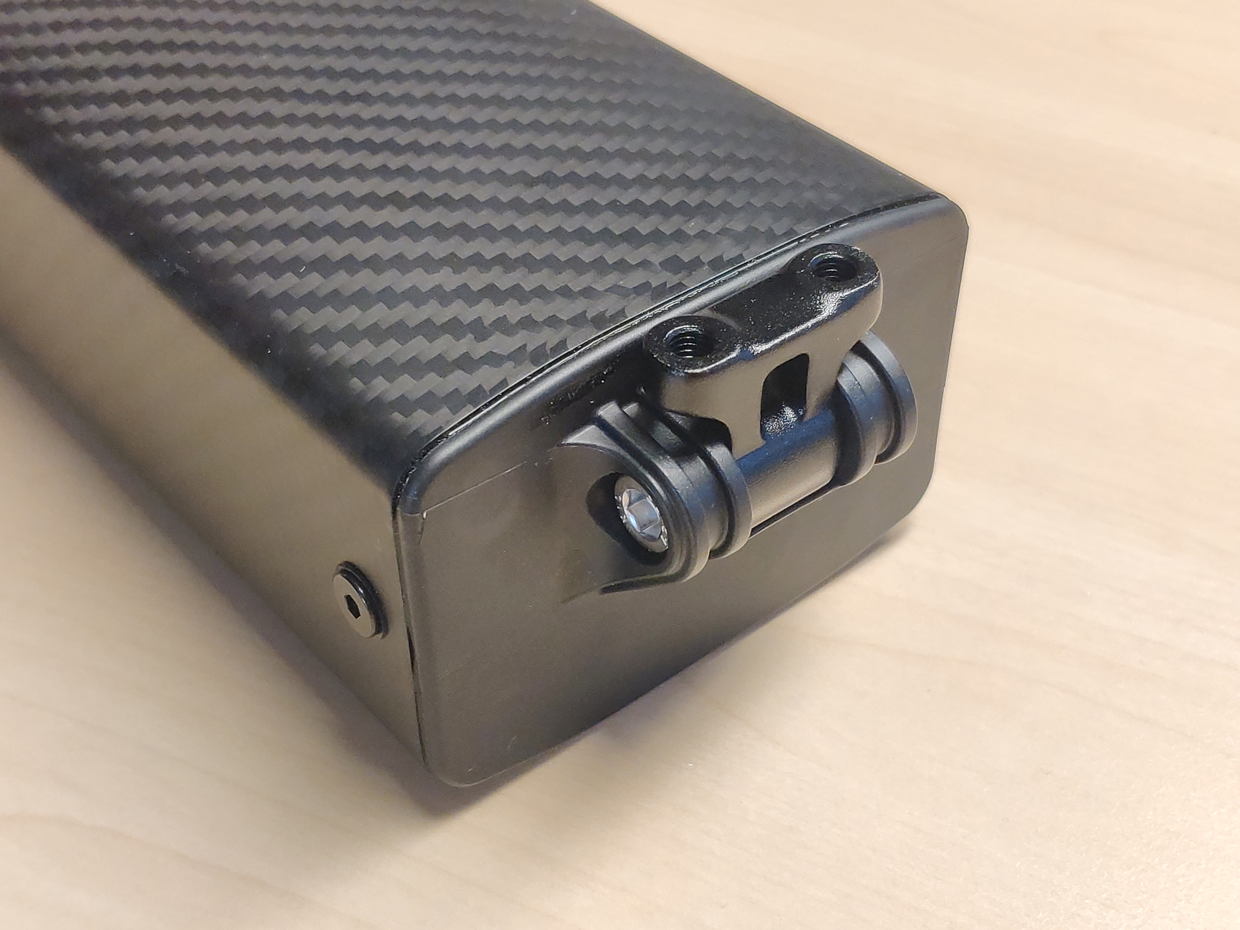

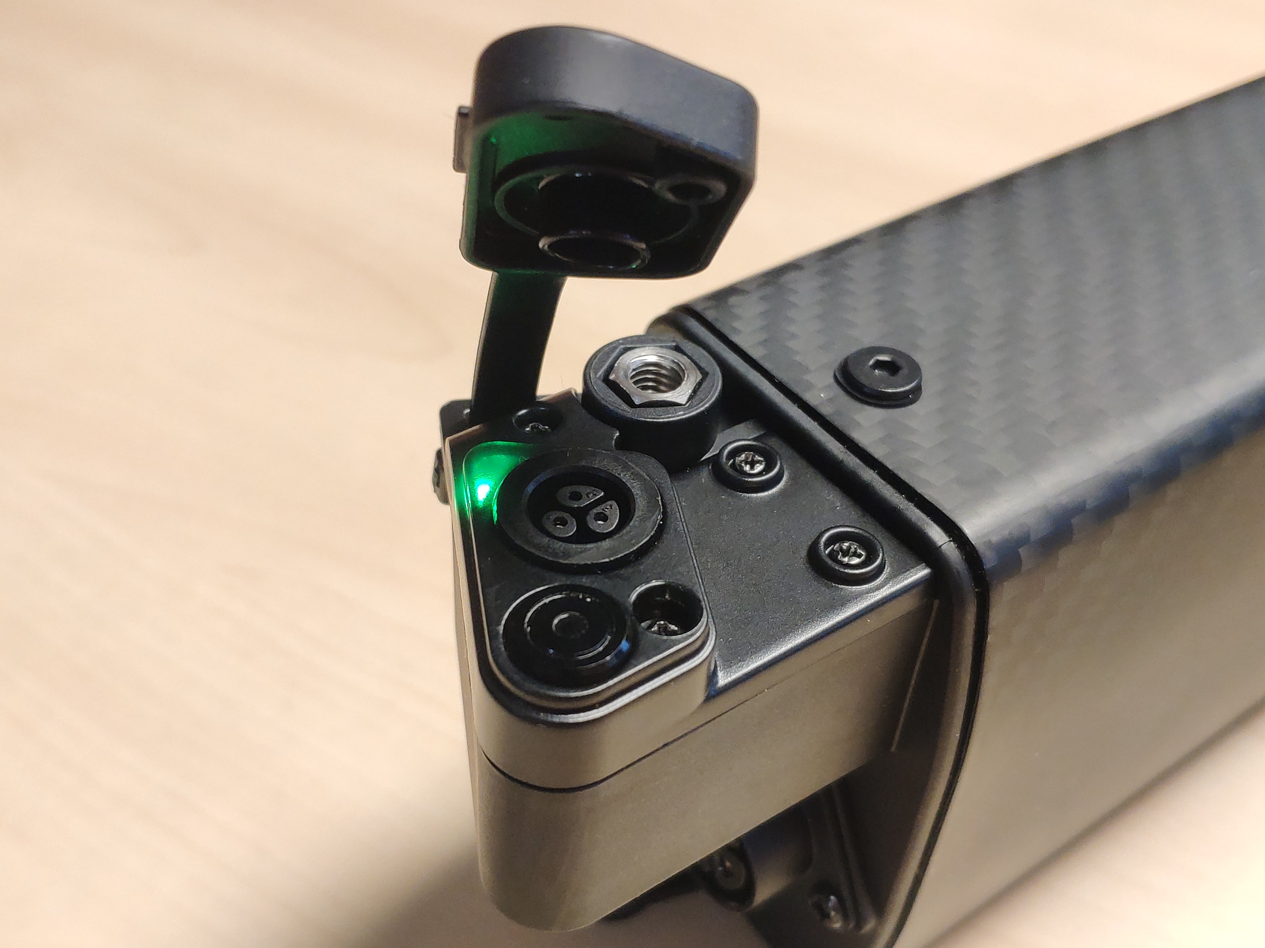

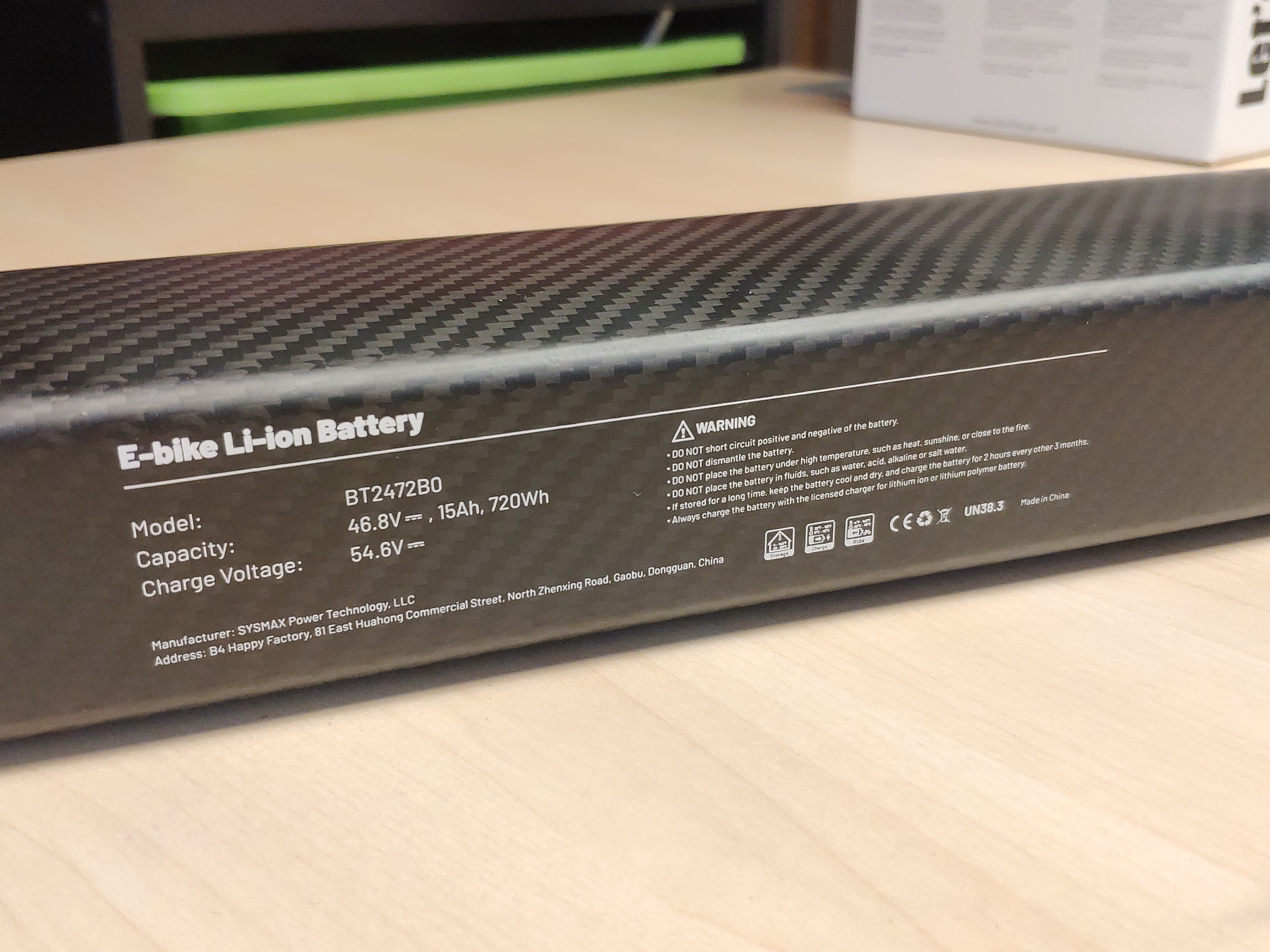

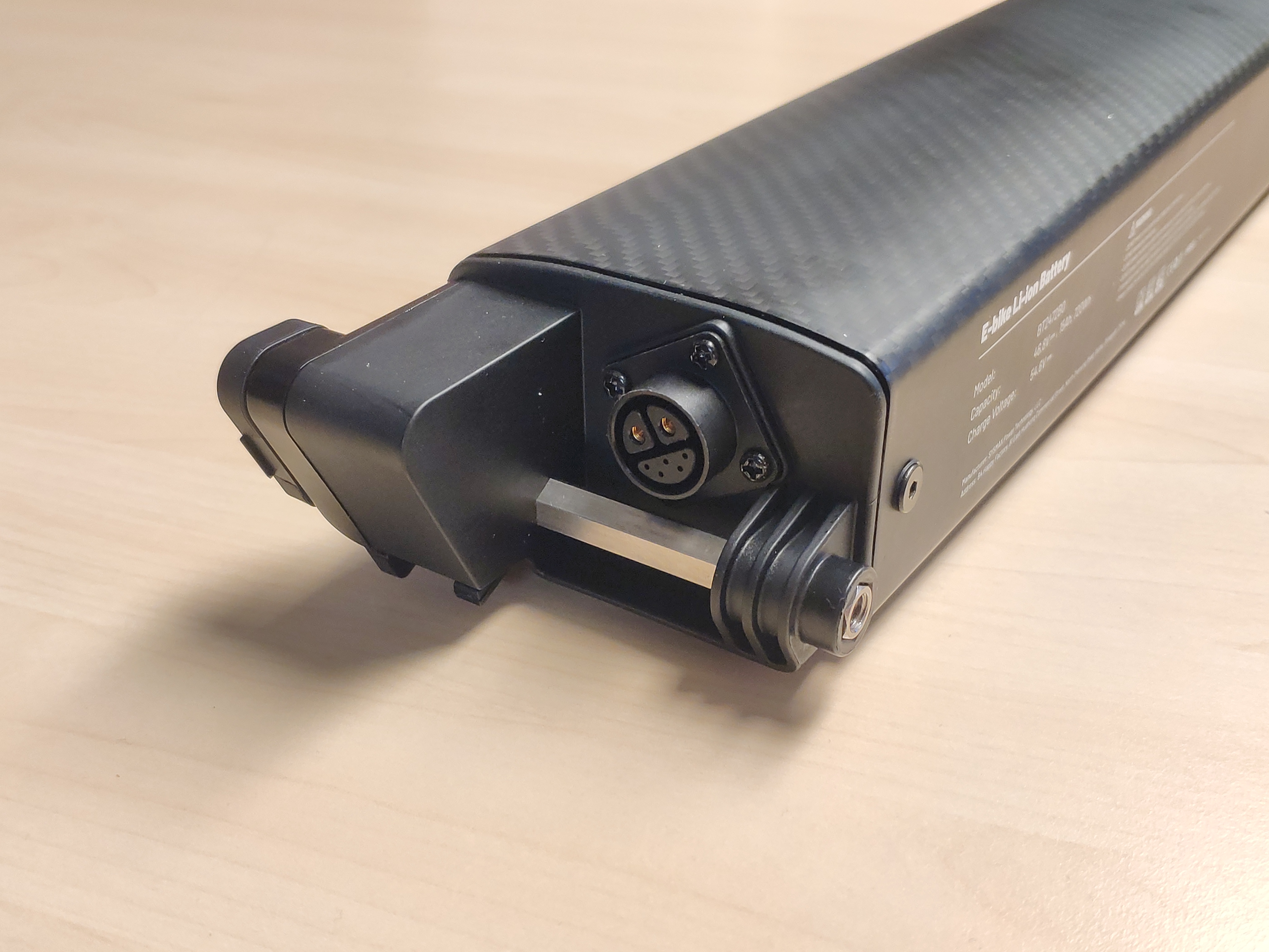

So my 2x batteries arrived this week (still waiting for the frame to be released by customs 😪) and I'm finally able to take a closer look at them. My ultimate goal is to make them 52V and I'm very determined to do this 😉 Things I've noticed so far:
They waterproofed using glueing the endcaps in with silicone 😐 This means it's not a very friendly repair, if it's needed one day.. The screws were tighend kinda loosly and torx would have been a better fitting screw for a battery enclosure. (Hex tends to strip when it got rusty..)
The cover that goes on the charging port is black rubber and the button underneath is pressable, when it's closed. However the LED is not visible through the rubber, which is unfortunate.. Can't tell whether this is important during normal use.. The connector that's connecting to the motor, inside the frame is a HIGO Z718AM C 03 GH 0300. (I suppose it's original or a very well-made copy). Only 4 pins are used for B+, B-, CAN-H and CAN-L.
The manufacturer of the battery is nitecore (SYSMAX Power Technology), a very reputable and esthablished battery and flashlight manufacturer. The overall quality is decent, however, I hadn't had a look inside yet 😉

SANN is showcasing a 720wh Carbon Fiber "battery" which I imagine is referring to the case. Unclear yet as to what cell they are using? I passed on what was available to my battery contact at DT battery and it wasn't familiar with him and he is going to check into it.
The cells are from NITECORE and labeled as BIB2150. Best guess from Mooch over here, was that they are rewrapped. I contacted them, to get a datasheet and some info about their max discharge.

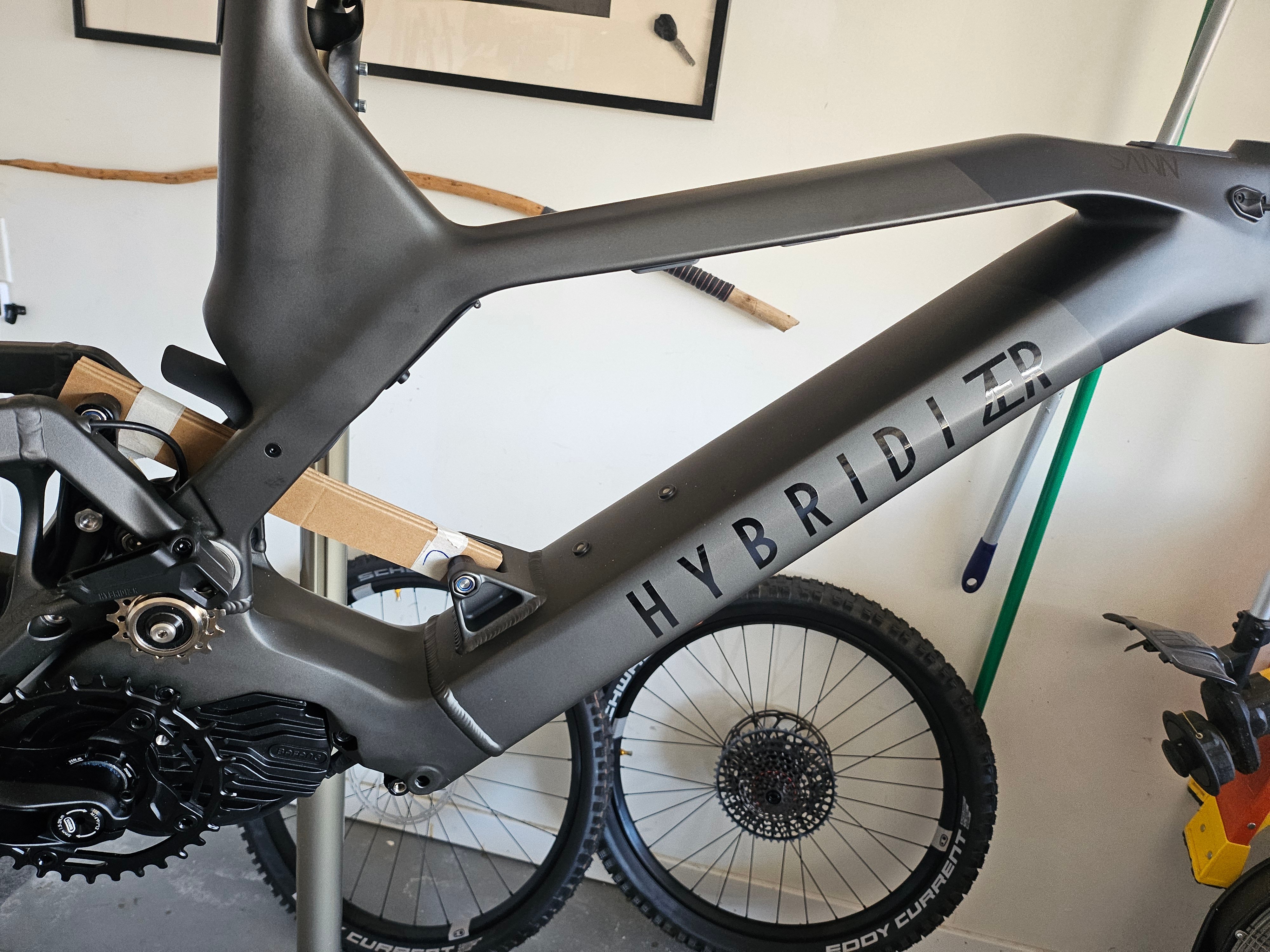

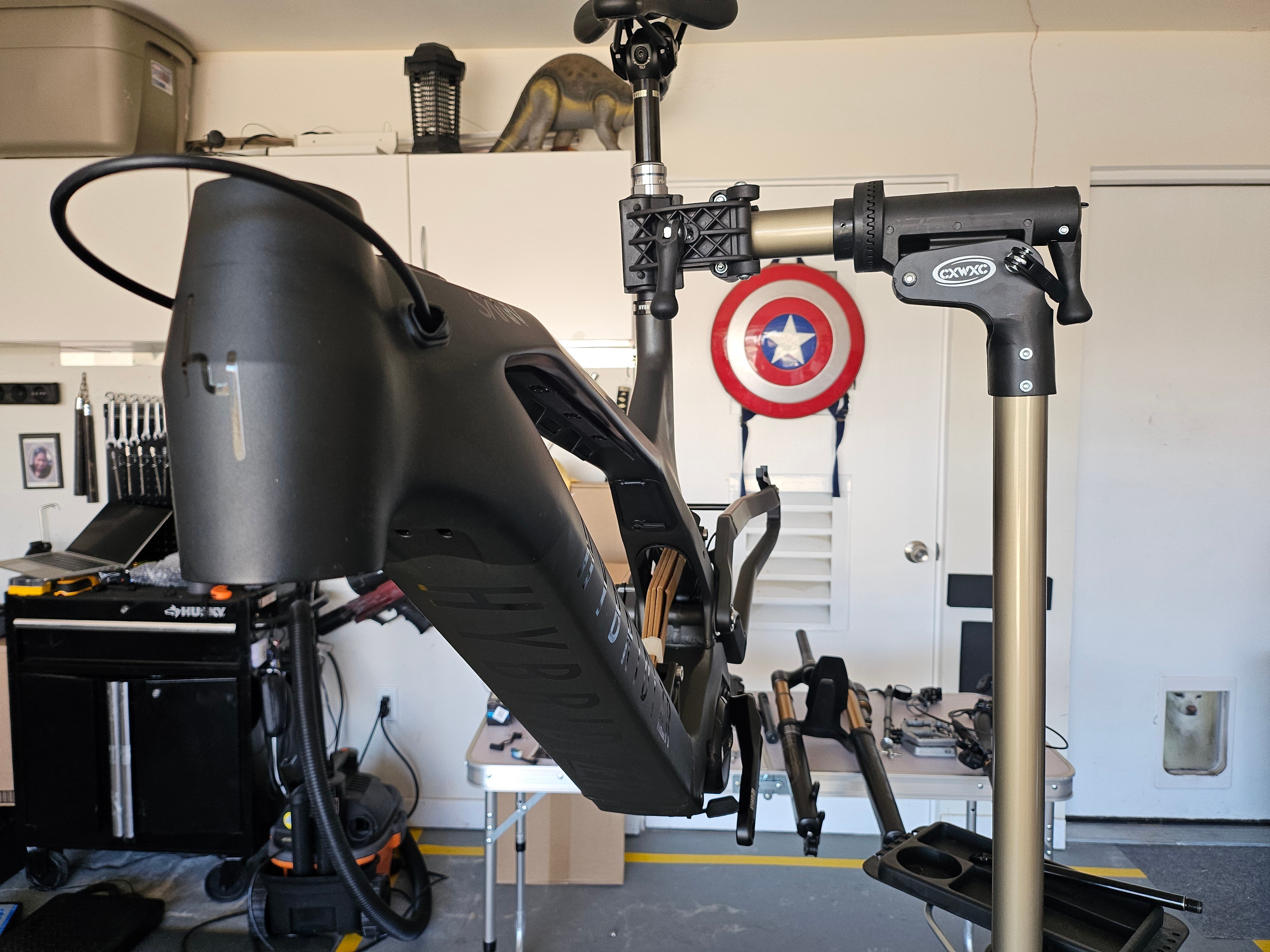

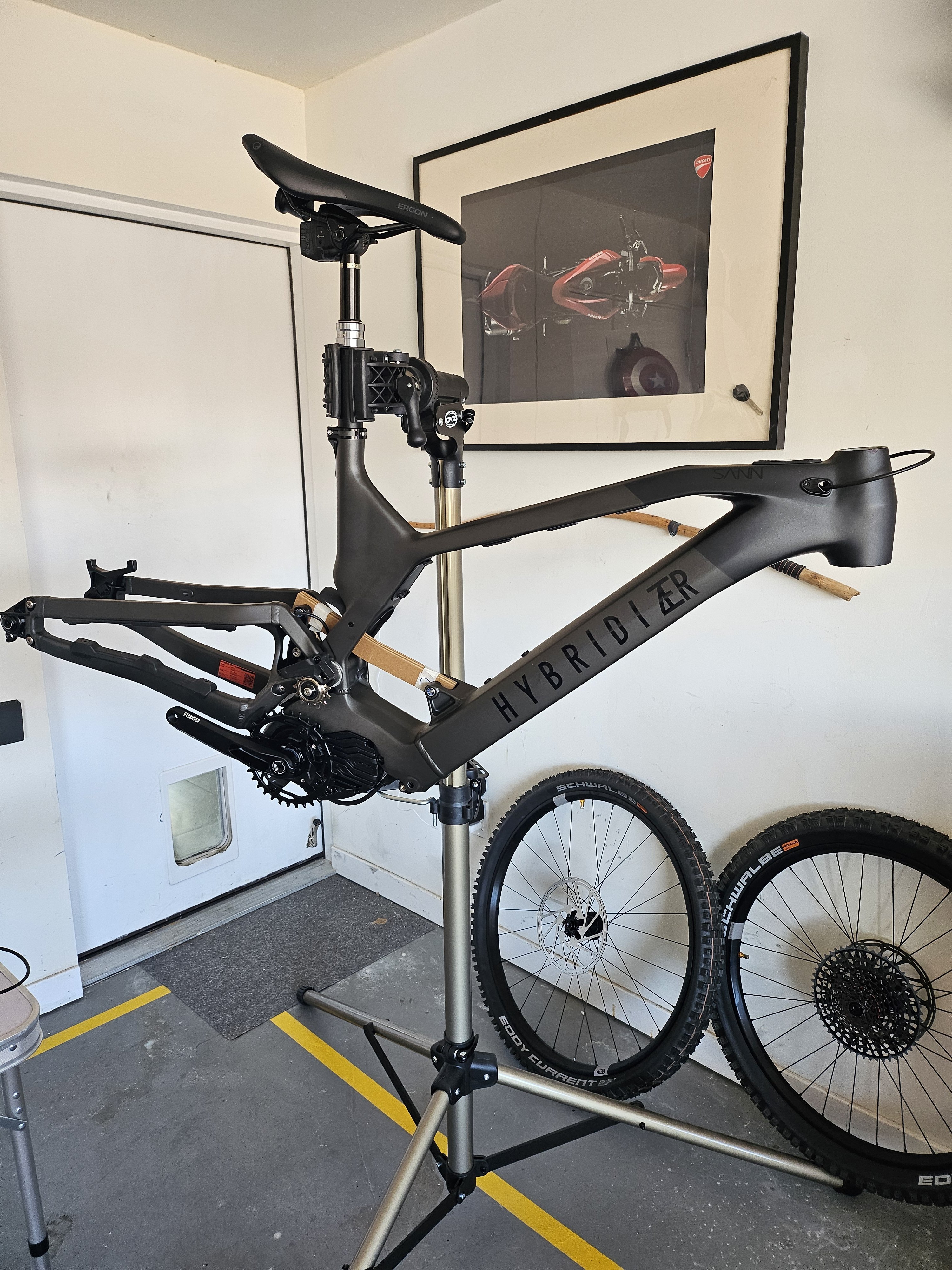

Do you paid customs @D'Apostrophe? And how heavy is the frame itself, without the battery?
No customs. I've never had to pay on anything aside from the sellers shipping fee from China direct. (Alibaba, greenbike kit etc.)
The weight for the front triangle without motor is 3.4 kg (7.6 lbs).
I can't weigh the swing arm at the moment because it's undergoing a custom paint job.
One annoying thing is that the motor has to be removed to take out the battery. Also, if your bottle cage screws are too long they will impact the battery case.
Be aware that there's no, or very little grease on the swing arm pivots.
