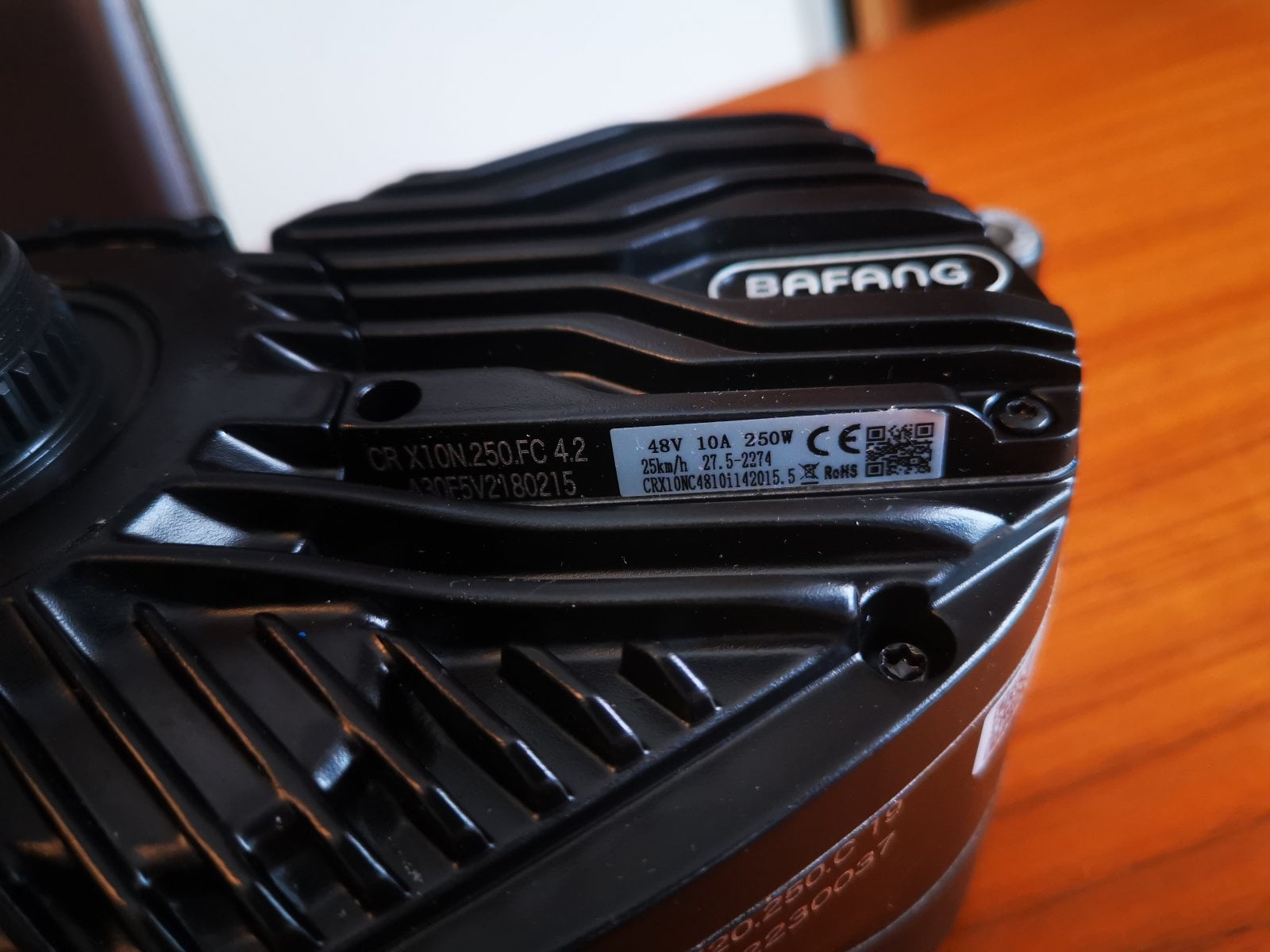

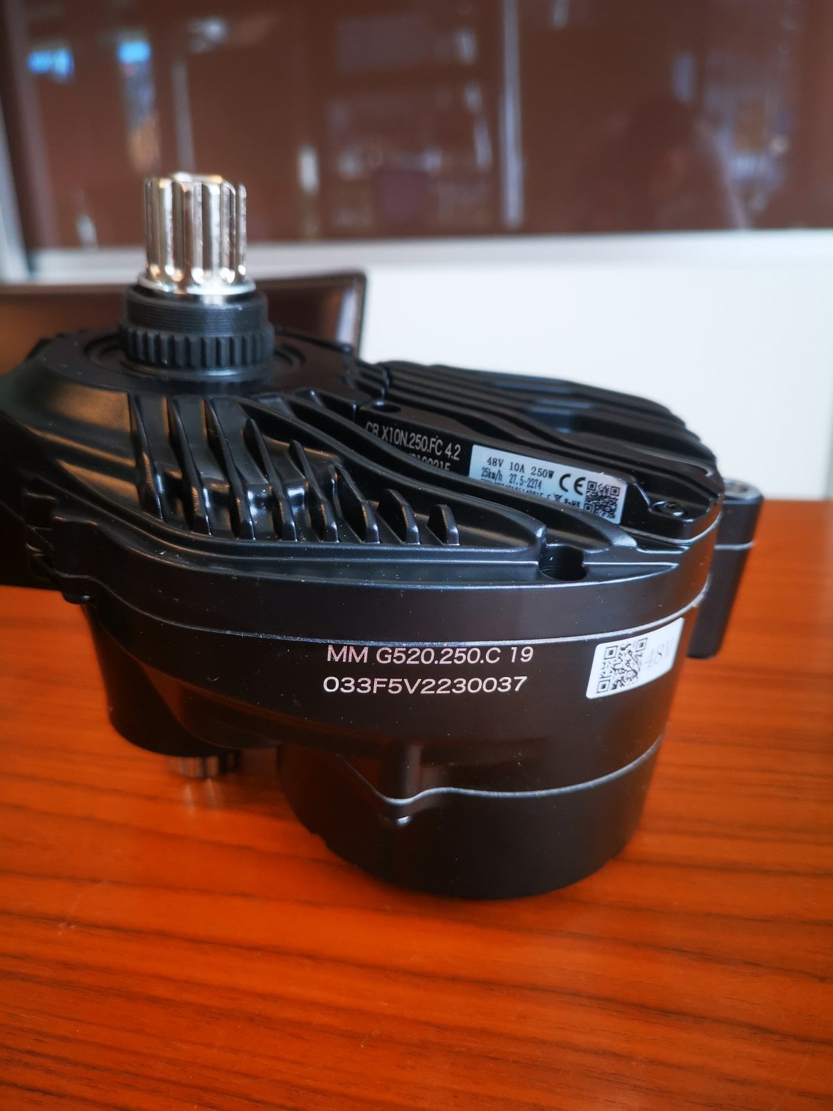

What do you mean with "optimzed battery"? Attached you can see the details of my M500.
Kyokushin
Mar 28, 2021
330
192
Sol
same as mine, i had same firmware initially.
Optimized battery - that what i got from Bafang representative when i provided the feedback an engine is loosing power in function of battery discharge.
Is the stator the same?
Bafang support representative informed me its different, but i have not verified that.
