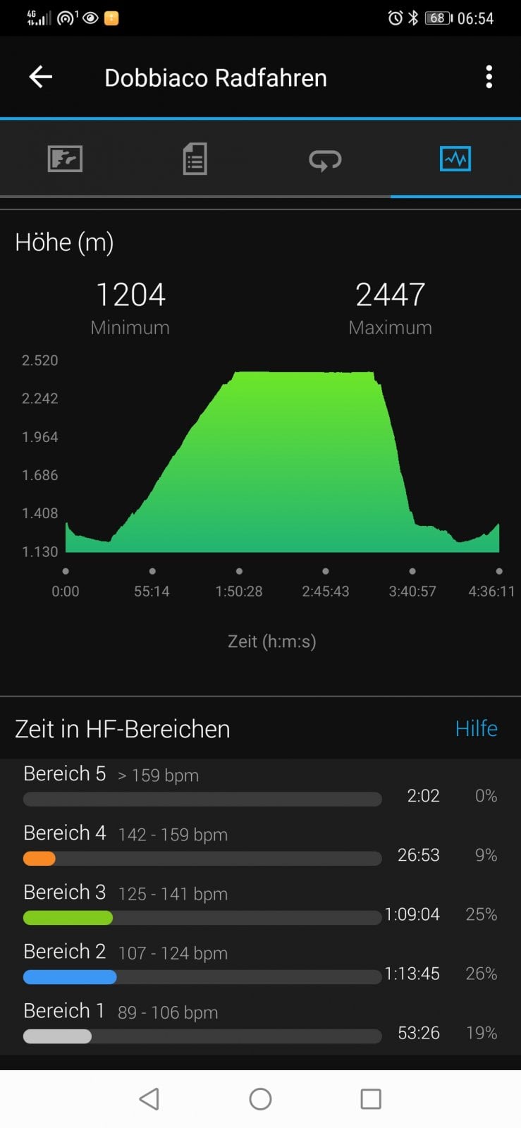

I just did a long test of the new firmware yesterday and for me it is great. We did 46 km with 1460 m of ascent, battery life at home was still 15% and i used only levels 3, 4 & 5 as we did some steep tecnical uphill. Motor gives plenty of power and also under 20% of battery still gives around 250 watt.
Motor with this performance is nearly at the Bosch and Brose (friends drive Specialized Levos, Cube Action Team or Trek rail 10). Of course their motor in steep uphills gives more power then bafang m500 but you can stay close to them with a bit of effort. This wasnt possible with the old firmware (if i am right it was not the 12A but the 10A). For me this motor is just great ?.

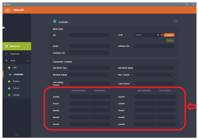

sorry ... I can't do it because the bike hasn't arrived yet; you can check the configuration shown by the BESST instrument as per the attached image, I refer to the part relating to the 10 levels of assistance.
They could give us some elements of comparison between the different versions of FW.
These settings are not readable when you connect the bike. Its only something is besst visible with empty values before you connect.
