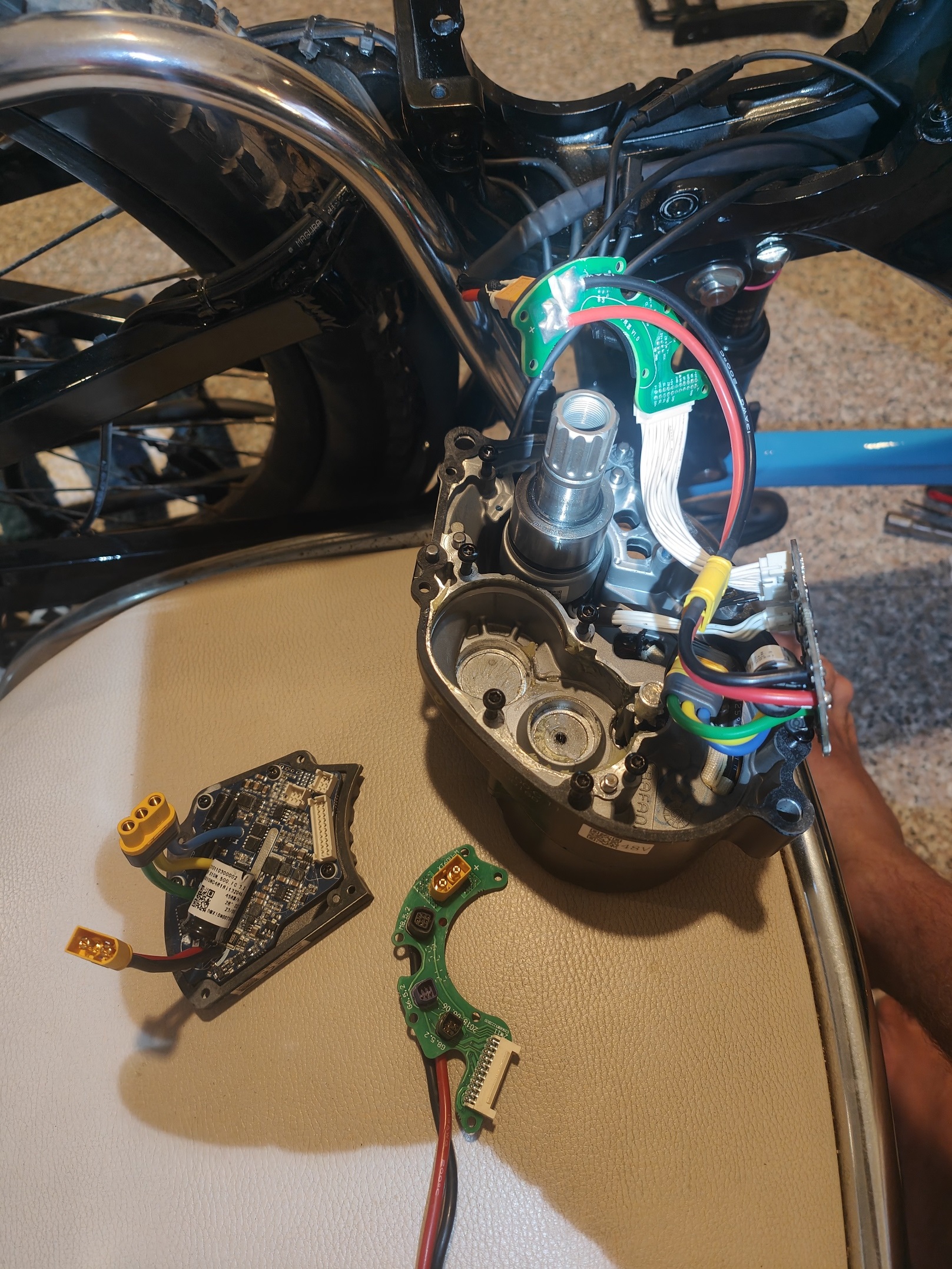

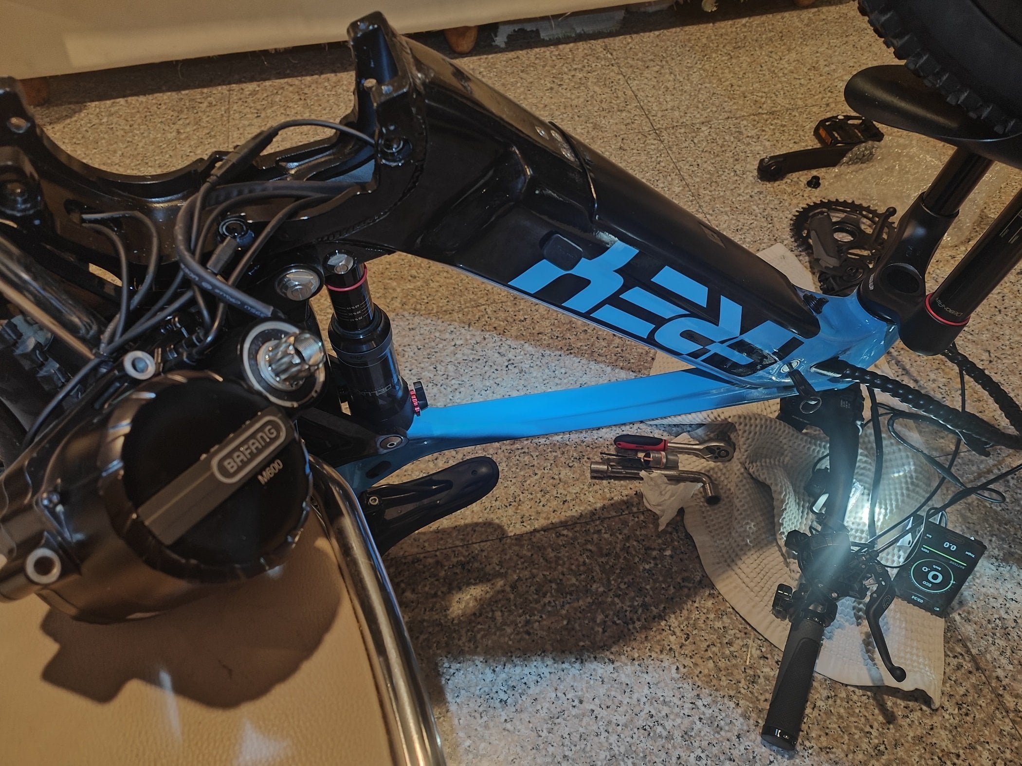

Hello every one here is the problem . I had a m600 bafang won t turn on .
The bike was under warranty so i got a new motor .
With the new motor the bike start with the old one no .

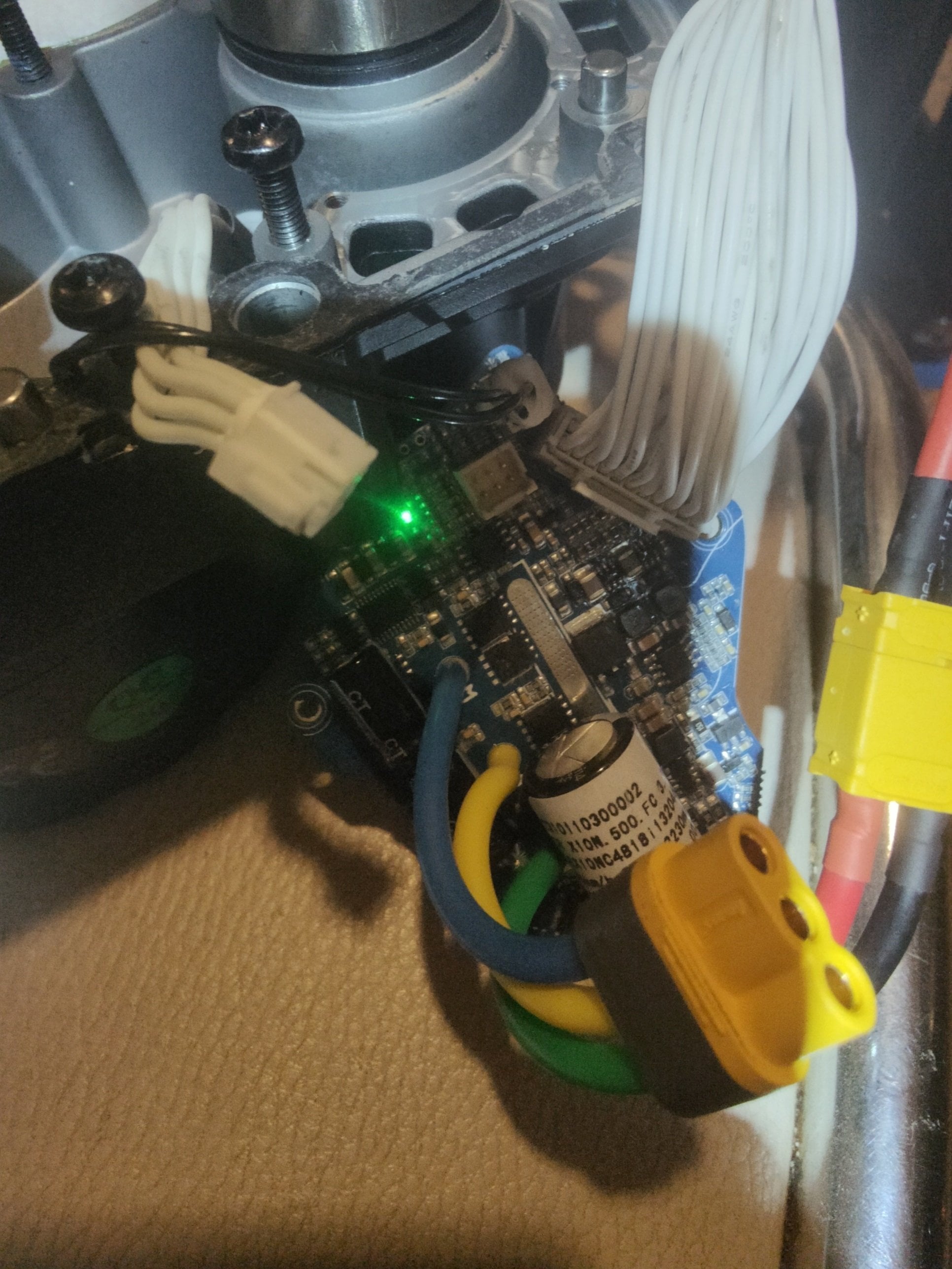

So i decided to change the controler and no the bike won t start even after i change the controler .
So what the next step to check on the motor and what should i change ?
Anyone have a video how to replace the cable interface inside the engine please ?

Hy yes i know thanks but the best pro don t reconize it because it s not turn on .
When i say not turn on mean lcd screan is off after press power buttom .

I have the same issue did you end up finding a solution? I am about to order a replacement torque sensor to replace it
