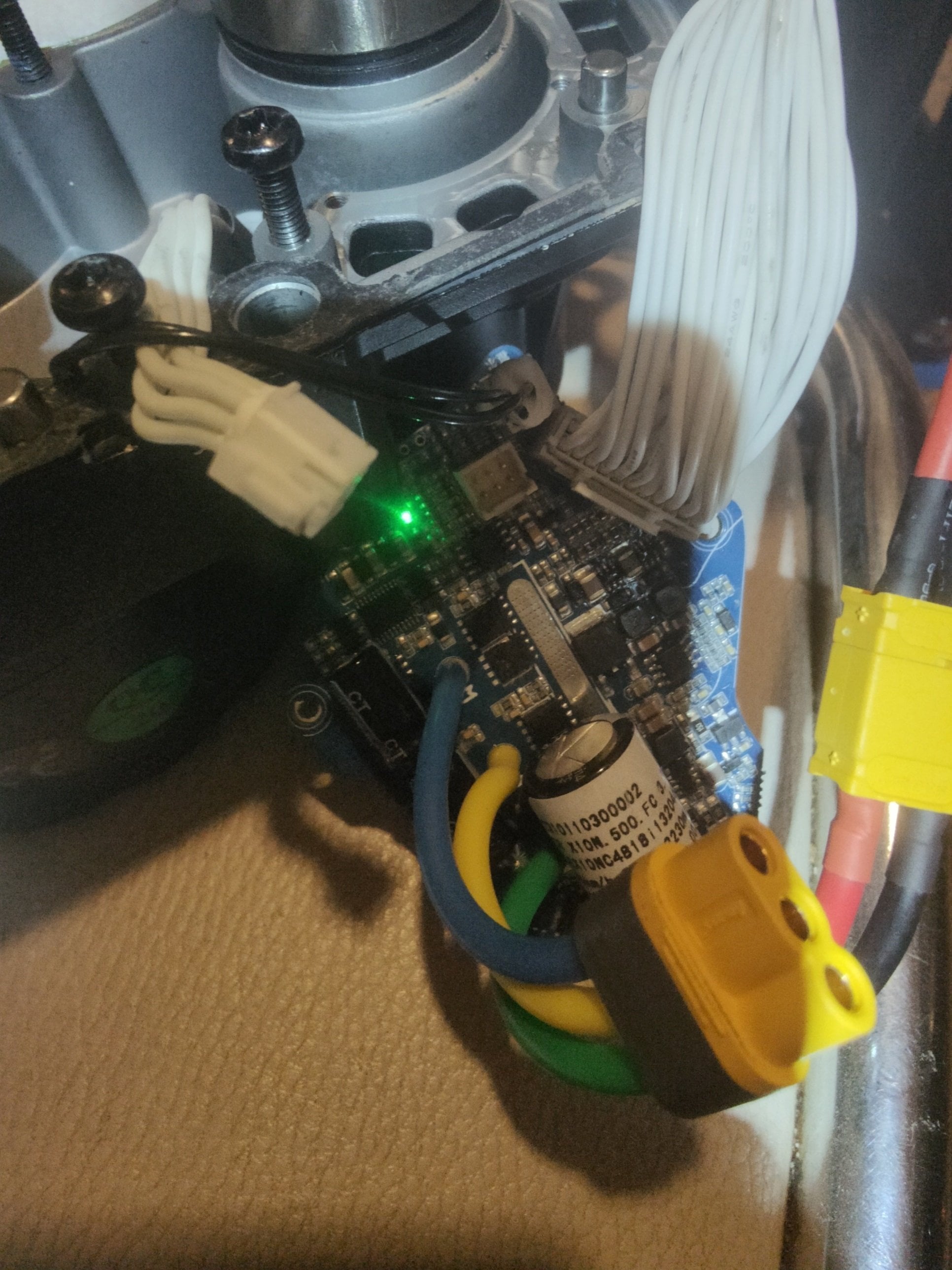

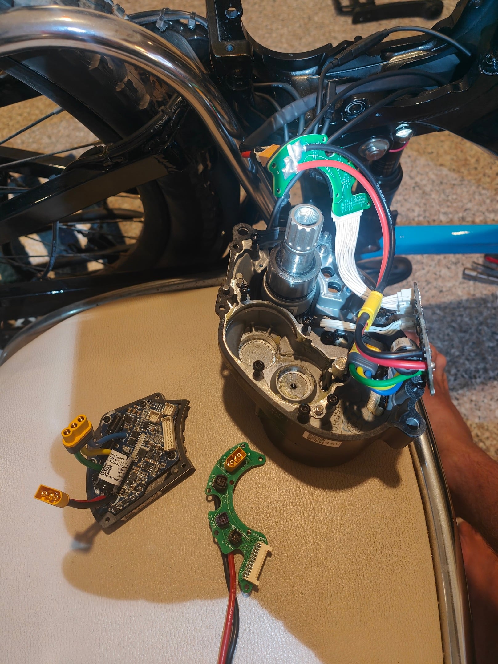

Hy dado i can see that you know very well about bafang i m facing to a problem that the m600 won t turn on .I got a new motor underwarranty .
So i replace with new motor and bike work good now . So i try to fix the broken one .
I order new controler . Not working .
I order new pcb and cable . Not working .
So i unplug torque sensor and motor and i get the green light flashing .
When i plug the torque sensor the green light stop flashing .
What this green light mean and can i start the display without torque sensor plug ?
thank s for you re help

Hello.
Green blinking light means controller had boot up successfully and no error. (form new controllers they have removed this LED - saved 0.01 USD :)
Yes, you can unplug torque sensor, but it wont help u, will be giving u error. Is strange it is not booting up with torque connected. Could be some shortage at torque sensor. If only wrong voltage output from torque it should give you error, but should be able to power on.
Do u have Besst? If you plug torque sensor, are you able to read motor over Besst? Let us know what voltage from torque is Besst reading.
I would try new torque sensor...

Thx so even with torque sensor disconnected the screen should turn on if i understand .
yes i do have besst but besst not reconise it as the motor can t turn on .
I don t want buy a torque sensor new if the problem is from something else .

Yes, also without TS.
You said u have changed everything, right? So only sensor is missing. ;)
Try connect to Best without torque sensor connected and let us know.

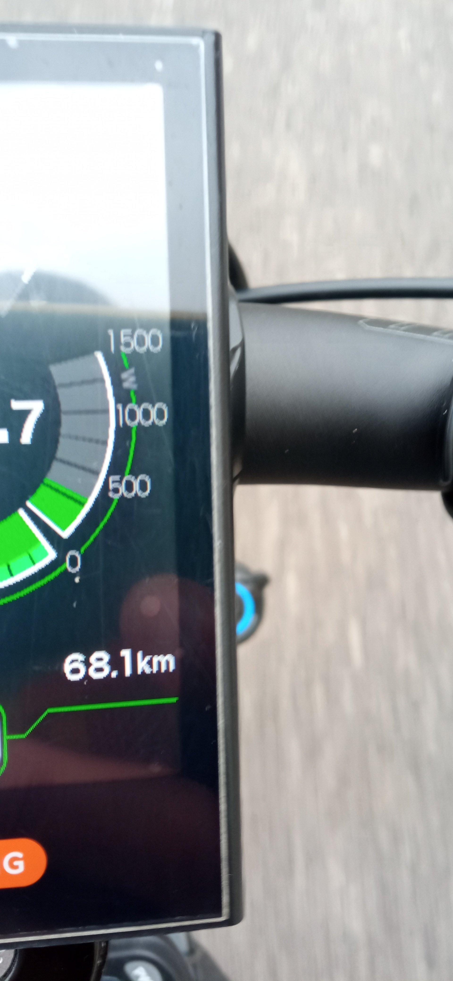

I was running it and it's like this: 1.2 approx. 300w 3.4 approx. 400w 5.6 approx. 600w 7,8,9 over 700w In the photo, st.1 is about 300w, it is difficult to take pictures with a mobile phone in hand.
