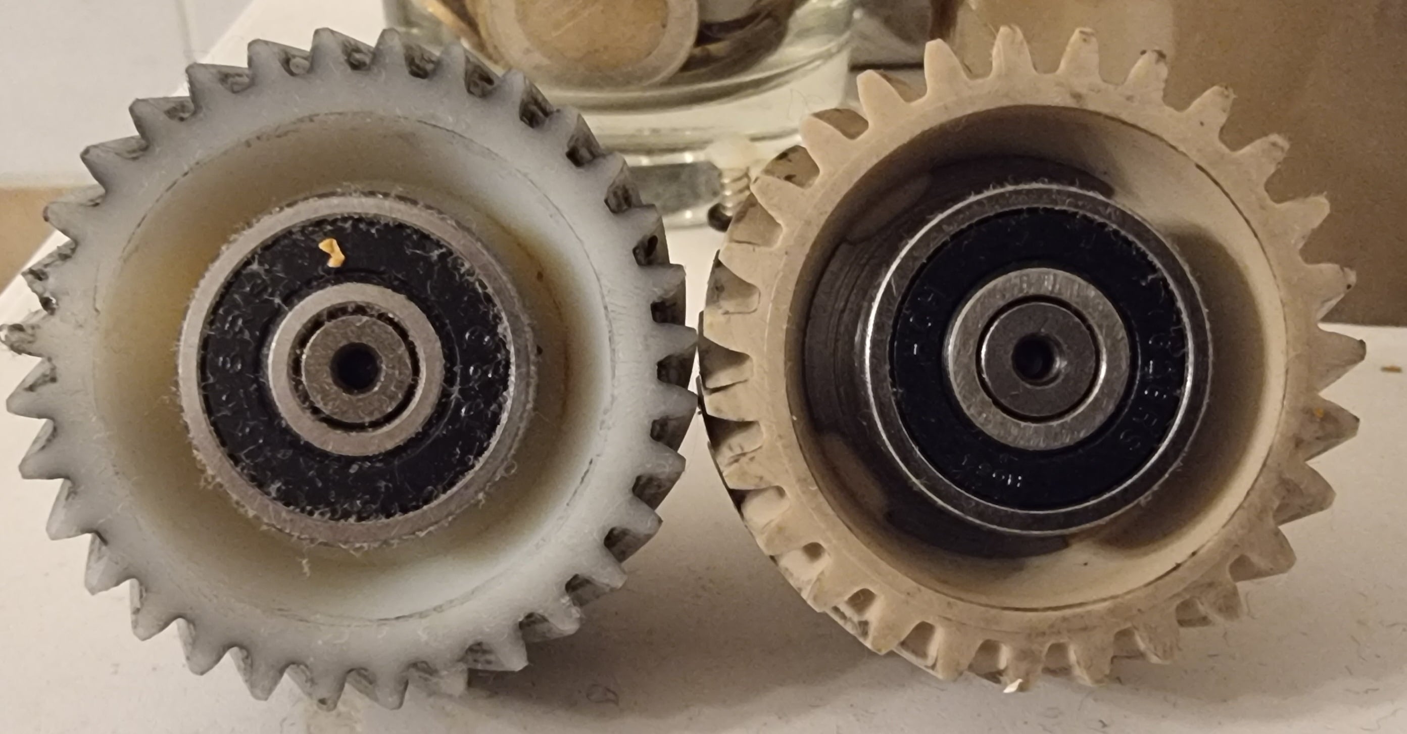

Hello,
My Nylong gear is faulty now.. then i bought an other (the only one available= the M600 nylon gear), from ali.... and it doesnt fit. Its a little different....
Can somebody help me?
Or maybe it will be better to upgrade the M500 to the M600 motor by buying only the stator and the rotor ?

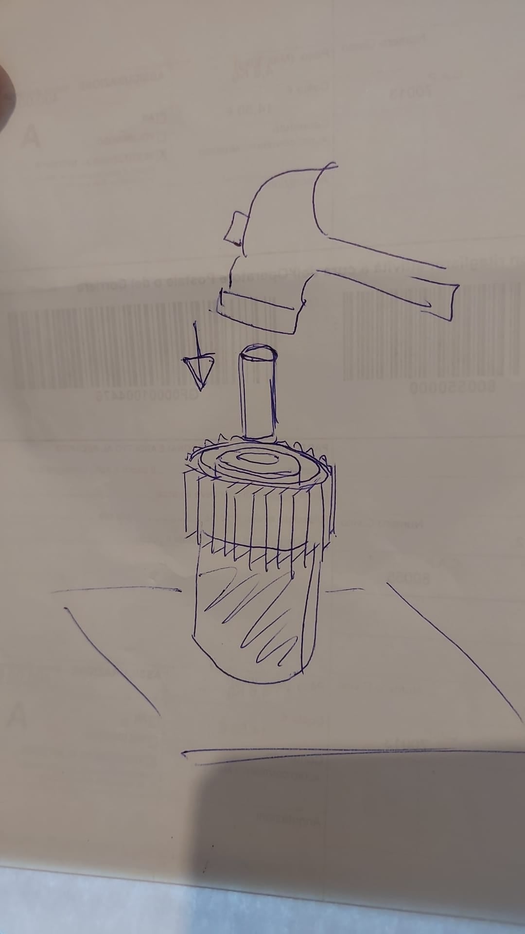

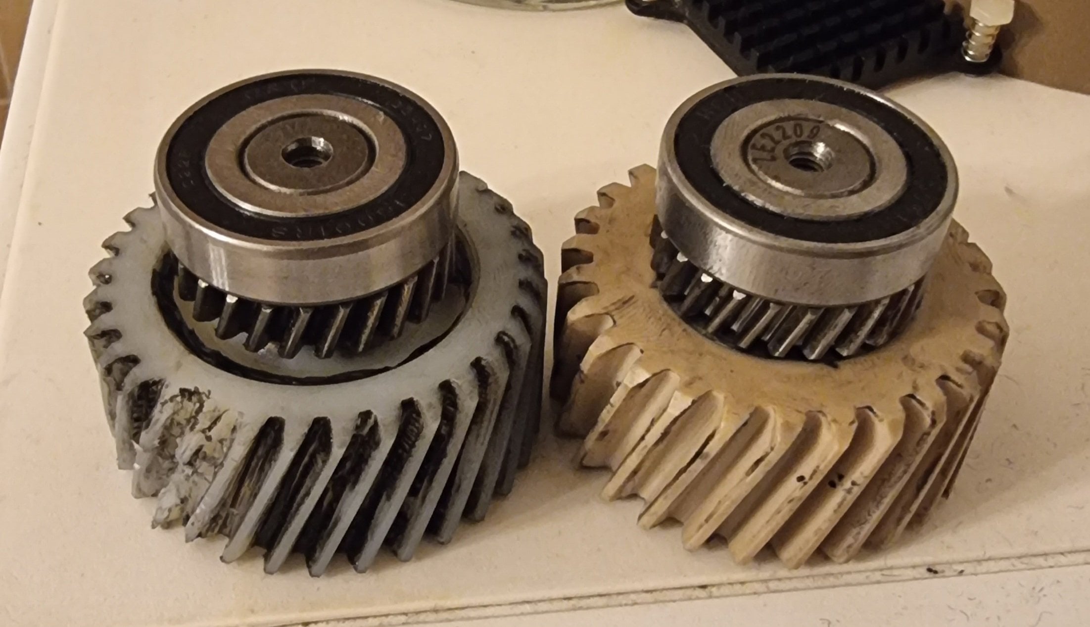

Looks nice (y)
Could you please write some tutorial how to do it?
I dont need this at now, but may be useful for some others in future.
you need a tube of the same or similar diameter as the nylon gear
you need to place the gear on the tube and tap the axle (very hard) from above until it comes out.
To reassemble the procedure is the opposite, paying close attention to the key that must be inserted into the axle.
