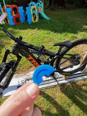

So, I performed an air can service on my 2021 superdeluxe thrushaft shock. There's a blue spacer under the bumpstop that looks like it could be carefully cut off to increase travel, it sits in place of the thin steel washer that's there on all other RS air shocks. Didn't think to take pictures, sorry, a serious DOH moment once it was back together.
Looking at the available service PDF from SRAM it would seem the standard thrushaft shock is the 62.5mm version off the 2021 slash, possibly just limited to 57.5 for the rail using this spacer. there's no mention of the spacer in the PDF. Normally i'd be brave and just hack the thing off to try it, however, replacing this spacer involves a FULL teardown of the shock with all the special tools involved in doing so. My concern isn't frame clearance, it's if the damper body has enough space for the extra piston movement.
Has anyone tried cutting this blue spacer off? Is there anyone with inside information that knows if the rail shock is just a travel limited slash shock?
Thanks for any advice.

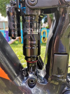

Just gave it a quick wash and let all the air out of the shock for you guys to see

So removing this stock spacer takes stroke from 57.5mm to 65mm and travel moves up to 169mm ?
is it an easy hack?

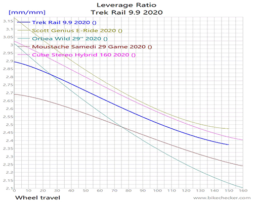

Well, the spacer certainly didn't look like it was 7.5mm to me. More like 5mm maximum, which would take the shock to the standard slash stroke of 62.5mm.
Anyway. the leverage ratio of the Rail is 2.4 when bottomed out at 150mm travel. If you follow the leverage ratio curve along to 160mm travel its at 2.35. So.....
5mm x 2.35 = 11.75
150 + 11.75 = 161.75 (yeah i know, we're getting down to two decimal place guess here:LOL:)
Sound reasonable, or have i done something daft? The BB is going to be LOW on bottom out! :)

Easy to work out the numbers, divide travel by stroke, multiply answer back up by new stroke:
150mm travel / 57.5mm stroke = 2.608.
2.608 x 65mm stroke = 169.56mm rear wheel travel.
Things to consider. The brace on the seat stays comes 'very' close to the seat tube with the increased travel. I run mine at 62.5mm & only have ~2/3mm on a hard bottom out, which is a little close for comfort when you allow for frame flex. Bear in mind mine is a L frame, there may be more clearance with an XL.
Also consider the tyre may buzz the seat tube and or saddle.
