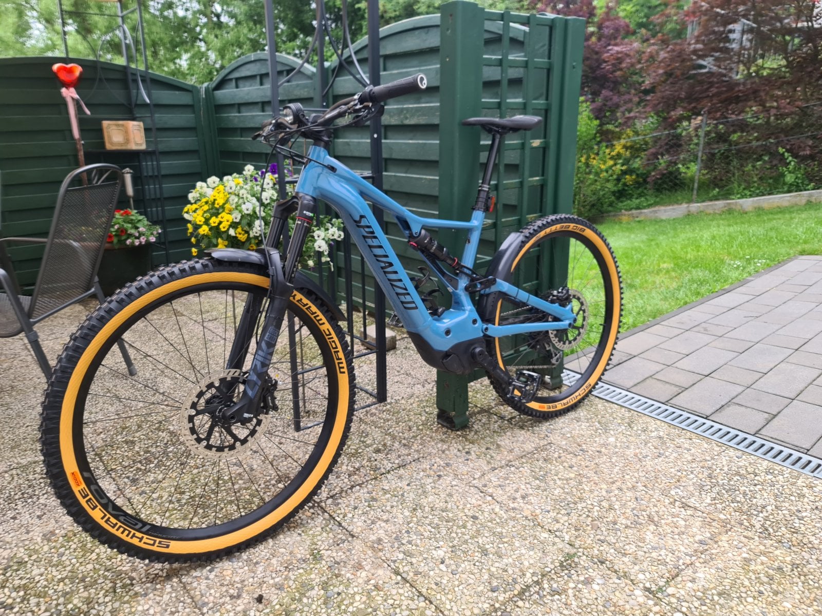

Got some new shoes for the lady, like the look. ?
Havn't done a testride yet. I'm excited how they work.

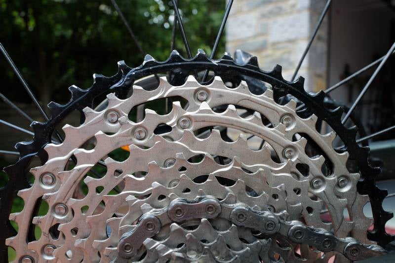

Hi. My wife's TL2020 shows an irregular shape of some of the cassette teeth, as you can see in the attached picture. The bike has barely reached 100 km, so I was wondering if this is not wear and tear but rather something normal designed like that, just like for example thick/thin chainrings.
What do you think?
