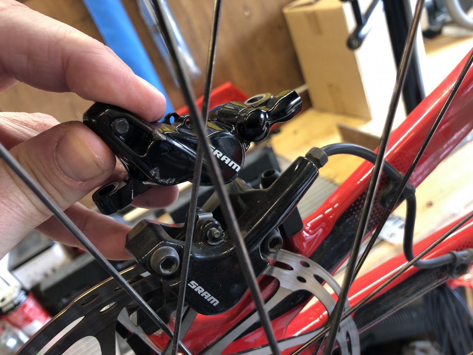

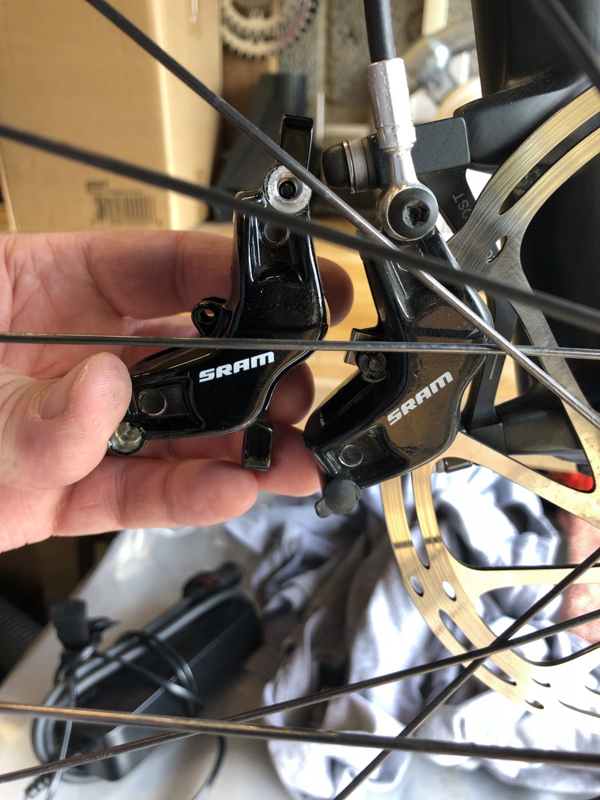

Back to the shite. Full, perfect bleed today when I finally got time this afternoon. No bubbles at all. Lever tight with the spacer block in but once that’s Out and the pads are in, lever goes soft.
I think air must be getting in somewhere.
Could it be the lever end olive? I didn’t cut and replace it when I put the new lever on so I can start there tomorrow.
The front brake is as hard as nails and that’s using the original hose, olive and barb.
There’s just so many variables. Calliper leaking air, Hope hybridised connection there, could Level T piston be leaking air past it’s seals?

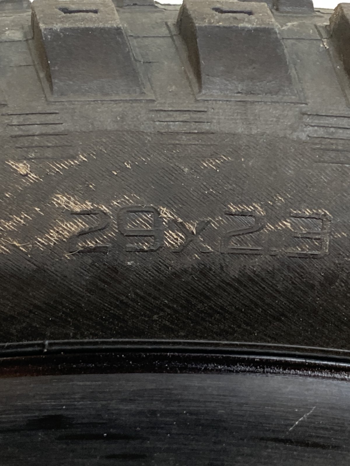

I know almost nothing about mtb tires, but I've been reading a lot about the topic... I am looking for future tires replacements, front and back, and I'm kind of confused about the rear Eliminator Blck Dmnd 29x2.3 width.
Is it wider than other 2.3 tires?
its like 63mm wide, while the 2.6 front is 66... could this be correct?
Anyone using an Eddy Current Rear 29x2.6? would it fit?
Think the rear tyre is 2.6 despite what it says in the spec.
mine is 2.3. But it’s wide, wider IMHO than what a 2.3 really is.

Bleeding issue solved. People say, a bad workman blames his tools, but what if the tools are at fault. On the 4th bleed in succession it suddenly occurred to me that I’ve removed more air from this system than can physically be inside even with no fluid in.
Turns out one of the SRAM syringes was missing a little rubber O ring.
Now it works, to quote Simon Gruber.

How are you going to use the same factory hose, unless you crimp a new banjo fitting on it?
Specialized frankenst'd the brake setup on the base models, Level T (crap MC's) with a code/guide quad caliper up front; but they use the shitty level dual piston weak sauce caliper out back. I was doing a similar upgrade myself but had to order a new rear line, and re-run through frame in order to upgrade rear calipers to quad's. The level MC's still leave a lot to be desired, so will probably just go with another setup MT7's or MT5's trail's in the future.
Nipping back to the brake swap - Level T for Guide RS.
Having disassembled the 2nd hand Guide RS's, it occurs to me that I can in fact use the existing rear brake hose in situ.
If I take what was the front caliper and install it to rear, then the existing hose can screw right in at both ends, albeit with new rubber olives.
Similarly the front....
Then all I need are the olives and a bleeding edge bleed toolkit.
Is this right or am I missing something fundamental?

I have a Hope fitting, erm, fitted, to the original hose. I cut the old one off and put this on. Quite a few parts to it including two copper washers but it works. However, I wish the the Guide RS's had the same caliper front and rear, with banjo fittings. It would be much more sensible. Front one has Bleeding Edge bleed port but rear doesn't. I wonder if this second hand pair was made up of two different years.
I did also buy a new 2000mm line just in case, and the fitting on that is removable so I could have fitted it to the existing hose with a new barb and thingy if the Hope one didn't work.
The annoyance I currently have is that the two levers have different bite points now. Front is uber quick, and there is a tiny brake rub too.

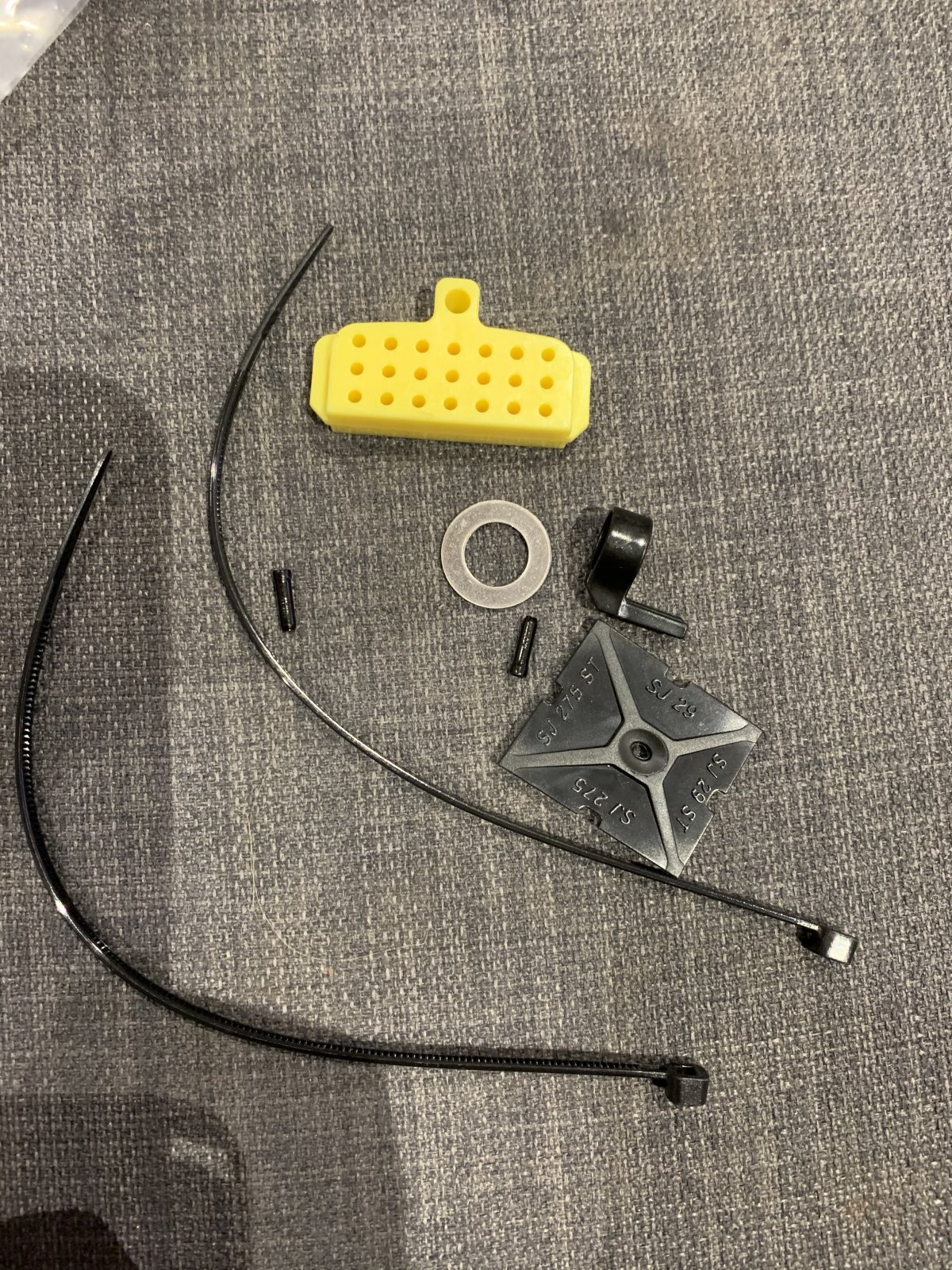

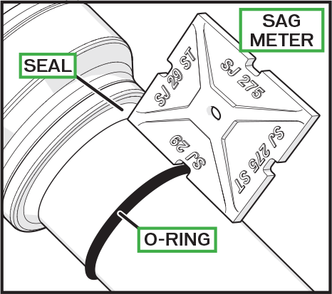

.........I never used it because I prefer to set sag at 30% travel with a ruler, but I assume the 4 different sides refer to wheel size and either Stumpjumper ( SJ) or Spesh Turbo ( ST) ???? So if using this for a Levo you need the side that says SJ 29 ST...and use the right hand side of the top face in the diagram above?
You also have there a brake block (for brake bleeding), 2 zip ties, what looks like 2 inner cable end bullets, a washer they forgot to fit on the bike ...just kidding!, and I don't know what the other black bit is.

Cheers. Have to say, there are a couple of things I know. The washers I thought were for between the pedals and cranks but they aren’t so no not sure what they are.... they probably did forget to fit them!

........but I assume the 4 different sides refer to wheel size and either Stumpjumper ( SJ) or Spesh Turbo ( ST) ????
There is a Stumpjumper ST model (short travel) with 120mm of rear travel. I think it makes more sense to use the Stumpjumper (SJ) for our Turbo Levo bikes, as they have more similar suspension and geometry than the ST.
Measuring it yourself is even better though! (y)
