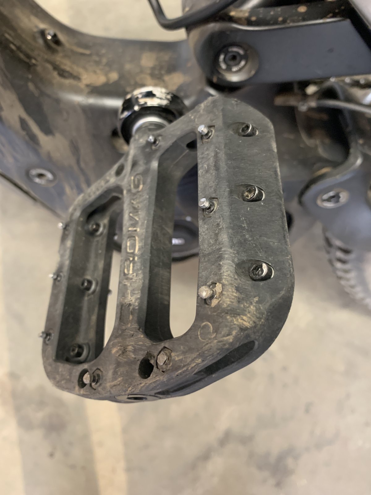

My only real complaint with the decoy so far is the low BB height, even with the flip chip in the high setting. My pedals are getting mashed and caused one low speed crash in a rock garden where it caught me off guard/off balance.
Im seeing what you mean now. Been nailing my pedals a few times now. I guess on the jump trails it wasnt an issue and on boulder its pedaling up the fsr and no pedaling on the downs. More pedaling on some slick rootty rocky trails recently and getting used to the power band climbing. Working the pedals more than an acoustic bike. I bent my crank or pedal laat night. Hows the high posution working for you? I put a 170 air shaft in my fork but that only raises the pedals a couple mm. 180 triple clamp would be sweet i think

I’ve only run it in the high position, as it’s plenty slack for a trail bike. I get enough pedal strikes that I’m not even interested in trying low mode. My composite pedals are beat to hell and the cranks are pretty bruised up already after less than 200 miles.
I am getting less strikes than I was at first as I’m being more cautious of them.
Ya ive got chesters(composite/plastic) so not a big deal. Still sucks, theyre new. I hope its the pedal and not the crank arm. Ill put my other pedals on tomorrow to check. May have to try the higher setting and 180
