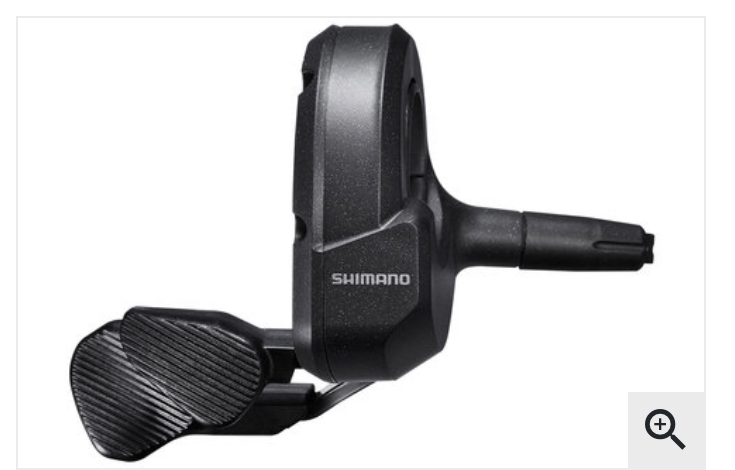

I thought I could get used to the Di2 push button shifter but after 4 rides it ain’t happening. My wrist is actually cramped from the awkward hand positioning required to shift gears. Did they actually ride these bikes to see if it functioned well? It’s nice and tidy looking but not ergonomic at all.
I've broken my wrists and thumbs and etc and the shifters are not good for me either...gonna make the change to a more traditional shifter...I do love the Di2 though.

Does it work with the e8000 shifter?
I’ve got one lying about..
