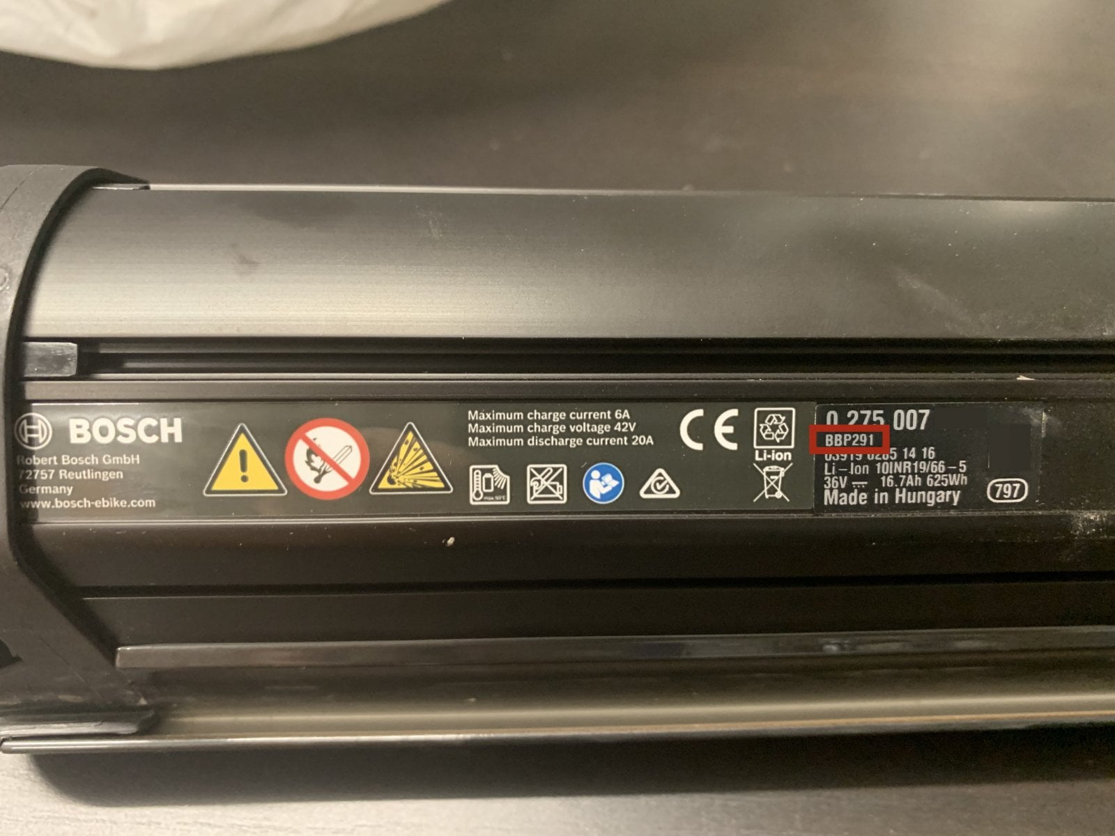

I'm tempted to upgrade my Rail 5 500wh battery to a 625wh.
Does anyone know what battery is correct, vertical or horizontal?
Wouldnt like to order the wrong one... ? ?

I've had a look at the diagram but it doesn't specify vertical or horizontal, Only powertube mentioned.
Or am I missing something?
Ah, I thought it was there, but it indeed is not.
The best most accurate way is to check your current battery (this as Trek manuals mention them, not which one goes in your bike).
Take the battery out, and check the serial part, you should see something like:
That "BPP291" in the picture is the important part (boxed in red).
I am aware of the following models:
"US" Models:
BBP287 = PowerTube 400 Horizontal
BBP288 = PowerTube 400 Vertical
BBP285 = PowerTube 500 Horizontal
BBP287 = PowerTube 500 Vertical
BBP295 = PowerTube 625 Horizontal
BBP296 = PowerTube 625 Vertical
"EU" Models:
BBP282 = PowerTube 400 Horizontal
BBP283 = PowerTube 400 Vertical
BBP280 = PowerTube 500 Horizontal
BBP281 = PowerTube 500 Vertical
BBP290 = PowerTube 625 Horizontal
BBP291 = PowerTube 625 Vertical
Thus if you currently have a BBP285 (horizontal), upgrade to a BBP295 or BBP290), etc.
Do note that if you just "buy the battery", if you are going to then go on a trip, you need to bring the few tools along to dismount the bracket, and mount the other battery, some people manage it in 20 mins, but maybe you want to do something else during a rest than that, especially if other folks if you are riding in a group are enjoying a proper rest ;)
Trek and your favourite local bike shop sell the RIB as a package, and then you have a battery cover and everything in one go, which is a bit heavier due to the cover, but it will save you on finicking with it in a place where you might not have the most clean conditions, or drop the tools etc etc.

Wow Jeroen, what an incredible reply!
Thanks for your time and effort to help me out, total Dude ?.
Indeed my number matches to the BBP 281- 500wh vertical.
My plan would really be to buy to replace my 500 and sell it on so the upgrade doesn't cost so much. I can't see myself doing anything quite that epic to need 1150wh of battery ?.
