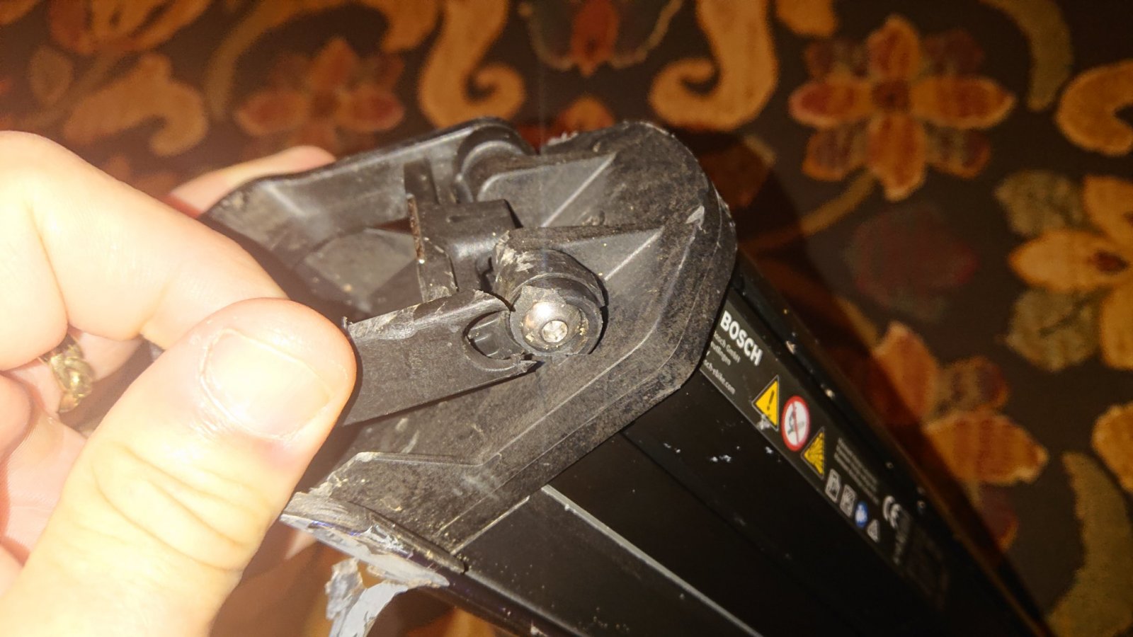

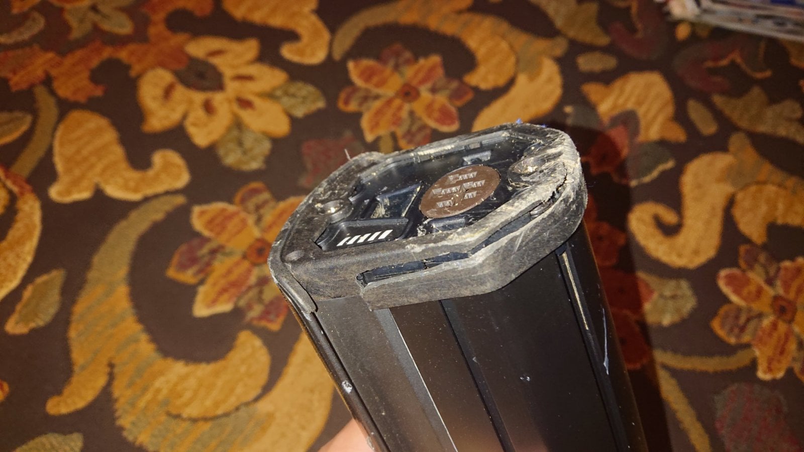

On last nights ride my battery pretty much ejected it’s self while riding along some gravel track. I was going fairly quickly so needless to say it’s made a mess of the battery cover plate, but more worryingly it’s dented the battery it’s self.
now the battery was definitely fitted properly (i double check ahead of every ride), and this was about a Half way into my ride not right at the start as you would expect had it of been fitted properly.
Managed to refit the battery and cable tie it in for security, but can’t see any damage to the locking mechanism so no idea what happened.
is this a known thing or fault on the rails - batteries self ejecting?

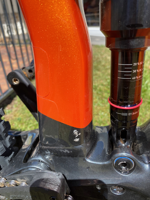

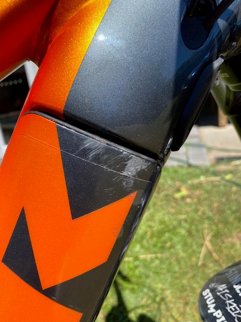

had the battery fall out of my 2021 rail 9 today only 3 days old and third ride(half way around 2nd lap of Davies Creek trails) ,,hadn't had battery out yet, damage to battery cover and some scratches to seat tube and chain stay as it bounced !!

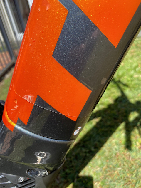

Since you've been posting, I've started putting a 1"x 3" piece of 3M Clear Bra from the cover to the frame at the top to be safe. It doesn't even show and the stuff is tough. I just replace it when I pull the battery out. Good peace of mind.

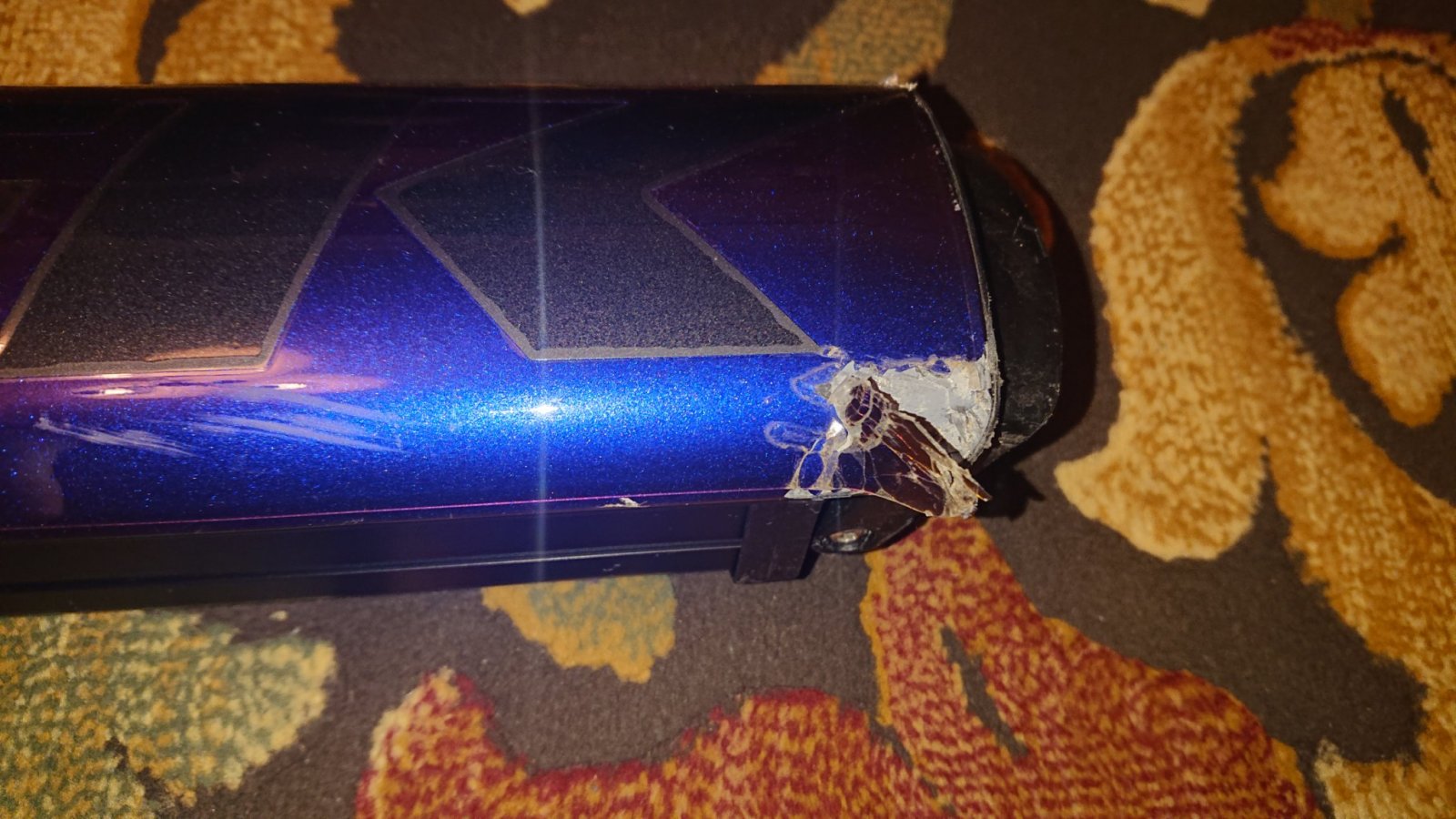

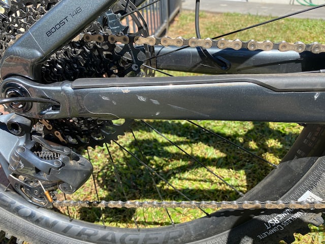

Love my bike but a little pissed off, I bought my 2020 Trek Rail 9.7 Gloss Purple Phaze new from Trek on 8/10. Yesterday my battery fell out and scratched the paint and carbon. At first, I thought it was my fault, then it happened 5 more times. I know this not my fault especially after reading this thread. It's weird because after the first couple of times the battery fell out I bounced the bike up and down and the battery would not fall out, after a couple of mins of normal riding(flat paved road no bumps) the battery would just fall out. I dropped my bike off at a local Trek Store, he stated he would contact Trek and see what he can do under warranty. My bike was in mint condition and now my battery cover is all scratched up, I spent a lot of money on this bike and have believed for a long time Trek is a great company, I hope I am right and they make things right. How has the warranty been for you guys, did they cover the work? Did they replace the cover with an exact painted one? Did they give you a hard time? What was done to correct the issue?
