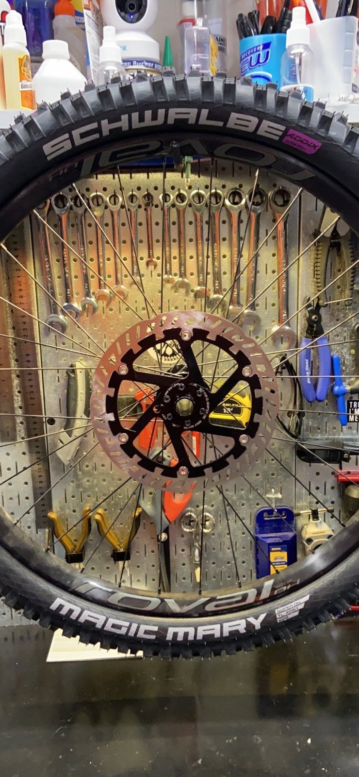

Partly out of curiosity and partly due to Merlin having terrific deals on Schalbe just now, I swapped my E-Wilds for a 27.5 Magic Mary 2.4 Super Trail soft, front and a 27.5 Big Betty 2.4 Super Gravity soft, rear. Ive done 3 rides at around 60 miles through my local woods which have become very slippy and muddy. Im still playing with pressures (currently 22f/24r) and I am very pleased. I averaged c11 mph as opposed to c10 on my last rides despite noticing a little bit of drag. Grip felt so much better and perhaps that heightened my confidence and encouraged me to horse it on a bit more, especially on corners and rougher stuff. I noticed that on each ride and on the exact same route and very similar conditions, I dropped a battery bar about at 4.5 miles as opposed to about 5 which I would normally do on that ride.
But I do feel more confident riding and Im happy with this combo.

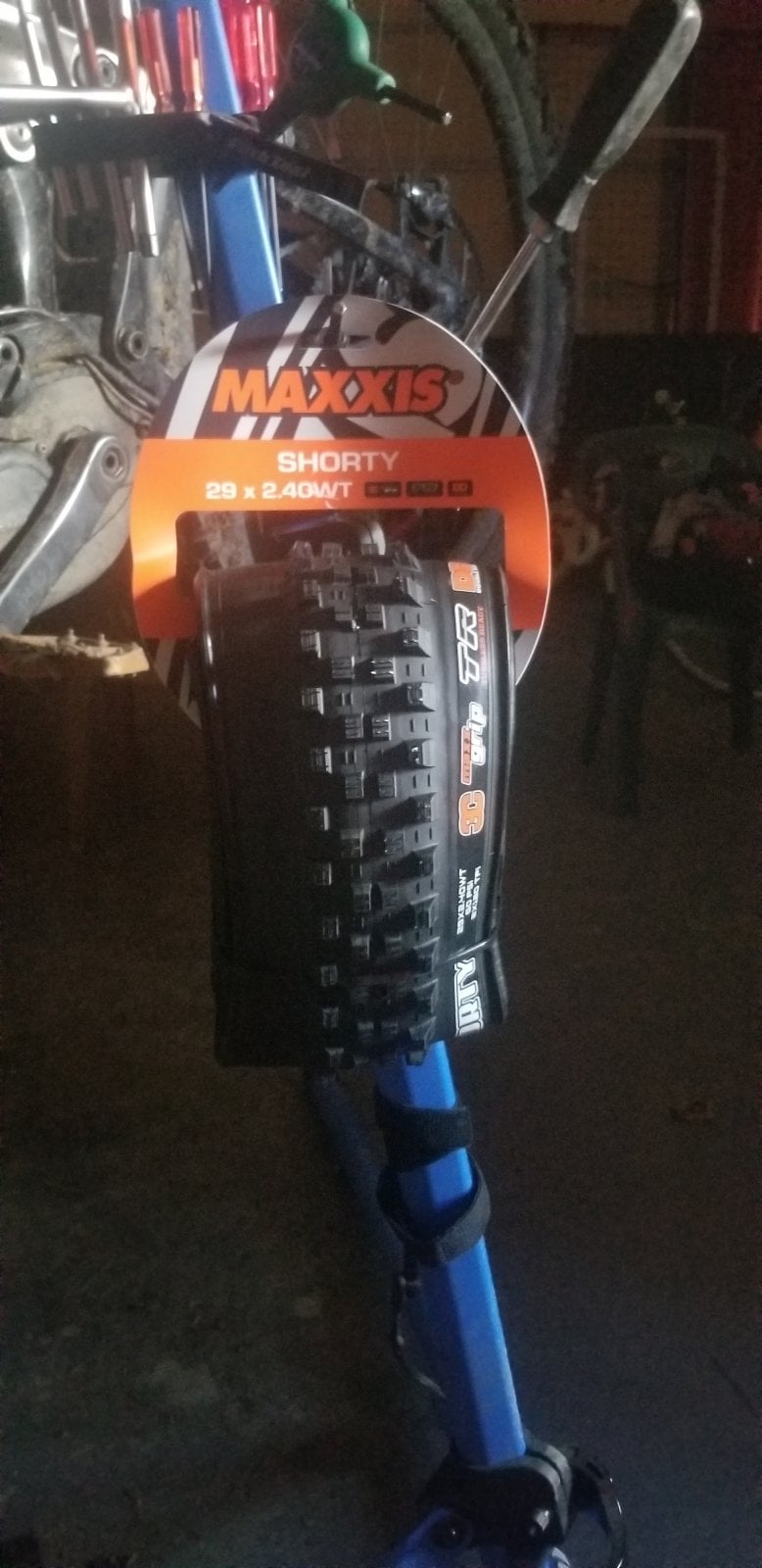

The new shorty is in.

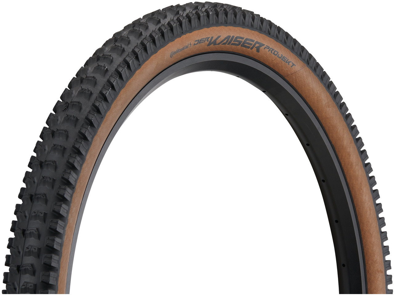

well had a good experience last 7 month with assegai 2.5 3c, heavy use in super dry loose conditions. rear was kiaser really loved the kaiser so after 1600 km switched last week to two kaiser 2.4 so far grip is on par with the assagei roles better rear is easier to drift and control wile drifting but needs higher air pressure front 22 rear 30 i weigh 105kg .
kaiser gets my thumb up got these ember eddition they rip and look cool on my levo
kiaser
