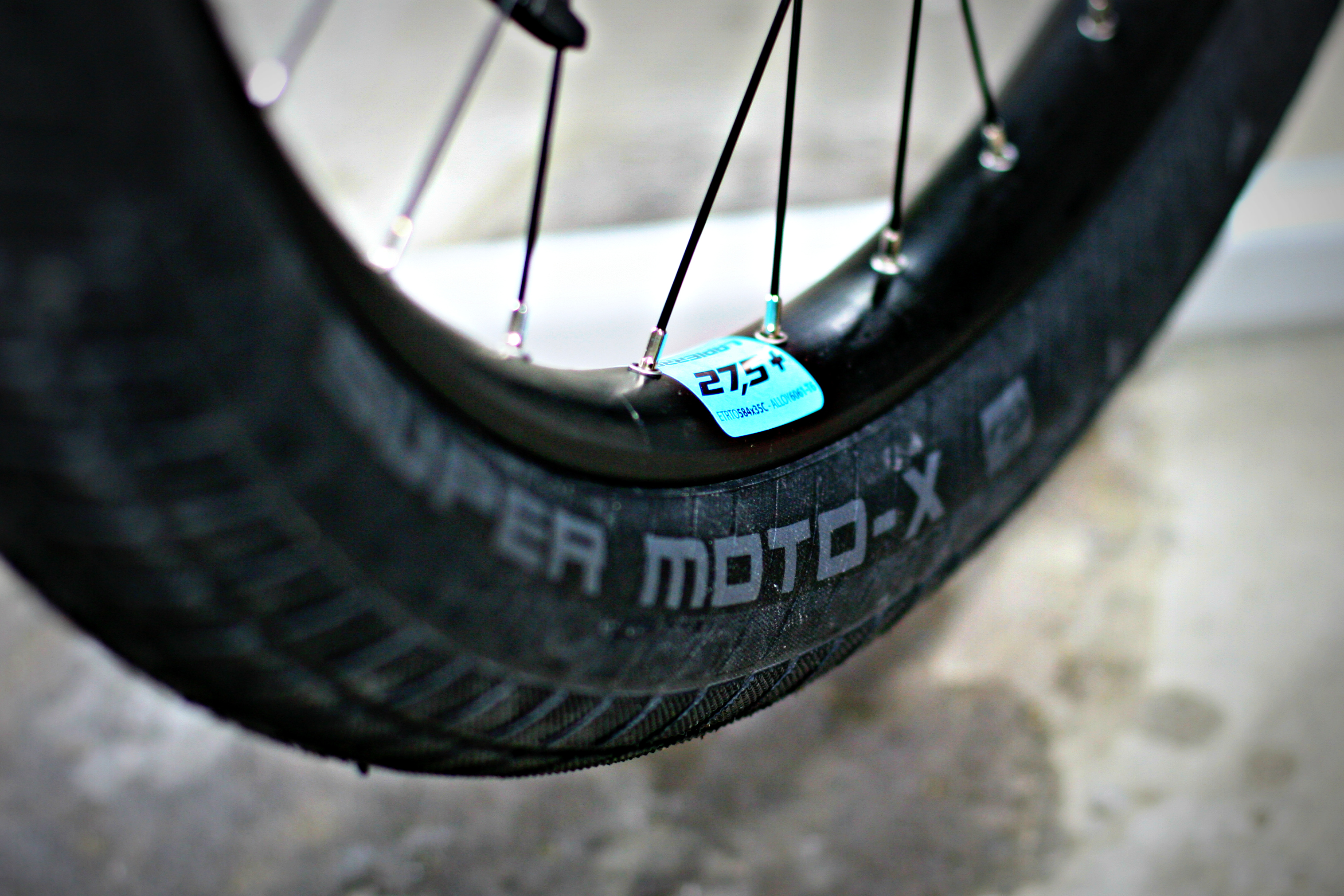

Just swapped to a pair of Super Moto X for commuting. Made a short 8 km test ride before dark... not surprisingly they do roll well compared to the original Rekon+ & High Roller II combo. Will be interesting to see how they cope commuting on rough roads.

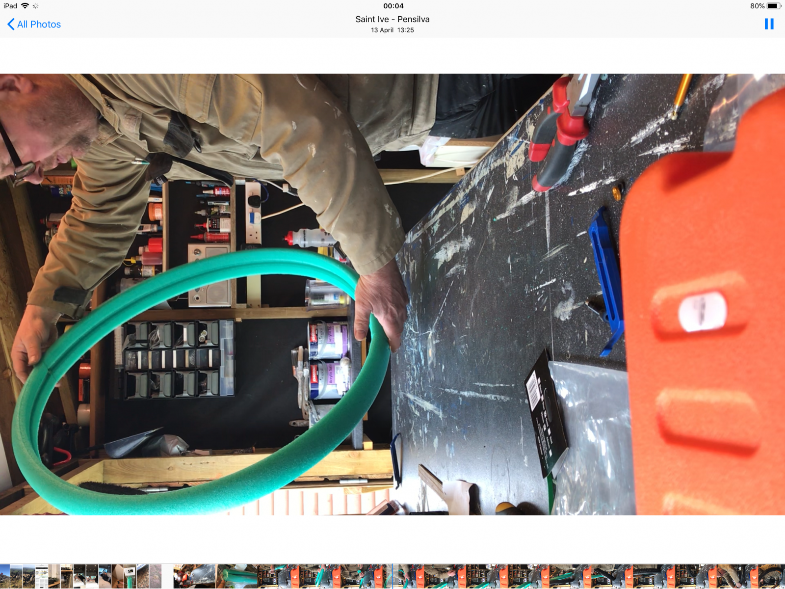

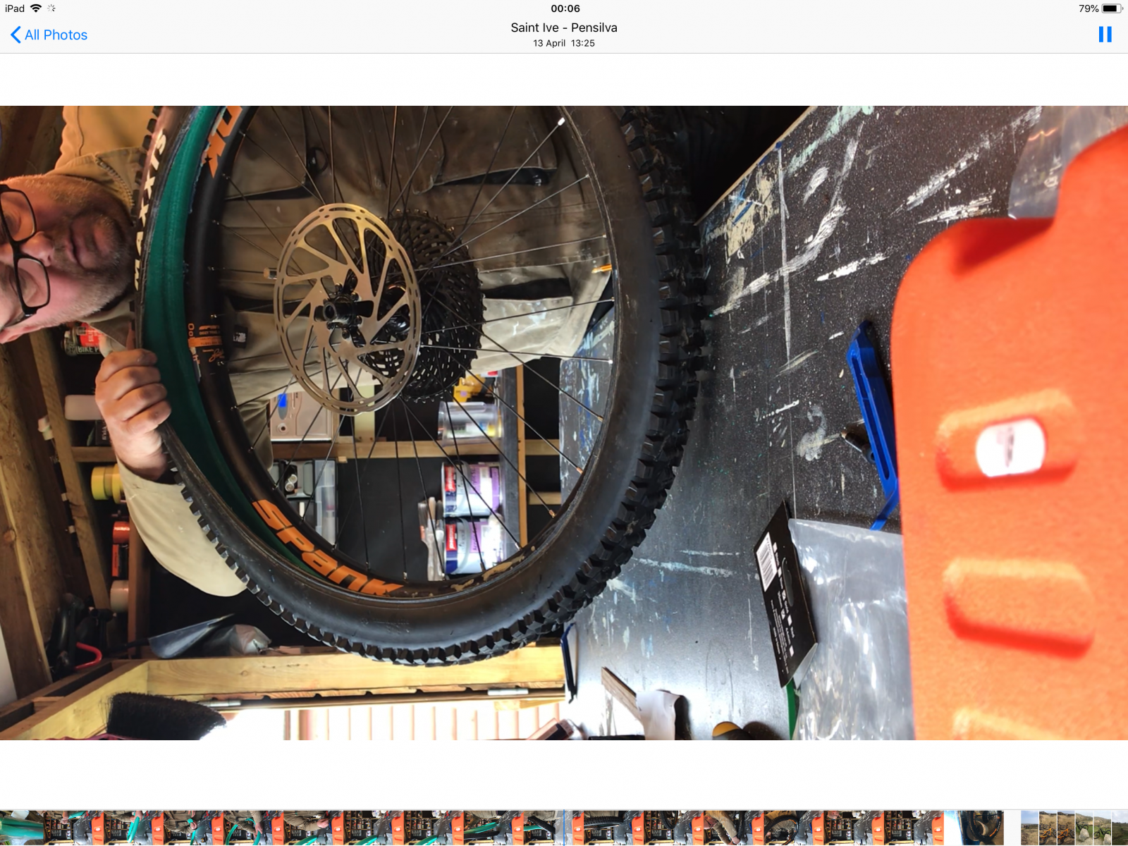

I fitted the ratbites and had a few rides on them . Iam very impressed .
Let’s start from the beginning.
They are easy to fit , I just broke the bead one side of the tyre and fitted them just as I would a tube . I didn’t even worry about the sealant in the tyre I just allowed it to re dustribute around the insert , hardy spilling a drop .
The action of the ratbite inside tyre forces it out onto the rim making tubeless inflation very easy and instant .
Unlike other inserts this fills the tyre not the rim void , which to me makes more sense .
I instantly reduced my pressures to 17 front and 23 rear , at this pressure before the wall would try to fold when pushed sideways .
The feel riding is very good. Over Rocky ground ,and I certainly have some of that in my back yard , the feel is amazing the tyre just seems to absorb the rocks without fully deforming and threatening to clink the rims , grip all round feels much increased , probably due to the lower pressures Iam now able to run .
I can’t notice any increased drag from the tyres , exept the lower pressure feel on the road , in fact they feel like they have less resistance over rough ground , it’s hard to explain but it’s as if the tyre pressure Ramps up as it deforms over bumps ,which I guess is what the foam does really and a good reason to have the foam against the outside of the tyre instead of filling the rim void where it can only act when the tyre is fully deformed and about to pinch in the rim .
For £ 18 a wheel they are certainly worth a try .

How does this make more sense?
If I have this right your insert is on the outside of the tyre and the inflation chamber is now on the inside?
If so you're effectively losing the tyres air chamber, comfort and compliance, reducing grip and increasing rolling resistance and weight.
This is from basic physics of how a bicycle pneumatic tyre works rather than experience. I don't enjoy riding bikes with low tyre pressures so all these insert systems are pointless for me. *Apropriate tyre casings and pressures never let me down.
*Dual ply for DH 2.5 @ 28/34psi
*Exo for enduro 2.5/2.35 @ 32/38psi
*Single ply for trail centres/natural/XC 2.35/2.35 @ 32/40psi
For me anything lower than these pressures cause the tyres sidewalls to fold/lose rigidity in corners (the only exemption would be in hugely wet/muddy natural conditions with very little hardpack/rock). But I still don't bother running lower pressures or even mud tyres as I kinda enjoy the sketchiness.
I'm a massive tyre geek with loads of experience but haven't posted much on this thread as it's full of recomendations for plus tyres. Which I just don't like the limitations of. And people don't seem to be able to cope with my honesty.
