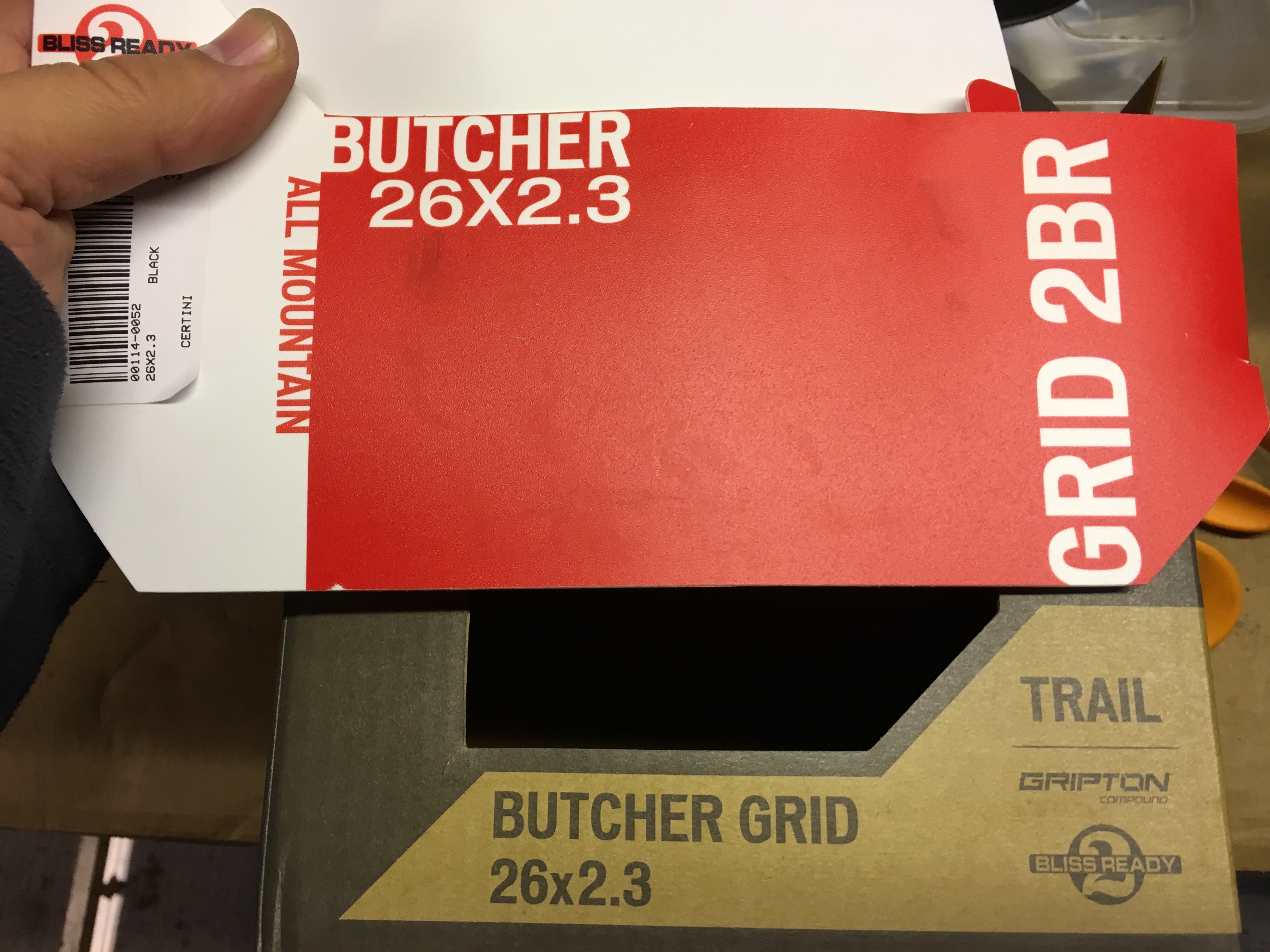

Hi guys - 2 quick questions - in the photo below I have 2 different Butcher tyres (new packaging I guess) - are they different compounds - I was wondering if the 'Gripton' was a softer compound, or just a new marketing term...
And second question - riding around Dartmoor, Uk - very very muddy, and I am not getting confidence on my from end (standard 2.8 Butchers as fitted to the 2018 Levo) - would a Magic Mary on the front be an improvement - I know it can be very subjective. I'm a big bloke so running 20psi front and rear - I guess lowering the pressures a bit would also help?

gripton is the supposed new compound which is softer but in my opinion not very grippy on the front, magic mary is miles better especially the soft compound
