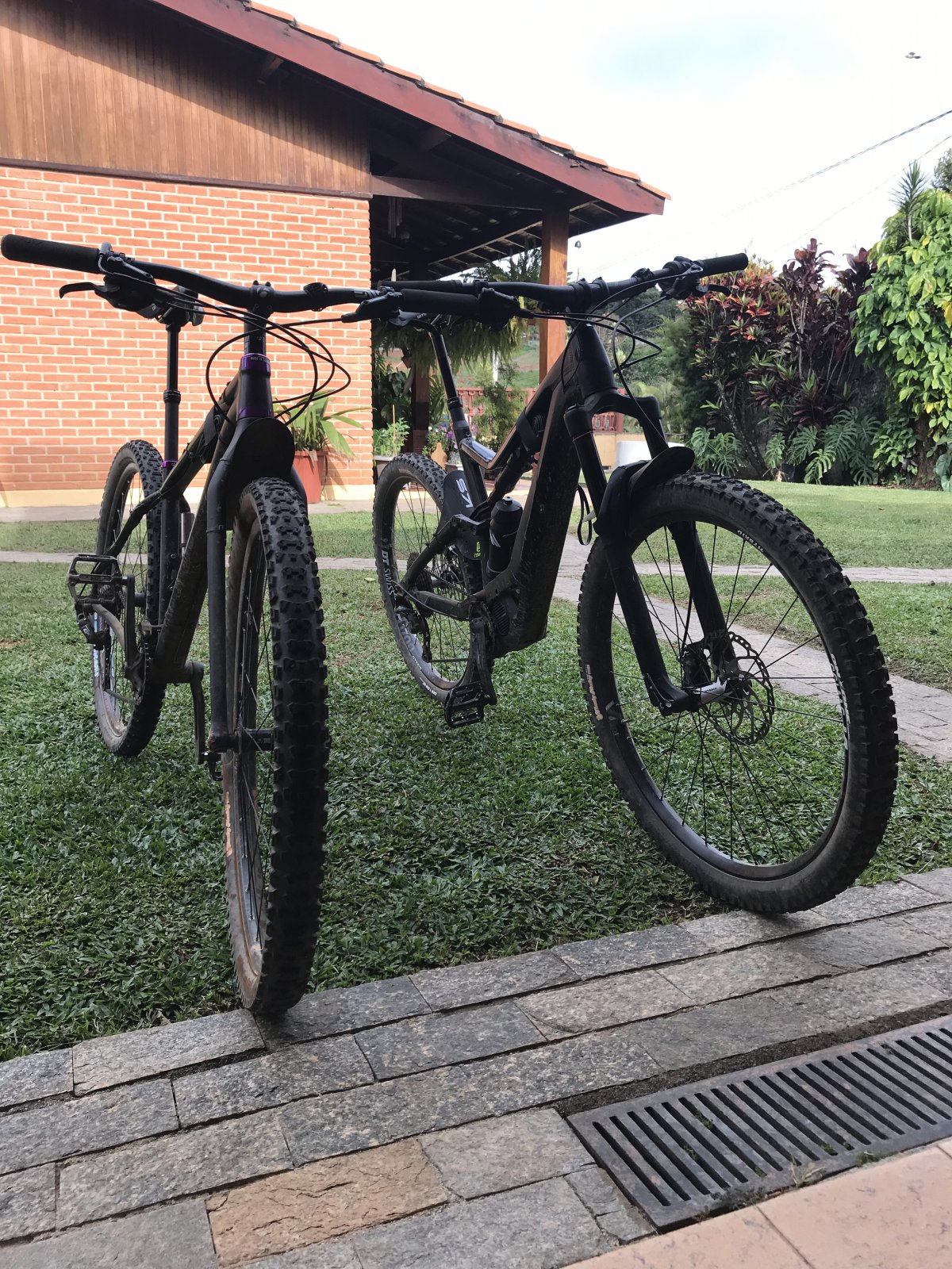

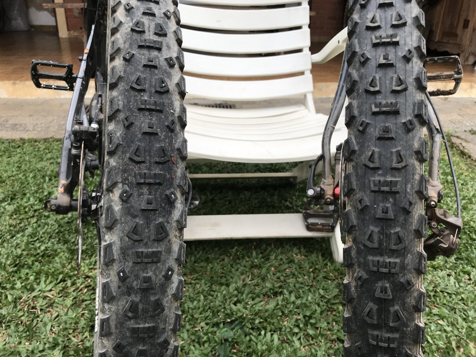

I have been riding this combination of on one smorgasboard rear and chunky monkey front on my bikes for a long time and now set the ebike with the same. The point is having the same feedback of traction for climbing and descending on all my bikes. Compared to the original tyre set of the spectral, I’ve lost some 15% of climbing traction and 25% of breaking with the rear, witch I find good since sliding the rear suits my style trajectory corrections.

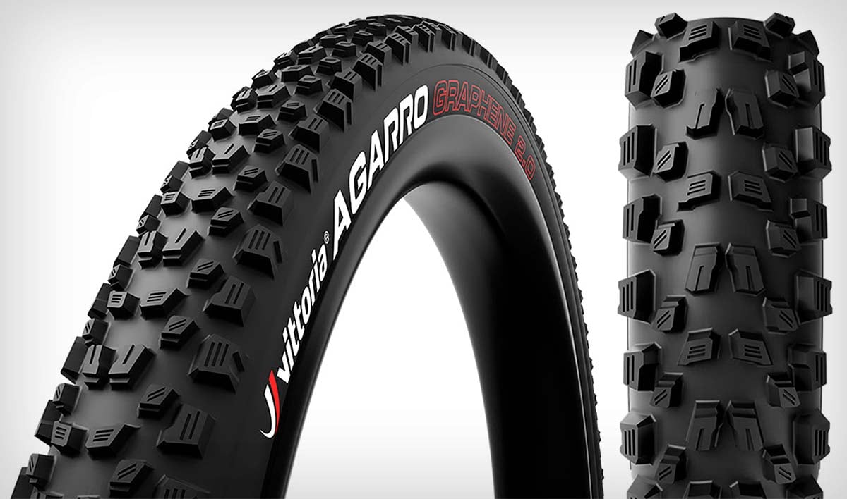

Vittoria is what i wear on my XC hardtail, great tires for that, haven’t tried any of their enduro tires, what they offer are pretty much the same draw other brands wich I’m ok with it on my ebike and I don’t want to do experiments, but now they offer the Vittoria Agarro on 27.5/29, 2.35/2.6 and it’s looks a good compromise between rolling and grip
seems good if you want to carry speed on a mixed hardpack/loose trail, for example

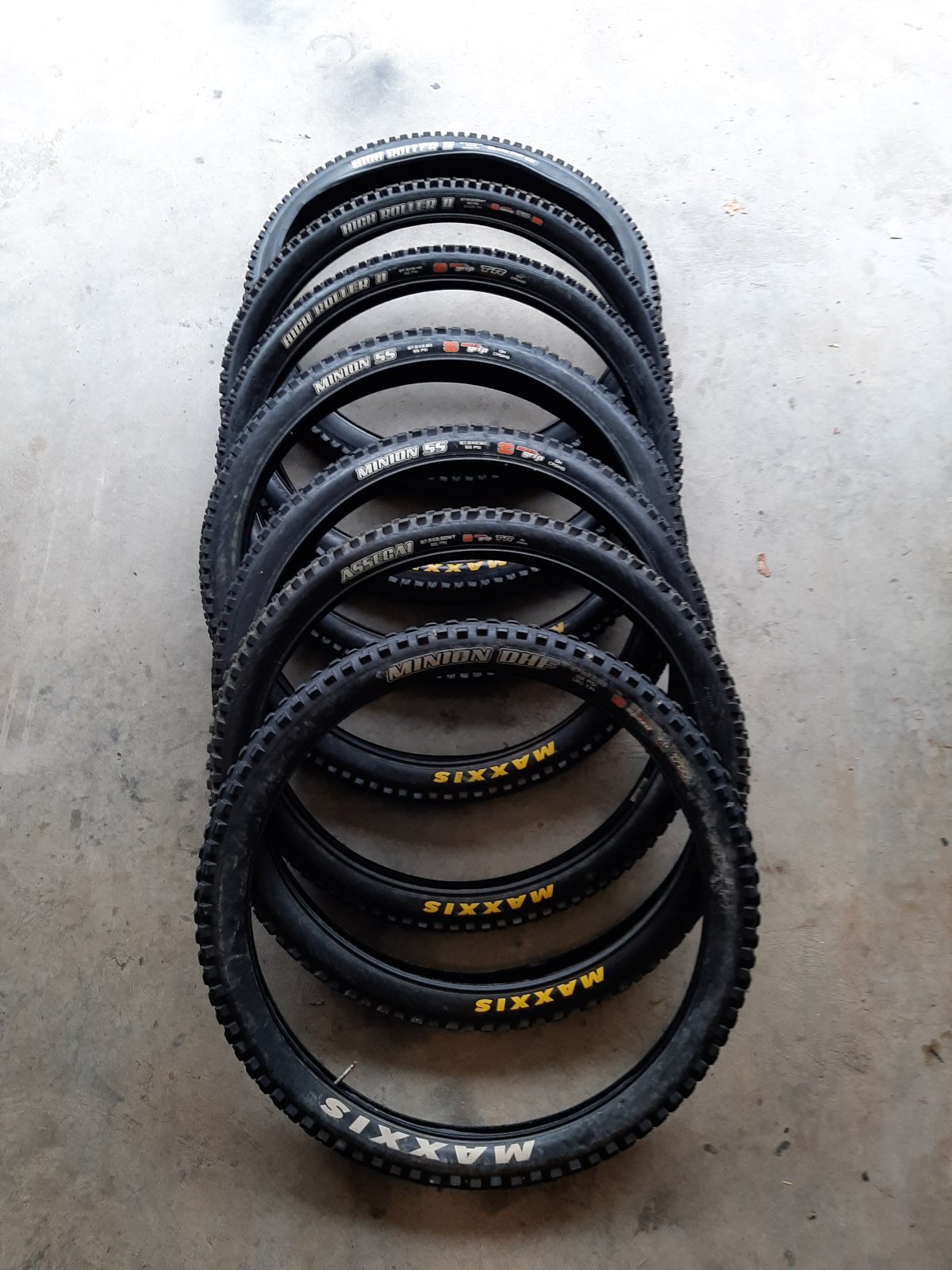

So all this talking and malarkey about tyres has made me curious. As luck would have it I bought a bunch (for Chf 30!) all are nearly new so obviously someone has a Maxxis sponsor as they came with bags, stickers, belts and a calculator! I tried the DHF 2.8 on the front and straight ahead grip was good but steering was not much different to the Butcher. So I then put it on the back and Agessi 2.5 DHC on the front. Definitely a bit more rolling resistance. Steering has improved out of sight every where. DHF on the rear is interesting, braking and traction going up in crap conditions is a lot better but it does move a bit sideways which I am enjoying except on wet roots. A faster combination for me as I have better grip for braking late and the front goes and stays where I point it.

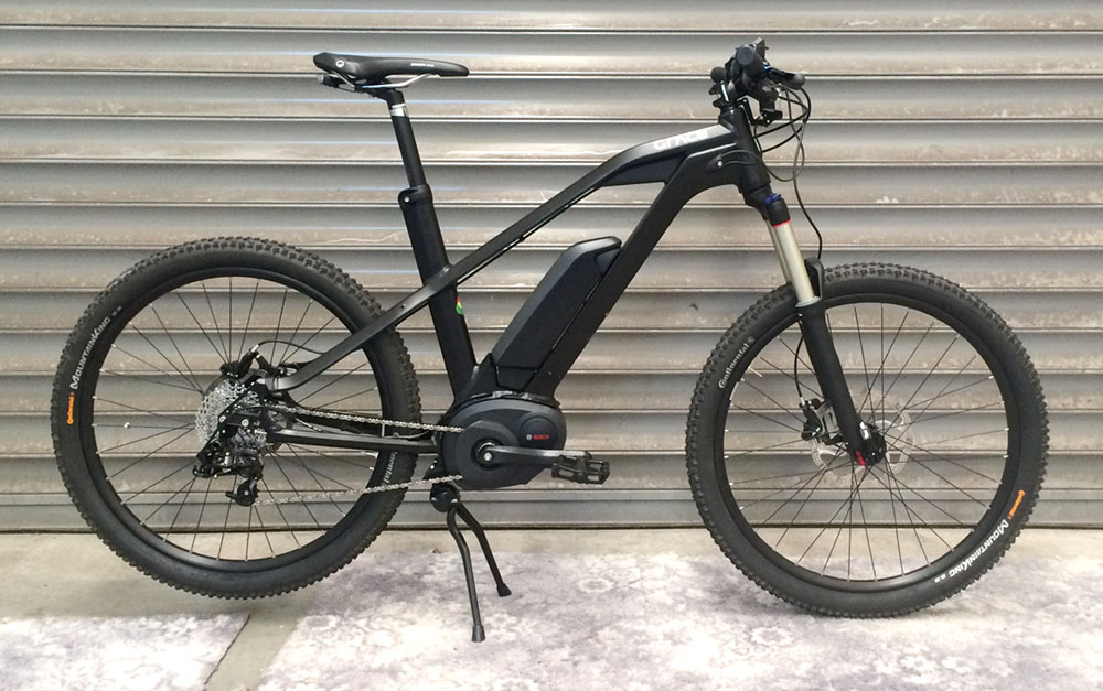

Four years ago, the company I work for acquired a "Grace" hardtail eBike which was imported from Germany. It's the first proper eBike I've ever ridden and is what got me convinced that pedal assist bikes are gonna take off. It's not a common brand and I doubt if I'll ever see it in NZ bike shops.
Much to my surprise, those Continental Mountain King 2.2 tyres it came with happens to be very good in wet slimy hard pack clay and greasy exposed roots where I ride (common NZ winter terrain). In fact it was good for anywhere (loose gravel, sand, tarmac). When came the time to spec tyres for my new trail bike-build (with a Bafang conversion kit), I naturally wanted the same tyre. I had to go to an importer to get them (stores didn't stock them at the time), but I was shocked that they were just the cheap basic tyre model. Put them on and couldn't be happier. Even on higher (safer) tyre pressures, they still bite well in the wet. They're just as useless as any tyre I've tried over mud bogs, but the treads are quick to shed the mud off and self-clean once they're out.

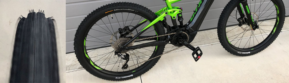

A year later, when I got my Giant Trance E+, it came with Maxxis tyres with the usual Minion 2.6 DHF at the front - I mean what eBike doesn't come stock standard with this, right? I know it's meant to be the best front tyre for enduro eBikes but I just couldn't bond with it from day one. It felt very draggy (bike slows down noticeably when coasting) and the square-ish cross sectional profile made the steering sluggish and the side knobs just kept flicking up stones for some reason. I was about to change them to Maxxis High Rollers.
But last minute, I decided to change over to Continental Mountain King tyres when I realised they were available in 2.4 and you're right @Kave their 2.4s almost seem as wide as the 2.6 tyres. I believe the Trail Kings are a better model up with better compounds and casings... improving all the way up to your Der Barons, which I'm meaning to try one of these days. These models are all available in 2.6 but I went for the 2.4 for lower rolling resistance (easier on battery drain).
Below is the thread profile from my spinning Continental MKs (these particular Conti models seem to have a similar cross-section - although slightly different tread patterns). It's roundish with a minimum central row of knobs, with the side knobs only coming into play when you need them during cornering. I believe its why it's got low rolling resistance and gives a livelier steering for trail riding which is what I mostly do.
I don't ride hard enough to ever take a DHF to the ragged racing edge, so I can't comment regarding a high performance comparison. But I do like the Conti MKs 2.4 as a jack-of-all-trades tyre that's more trail oriented, and is at the very least - predictable in the wet.
