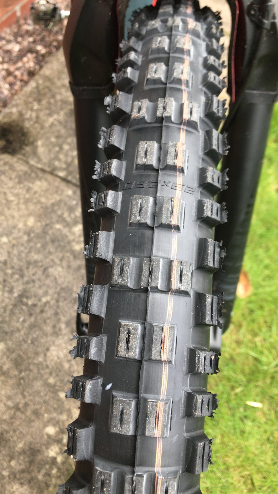

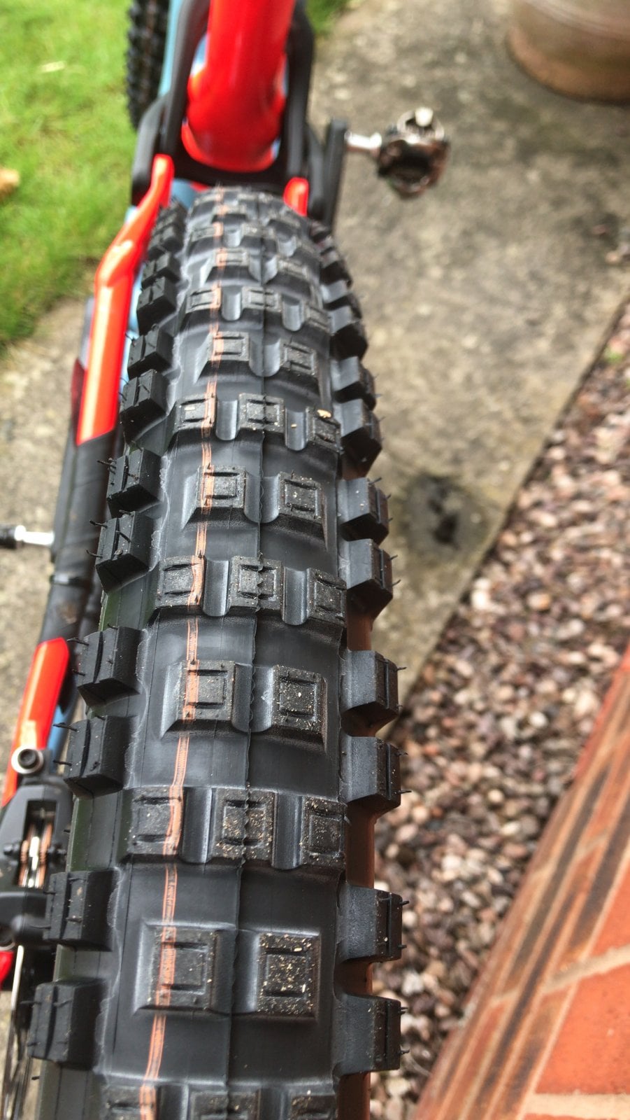

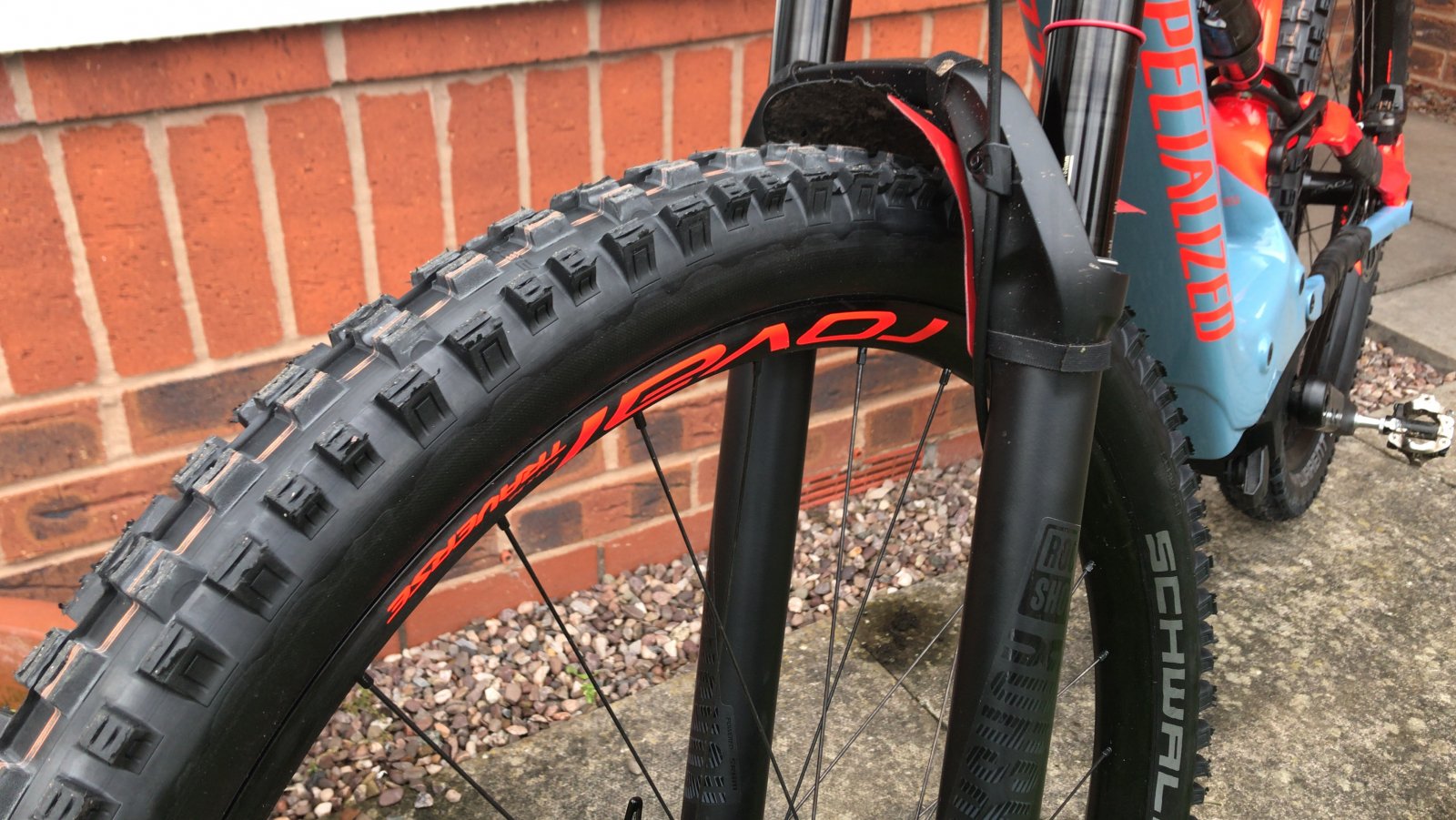

2.5 Minion DHF on the front now, stock 2.6 Butcher on the rear (not tough but it got around Coed Y Brenin OK this weekend).
I had a 2.6 HillBilly on the front, OK but a bit balloony, the profile is noticeably bigger than the Butcher and Minion. So not sure what I'll do with it.
One thing I like about the Minion is the rounder profile - Spesh tyres always look to have a square profile to me.
I'll look for something more blocky from Maxxis for the rear when the weather turns wet. Any ideas?
