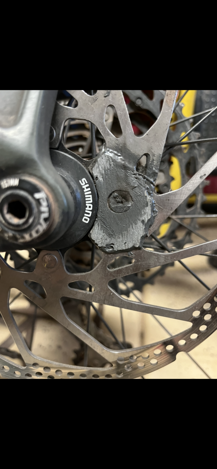

I’ve just bent the rear rotor on my Merida e160 and replaced it with a Swissstop rotor. It’s great but the problem was what to do about the magnet. For now I’ve just epoxyed a magnet to the rotor but planning a more robust solution with a thin sheet of titanium.
I use JB Weld and fiberglass cloth to fasten a magnet to a regular rotor. I have done this about four times on different rotors. I works great.

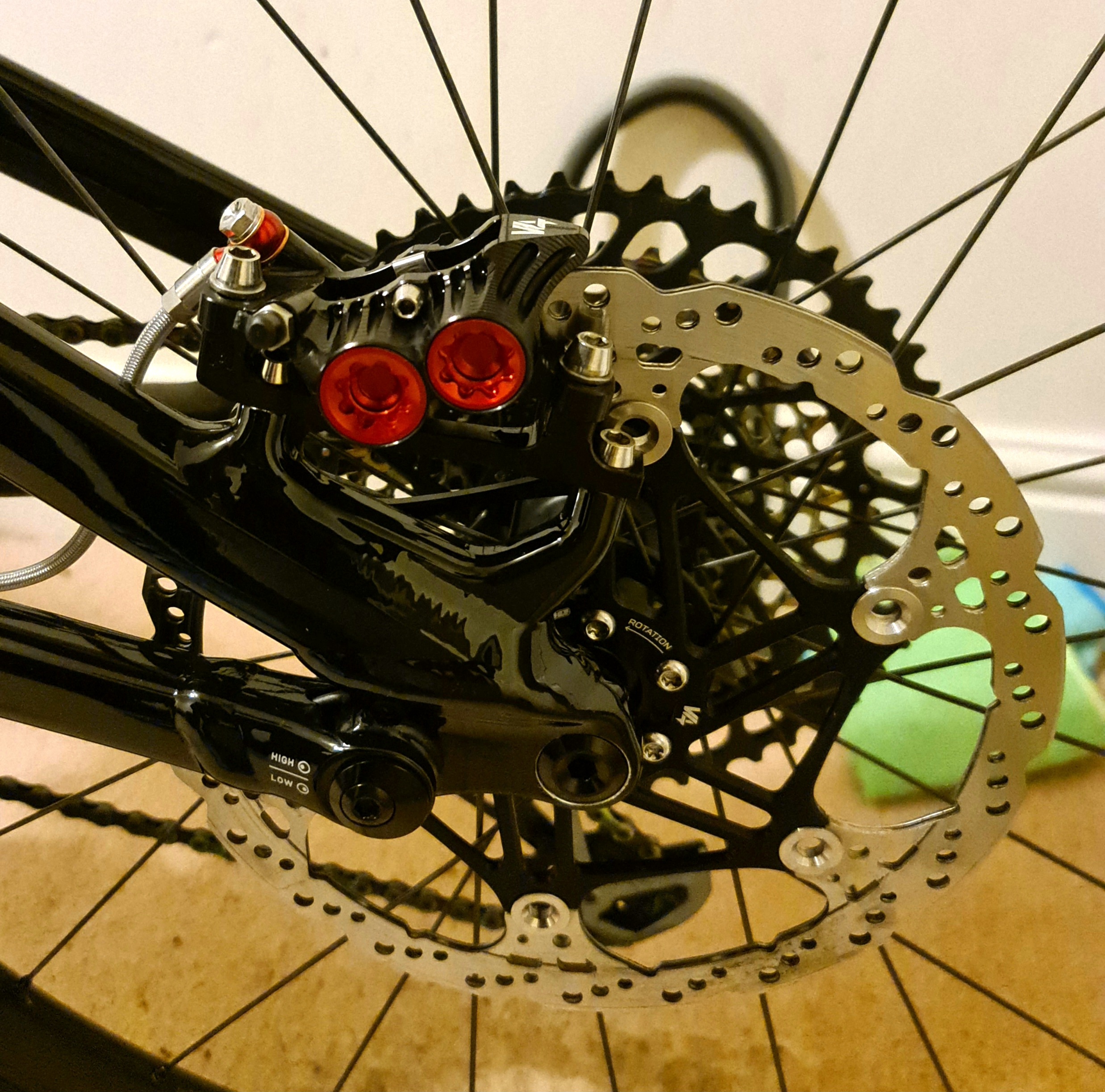

Trek Rail with Swissstop Catalyst Pro 220mm rotors front and rear. Coupled with Shimano M6100/M6120 levers and calipers they are super quiet single finger stoppers with loads of feel. Have Shimano organic pads (D03S) but will soon try Swissstop Disc 27 RS pads.

V4 floating 220mm front and back.
Not had any issues with heat and perform really well in wet muddy conditions.
