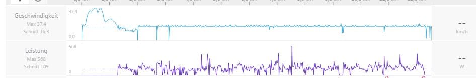

In the attached file you can see what happens to the recorded speed as soon as i connect the Levos "Powermeter" sensor.

I have still the old SW and circumference is set correct.

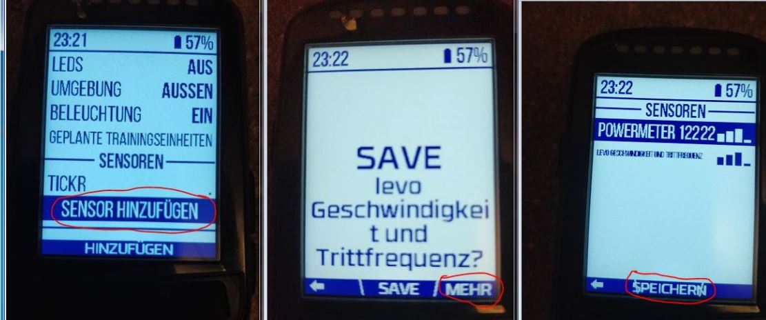

Diver is correct of course, Wahoo app sees a powered-on Levo as a POWERMETER device.
But it clearly gets cadence and speed data from it also, even they are not shown. I think the Spesh uses a correction factor in the rear wheel rotation sensor that Wahoo is not interpreting or correcting. I think this would be a simple software fix to be honest, for Wahoo.
If you upload to STRAVA then distance is out by almost x2. So then the average speed is almost double also. It's clearly a speed signal issue - Strava takes wheel speed sensor data OVER AND ABOVE the GPS speed data if it exists in the file. The same Wahoo file dumped to other apps like KOMOOT show it all correct. Perhaps Komoot only uses the GPS data? Or KOMOOT ignores the suspect wheel speed data, who knows.

My 2018 Levo is also paired with my Bolt under a Sensor "Specialized" where i can see "Speed" and "Cadence". With "Speed" i can adjust the real wheel size, so speed and distance data are correct in Strava, Komoot, RWGPS, Garmin Connect ....

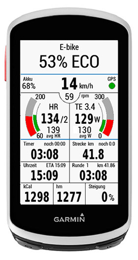

Long story short: I have owned a Wahoo Elemnt Bolt for a year and if I had to vote again today, I would take a Garmin 530.
In depth: The Levo has ANT+ and Bluetooth interfaces. Wahoo supports various Bluetooth devices as well as various ANT+ profiles. ANT-profiles provide standards for highly compatible device communication. Speed, power, cadence etc. is provided by the Levo via ANT+ profiles, which the Wahoo knows. Not so with the "support level" and the "remaining battery capacity". These values are provided by the Levo via the so-called "LEV" profile. This profile is not supported by Wahoo. Therefore the only solution is the "fake channel", where you have to sacrifice your heart rate or cadence.
Garmin supports an interface that gives programmers access to ANT data. Therefore, there are 3rd party apps (besides Garmin's own solution) that display e-bike data. A clear plus for Garmin.
