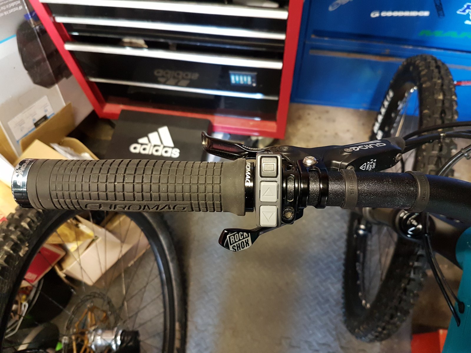

And here's the 6000 shifter fitted with Reverb 1x remote. Unfortunately it seems that the Guide RE have different clamps to the Guides so the MMX adaptor doesn't fit, not sure if SRAM make a compatible version. However this setup works well for me although I have big hands, others might want to swap the dropper and brake position to move the brake lever a bit further inboard
Gary
Old Tartan Bollocks
Mar 29, 2018
10,496
10,709
the internet
Ah... seems a lot more usable fitted in that configuration.
Guide RE/RS etc have 2 styles of clamp. you simply need the MMX split hinged style. they're sold separately at RRP 19.99 but can be found for around £12-13 .online.
what drop reverb do you have fitted? (and what's your inside leg measurement?)
and what was the lower inside of your seattube like? mine has a reinforcing ring/weld stopping the post being inserted below the bottom of the actual tube. I'm wondering if yours is the same being a larger frame size. it stops the post fouling the shock but if it weren't there I could have run a 170/150mm post fine. I did (later) think a shimmed 30.9 post might slide through ok. can't really be bothered with the faff now to go back and test this out.

Cheers, will try it like this but if I do want to move the brake lever slightly left I might get one
170mm Reverb, 36" inside leg. Think you can see from the photo I could run a 200mm dropper. One slightly annoying thing is that because the hose is cable tied to stop it fouling the shock you can't drop the post down to the clamp to get it right out of the way as I like to do at bike parks etc. Well, you can but risk kinking the hose which was what CRC had done with mine when they packed it, kinked the BrandX cable badly enough that the post wouldn't stay up when sat on.

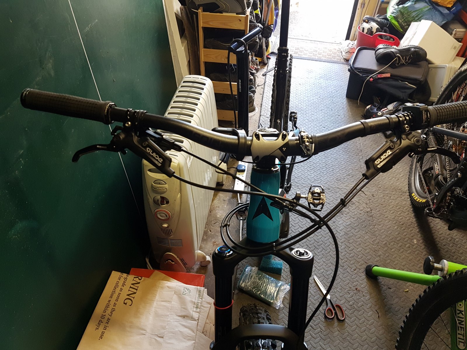

Regarding running the new hose through I'll admit that I forgot about the Reverb hose barb doodad but after dropping the motor I found that the cable has been run through a foam tube to stop it rattling. Even with nothing tied on the other end it took a fair yank to pull the BrandX outer out, I suspect that the foam tube compresses and makes it hard to move the hose/cable outer. All I can suggest is that anyone else trying it uses the red connector and tries to pull one end whilst pushing the other extremely gently. There is also a dead-end at the bottom of the downtube where the motor sits so once the cables are detached there is very little chance of fishing another one through, I'm an electrician by trade so pretty good at fishing cables, I gave up and dropped the motor.
The other thing to note is that the cable entries at the top of the downtube have one each side for a 5mm hydraulic hose and one only big enough for a 4mm cable outer. To keep the hose running around the headtube I had to use a Dremel and sanding bit to open the hole out. So yeah, as dropper installs go it was a faff

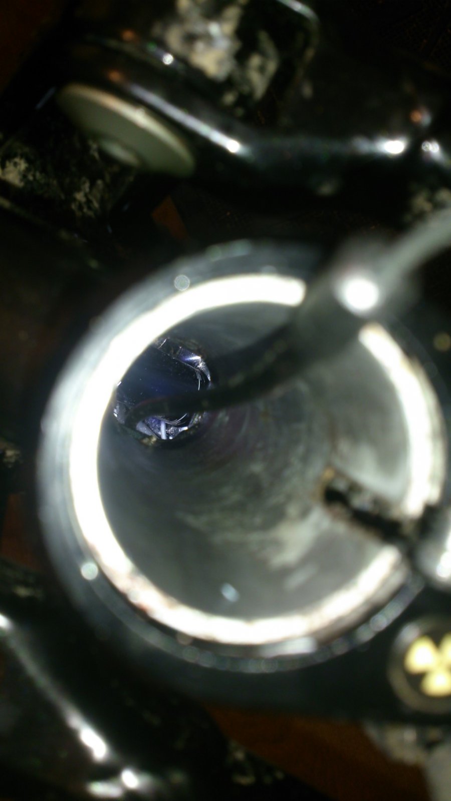

while I had the post out to inspect it I dropped the shock from the rocker to take a proper look at what's going on inside the seat tube.
What I found was weld all round the inside down at the bottom, a few spots clearly put there to stop the seatpost dropping through onto the shock.
The seat tube only has 130mm of insertion max.
Sorry. I'm no David Bailey but if you click on the image it should be obvious enough.
Anyway. looks like my only option for a longer seatpost is to ream/dremmel the seat tube (I'll need to call CRC to find out how this'd affect warranty) or swap out my 170mm OneUp for a 150mm (I haven't had time to send it back yet)
