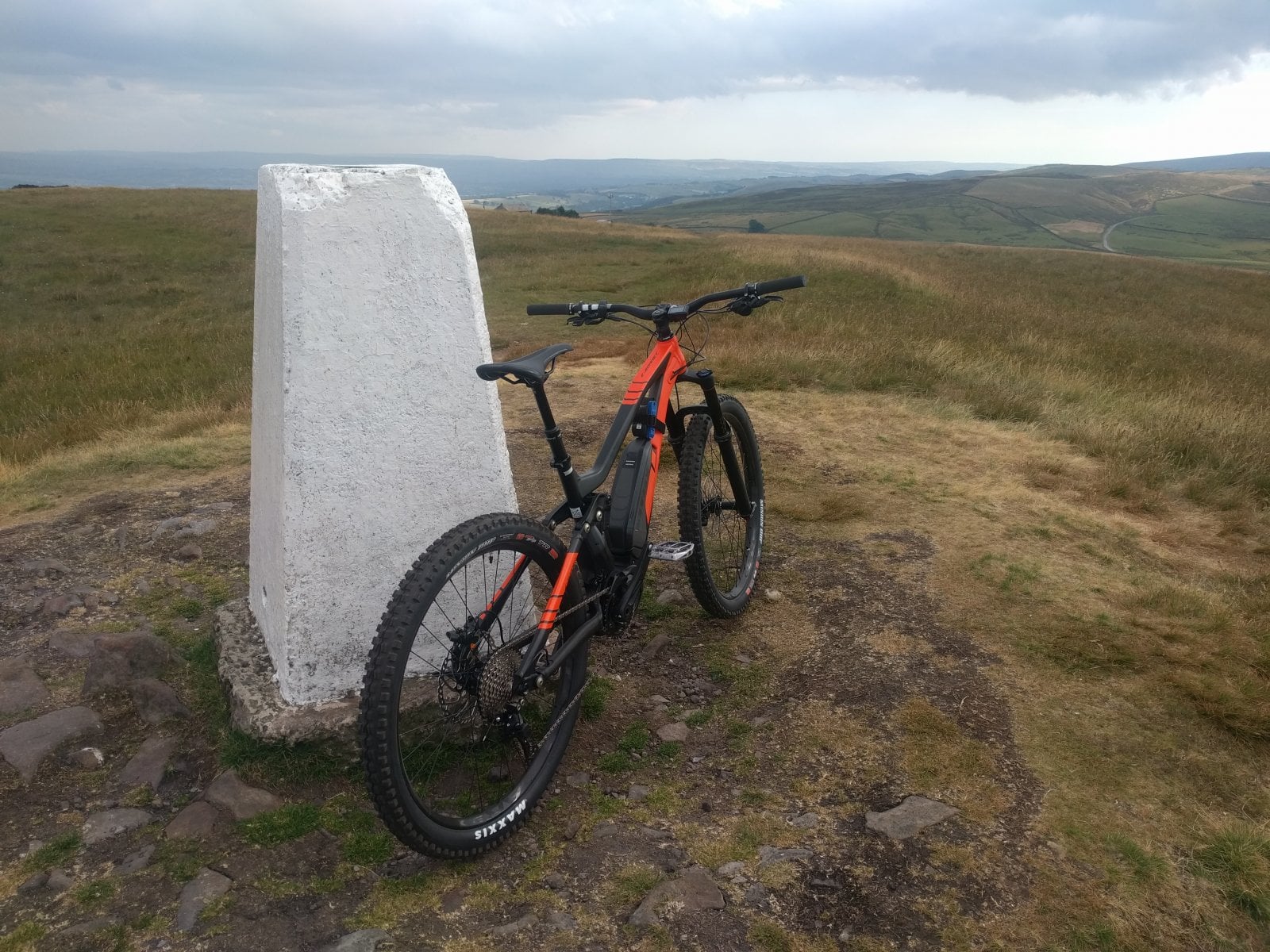

First big ride done:
Follow Martin on Strava to see this activity. Join for free.
All done in eco except for 20 mins of pushing which even turbo wouldn't get me up. Battery went to 1 bar at the top of the last climb.
There's nothing wrong with the handling of this downhill, the extra weight does mean you pick up speed a bit quicker in the steep stuff so you have to concentrate. Rock gardens, drop offs, fast grassy and nadgery tech sections all dispatched as easily as on my Commencal Hip Hop.
On the steep ups the front does wander a little bit and some practice will be required to start popping the front over obstacles.
The brakes are ok but I'll try some sintered pads next time I think just to see if they improve things. Braking control was fine though with good feel and modulation.
Had a battery error after stopping for some lunch where the bike auto turned itself on and when I restarted it it had an aw013 error code.
Switching off and on didn't sort it but taking the battery pack off and refitting did.
My 'shimming' of the post to limit travel worked fine, I used 1" sections of zip ties in each of the keyways to limit things as my first attempt with a lid of a takeaway tray proved to be not sturdy enough.
Would have been nice to have finished with two bars left but 5000ft most of which were pretty steep on a hot day obviously took its toll. It will be interesting to see how it goes on climbs that aren't as steep.
I might knock the assistance back on all of the levels though as I find trail on steep climbs caused the front to lift too much.
