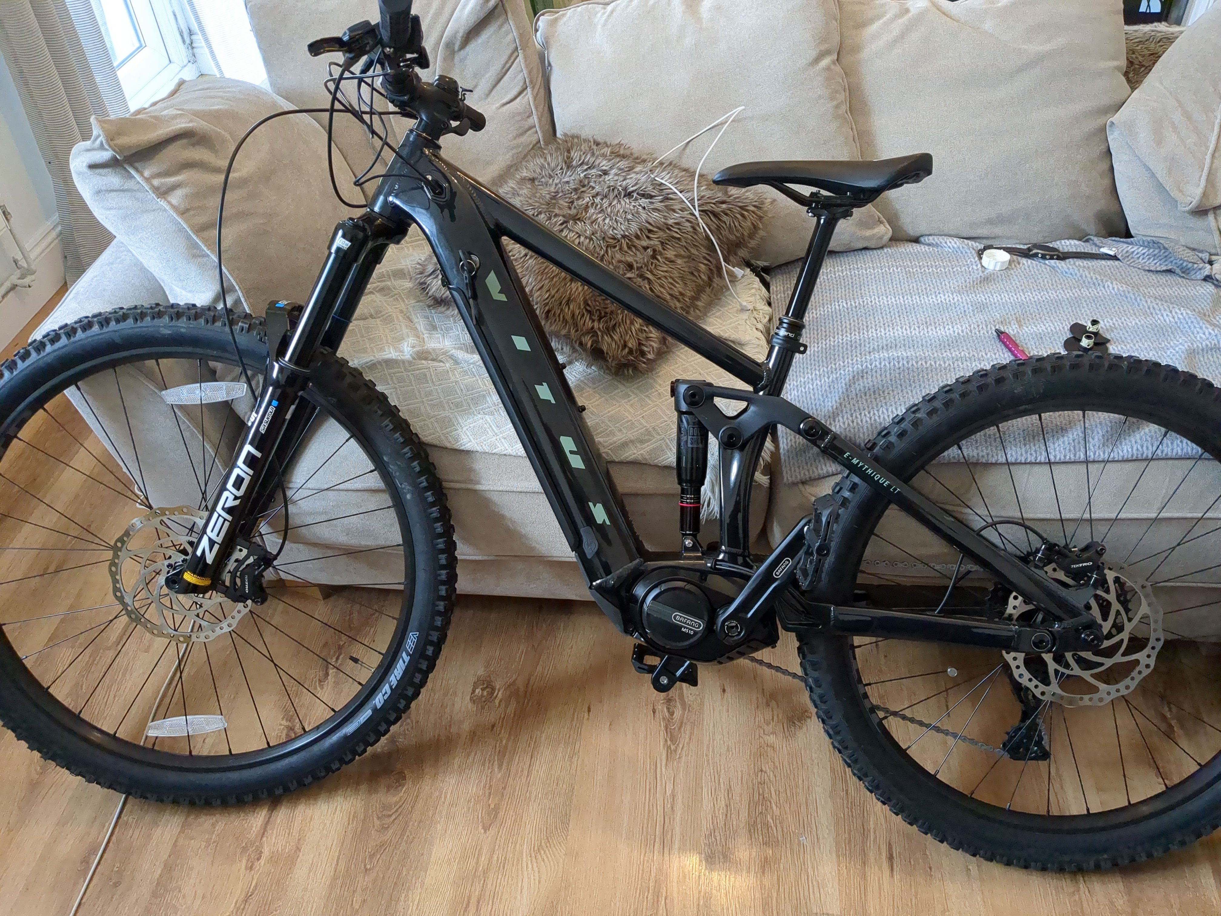

Hello,
I have recently got an E-Myhtique and after two or three rides have not got the same issue. I was planning on a ride this morning but bike would t switch on. I worked my way though starting at the screen connectors but all looked okay. Took of the bash plate and the side panel that covers the motor on the drive side and still looking okay. Removed all three connectors and found the connector that was furthest left as you look at it was wet and had some crud in it. Sprayed some penetrating fluid in and carefully cleaned without damaged the pins. Did the same with the other two just to make sure. Then gave it a quick blast with a hairdryer then connected it back up and now working. Hopefully this is problem solved but gonna leave it disconnected and inside for a bit to dry out more.
The rides have all been wet and I went through some deepish puddles which I misjudged. Also use a Mobi bike cleaner to clean bike as well.
Looking at bash plate and side panel the connectors should be fairly well protected but moisture must be sitting in there and working it's way into the connection.. My bike has been in the house when not used so in a dry fairly warm place.
Not sure if the connector seal could be better or maybe connector wasn't seated correctly when put together at the factory as the other two seemed okay.
Hopefully that's solved it now but gonna keep an eye on it.

Hi , hope this sorts out your issue , if it were me I’d also clear frame wrap over the dcp245 display screen , mine lets water in causing the same issues. When it drys out it’s ok , since fram warping it it’s been perfect 🤞

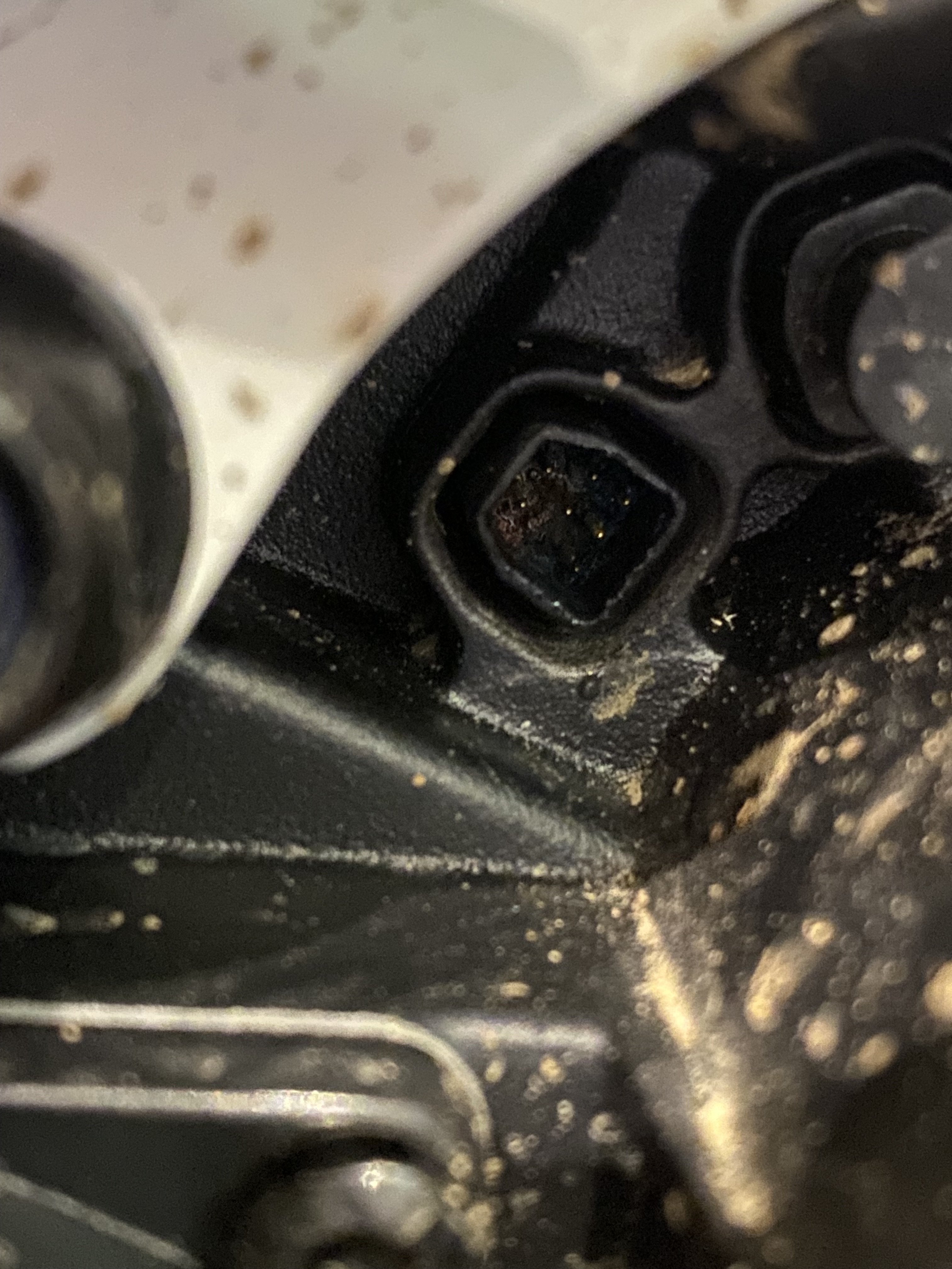

Another dead Mythique here.
Wet ride, started to malfunction, wouldn’t switch off, code 36 on screen, pulled battery, put it back and it turned on, still code 36. Dried display and buttons, dried connections at motor - worked fine. Went back an hour later - completely dead!
New display and buttons and wiring loom - no difference.
Currently motor, loom, display, battery and lower battery mount are connected on the kitchen table - still nothing.
Only thing I have noticed is the battery connection sparking when connecting to battery mount. Battery goes in and out of sleep mode ok. The 2 connectors marked + and - on the battery are live all the time and show 36v.
Stumped, what to do now?
My feeling is the fault is in the motor as the battery connector was bone dry and the connections at the motor were quite wet.
Warranty is not an option any more according to Chain Reaction.😟
Same here, i have just ordered a new socket board, apart from the battery its the only thing left to replace
