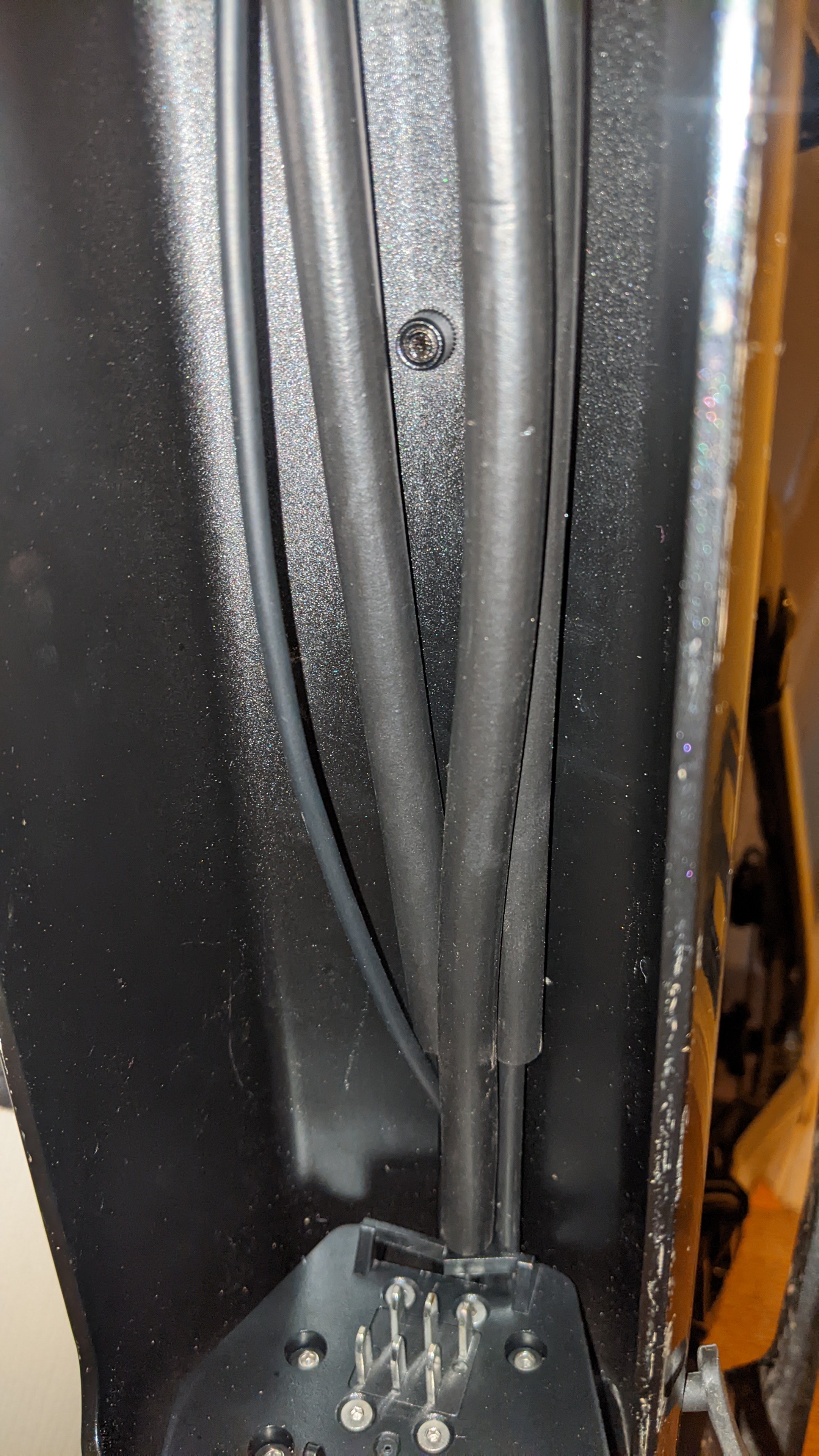

Hi Guys,
I've a Vitus E-Mythique LT VR that after one spin won't turn on again. It was parked up for two days indoors before trying to turn it back on.
Bafang M510 motor.

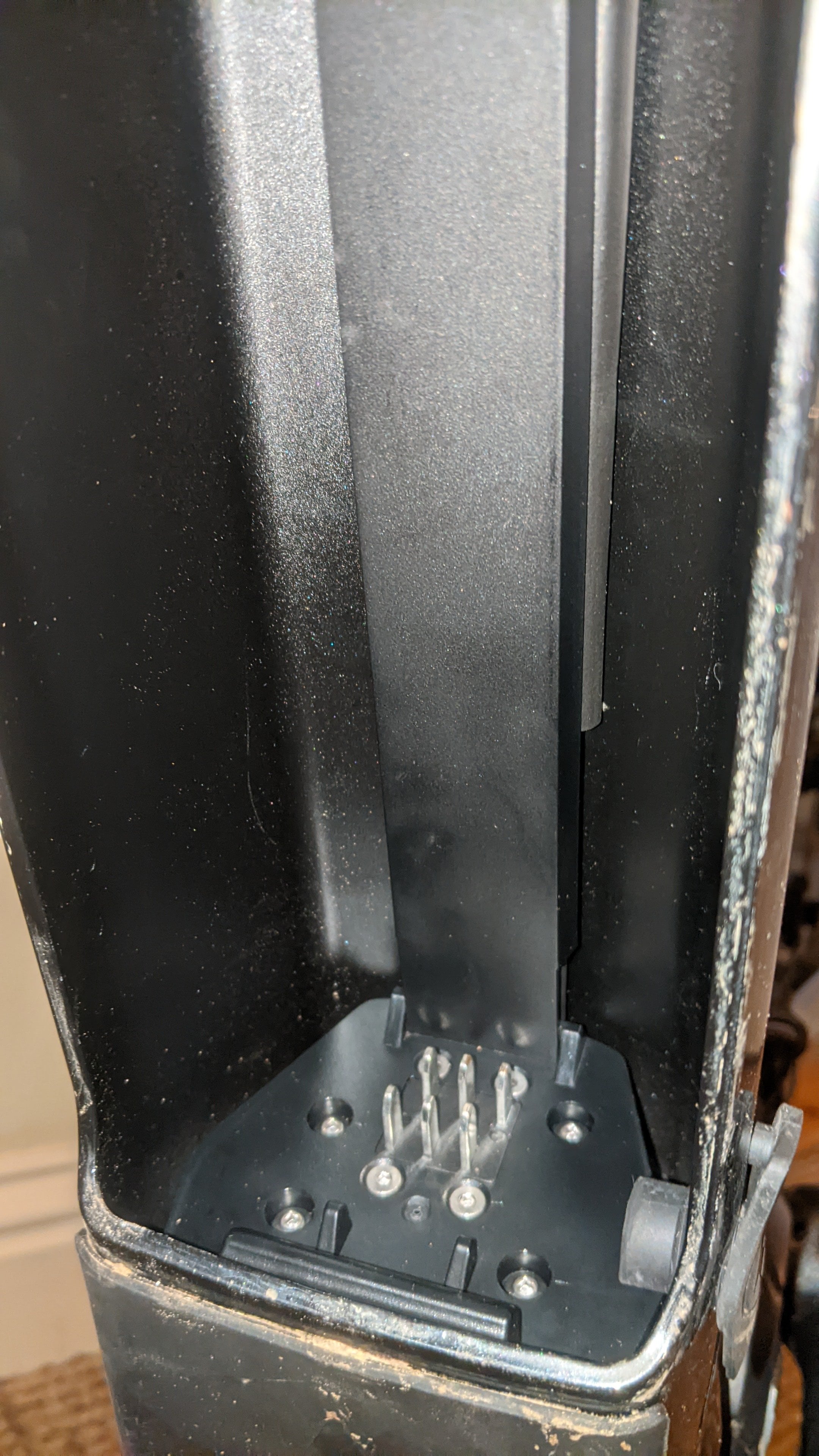

The battery was around 50% when last powered off. I fully charged the battery to see would it help but no result. The light on the charger cable goes from red to green to indicate it's charged.
No response from the power button on the handlebars.
3 connecters at motor are plugged in.
Both connectors in the display are plugged in.

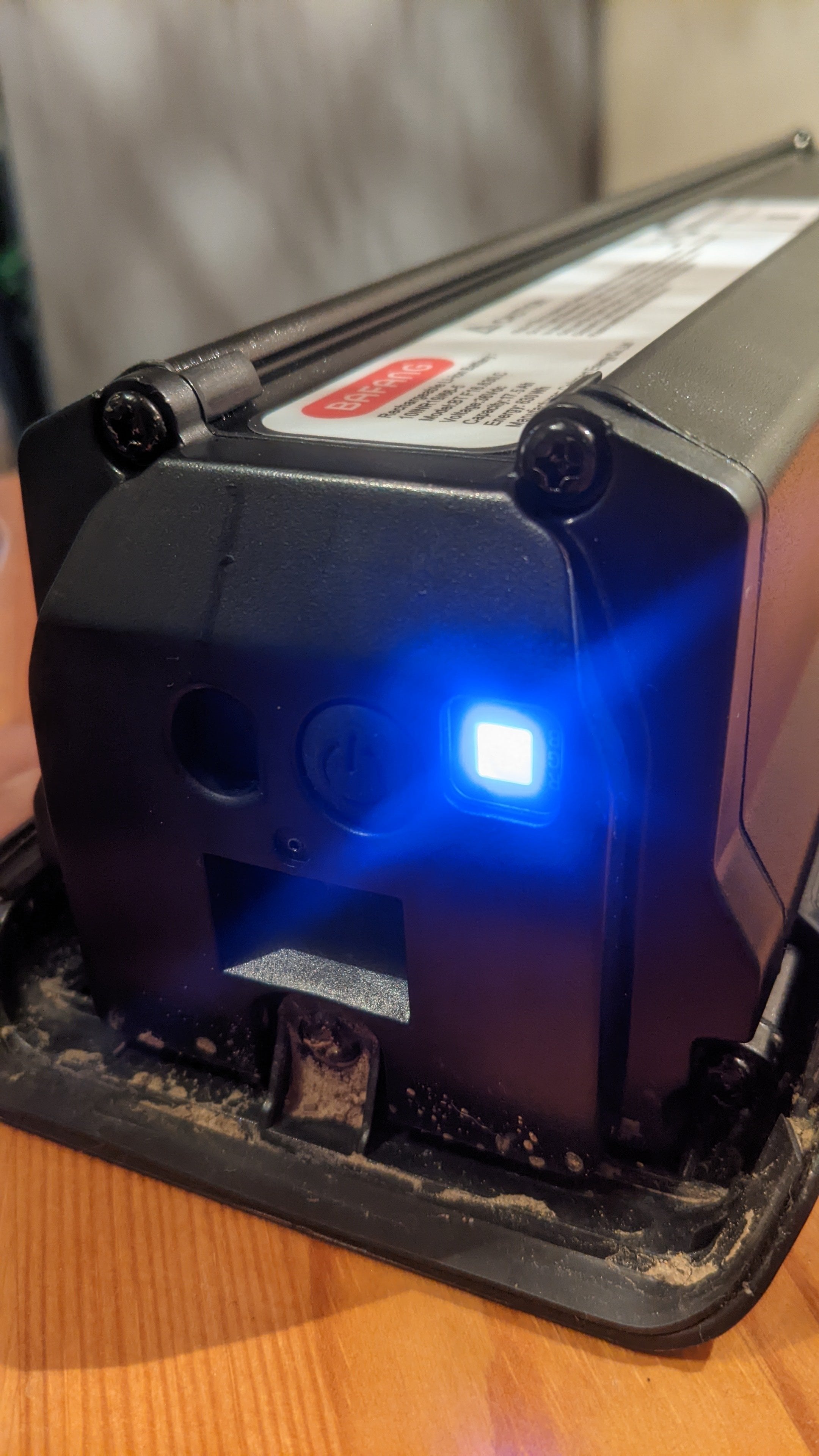

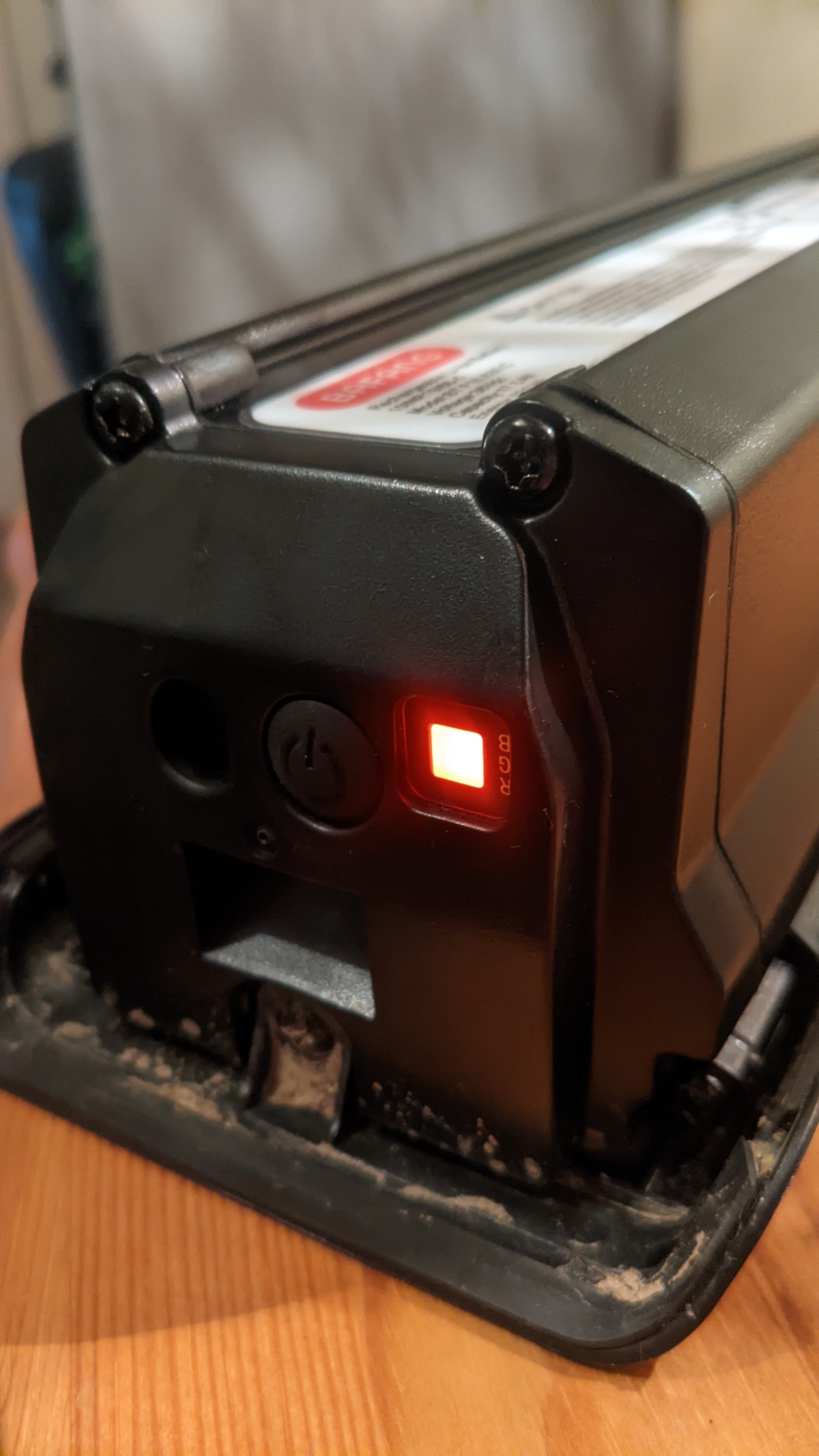

The battery itself: it has a RGB display and it's own power button. The light is Blue. If I hold it for 8 or so seconds it goes into a red mode. I can go back and forth from blue to red but can't get back to green. I read that there could be a sleep mode so that's why I tried holding the button for 8 seconds.

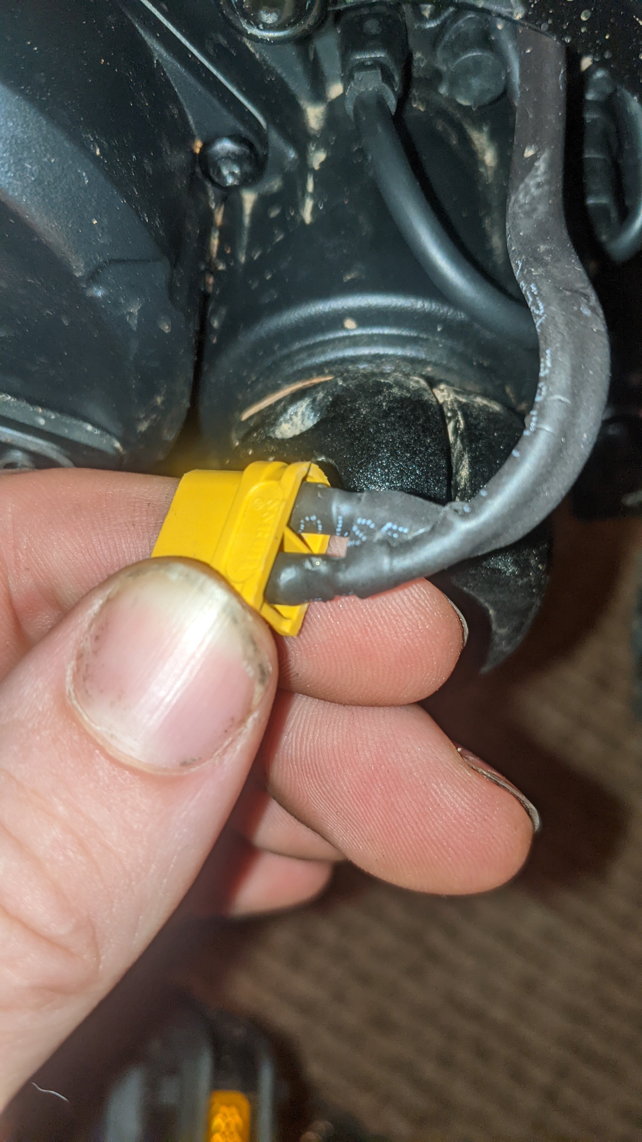

Hard to see but there does seem to be a tiny nick in the positive yellow cables heat shrink that exposes the pin.
The bike is my girlfriends and brand new. Will be contacting the seller as soon as I get her order details.
Any help would be greatly appreciated.

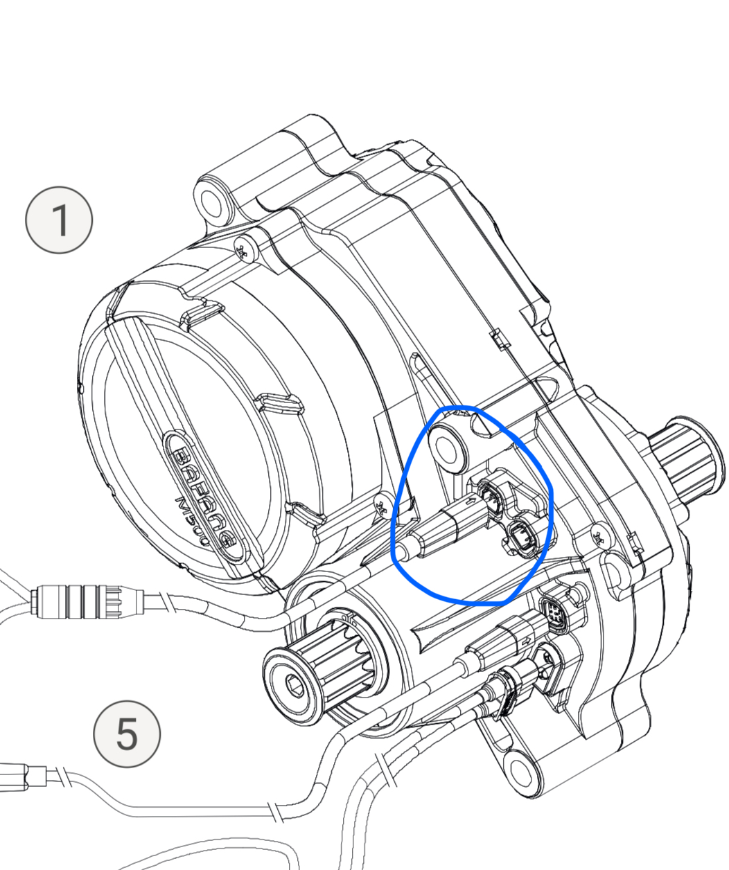

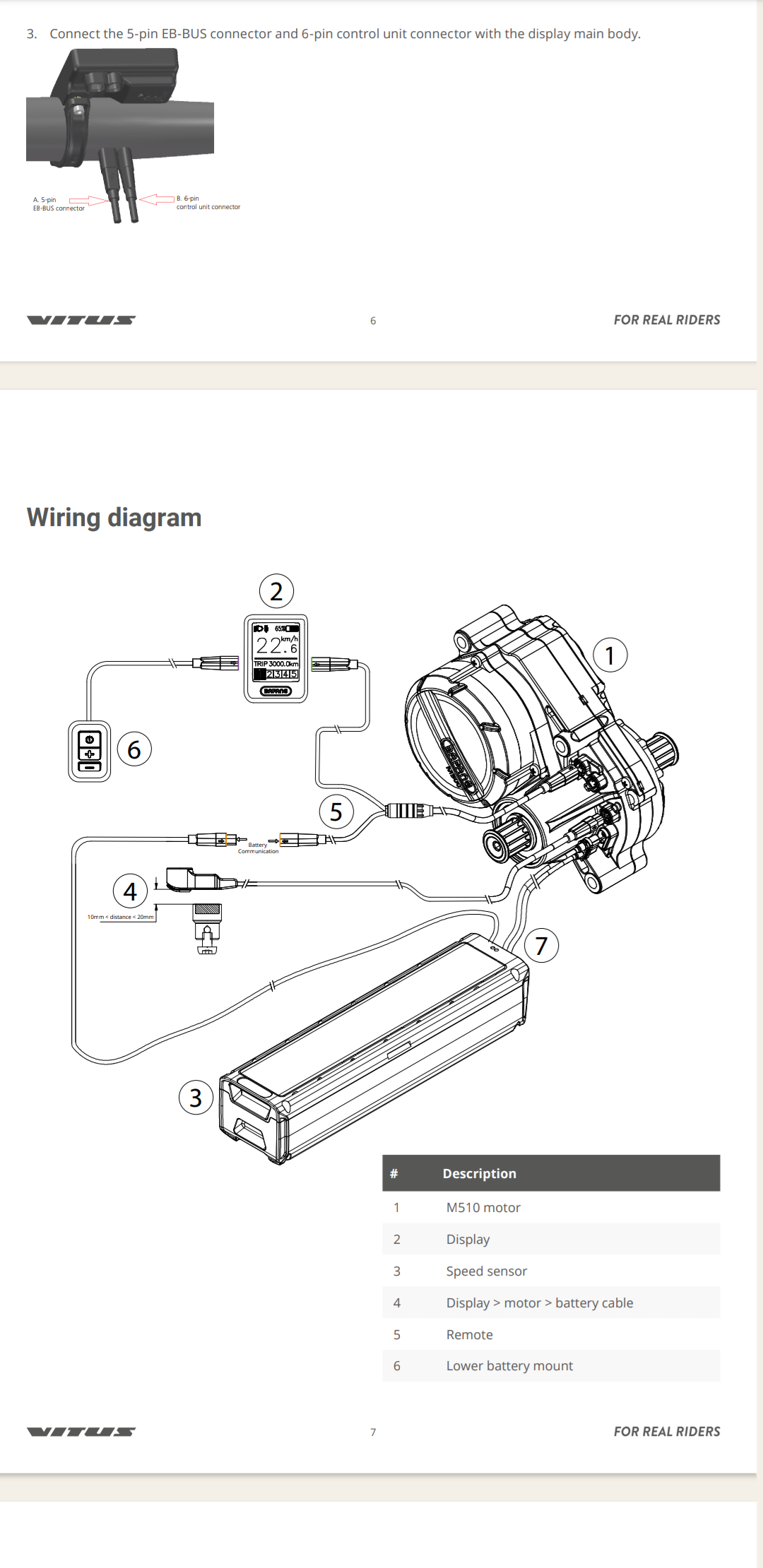

I've checked every connection to see if it's tight except for connection 5 In this diagram which I can't find. I suspect it's maybe inside the frame

I was just reading about the battery and playing with mine.
When charging it looks like it flashes green when it's less than 66% and Blue when charging and over 66%
If I press the button when not charging at 66% it shows blue.
I think 10 second long press brings it out of sleep mode.
It does sound like a cable issue.
If you've not already maybe unplug the cables going to the display and put them in again, just to make sure they're seated correctly. Also make sure the controller one isn't pinched, it's only just long enough so it could get tight really easily.

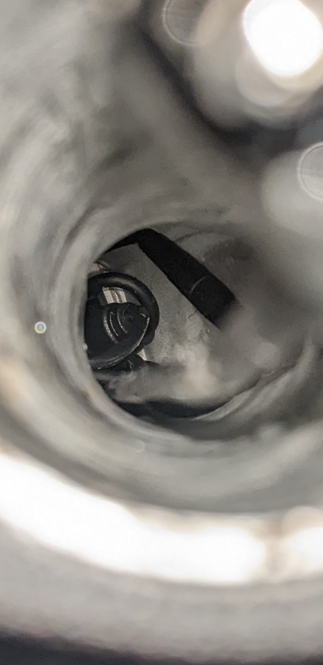

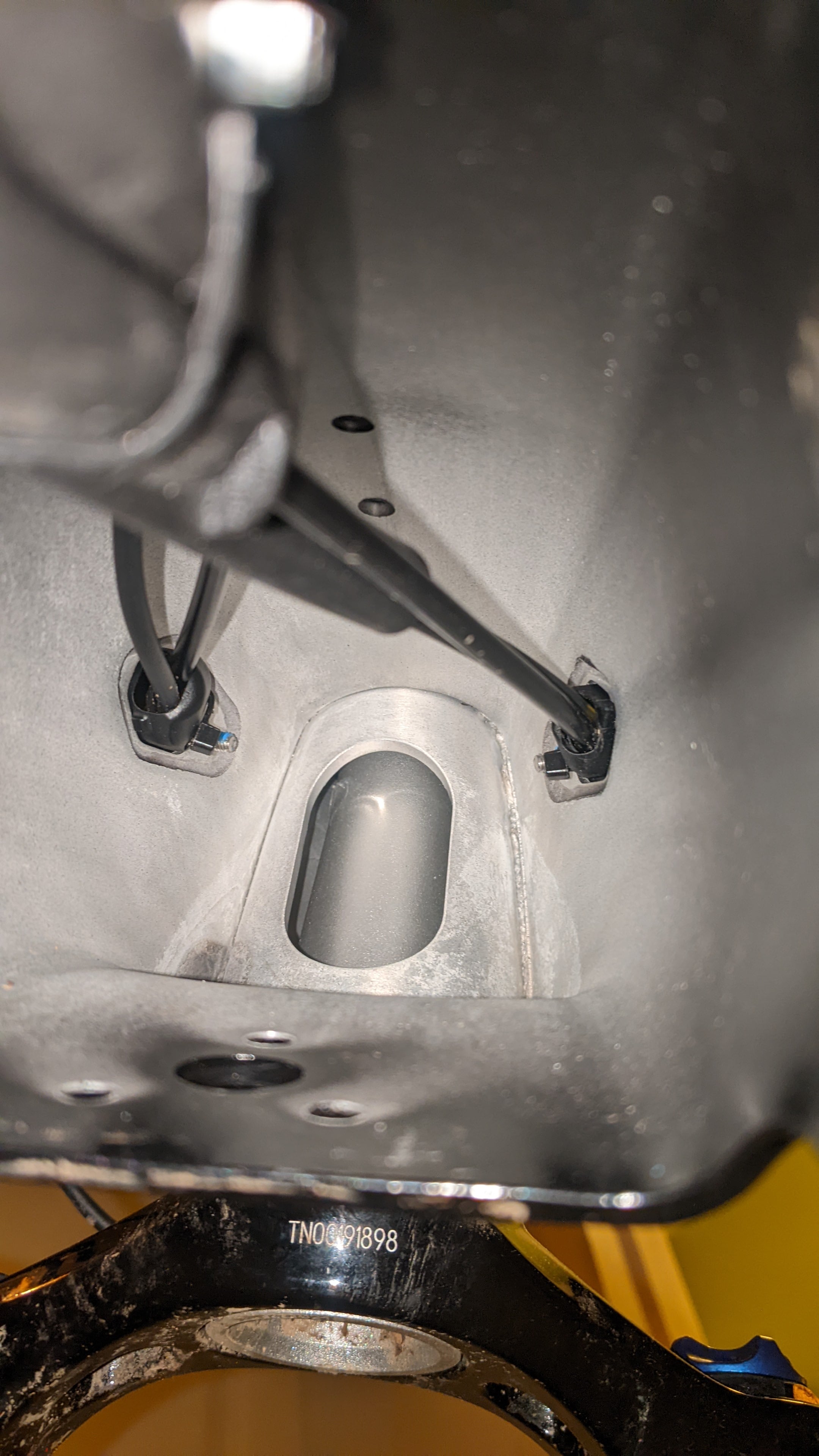

I'm starting to believe that junction 5 doesn't exist?? It's not in the down tube. Remote plugs into display, then display runs into the frame, behind the battery and plugs directly into the motor. As far as I can tell. EDIT: junction 5 is on top of the motor tucked up into the seat tubes. There appears to be two connecters in there.

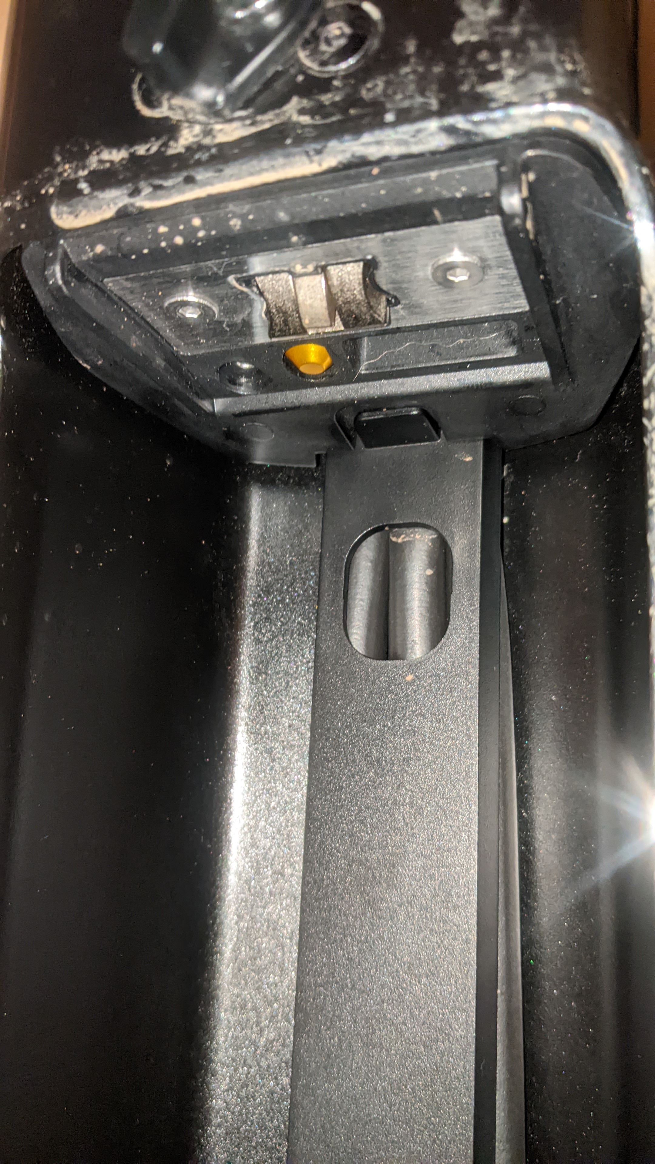

PXL_20230906_181106515.jpg PXL_20230906_181300190.jpg PXL_20230906_181156992.jpg Screenshot_20230906-194105.png
13,999
20,749
Do you think they might have been damaged by the dropper post ? There's quite a lot of space above the motor before you'd get to the dropper though.
It could just be something as simple as a faulty power button/that cable damaged.

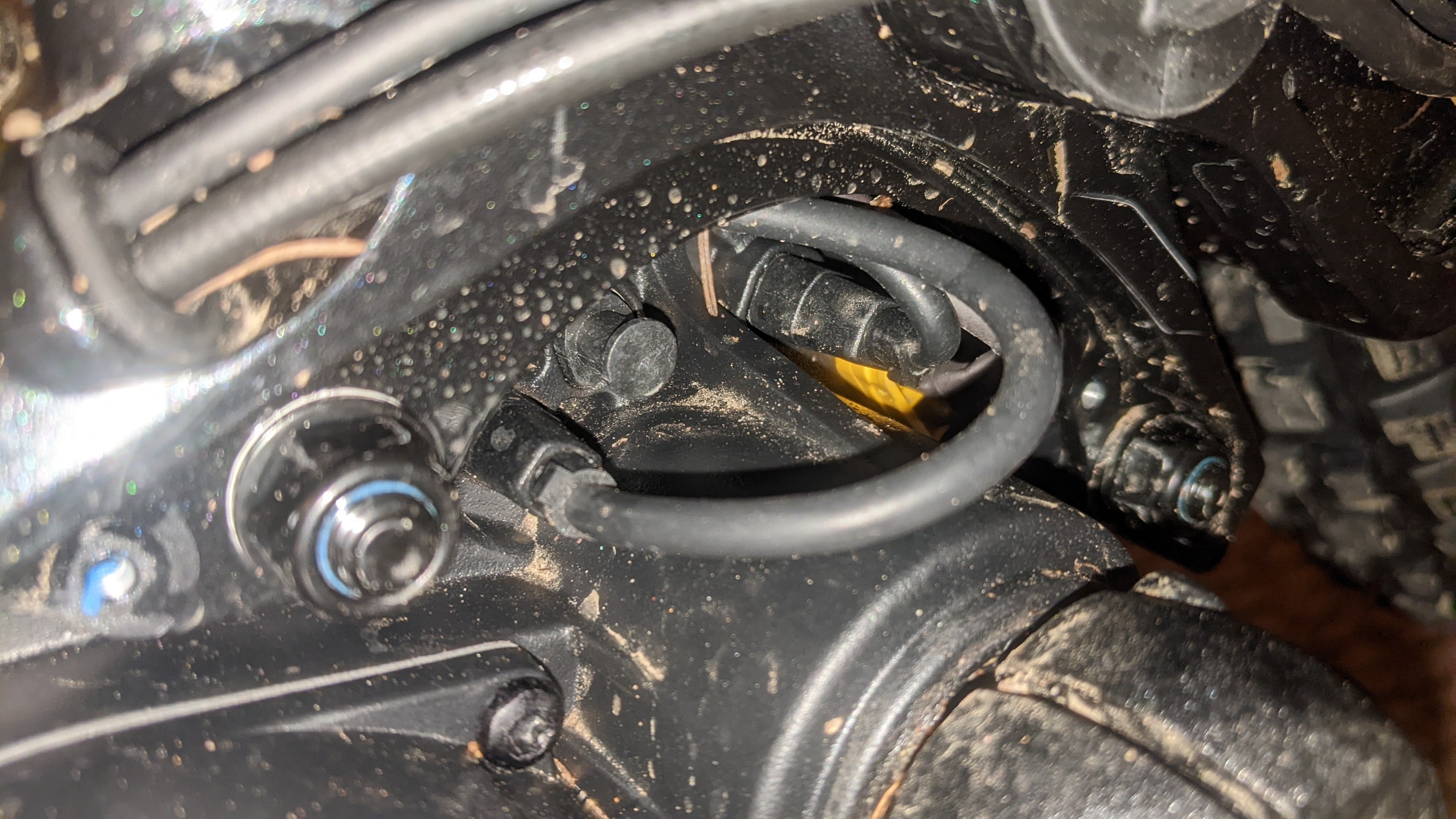

Yes, those connectors are pushed up the seat tube (I pulled my motor and took a look). Looks like there's quite a kink in the cable to going to the connector in your picture.
Can you pull the motor without removing the chainring?
13,999
20,749
Maybe it's possible (the only real issue is getting to the bolt that is behind the chain guide, which you have to get loose and rotate) , but I got a Park Tool BBT-18 (fits perfectly) to remove the chainring.
And if you don't have one of those then I think any Brose/Bosch 8 notch lockring tool will fit.

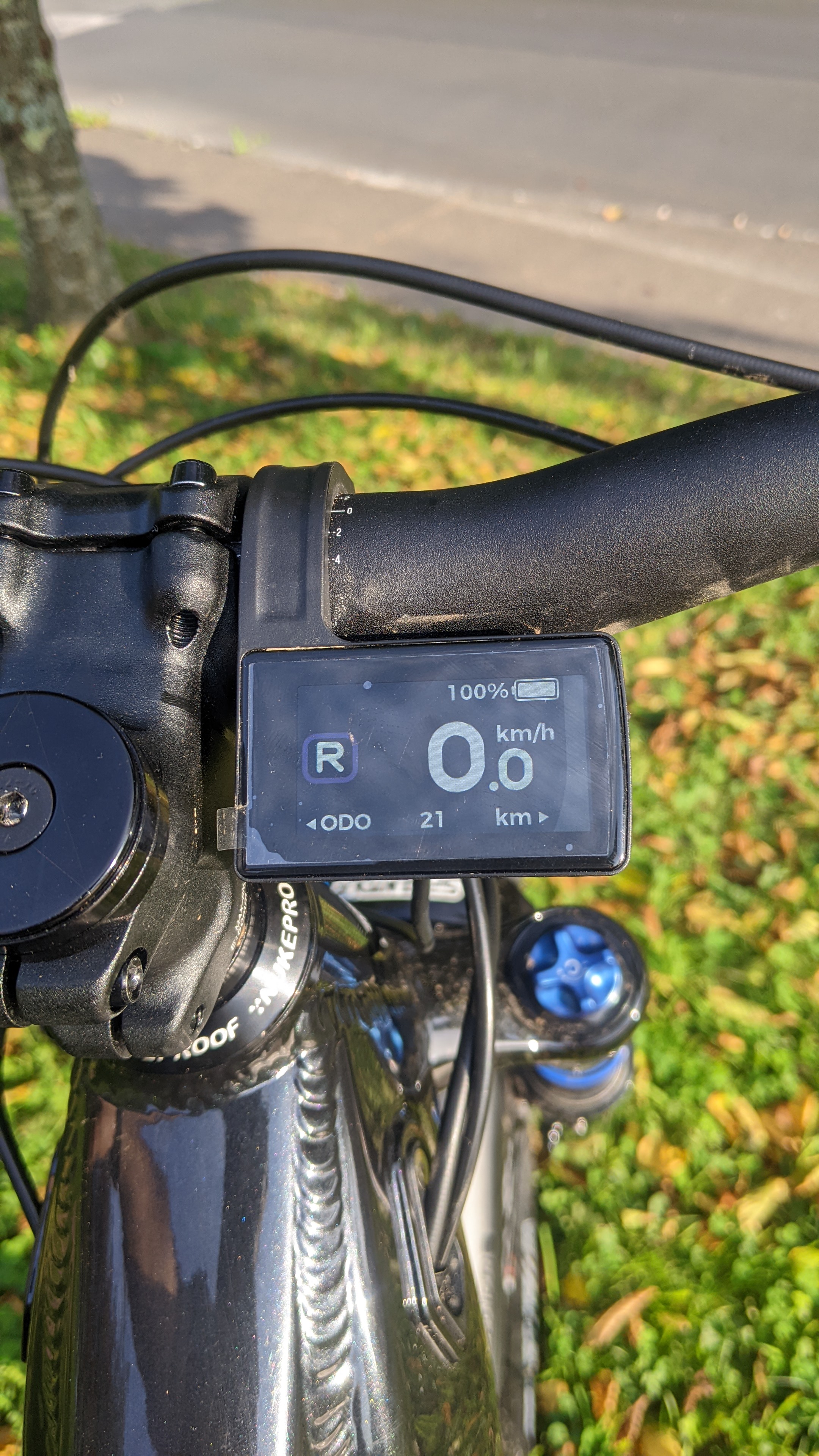

Battery is blue now. So your guess might be correct. I'm half wondering did something get wet and did it need time to dry out. No idea.

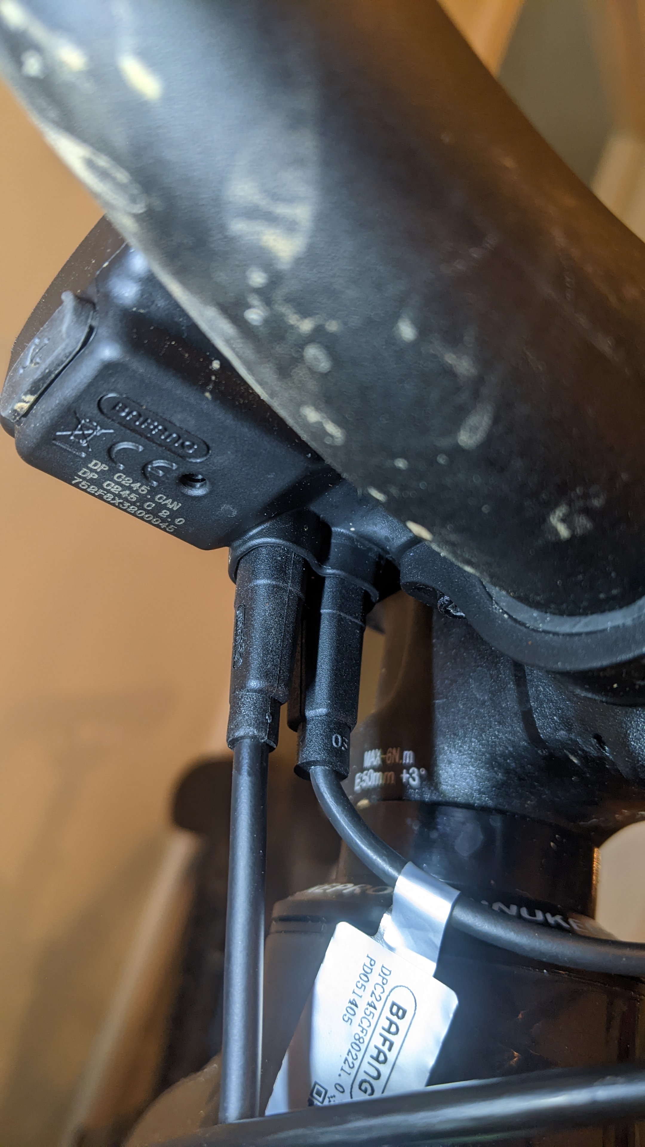

Hi, I have had issues on the 245 display after washing the bike or in heavy rain, if you take the display off dry it out on a radiator it turns on again. I solved my issue by clear frame wrap over the top of the screen & down the edges. Water was getting in around the clear part of the screen .
Not had any problems since I did the modification, good luck.

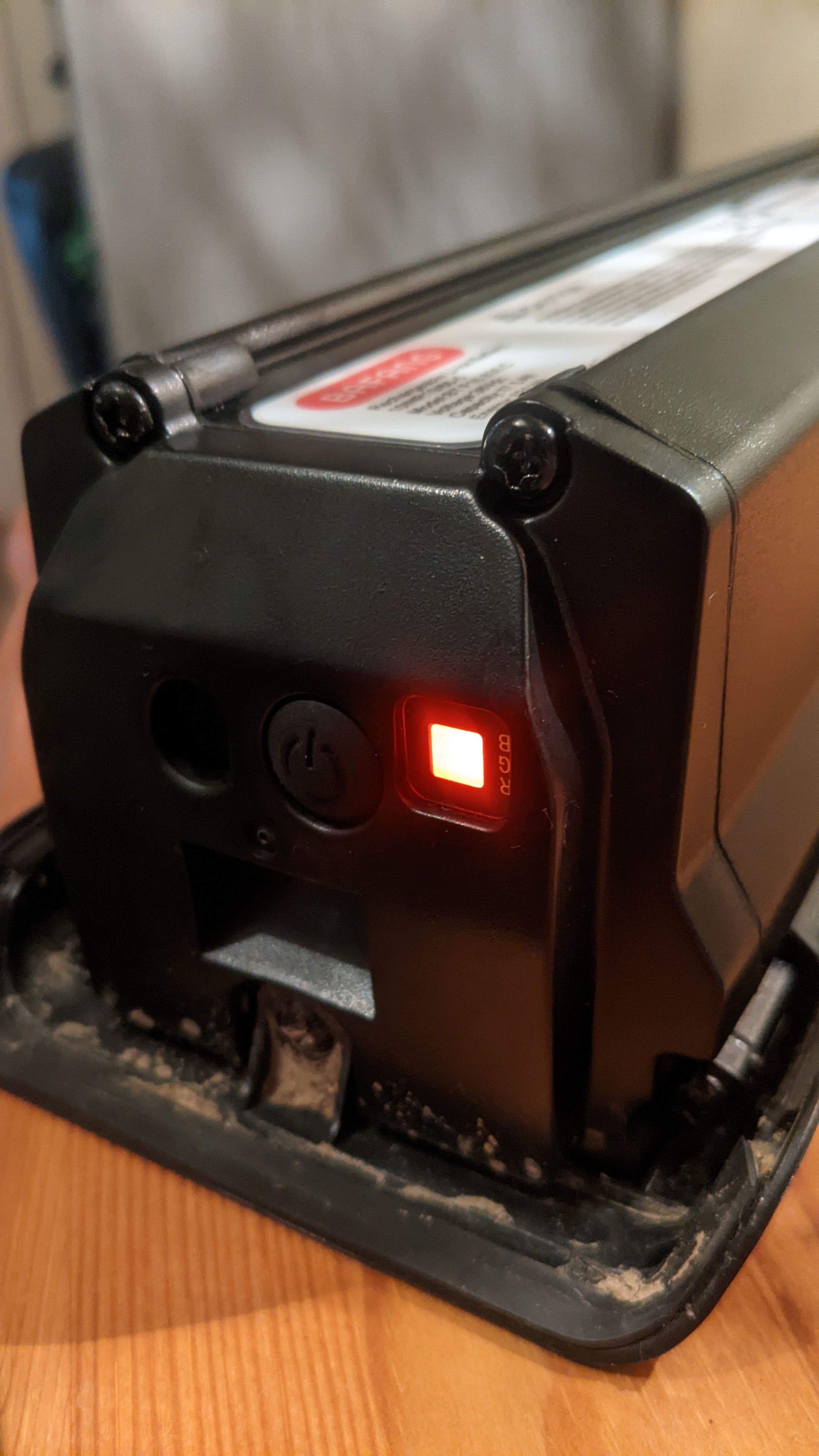

I have finally managed to get mine working
Charge the battery full with the battery in the bike
Once charged partially release the battery so that you can press the button on the battery
Hold the button on the battery until the lights go from blue green red then
When it goes green refit quickly and press the power on.
Screens booted up and worked every time since, I sense that water ingress is putting the bike into a safe mode!?

ok, so for testing/reference.
I just tried that on mine ...
Working bike. Powers on fine.
Opened battery and lowered just enough to press the power. Pressed and it came up red, held and eventually it cycled blue green red and put the battery back. Pressed the power button - nothing :)
That kind of fits with your theory that the bike is going into sleep mode for some reason, except I forced a working bike into sleep mode.
I then tried it again - but the same result. Dead bike - it didn't bring it out of sleep.
This time I removed the battery. Pressed the button and it came up red. Waited a second.
Pressed it again. It went red. Held it this time and it flashed red then a second later went green. Released the button, re-inserted battery. Bike powered on.
Tried the same thing with the battery off the bike and the same results. Re-insert battery, press power for 3 seconds, bike powers on.

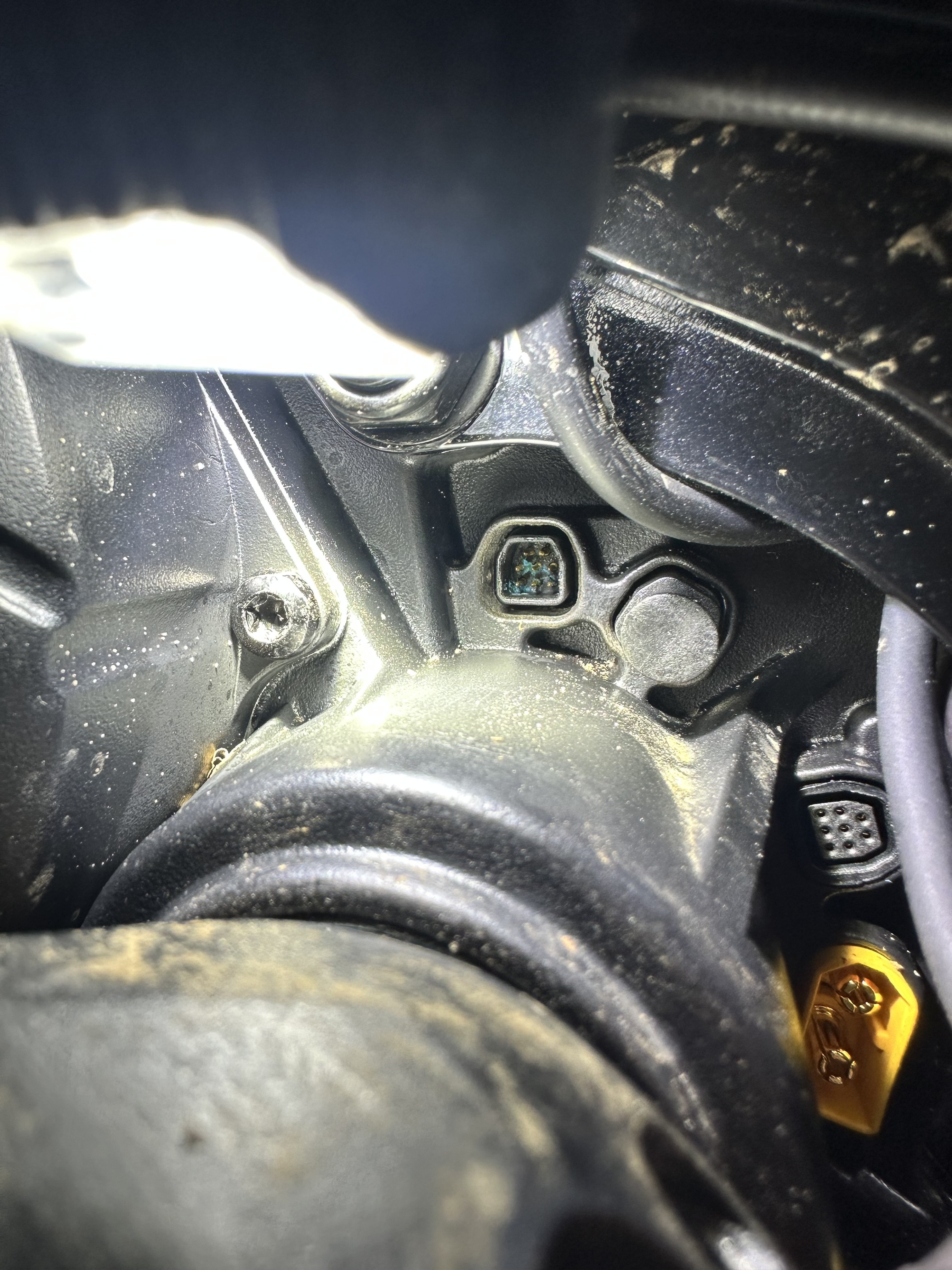

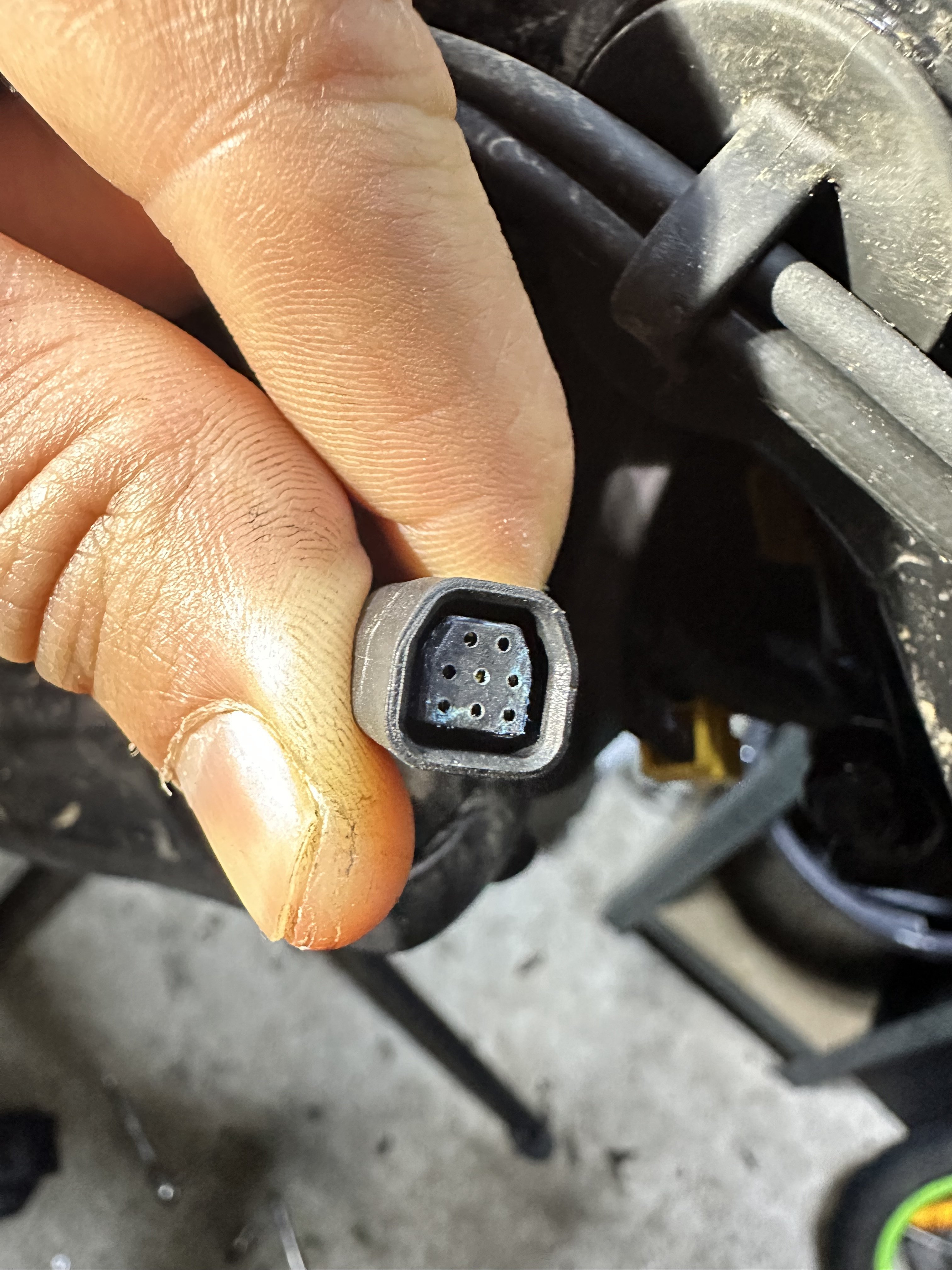

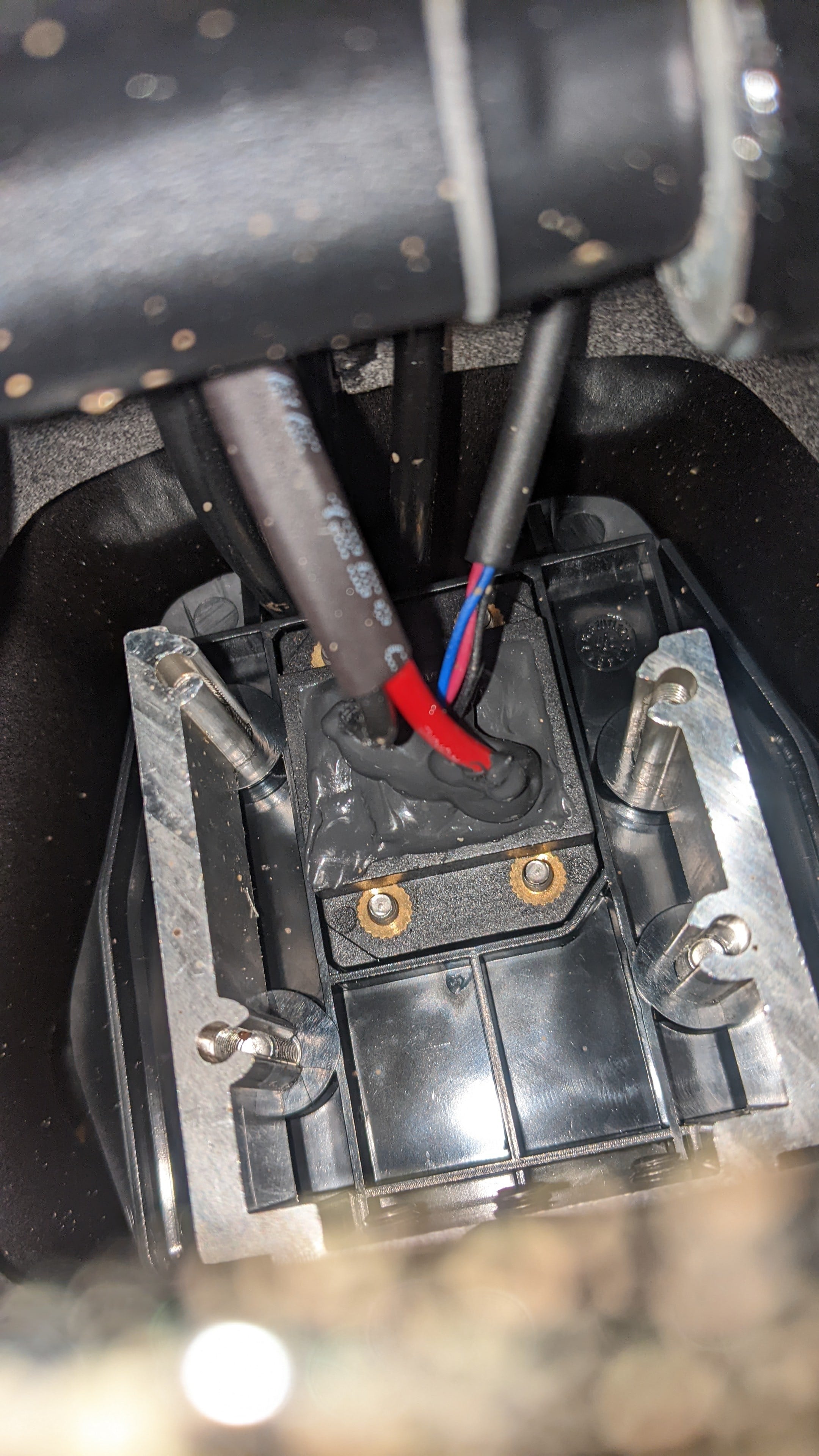

It does seem to be a common issue now as I have come across 6 separate occasions so far. All bikes delivered within recent weeks and failing after a hand full of rides
I did find corrosion in the connection from the motor to the switch which has since been cleaned out
Can water cause the battery to go into a safe mode?
View attachment 128723 View attachment 128724
Hi thanks for your help and advice here, I have tried all variations of button on battery with bike on charge at same time and off charge with battery still connected and nothing seeming making any impact. I did get the bike powered on yesterday by that method but then by time I had my gear on and ready to ride, it wouldn’t turn on again.
This motor connector you have pictured, where is that located? Is it chain side or disc side? Is it easy to access just taking the top cover off or did you need to remove chain ring etc? I am mindful of warranties and don’t want to pull it all apart, equally if easy to access that motor plug I think that is a next step to try. Elec cleaner it and if it did get wet that would explain all the rest. Bike is dry now but would be good to check that connector

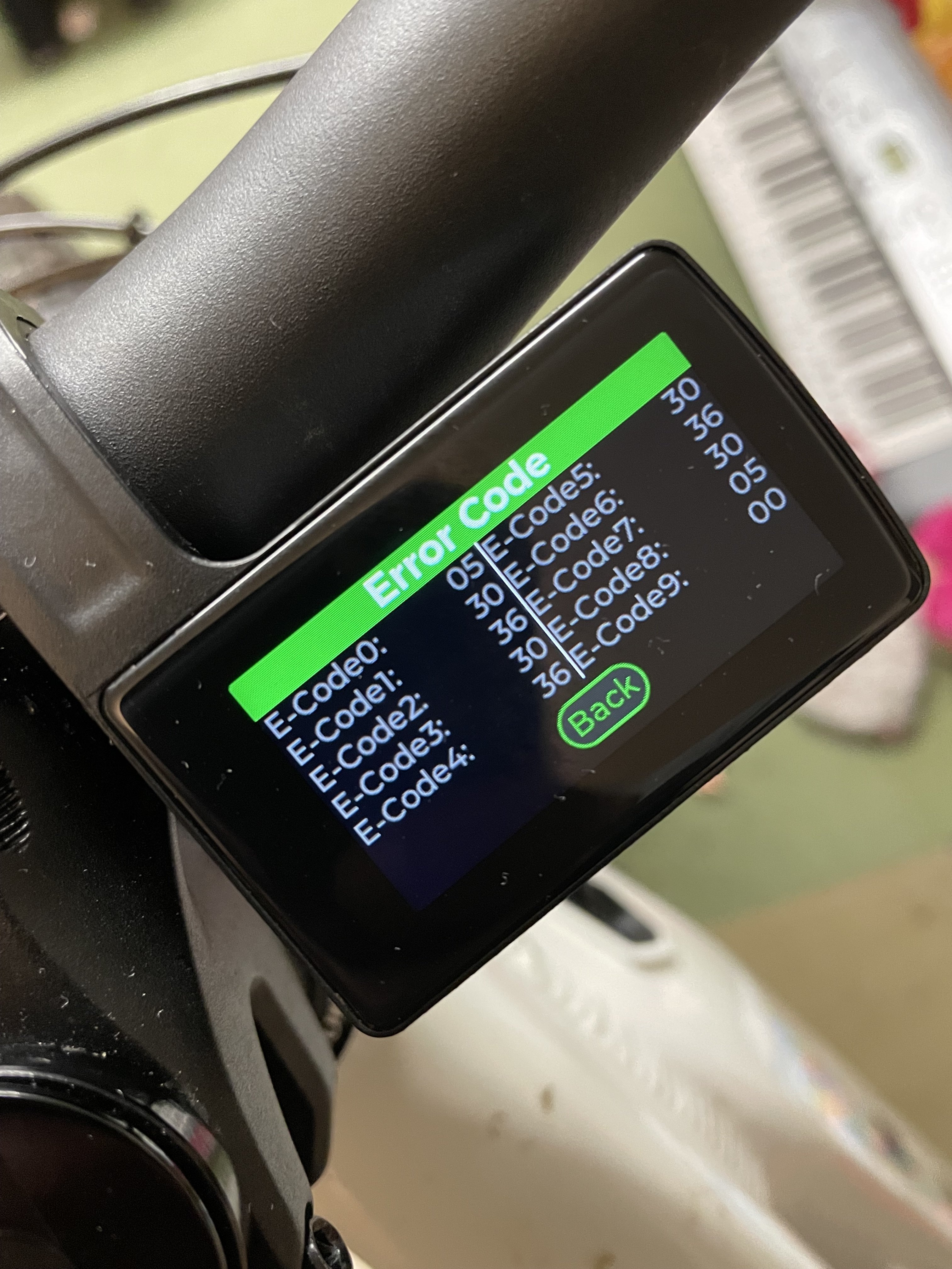

Emtbkris
Nov 11, 2023
Hampshire

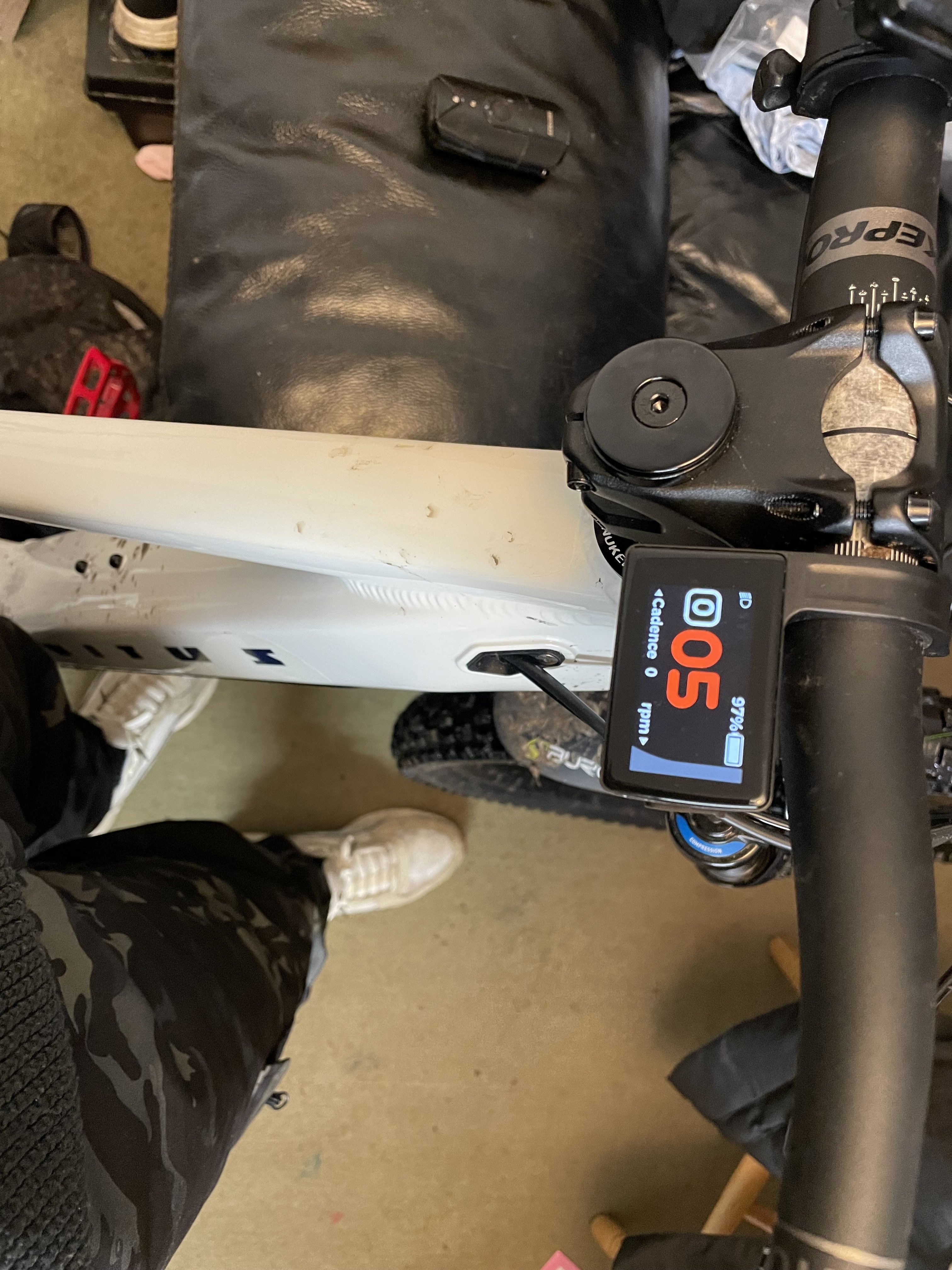

Initially, still didn’t have any difference. I put the cover back on and did same battery button thing but no display.
About an hour later I went back to it hoping for a miracle, I took battery off completely and clicked button. When I put the battery on the bike the display came on itself. I thought might be solved, for now. But nope.
I now have a 05 where the speed would be. Bike clicks between eco and trail mode etc but no assistance from motor, as if bike is still off.
Speed is not being displayed as that 05 doesn’t go away.
I haven’t dared turn it off yet as know it won’t turn back on again..
Here’s the codes I’m getting now and the screen with 05 display.
All connections I can find are secure and ok that I can tell.
Think this is going to turn into a headache but open to any advice and pointers if anyone else has had this issue
