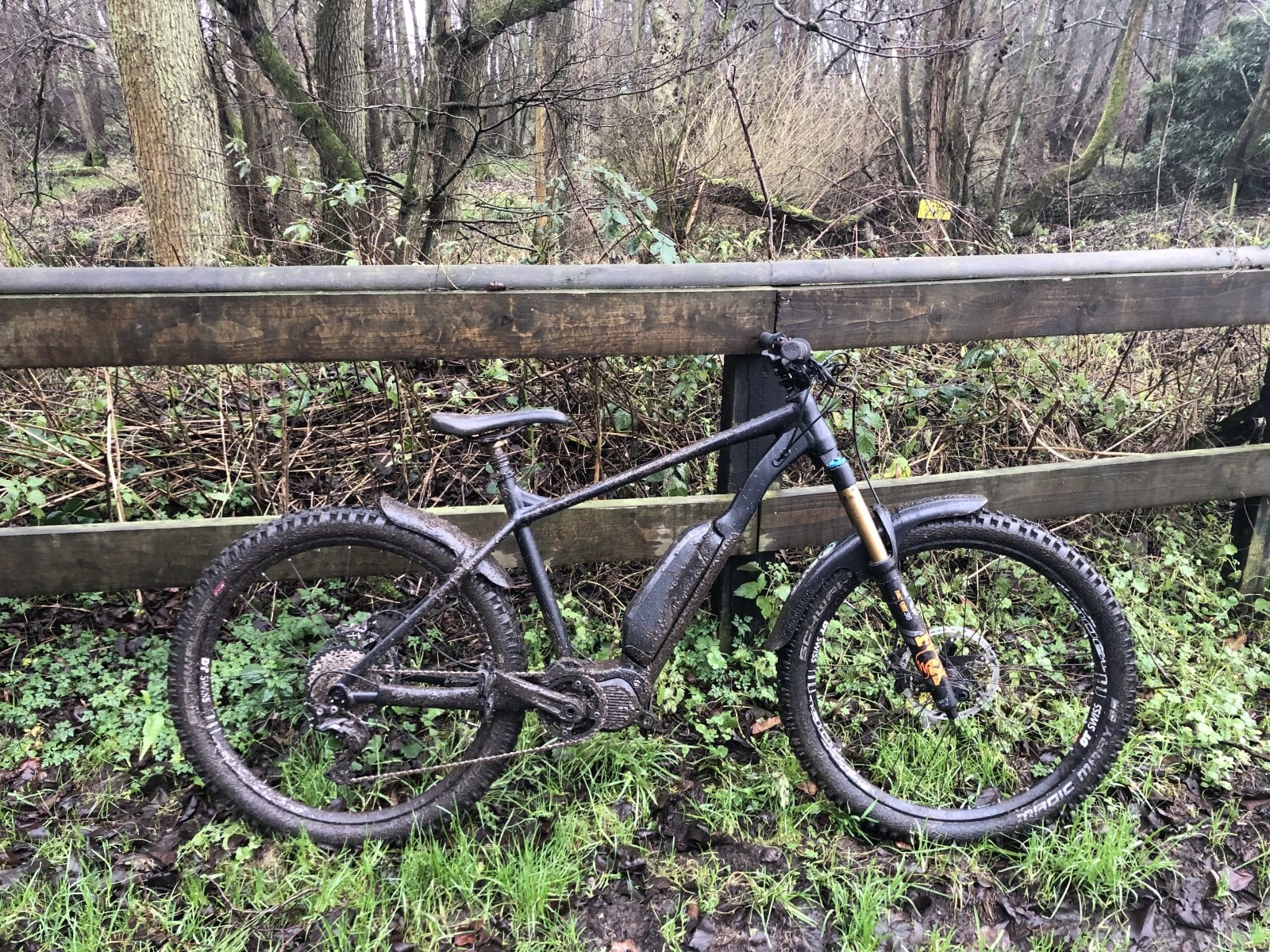

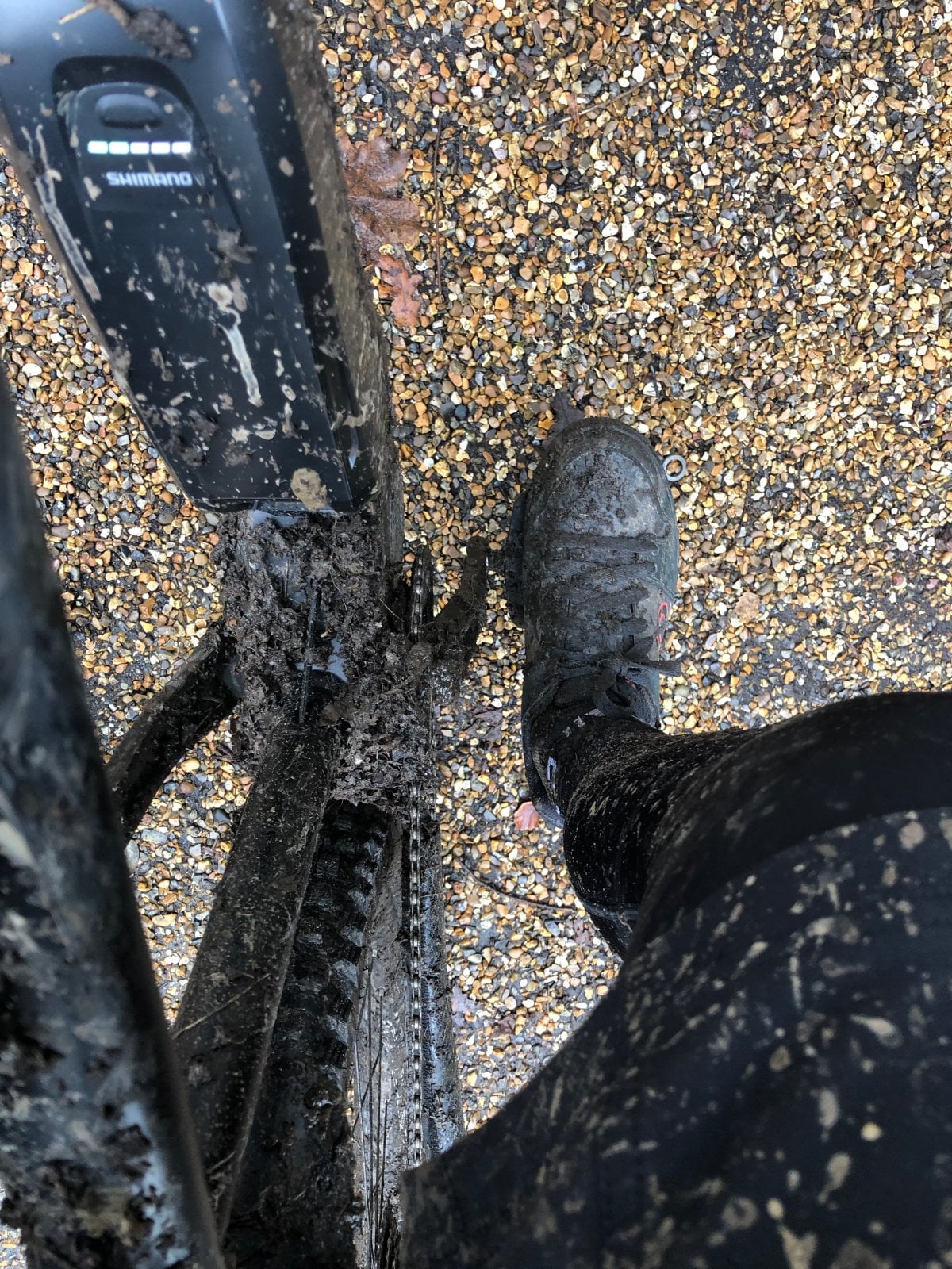

I think EMTB's really come into their own in the winter, I am enjoying getting out in the mud and crud more than ever, you can plough through stuff!
