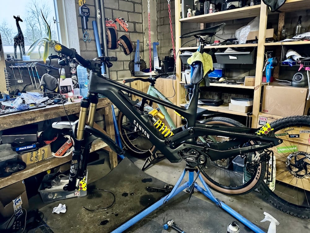

On my Canyon Spectral ON and Torque ON I had to lift the motor to get the hose through the frame. Both bikes had a heat shield around the hose.
I did gut the hose on the brake lever site. Then mounted a Park Tool cable routing guide. Pulled the hose through the frame. Mounted the new brake hose. And slowly guided the new hose through the frame. To place the heat shield. Dismounted the guide tool. Installed the heat shield. Mounted the guide tool again. And did the guide the hose through the frame.
In my case the hose goes through my headset. Also had to remove the fork. At the end it did take me 20 till 25min to get the hose through the frame. This is with dismounting and mounting the EP8 motor and fork.
My Spectral ON had also a clamp for the brake hose. First I had to loosen it.
Installed the Magura MT7 Raceline with Shimano M9120 calipers on my bikes.

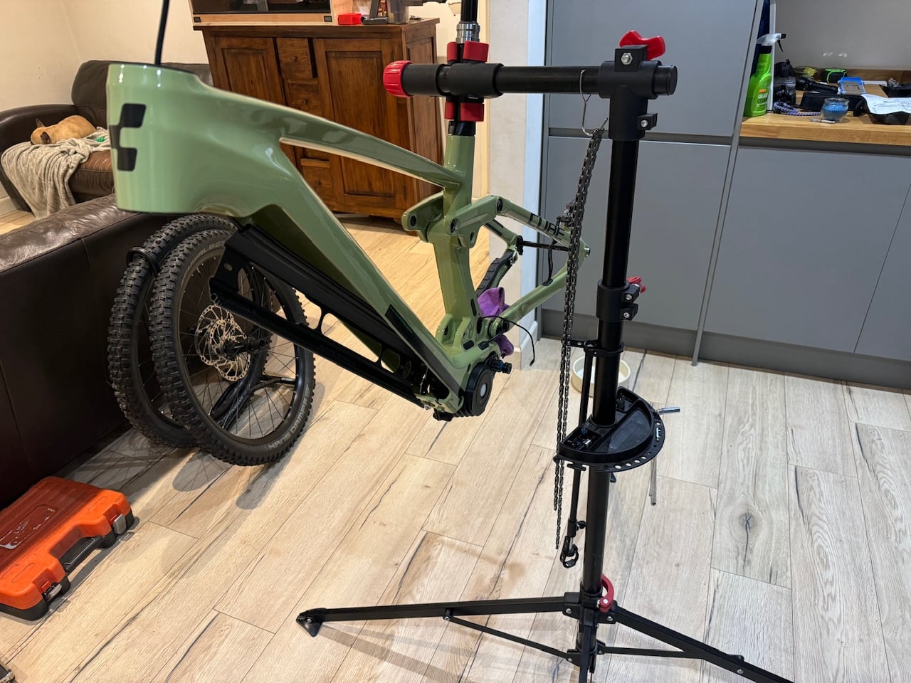

I stripped the whole bike down as I wanted to give it a full service. On the stereo the metal battery tray comes out, after you remove the lock, and then there’s another plastic tray behind that the hose goes through.
I went through the chain stay first, then through the frame but had to feed it through bit by bit
