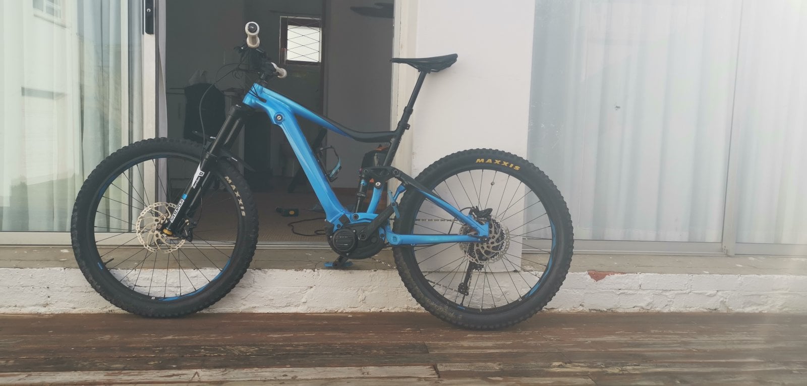

Recently I spent some time changing a couple of things on my Trance-E +2 to improve the front heavy low front end. Here's what happened.
First thing I did was to move my seat backwards as far as I could go. This gave my a lighter front end and strangely enough the bike is now much easier to ride no-handed. Previously it would feel nervous and like it would fall over when you moved your balance left to right. Stability therefore is now much improved.
Previously I replaced my standard handlebars with a Raceface carbon bar which gained me about 15mm. That lightened the weight on my hands marginally but not much more. I wanted to put a raiser stem on but couldn't find 37mm available everytime I looked and quite frankly I didn't look too hard.
After previously spending some time on tuning the Fox Rythm I felt that it would benefit the bike if I could lengthen the stroke to 160mm, so I decided to buy a longer air spring for the extra 10mm as in the SX Pro. Now it is important to note that many of the 150mm Rhythms don't actually have 150mm travel because they sag into some of their travel on their own weight. I did everything I could but just couldn't get my fork to stop sagging into it's initial travel on the weight of the bike alone even after burping the shock to get air out of the negative chamber. It looked like I'd have to strip down and remove some excess ghrease (a common reason for forks to behave like this). As I planned to increase the stroke anyway I decided to buy the longer airspring and do it in one go. This is where things got interesting. While looking for the right part number, I saw a Suntour Duramlux boost 29 for a really good price. I mean this price was so good I just had to buy it and based on reviews of the fork it compares very well with the Fox factory and Rockshox Lyrik in performance. It turns out to be the best upgrade ever. I gained 30mm height because of the increased axle to crown height alone and this changed the playfulness of the bike tremendously. I have much less weight on my wrists, more control on the steering and the bike feels generally more precise to handle with lighter steering. I've also gained the ability to increase travel all the way up to 170 if I wanted to without buying parts, all internally adjustable. The fork itself may not be a Fox Factory or a Rockshox Lyrik but performance wise it is amazing and the adjustability is awesome with high and low speed compression damping as well as high and low speed rebound damping. After fitting the fork I found the bike to be a beast going over and through obstacles like butter and the jarring ride over choppy terrain is history. I also have the option to fit a 29er on the front if I want to. I still maintain however that the 27,5 feels better for me personally, so I don't think at this stage that I'll consider it.
The change in the fork lightened the front so much that I now consider moving my seat forward a little again as I found that when riding no handed my bike feels a little nervous but it becomes very stable when I move my weight forward just a little. That is my next change weather permitting today.
The bike also looks much better and more aggressive now and it is very confidence inspiring. I'm adding some pictures.

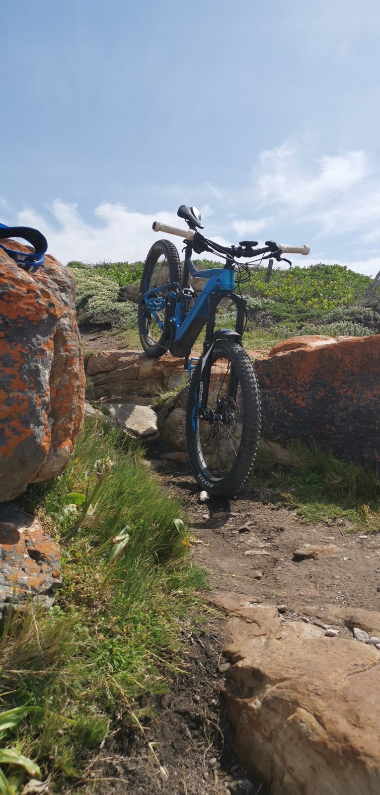

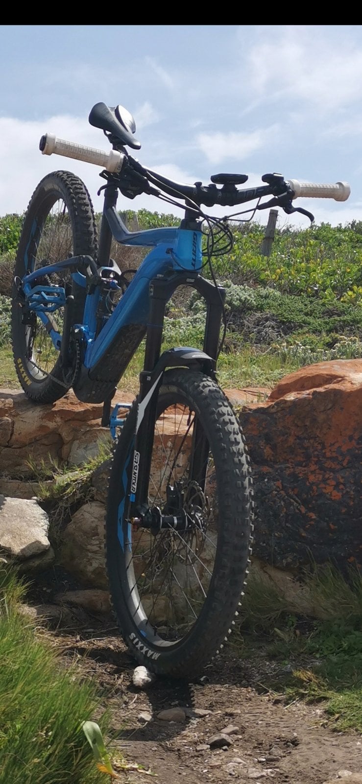

@MrTeno2U I think you need to do a bit of work to get the settings perfect on the R2C2 and perhaps in the test they haven't spent enough time getting it just right. In my own experience as a heavier rider currently weighing in at around 111 kilos (multiply by 2,2 for pounds) I found the shock to perform exceptional with 110 psi air. I then opened all the dampers fully and once the from wheel stopped jumping into the air on the high speed rebound setting I played with the slow rebound until I was happy.
The next step was to look at the compression damping where I started from the opposite side and worked my way back until the reaction became softer.
Next step was taking it out on the trail. The damping on compression and rebound was noisy as the test says with a hissing sound every time the fork was compressed or relaxed. I then relaxed the compression while riding until I was happy with the small bump absorption and found that the hissing went away.
The rebound is still making the hissing noise but it is not irritating or too loud and more of a subdued hiss and to me sort of reassuring that the for is doing its work.
The fork now has a very smooth action over choppy surfaces, which previously would have worked my wrists very hard. I also find that the fork absorbs big hits very well and ramps up very well towards the end of the stroke. I will experiment with it over time and if need be I can remove a volume spacer to provide a bit more travel although I don't feel currently that I need that. I also have the options to increase that travel with an additional 20 mm. I don't believe I will increase the travel at this stage as it will take any hit as is without bottoming out and with the higher axle to crown height addresses the only criticism that I've got on my Trance-E.
Tomorrow, weather permitting, I'll be riding a series of three trails that will include climbing, some moderate downhill, drop-offs and a gnarly rooty, rocky section with serious climbs through tree roots and over rocks. Based on my feeling after a good local test yesterday morning it's going to fly through there.
One particular stretch I did yesterday where I normally go through at speed pedalling hard with bad undulations left me gob-smacked with admiration for the performance of the fork. With my Rythm I would be almost out of control and at the speeds I was able to reach through there yesterday my feet would be off the pedals even standing up.
Another huge advantage is the lift I got on the BB with the pedals now not coming close to hitting anything.
The slacker fork angle means I will take my seat forward marginally again as the steering and front wheel is now considerable lighter. My angle of steering is also much better now which gives me more confidence.
I am highly recommending the fork and I will now also do some experiments with a 29 inch wheel if my brother will lend me one as my previous tests with 29 inch wheels were on other brands of bikes where the feeling was a bit too vague for my liking. Once I've tested that I'll give some feedback on what I think on the mullet conversion for the Trance-E.
In summary, I think that the longer axle to crown height of this fork that is seen as a criticism is actually what I like most as it changes the geometry favourably and lightens the load on the front wheel and lifts the pedals at the same time. I know that they build bikes these days with low BBs to get a lower centre of gravity but the low BBs are in some cases becoming a bit silly and is only okay for downhill riding where you don't have to pedal. While I got used to that, It still caught me out many times and the lift these forks give is very reassuring. I also don't find that the handling is affected adversely as the improved steering actually makes it feeling more nimble and controlled than before.
