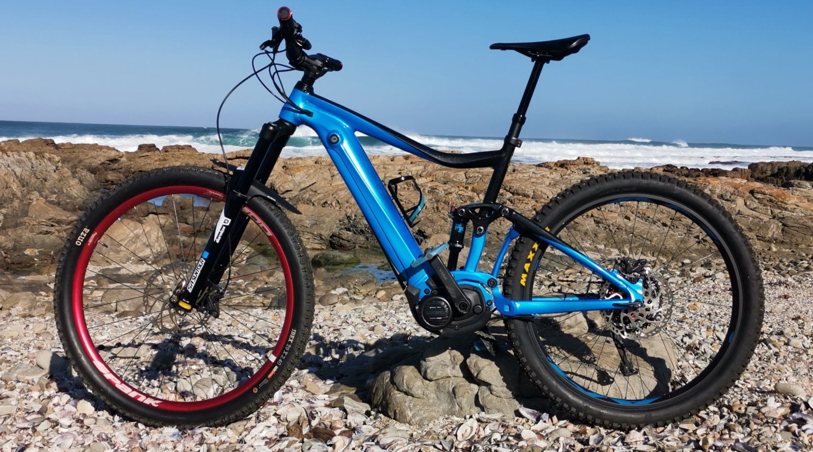

I don't know if anybody is still following this thread but I've done some more playing around and it's been lots of fun and the end result is even better. I got a 29 front wheel for free and decided to put it on. So to recap where we stand with mods:
I made the following changes to my bike:
1. Raceface Carbon bar with approximately 15mm additional height on the handlebars,
2. Replaced the Fox 36 Rythm 150mm with a SR Suntour Duralux R2C2 29 boost fork that gained me 30mm in additional axle to crown height (I left it at 150mm because it's already 30mm higher).
3. Now I replaced the front wheel with a 29, which gains another 7 of 8 mm and reduced the rake of the fork from 64 to 63,5 degrees.
I thought this last change would have a very minor impact and I expected the steering to be lazier, similar to the Merida e160. I couldn't be more wrong. It is the best change I made. The tyre I'm running us an Onza Ibex 29x2,4 in 60 TPI.
The results are as follows: Steering is lighter and more precise. Tracking is excellent and balance is perfect. The Giant always felt a bit nervous and I never felt completely comfortable to ride with loose hands. It was just too nervous. On hard surfaces I can lean into corners with much more confidence and improved grip. On trails with deep ruts, there's almost no feedback through the steering and it doesn't tramline like it did with the 27.5 x 2.6. In deep sand my front is a little less sure than before but considering that I'm running high pressures I could just let done air out and gain some improved grip. A small price to pay as I'm only riding a small percentage of terrain with such deep sand.
At the back I run a wider 27.5 x 2.8 for increased grip when climbing.
Climbing over steps and high rocks is improved, steering is lighter, confidence leaning in all corners are hugely increased and balance is hugely improved.
With this last improvement, I'm now incredibly happy with the bike. Comparing it with bikes like the Merida e160, which is lighter with a shorter chainstay length, which I used as the yardstick for playfulness, I am now as near as can be to experiencing the same playfulness. With the extended wheelbase and more relaxed fork angle, I have fantastic downhill stability. I love this Giant now so much that I won't trade it for anything out there.
The only other change I made was to replace the Giant rear hub with a DT-Swiss 350 hub and steel freewheel.
I attach a picture with my red 28 inch front rim which was given to me for free and which I decided I'm going to leave red just to be different and so that people can talk about me when they see me. The guy with the red front rim on the Giant ?
