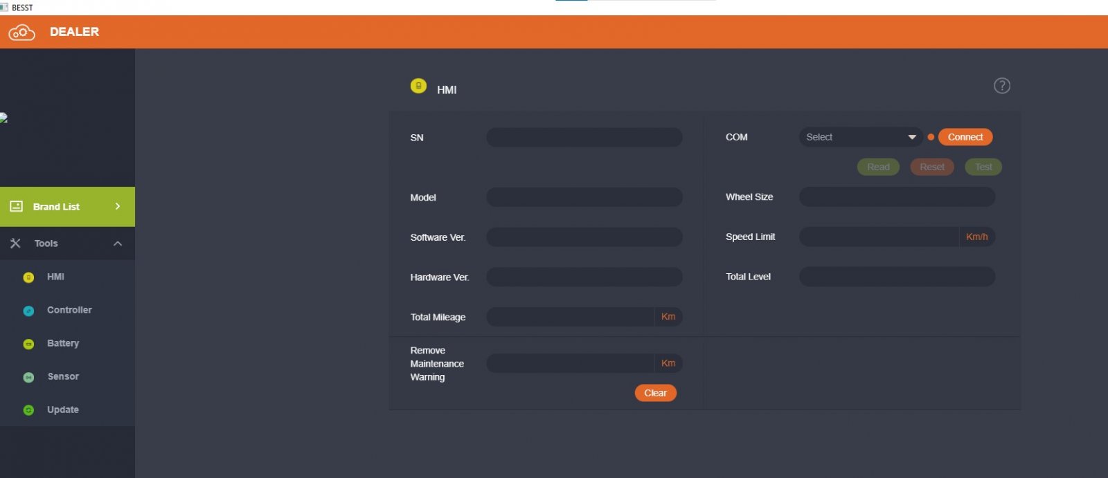

Great, it's a pity I don't live in the UK ... 🙈
I will have a BESST tool in 3-4 days, just visit me with bottle or white wine and i will be happy to assist ruin your controller anytime :)
