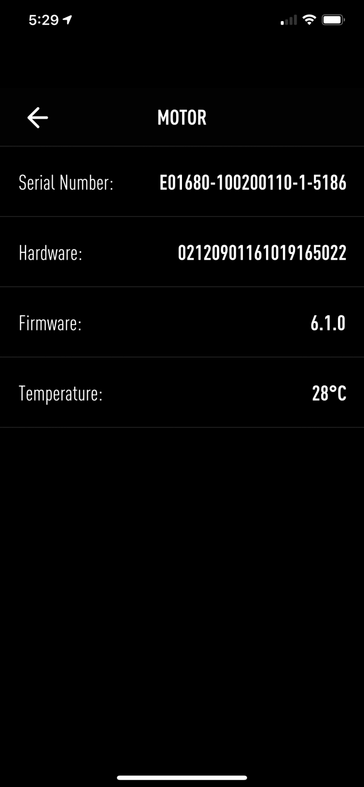

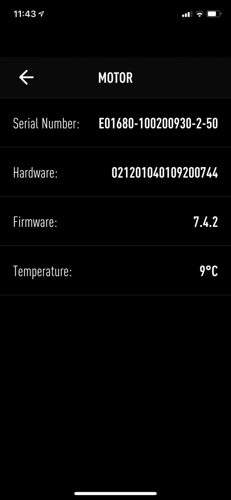

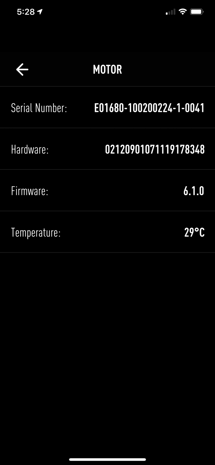

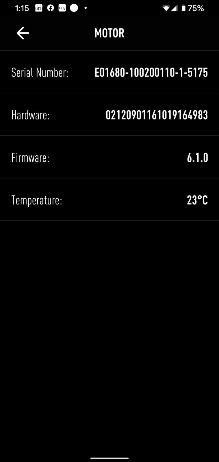

I wonder if @Rob Rides EMTB / @Citylad77 / @Austin Thomas could share a Mission Control screen shot of theirs on the motor page ?!? It might give some indications towards identifying 2.2's in future ?
Always happy to help...
and can I just say the GEN3 bike is Soooooooooo much fun to ride. That is all.
14,181
21,094
So some older ones which I think had the previous belt upgrades :
Maybe the "2" after the date numbers and before the last 4 digits ? (or two digits on Austin's) .. I'm only grasping at straws though - it might be something only Spesh can identify purely on how they have them logged and which ones they know had the 2.2 upgrades.
