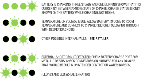

ok.. so a update ..
i have had the tcu in a bag of rice for 4 days on a radiator moderatley on an hour at night.. also i changed the power cable (rosenberger) i bought the newer 1 last year when my motor failed.. put it back together and nothing at all.
i tried with the old and new cable.
Down at the battery/charging port when i connect that i get 3/4 green lights with the 4th blinking.
Any news would be greatly appreciated.
