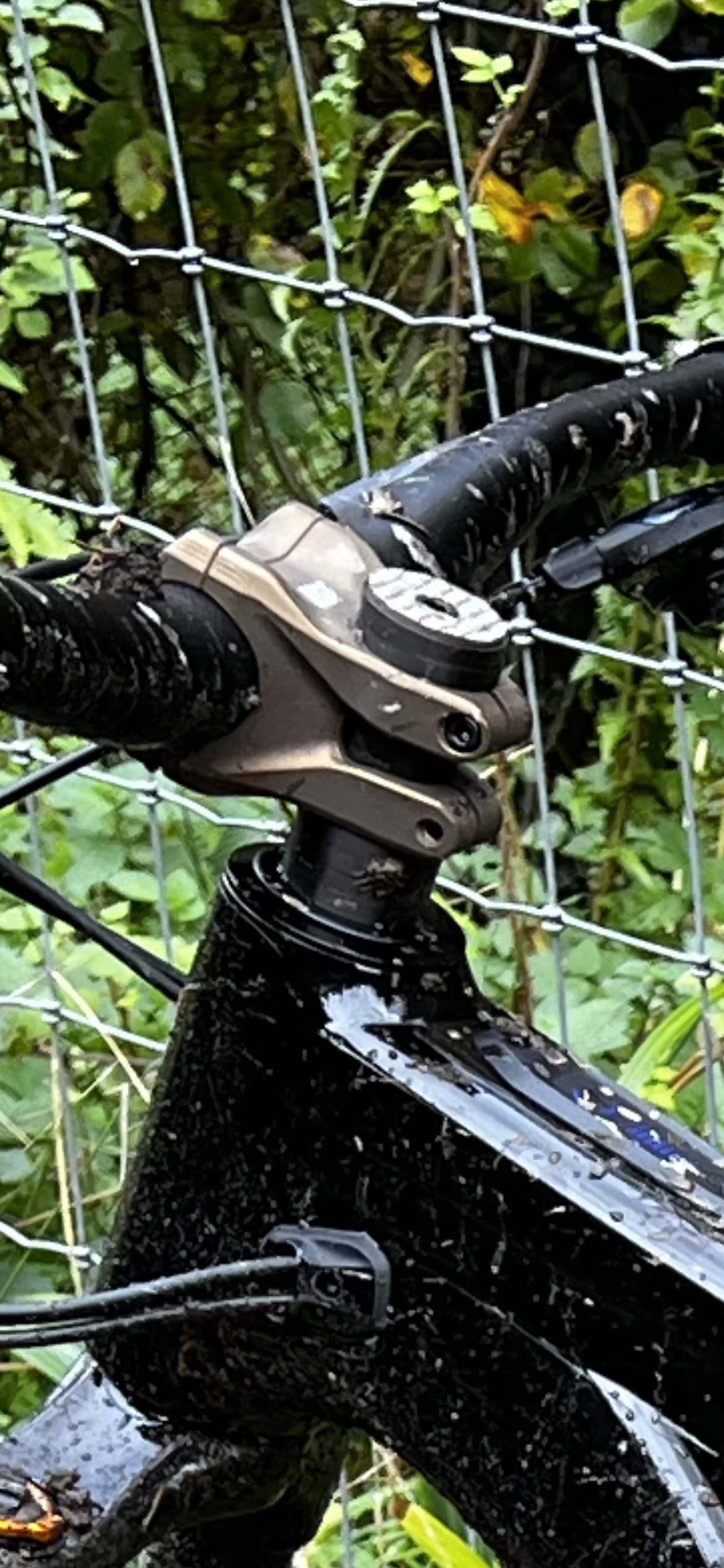

And here’s me thinking I’d lost my knack or working on bikes….
History, I’ve built up dozens of bikes myself, from scratch over the years. No issues with loose headsets etc.
Bought a Levo turbo earlier this year, swapped the headset cap over for a garmin mount (used on previous bike so no issues there) and noticed afterwards some play on the front end. Assumed fork knock from the bushings, took it back to my dealer and they diagnosed as loose headset due to customer fitting his own headset cap. And tried to charge me as a result for the work.
Bike back all seems fine.
Stem swapped over a few months later, along with steerer being cut down. Rebuild the front end and torque everything back up, knocks back. Definately was not there before the swap.
Strip everything back down, remember I have the adjustable cups, so throw on the -1 cup whilst it’s apart and all torqued back up again. No issues.
Will it stay this way who knows, but it’s good to know it’s design related rather than user error!!!!

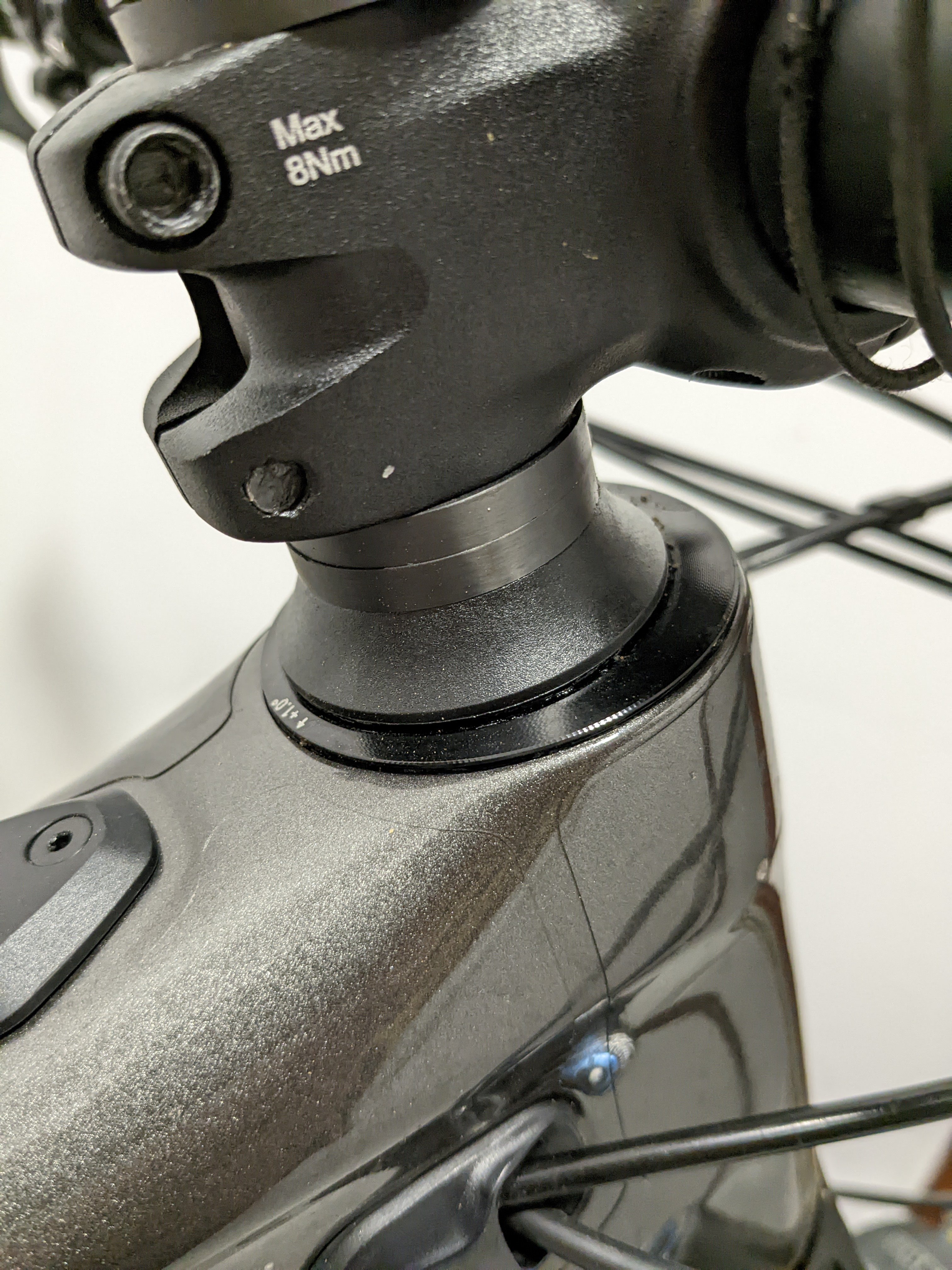

I have -1* cup installed, i ride quite aggessively, didn't notice any play (and i'd spot it right away), movement or noise....
caps are 'loose' in a frame, but they are chamfered - when you apply compression from a stem (and starnut), everything is in a place, the same as headset bearings.

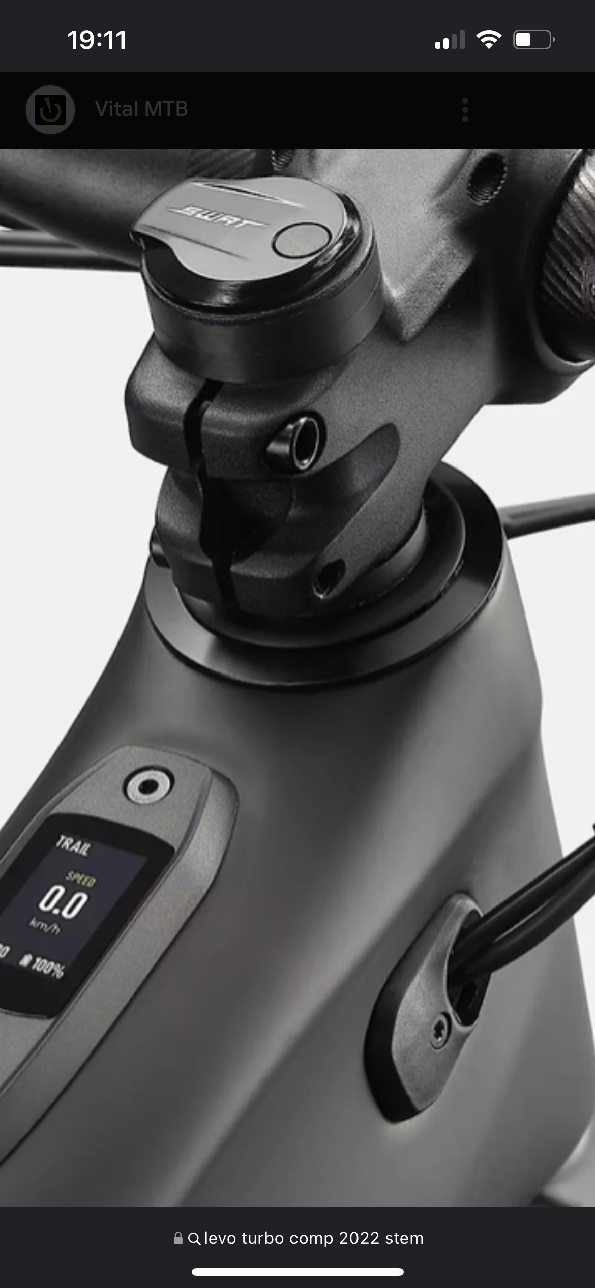

Interesting ... . Do you guys have the same buildup as me? Is it possible to indicate where the build-up of your headset differs from mine please? Mine looks like this:
Do you all have the 20mm cone above the upper bearing cup? If not, what else? Thanks for sharing!!!!
carlito
Feb 14, 2019
35
BELGIUM
Greasing the headset more often/differently may avoid the noises. But it doesn't eliminate the wobbling and instability. The play is caused by a combination of (a) the loose Upper Bearing Cup with (b) the 20mm Cone cover cap on top of it. It is impossible to keep this stable (in action) by increasing the tension of the topcap starnut screw. For solution I will (1) fixate the Upper Bearing Cup and (2) replace the 20mm Cone with something else, more stable, that grips better in the Upper Bearing Cup. Step (1) Is easy. Step (2) I'm still in the woods. All ideas welcome. Hard to believe we paid a premium price end up with this ...

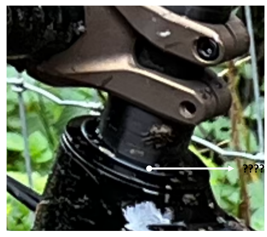

What is used to bridge the gap between the Upper Bearing Cup and the fork's tube? There is clearly something in between. Could you give us a detail of that piece, please?
No I’ve not got that, I’m just running normal spacers on mine - same as it came from dealer, just less on top now.
I'm referring to the piece where I put the arrow .... . Could you give us some details about that piece please?
Privateerjon
Jul 24, 2022
29
48
Bristol
So, you’ve headset cup in the frame, bearing, then a flat plastic cap, before your into the spacers below the stem.
The plastic cap / disc likely does not seal as well as the tapered cap you have on yours, as it sits on top of metal race of the bearing itself.
I’ll try and take some more detailed pictures next time I’m in the garage

I run plastic spacer/chimney - no issues
Thx for replying! Good for you. Yes, I think there is a combination of factors. You have the +/- 1° Offset Upper Bearing Cup. This might sit more snug into the frame because of different shape compared to the 0° one. Plus, your Cone Spaces seems to be less than 20mm. This combination might indeed work fine. Mine doesn't. I mean, really does NOT work at all. I'm certificied bike mecanic - for hobby, but nevertheless. Never seen such headset issues. Thanks for sharing! Every reply helps to clarify.
