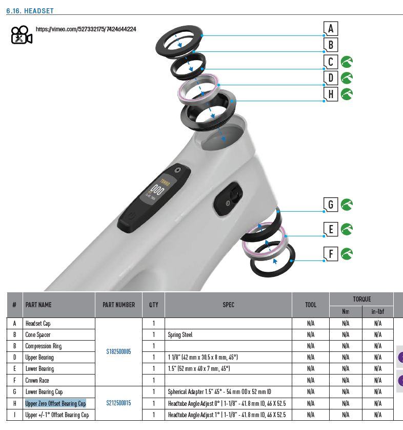

Recently noticed the same problem with the headset on my 2022 Levo Comp Carbon. If I apply the parking brake and push the bike forward/backward, there is play in the headset. I can see the top headset cup (A) moving forward/backward, while the (H) cup does not move. Cleaned and reassembled everything - the problem persisted. Did you manage to solve the problem?

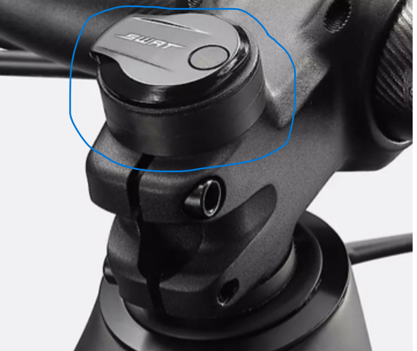

Ohh, that so radical... I can't tighten the topnut that much because I have SWAT on my bike installed from the factory. Also, I noticed that play comes from top bearing (D)/spacer(C). The cup (H) does not move.

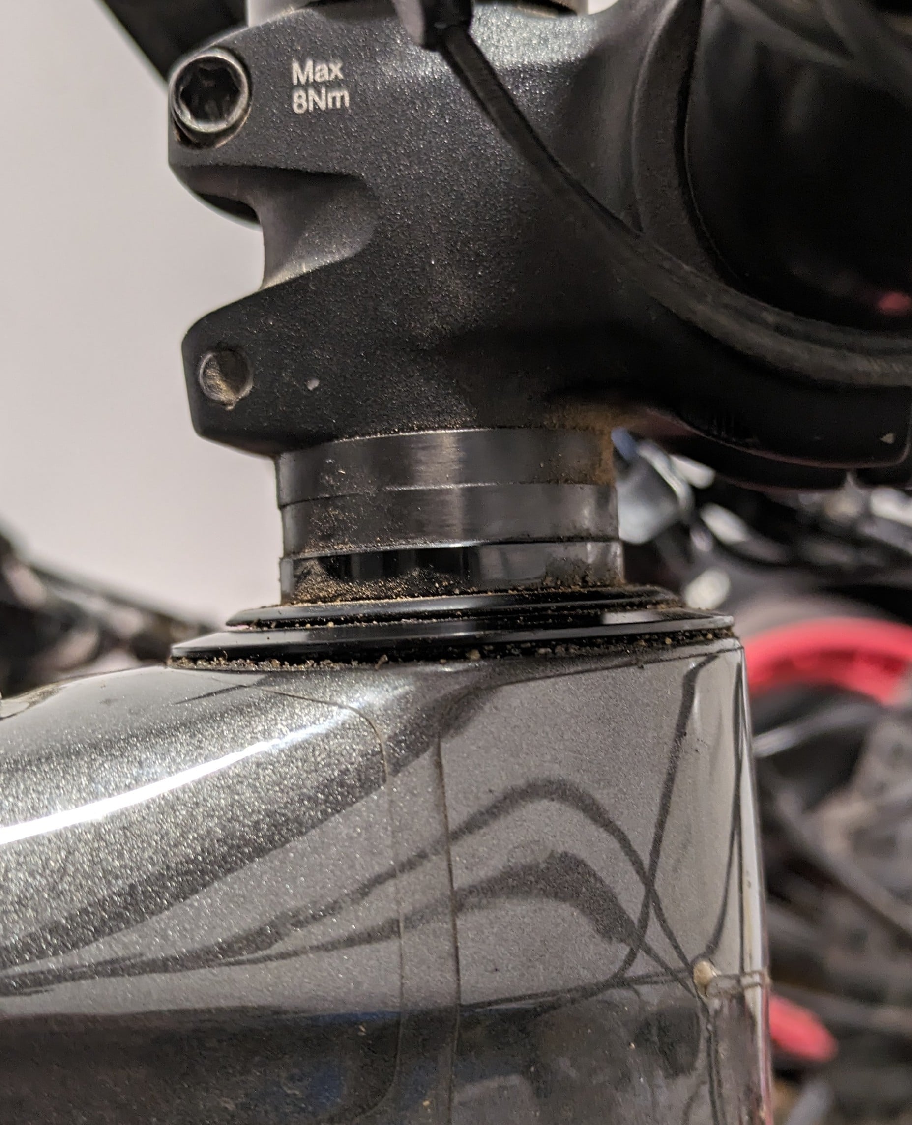

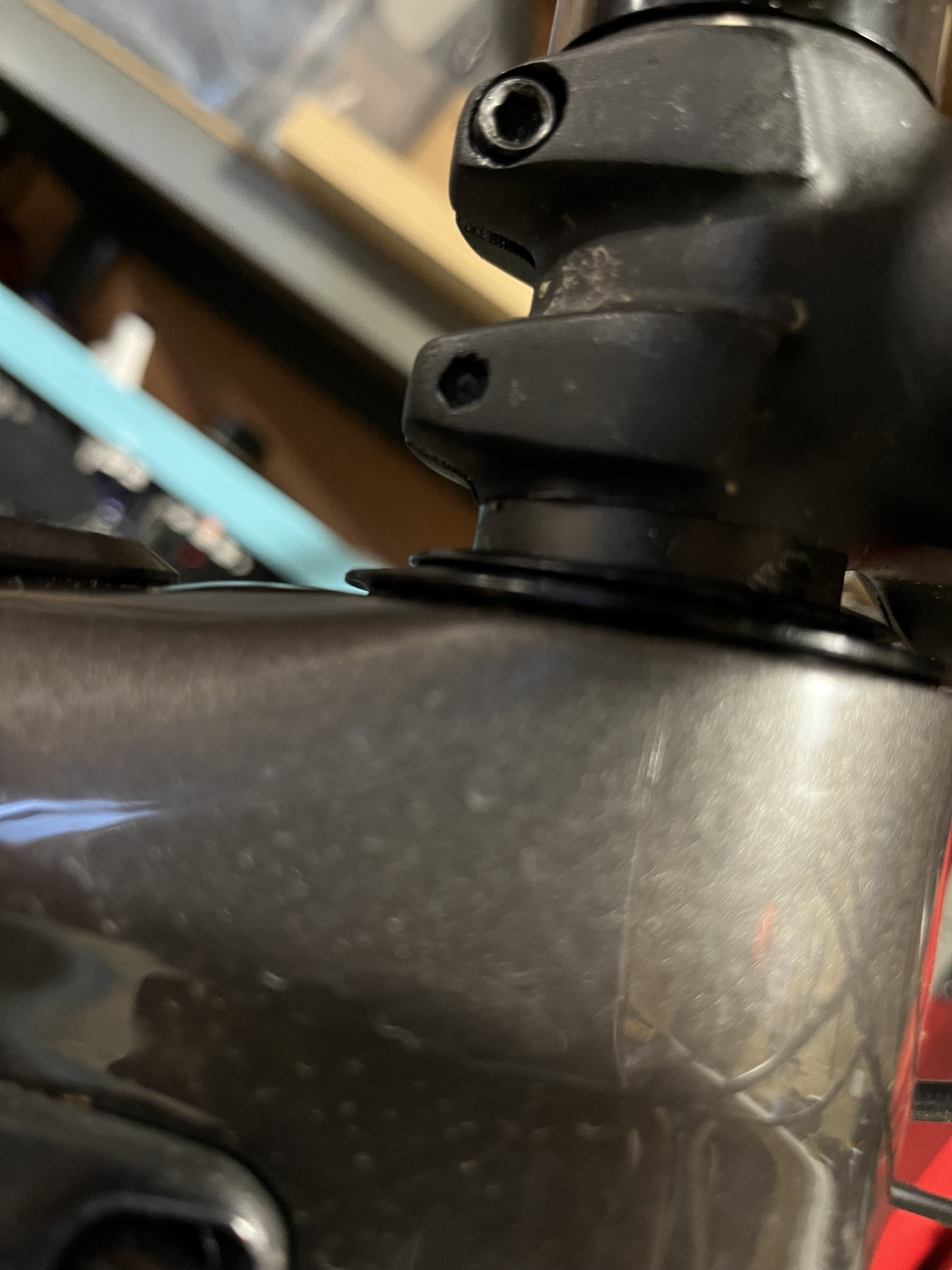

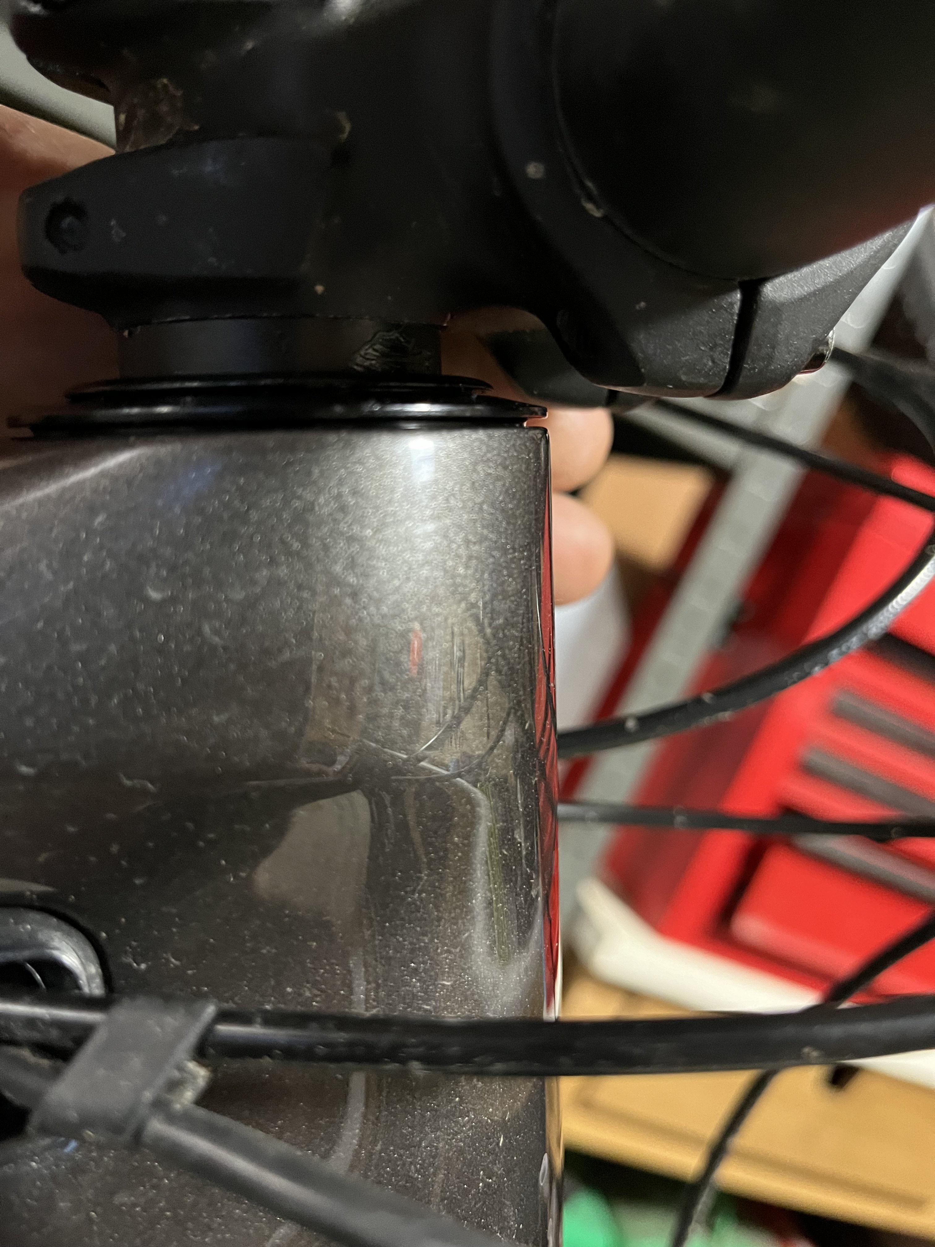

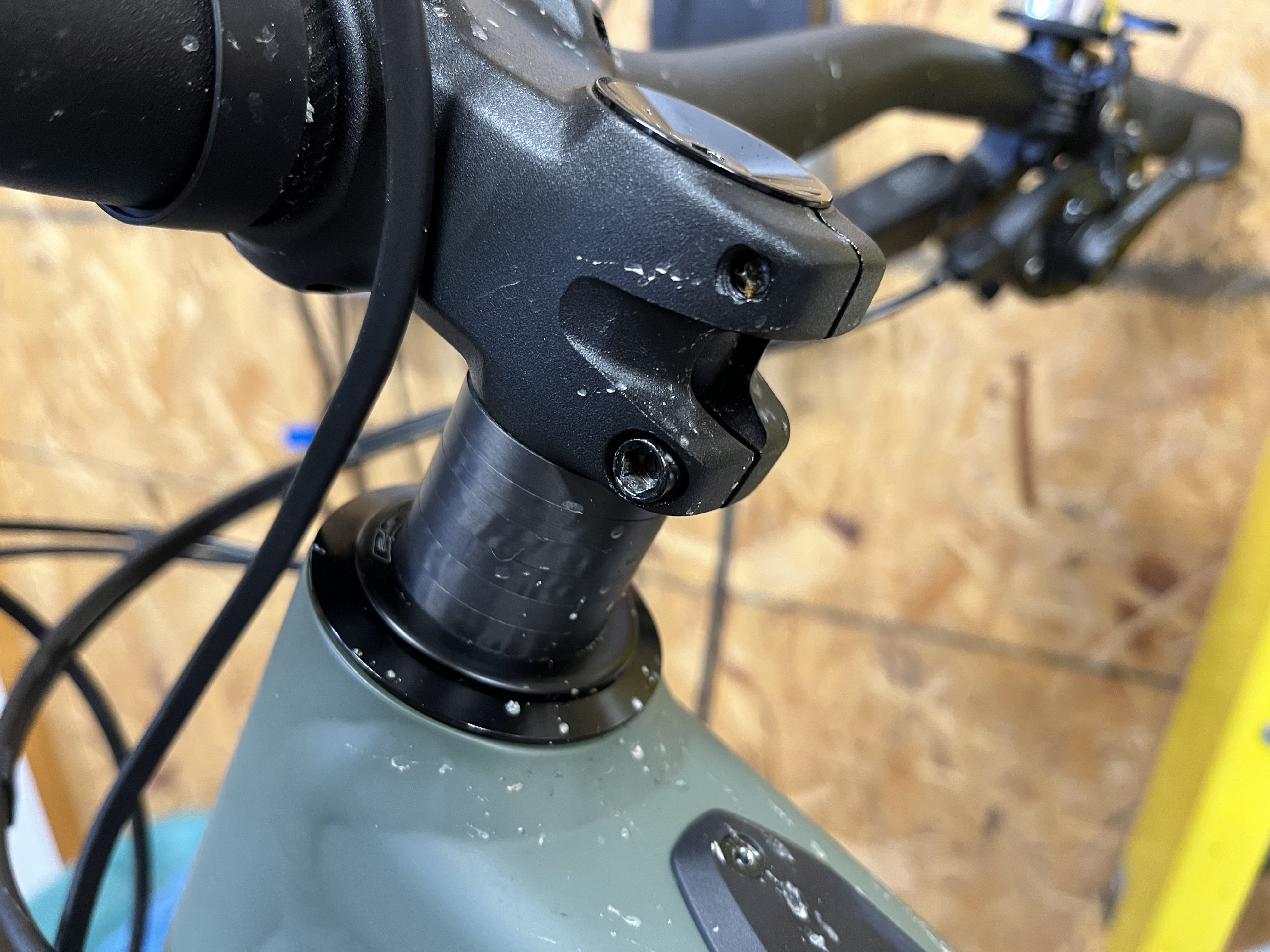

Apologies for the thread resurrection!
I can't see anything matching my concerns so I thought I'd post my own pictures and observations.
I'm running a 2023 carbon Levo with the standard non offset cup and I've noticed a gap between the cup and frame and also between the top cap and cup.
I think the photos are pretty obvious.
Is this normal? I've only done 90km on it so far so not a big test and I can't feel any wobble etc.
I did strip it down and it all looks ok, except that the cup does wobble before eventually tightening down as you tighten the stem down.
Any thoughts?
Cheers
HampshireSam
Jan 17, 2020
23
9
Hampshire

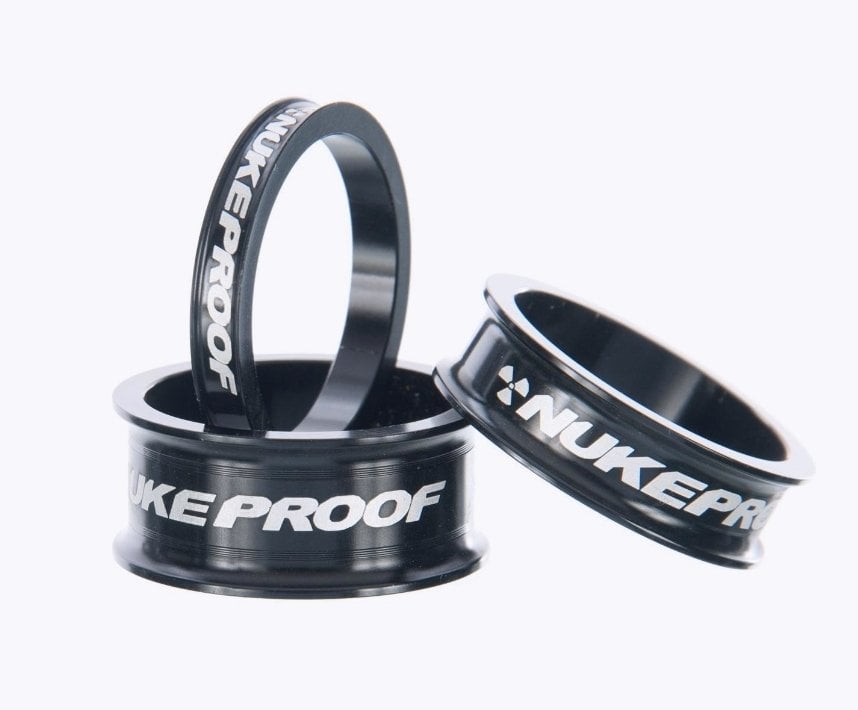

Looks like you're still using the headset spacers that come with the bike. They're carbon or some kind of composite. I was told they move around and are the cause for alot of the creaking noises. You can clearly see in your pic they aren't sat flush with each other. You could buy a 15mm spacer like I did and I've not had any creaking since.
yep, but they just do the job, i'm not concerned at the moment.
