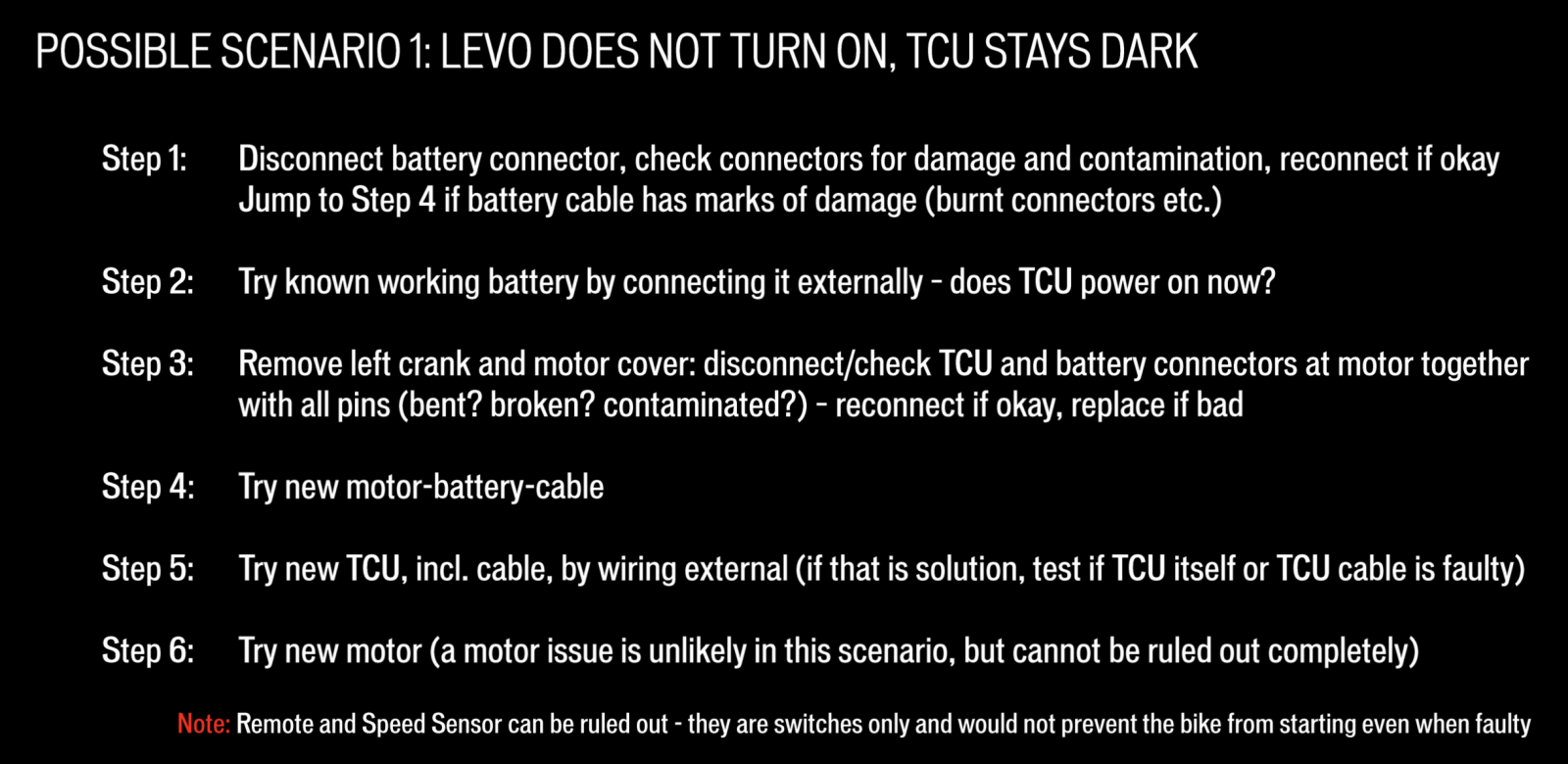

What does the battery diagnostics in the secialized app say?
So if you put that battery in your bike, you can't turn it on and the bike's display stays black? Or does that show an error-code?

If I connect it too the bike it doesn't turn on, TCU stays dark, doesn't light up or make a beep. Doesn't appear to recognise the battery.
When I plug it in to the charger just a single green light flashes on the battery. The light on the charger stays green.
and can you find the battery with mission control and what does the diagnostics say? Oh, I guess the my19 battery doesn't have an on/off button anymore, so if you can't turn the bike on, mission control as nothing to connect to.
