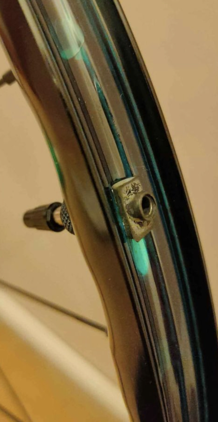

What valve seal are you using ?
Theres several different types, o ring, conical, arched, flat etc
Id check the arch in the wheel and best match the profile
Start taping opposite side from valve and have a good over lap
when inserting valve, lock the collar and further 1/4 - 1/2 turn (with pliers, carefully so no rim damage)
Check the inner seal is properly against the inner profile
Fit tyre, inflate, circa 40-50 psi
check correct fitment
deflate tyre pull stem and squirt in sealant
I’ve used Muc off & Stans - though must have gotten lucky
This show what I mean quite well, more so, if wrong valve seal is used

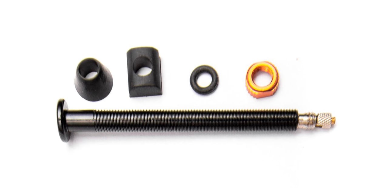

Phil,
I'm not sure if anybody else has mention it, but you have to pull and stretch the tubeless tape really tight onto the rim. The tape will then conform to rim's inner profile. There's several ways to do this.
The easiest way is to place the empty and cleaned rim back on the bike while the bike is held in a bike stand. If no stand is available, turn the bike upside down and install the rim. Place one end of the tape about 10 inches to one side of the valve stem hole. Hold down the end of the tape with your thumb (It'll want to slip and come off). Have a second person or your self grab the brake lever and lock the wheel. Pull hard on the tape and slowly let the roll of tape out as you stretch the tape onto and around the rim. The object is to stretch the tape so that it lays down and conforms to the inner profile of the rim. Slowly let off brake lever pressure and rotate the wheel as you keep pulling, stretching and applying the tape around the wheel. Continue wrapping the tape until you've overlapped the valve stem hole about ten inches. Cut the tape and with your finger rub the tape until there are no air bubbles where the tape overlaps. If there are air bubbles, work them out from beneath the tape with your fingers. Take a nail or pick and pierce the center of the valve stem hole. Push the new valve stem into hole and tighten the nut.
As a side note, I do not like to use the cone shaped vulcanized rubber valve stems. They are useless. The rubber will eventually tear and separate from the metal valve stem and the rim will develop a slow leak. I like to use valve stems which are shaped like a nail and the rubber is separate from the metal stem. These types of valve stems are very durable, won't leak, don't plug up with sealant and last forever. Also, the stems come with aluminum valve stem caps which protect the valve better than plastic caps.
Below are two types of valve stems which I use and recommend.

Thanks guys
Those grommet look a LOT better, the muc off curved ones have a little sleeve on them that is never gonna go down the hole unless you hack a lot of tape out the way
OIP.mQwRqS1ImYExcjU4kw4qNAHaEX
You can see them on the left set
I do try to pull the tape really hard but the Stans tape just snaps, really easily (I really don't like stans, I did my gravel bike with their fluid and it never sealed properly, and the tape is way too rigid)
The muc-off tape did stretch a bit but just went completely flat across the recess, which when I did my first set I thought must just be how you do them and that leaked like a sieve
A friend said I should try doing them in the house because he thinks the tape is too cold in the garage, but this time I even tried stretching with a heat gun to warm it up and the stuff still snapped :(
