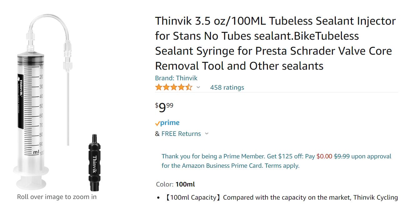

Charlie,
It's normal for tubeless tires to bleed off a slight amount of air over time. I typically check my air pressure every few days and add air accordingly.
I also like to check my sealant level every few months using the tool pictured below which I bought on Amazon. The sealant inside your tire will dry up over time. The tool allows you to add or extract sealant from the tire without opening the bead on the tire. You simply remove the valve stem with the black valve stem tool and insert the syringe into the tire via the open valve body. You can suck up the sealant to check how much is left in the tire and add accordingly to top it off. Super easy and takes only a few minutes.
