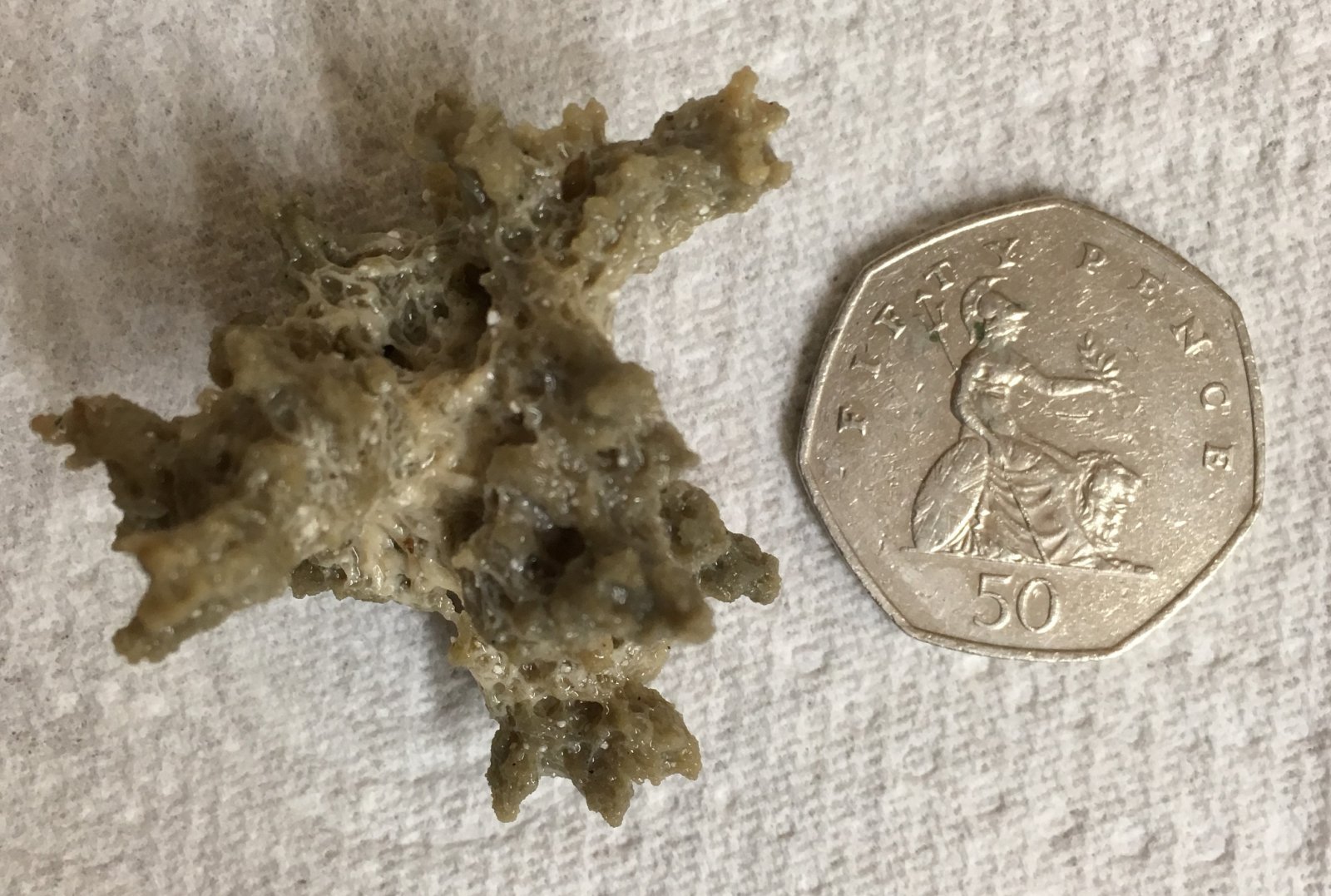

I check my tyre pressure before every ride, so when I notice that I have to put more than 1-2 psi in then it probably needs some more sealant. although I once did hear a rumbling noise and found inside the tyre a 3-D starfish made from congealed latex.
I use latex based sealants in tyres that are not proper tubeless because the sidewalls need sealing and latex is best for that. In proper tubeless tyres that actually don't need sealant to hold pressure, I prefer to use a non-latex sealant (Slime for ex), because they never go off, they just run out.
